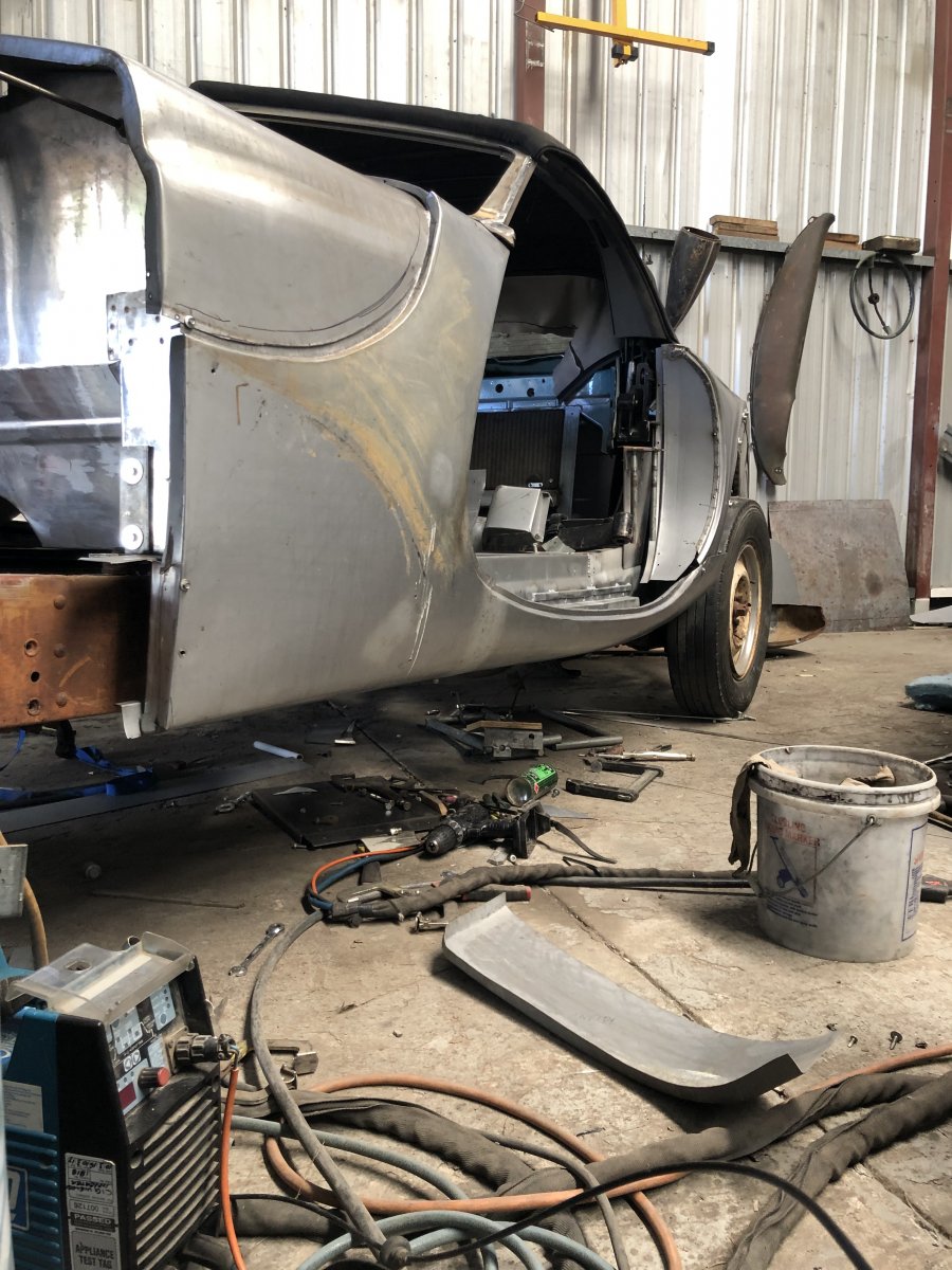

    E01C2E2C-5548-415E-A2A0-BFC01B64D1BB.jpeg Blobbing out over the weekend I got the cowlvent handle and mechanism , and a good wiper mech yesterday morning off a 49 Chevy.
    Then I remembered that one morning years ago someone left a small pile of Willys parts on the rock wall I was building with a note “thought you could use these”. I remembered a cool badge Aero Ace.... found it mounted on my old tool case. I love the font. Maybe painted body colour and discreetly positioned.
    The Packard reminds me of a fighter fuselage when I walk in each day. And Packard Aero has a nice ring to it.
