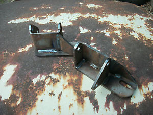

    Is anyone still reproducing the engine mounts for the Cadillac swap ? I'm looking for a pair.
  15. vonpahrkur
    Joined: Apr 21, 2005
    Posts: 981
    vonpahrkur
    i bought a set a while back for my merc, i contacted the guy i got them from and will get you the info when i hear back.
  16. 1941coupe
    Joined: Jul 4, 2010
    Posts: 424
    1941coupe
    I also bought repro hurst caddy motor mounts from a guy on ebay he makes them,real nice quality im working on a 53 331 caddy engine that will hopefully wind up in an early ford

    I bought my motor mounts off eBay from probably the same guy.
    They are nicely made and great price.
