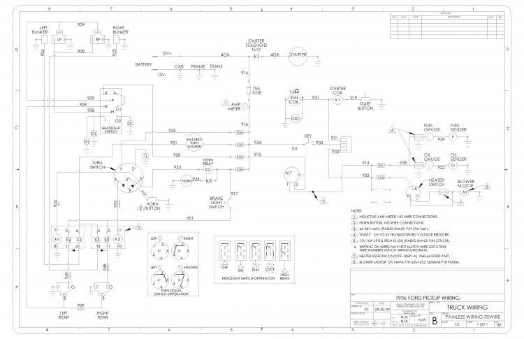

    Ok, I have this beautiful, almost original 38 I am working on, I have re wired most of the truck, now I am down to the headlight switch. The original switch mounted at the end of the column seems to be OK, (ohm it out tonight) my question is, are these switches good quality overall? are there any common problems to look out for? I do not see many people use them for one reason or another. On a side note, anyone ever convert the switch to a turn signal switch? Mount a simple 2 way toggle under the dash for the headlights and and use the horn mounted switch for turn signals? Last but not least, does anyone have a wiring diagram for this switch? Thanks for any help!

    I did exactly what you are talking about. I changed the switch into a turn signal switch. I had to use diodes and a couple doublle throw double pull relays to cancel out the brake light and make it blink.
    I created a wiring diagram that I will send you as a .PDF

    There is a pic of the wiring diagram in my albums. I can't figure out how to attach to a pm. I can send it to anyone who would like a clear large copy to their email. my headlights go through a 1965 ford truck dash switch. the origional bulb switch was made for 6v headlights and can more than handle 12v blinkers.

    Thank you Bruce, pasadenahotrod, and Kelsey Fleck, your input is greatly appreciated. I received the schematic on how to do what I want to do from Kelsey, that will save me hours of headaches THANK YOU. The rod seems to be straight, and everything "felt" good before I took off the end cap, I will clean and inspect everything before putting new wiring to the terminals, and make sure all is good.
