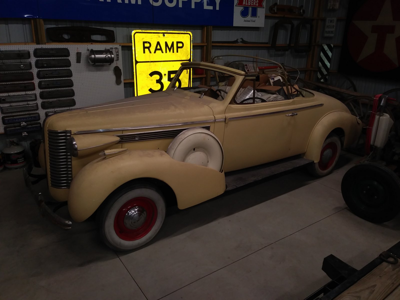

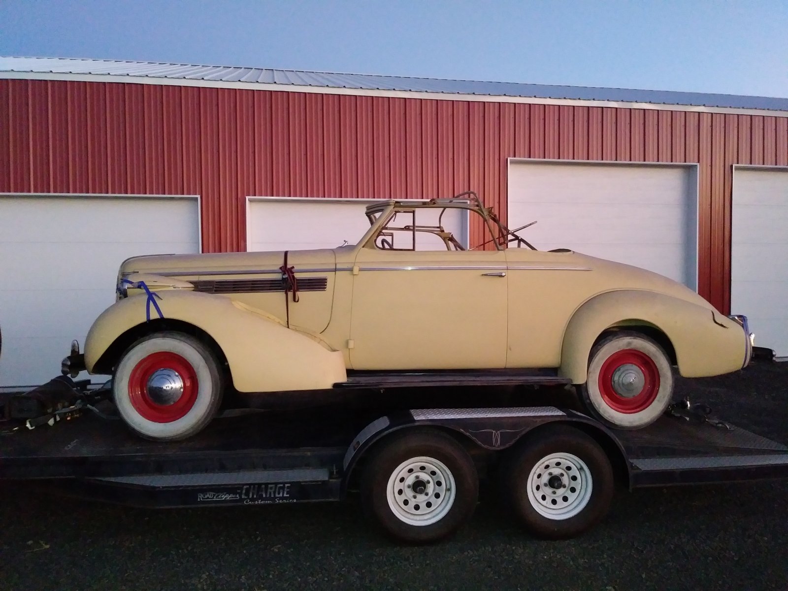

    I finally got it home. Does anyone know if a 38 Buick Special Convertible body would fit on a 37 Buick special coupe frame? wheelbase appears to be the same...
    Just Gary and hidez57 like this.
  20. Nope. That was early 1939s
    Ben
    '28phonebooth likes this.
  21. Probably, but to what end?
    Nice looking car.
    Ben
  22. wildwest
    Joined: Jan 20, 2007
    Posts: 375
    wildwest
    I found a 37 Special Coupe project that has numerous chassis upgrades already done and 37's had factory parallel leaf springs in the back so you don't have to deal with the enclosed driveline/on coils mess. Just curious, another option.
    firstinsteele likes this.
