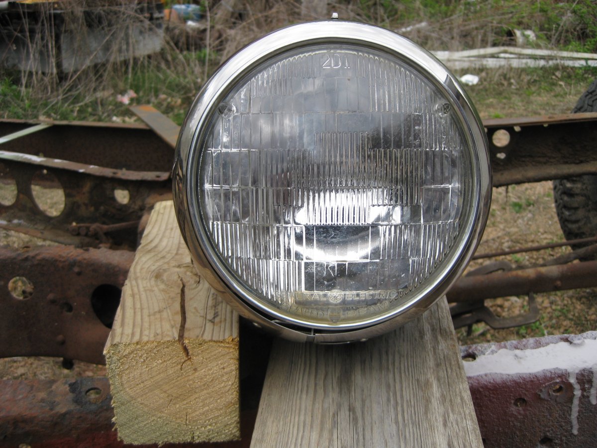

    if you have the 3 notches for the bumps on the bulb to locate into than for sure its been modified. i'm quite sure they are guide made buckets as they made the gm lights in that era. that would mean any guide or blc rim would fit the bucket. however, i just converted a set of 37 pontiac lights to sealed beam by cutting the front lip off a rotten old blc bucket and bolting it on to the face of the 37. that gave me a location for the bulb, and spaced it out towards the front just a smidgion so it looked correct when done. i bought new rims on ebay and they dont fit right, the bracket with the threads to clamp down the rim is incorrectly made. i dont think i have a photo of the conversion, but here's the light, note the gap at the bottom of the bulb in the rim IMG_0463.JPG

    rusty valley
    off the top of my head i would have said yes, however since i do have some "stuff" around here i checked, and no, the chevy bucket is a slightly smaller diameter than a common guide or blc rim. a clever fellow could remove one rivet and shorten the rim by 1/2" or so. maybe some one you know would have a junk rim for you to experiment with, or you can have this one that i stole the bracket from to fix my shitty ebay rims. free, you ship. i think you would want to have one to check the depth before buying new ones IMG_0646.JPG IMG_0647.JPG
