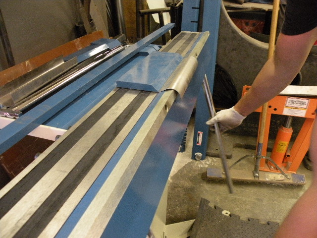

  3. Is residual magnetism an issue with a machine like that? Or does it have a way to demagnetize?
    It looks like it will be real handy for what you guys do around there. It appears that it is capable of bends that a traditional bender can't do.

    I have a confesson to make I am a tool junkie & if I can improve the quality & speed we do projects in then to me it justifys the cost. I will be 65 in a couple of months & dont plan on slowing down on tool buying. As far as the magnatism I have no idea if it will stick with the part or because it is such a short time amount it won't do a thing. I will let you know if tools start flying across the shop & sticking to the new panels.

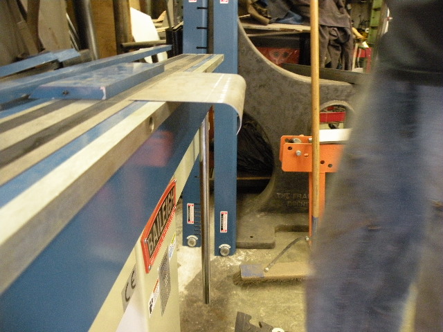

  7. carbuilder
    Joined: Nov 21, 2006
    Posts: 982
    carbuilder

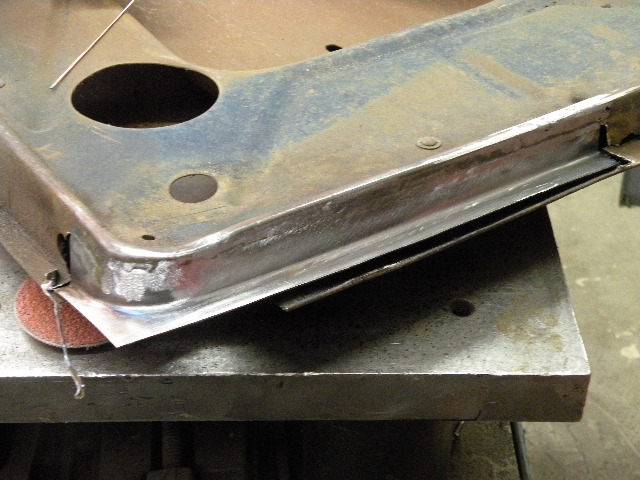

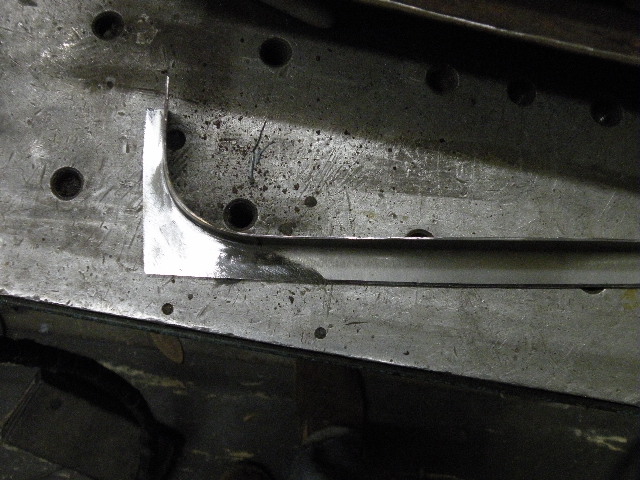

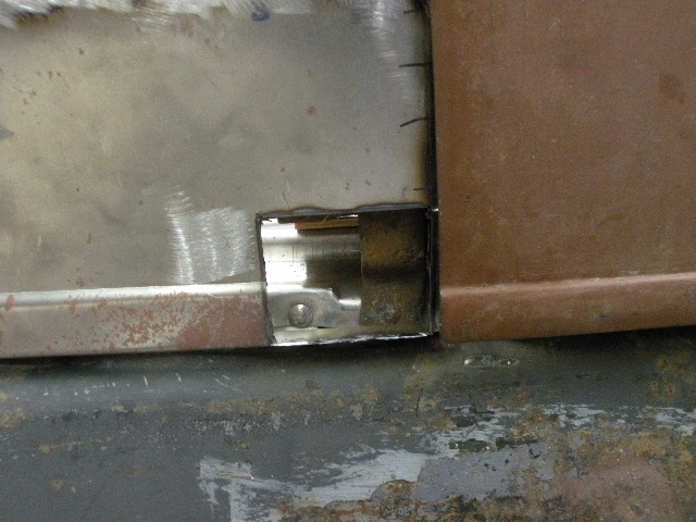

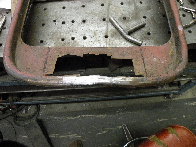

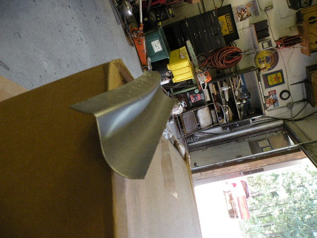

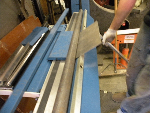

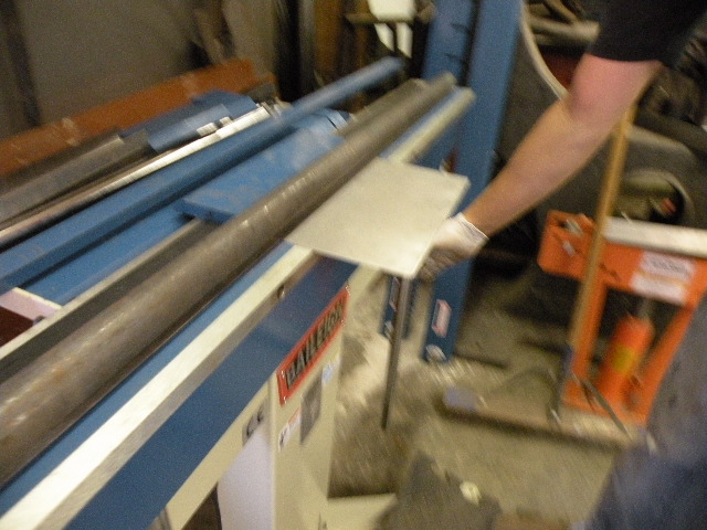

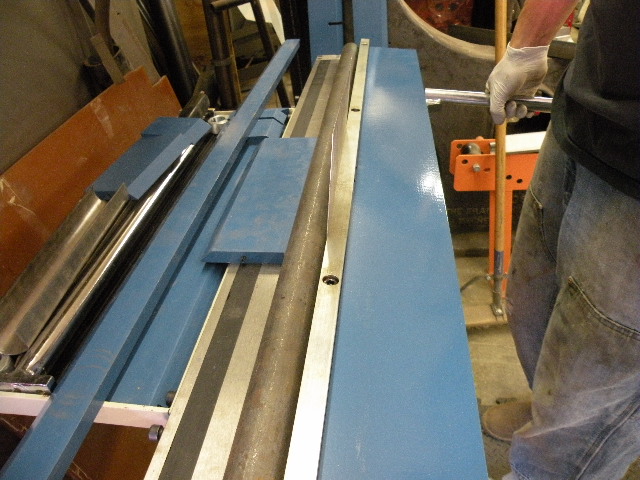

    Max did a little patch on the 30 Roadster & the piece was Made with the Baileigh Magnetic bender.
    Nothing coplicated but pieces need to be made & installed.
    Now it is a short play time.
    We were not trying to make any thing for a project, just took 5 minutes to try some ideas. This was 18 gage steel which is what we use the most of.

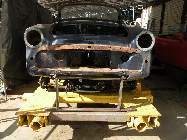

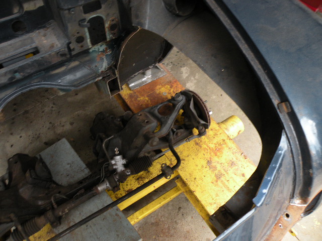

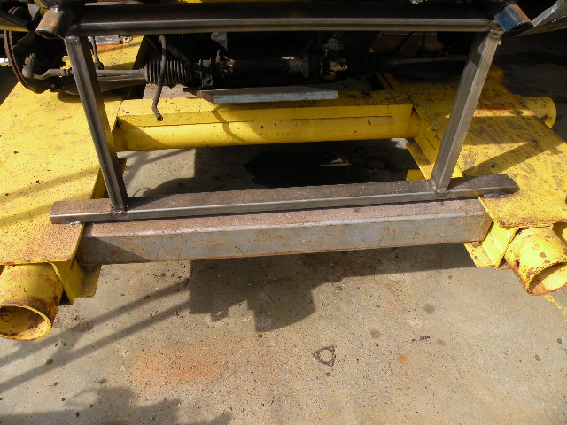

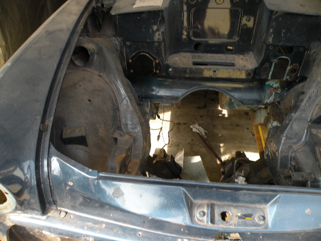

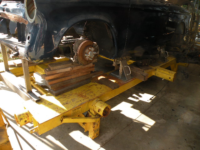

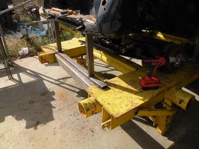

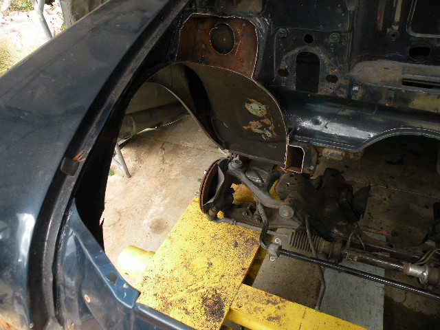

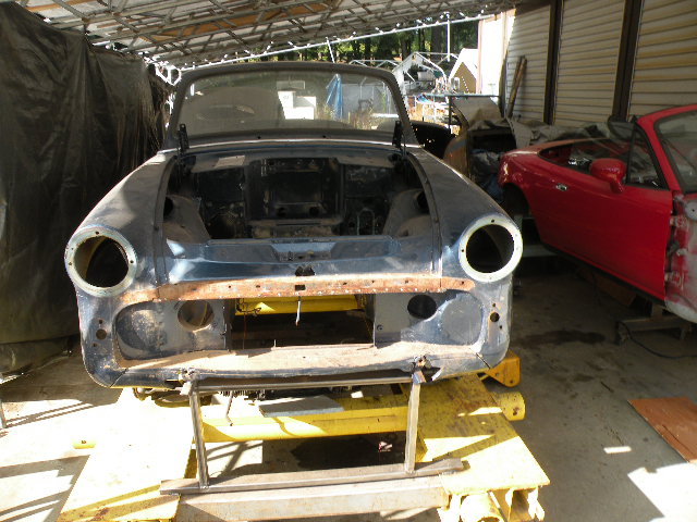

    I finished stripping the front of the Hillman down & made a front support welded to the frame table. then i can cut out all the old inner structure getting ready for making the new sub frame assembley to bolt the Miata front suspension in.
    This is going to be fun.

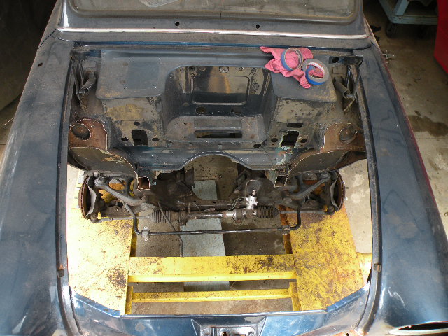

  10. carbuilder
    Posts: 982
    carbuilder

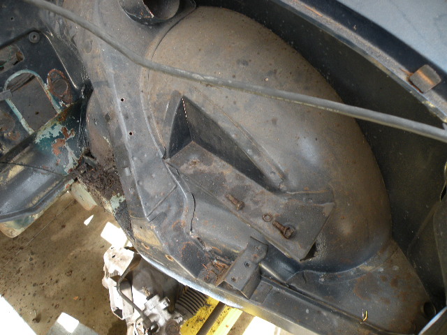

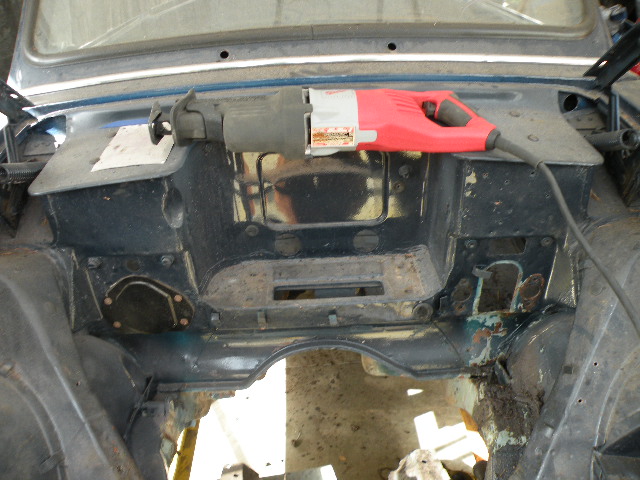

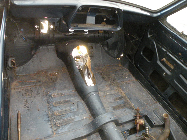

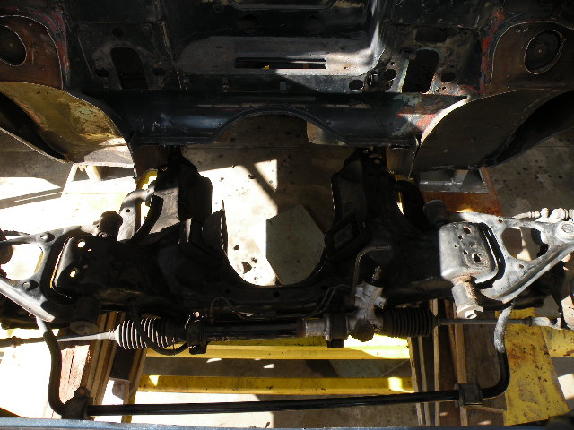

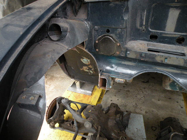

    A little front end surgery for the Hillman
    The tool of choice.
    Before & now the cutting begins.
    No turning back now.
    I will do a little more trimming then on to the next part.

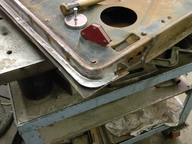

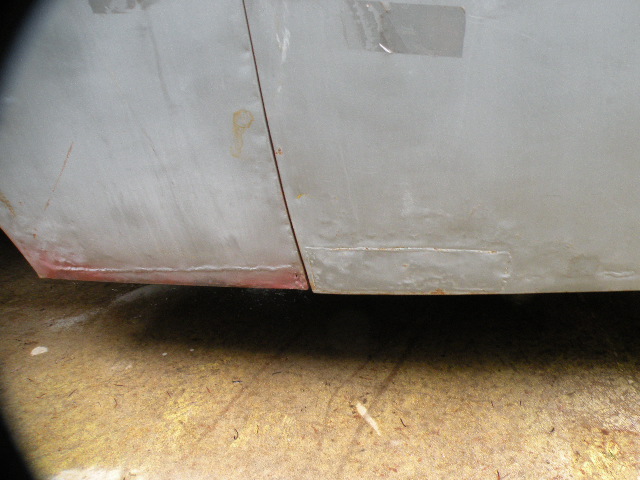

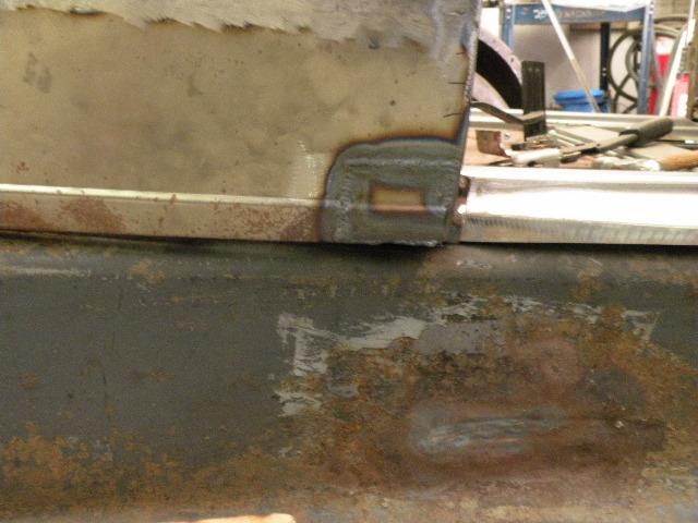

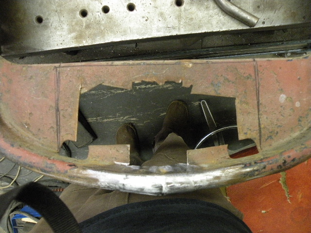

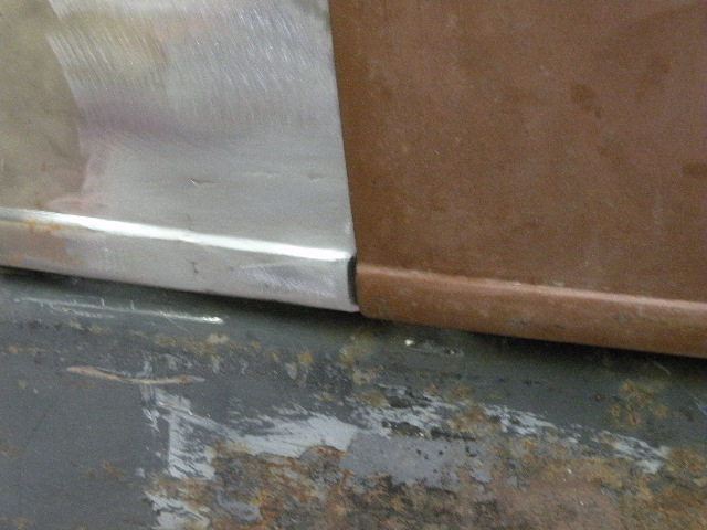

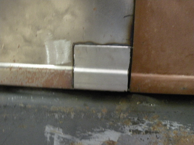

    Max did some repairs on the left door.
    More later.
  12. oldman2
    Joined: Sep 9, 2010
    Posts: 2,373
    oldman2
    Well you have a hole now to fit the front suspension(ha ha), can't wait to see more. Than is some great repair work to the bottom of the door, nice job...Jim
  13. carbuilder
    Posts: 982
    carbuilder
    Jim its just a little hole to fill with a larger then stock motor, more cutting today.

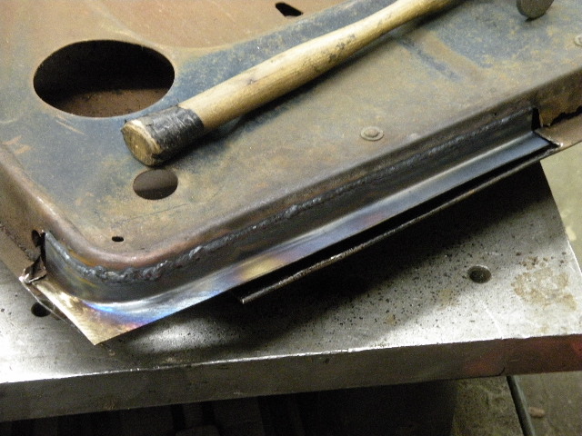

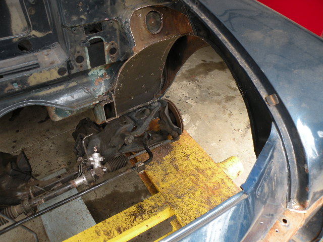

  14. carbuilder
    Posts: 982
    carbuilder

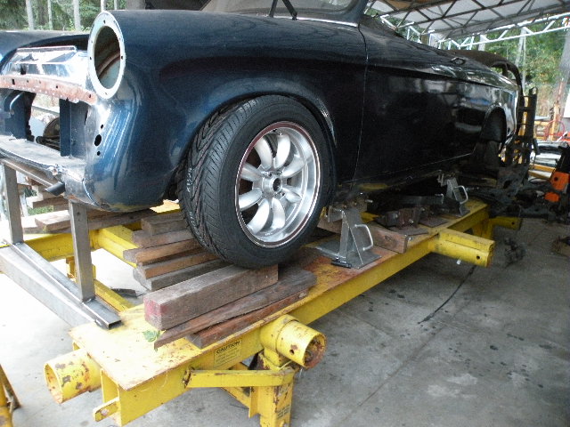

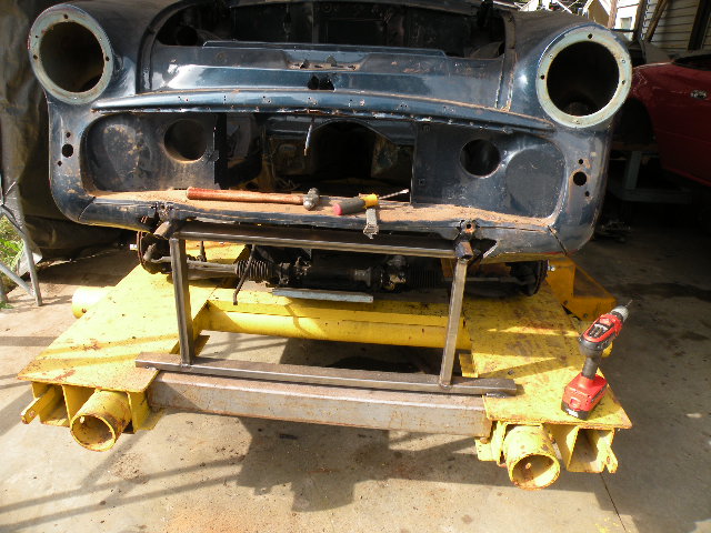

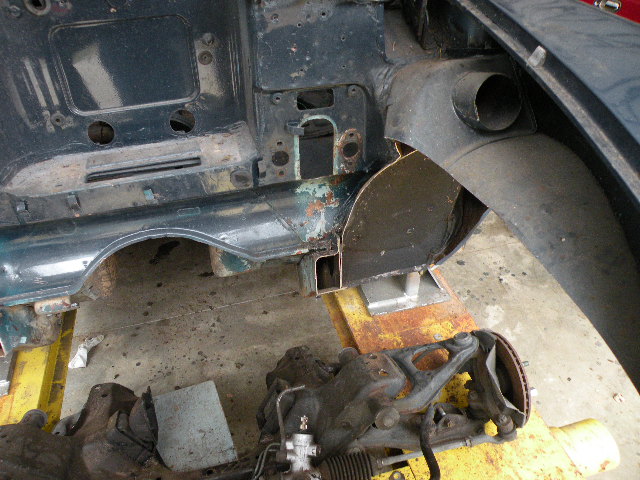

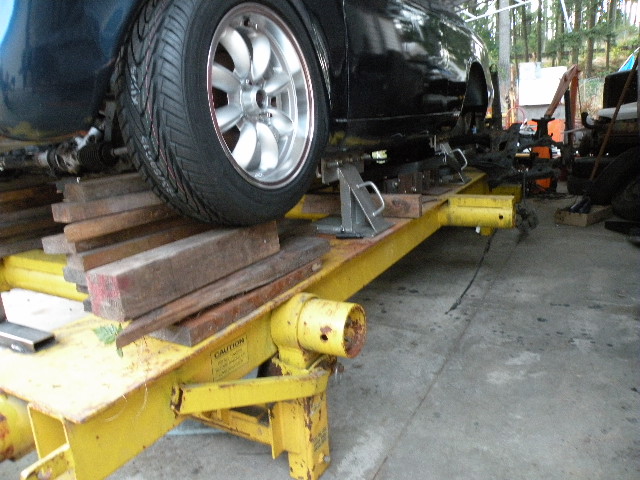

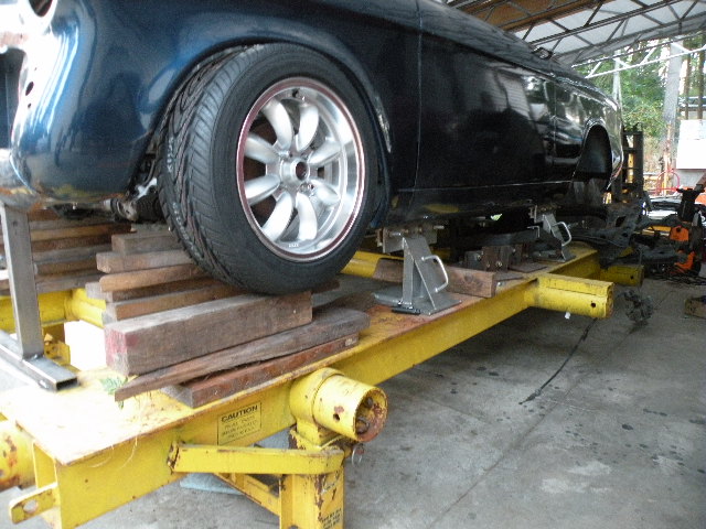

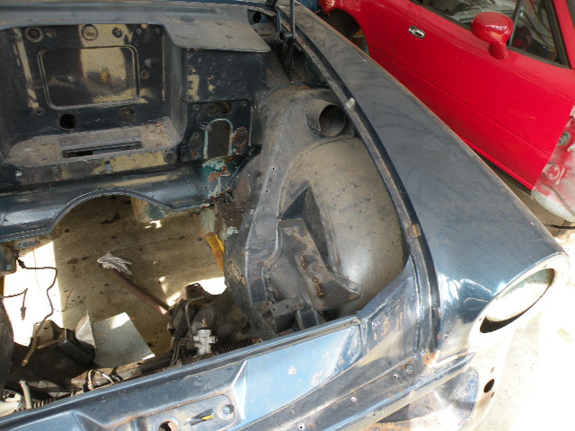

    I pretty well finished trimming the old wheel wells out for now.
    Then I just rough blocked up the front suspension to approx ride height approx to start 4 inches from the bottom of the rocker front to the ground.
    Then I put on a front tire to see how it would sit.
    Ride height looks pretty close for starters & the wheel lip will need some reworking. A little more triming then on to the rear set up.

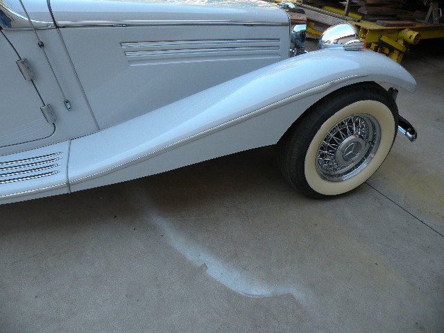

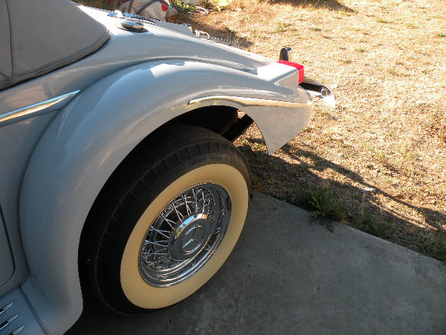

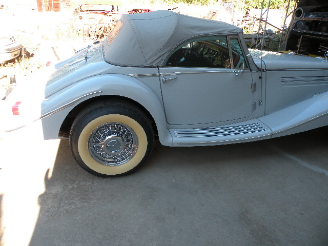

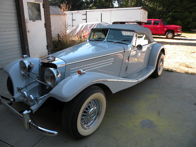

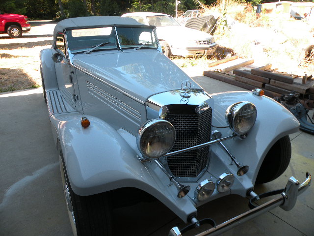

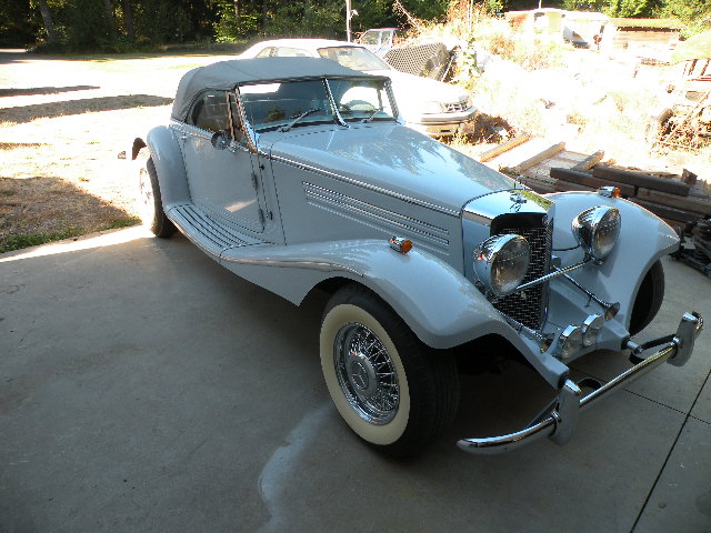

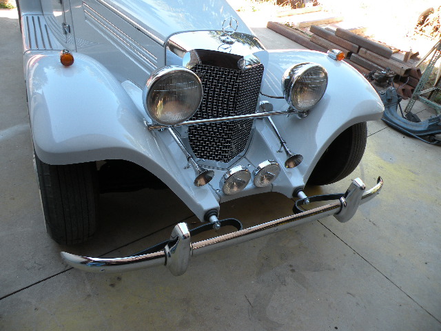

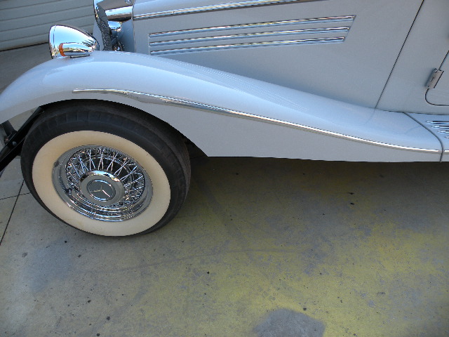

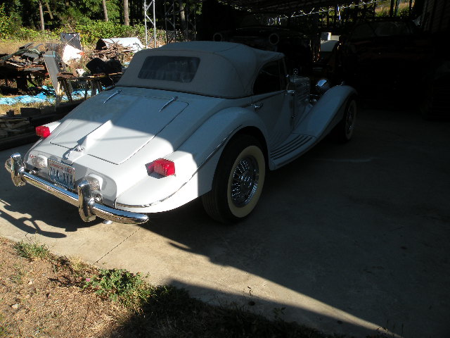

    I have been approached by a lady who is the new owner of a fiberglass kit car & she would like the plastic trim with the chrome comming off replaced with new custom made stainless and a few other up grade to make it a nice driver for her. It has air bag suspension already. The trim is not straight & varies in width so I am looking for ideas on how to make it. I realize the car is not real H.A.M.B. friendly but making custom stainless trim would sure a H.A.M.B. proscess for some. This is the project.
    So any thoughts or ideas I am looking at some 24 gauge 304 stainless real close thickness to what was used on cars fron the 50's & 60's. The longest piece is 52 inches.

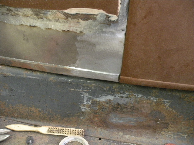

    The owner supplied the hinges for the 30 roadster then Max had to rework them & the door for every thing to open & close smothly

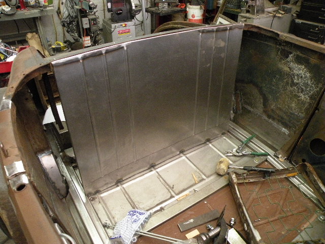

  21. carbuilder
    Posts: 982
    carbuilder

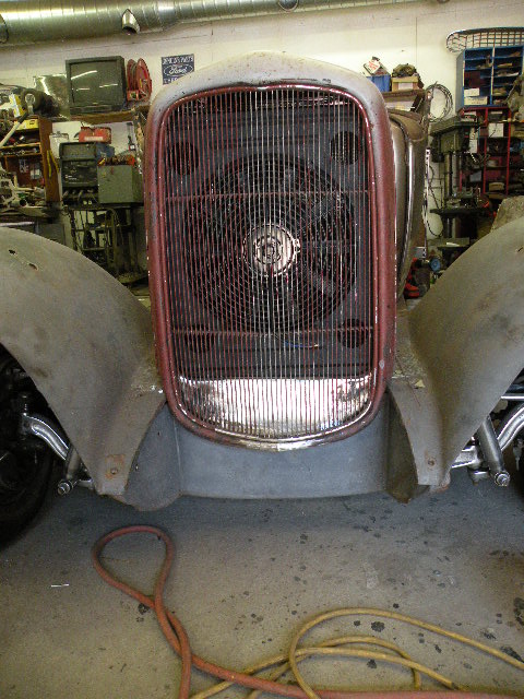

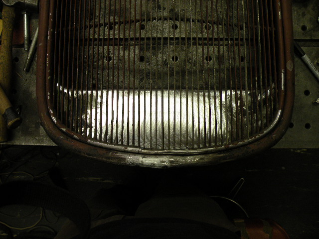

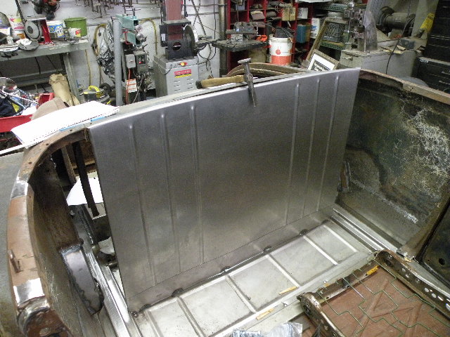

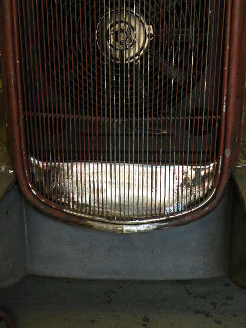

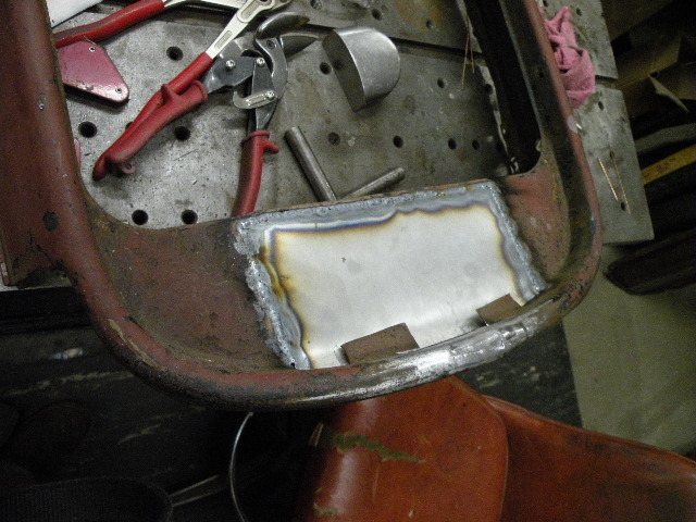

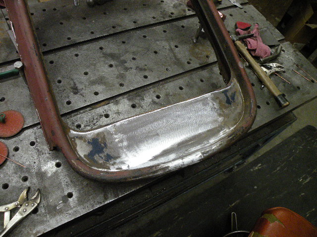

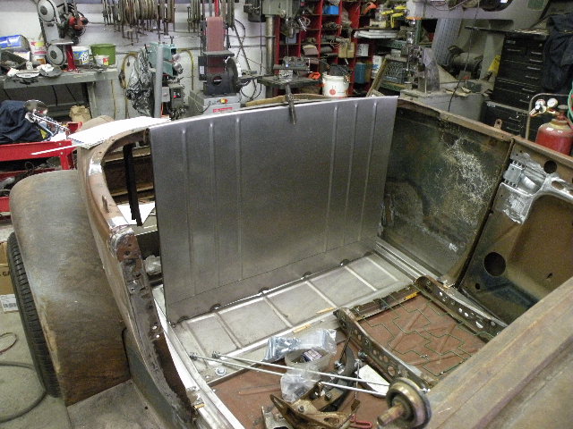

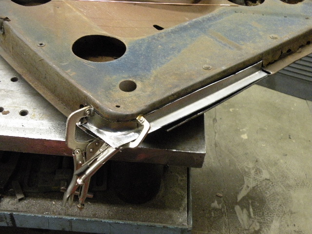

    Max built a rear seperator for the roadster.
    Then he moved on the repairing the Henry 32 grill shell.
    We are coming close to the end of this project as the owner is about out of $$ but there is a little more to be done before it leaves.
  22. oldman2
    Joined: Sep 9, 2010
    Posts: 2,373
    oldman2
    Nice repair on the grill shell....Jim

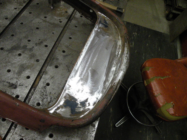

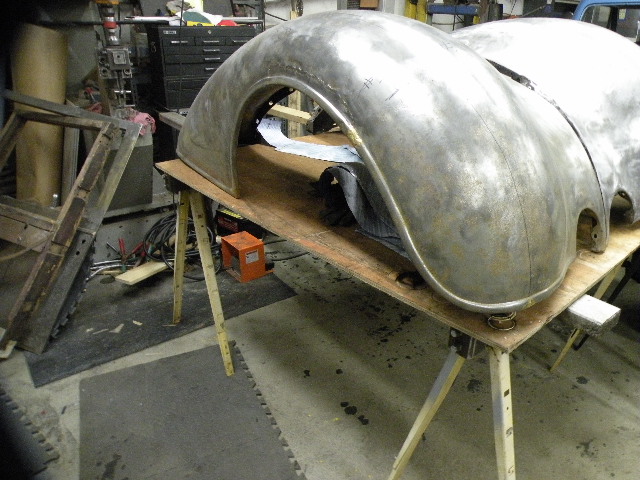

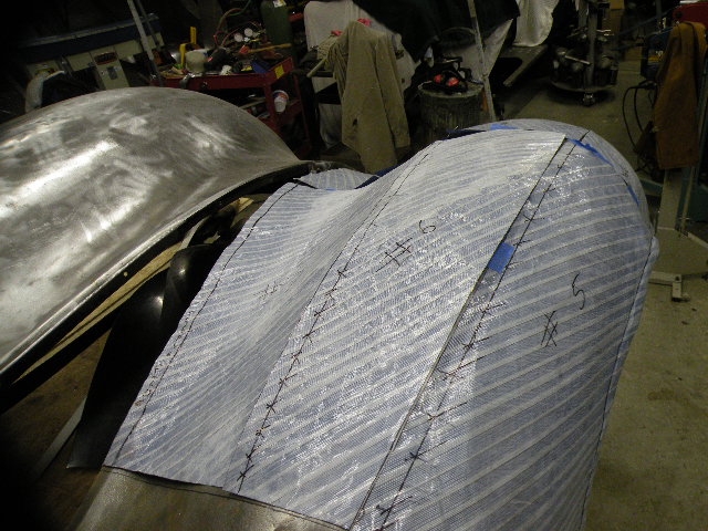

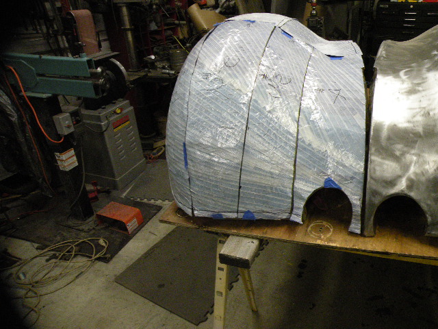

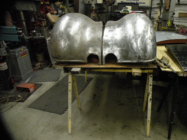

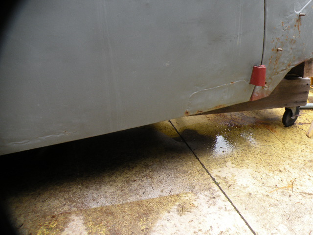

    To start things of the 36 Chev front fenders are very thin from previous repairs & very holey and we could not find real decent repaiable replacements so new ones will be made. After stripping & some banging around they actualy look semi repairable but paper thin all over.
    Just a small section looking from the inside out.
    I made some tape pattern templates for the front half to start.
    I will be using the correct thickness 19gage AkDQ steel just like Chev did.

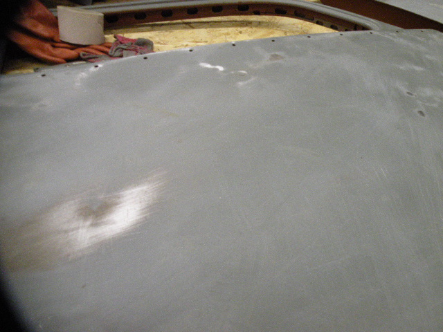

  30. carbuilder
    Posts: 982
    carbuilder

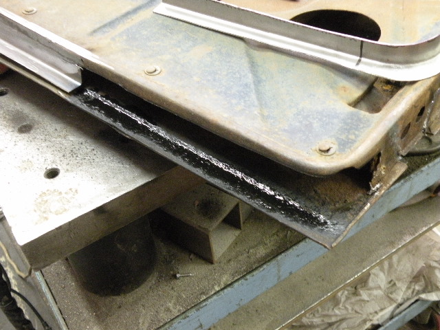

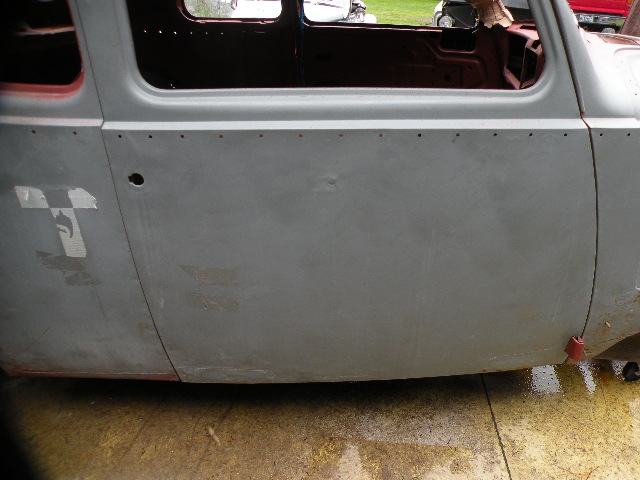

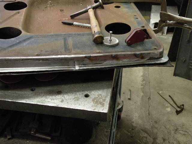

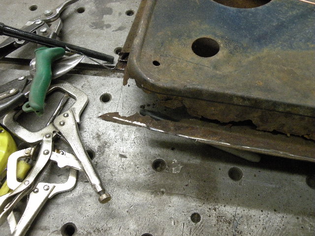

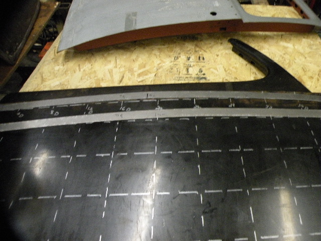

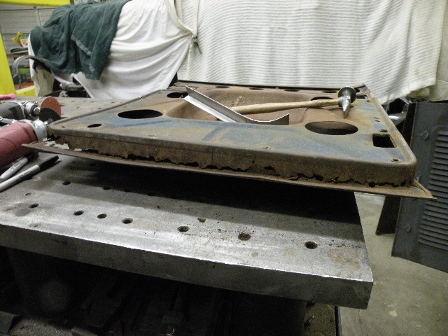

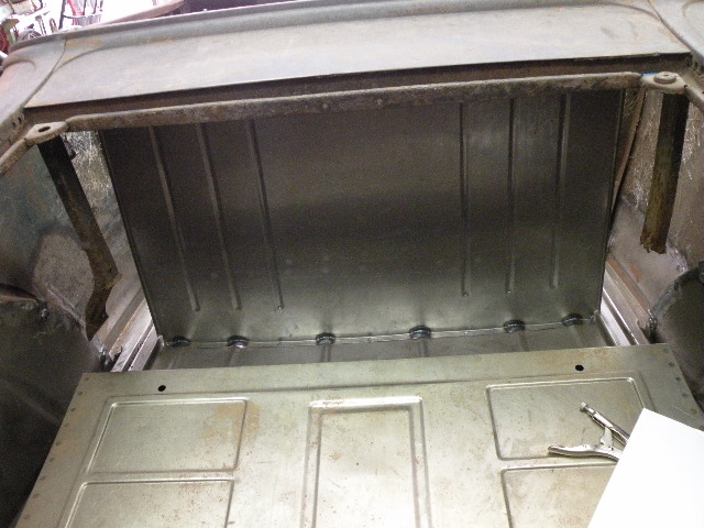

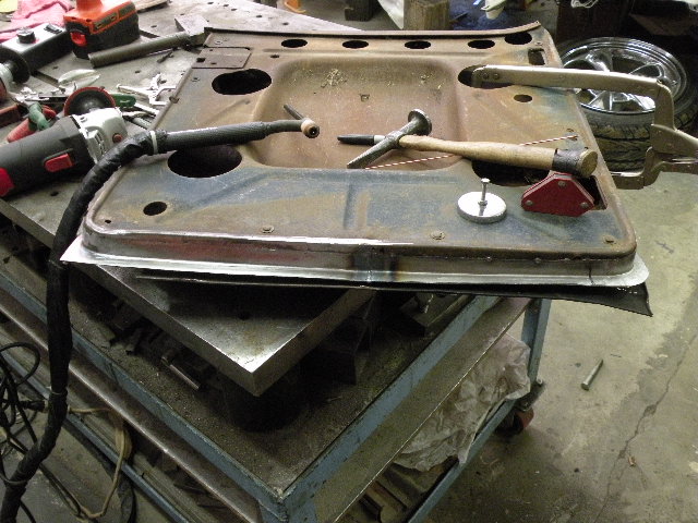

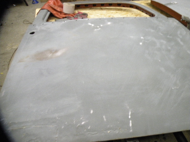

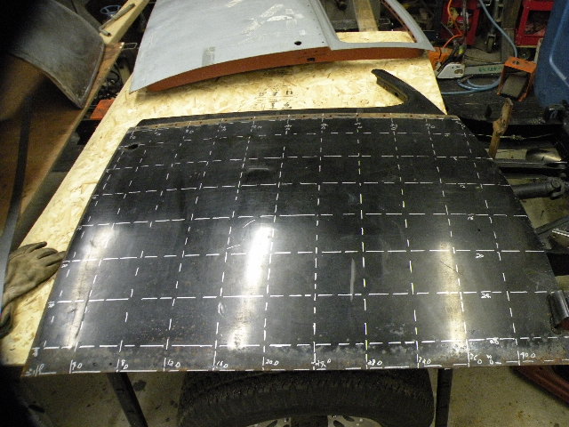

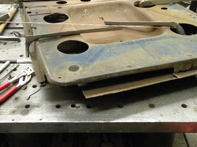

    I also will be rebuilding & converting a 41 Packard 110 coupe into a convertible Packard correct type rebody build. First I will start with the doors the passenger side will need a skin from the belt line down due to badly repaired rust out or damage & un repaired damage. This is to be a first quality redo so no cutting corners or over abundance of contour shapping material. I also have a 41 Packard convertible here for restoration after the coupe conversion and to use for patterns.
    I did some light 80 grit sanding to bring out some of the highs & lows plus show the un repaired damage.

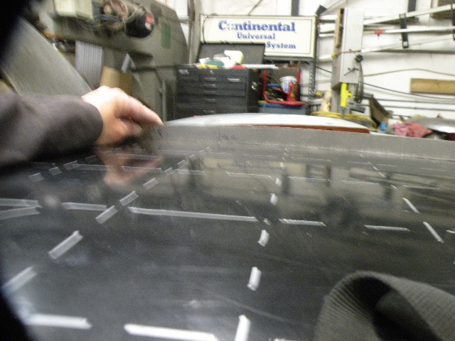

    This is the right convertible door I made a grid on so I can replicate the correct contour.

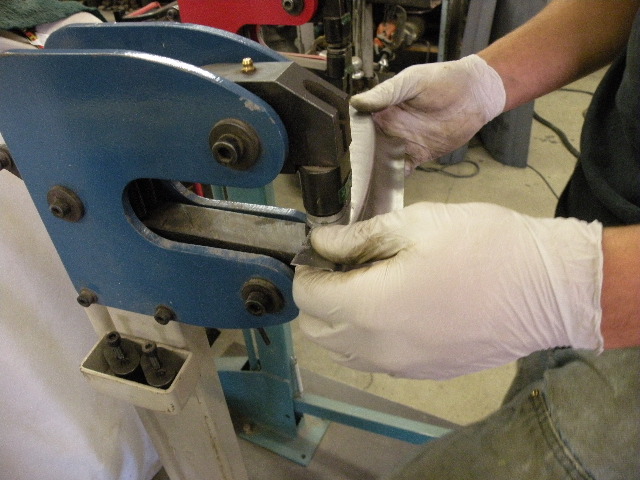

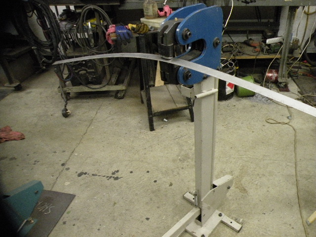

    I started making contour gages to make sure the new skin & any repairs to the drivers door have the correct contours.
    Its hard some times holding the camera & a part when you are working alone.
    I used the Baileigh foot shrinker stretcher to shape the gages & will need to make several more as the shape changes from top to bottom suttley.
    Thats it for the packard for today more to come.
