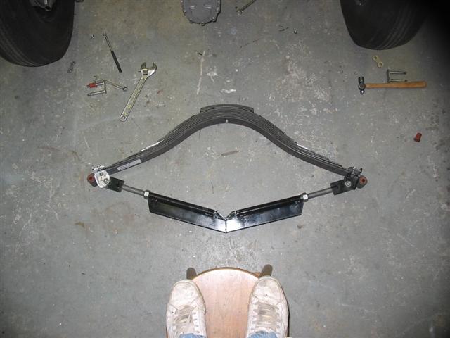

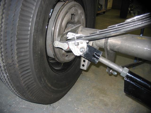

  7. I built one like this, it bolts on to the ends of the spring, and can be used with a stock or reversed eye spring. It is very strong and works great.
    HemiDeuce.
