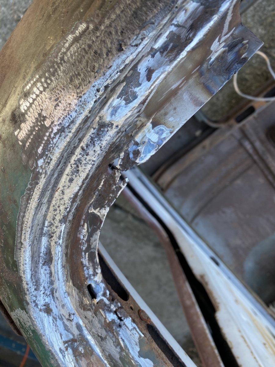

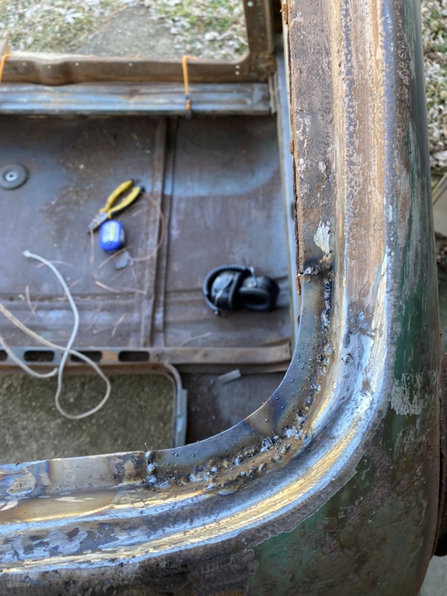

    I know you are young, and youngsters are always in a hurry, but here's a little unsolicited advice from an old guy: Sandblast the metal BEFORE you weld to it.
    So you go through a bunch of work to find the rust holes, make a patch, weld it in, and then grind it smooth. And then you are going to try to clean all the rest of the remaining rust off the area. But rust is sneaky, and what looked like solid metal right next to that just-fixed hole will show up as more pinholes. I guess time for another patch.
    And, welding on clean metal is SOOO much easier than welding rusty metal. Your welds would look smooth, not like bubble gum. Or are you using a flux core welder?

    i have to agree, clean where you are going to weld, even a little with a sander disc will help to make it easier to weld and pleasant to look at. i do appreciate all the effort to fix up the old gal, keep it up. and, generators are a dime a dozen, find one that has not been sitting in the ocean

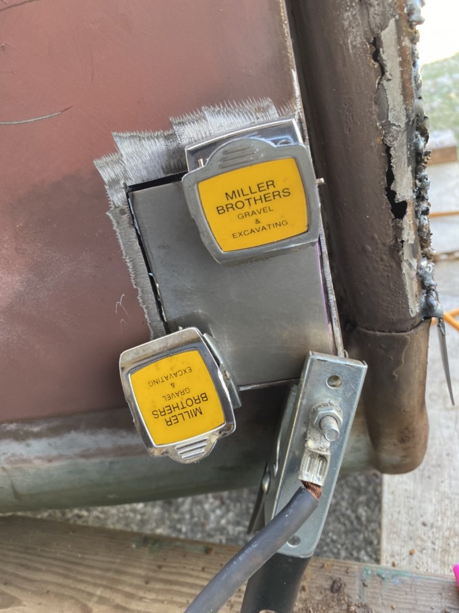

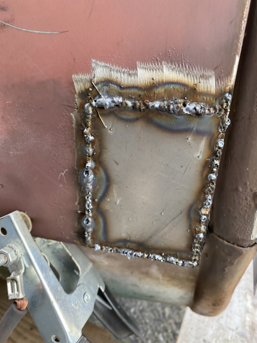

  20. Here is all the welding after grinding it down
    IMG_1019.JPG [​IMG]
    ...and here are the imperfections that will need attention

    For the passenger door I brushed what I could reach and just sprayed a rust stopping paint up into the door. After all this welding is finished on the cab I plan to spray the whole inside that will not receive actual paint with rust protection .

    What type of welder are you using?
    Not wanting to be critical but all that slag shouldn't be on there.. If you could find what is causing that and get some decent beads laid down it would be much more fulfilling. Does anyone live nearby that is a proficient welder and could give you some tips?
    Good progress being made, though.

    Practice makes perfect, but try to learn a bit each time you patch in a piece. Welding on rusty steel will never turn out well. Welding outside with a MIG welder and gas can be challenging if that is what you are using. I'm learning as well, but patience and prep is key to welding. Keep up the good work.

  27. I’m using a MIG welder. Can you explain what you mean by slag? I understand I’m not the best welder but really just trying to get better and it seems I’m not with all the replys. I know a few welders and actually some friends of mine going to a career technology school for welding. I’ll ask around to see if I can get some help. I’m getting to the point of wrapping up on the Cab so most of it will be on other parts like the Grill and Fenders

  29. I’ve set the welder to the right settings based on the gauge of the metal and the wire I’m using but still often find myself blowing through the metal which is creating many issues, any suggestions? I’ve tried to just do many spot welds (the recent corner of the door was done doing this if you wanna see how that turned out) and I didn’t blow through once just took way longer.
    This is when I spot welded to prevent blow through. Do you think it’s just blowing through because a lot of the metal is rust damaged and thin?
