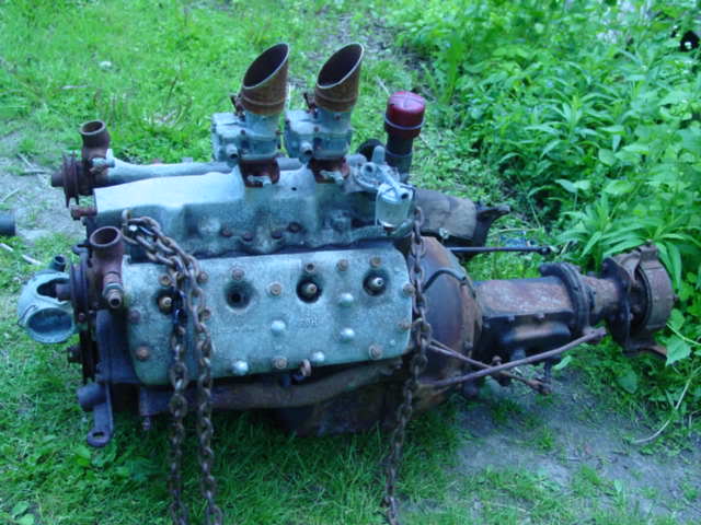

    Here's a picture of a '36 flathead for you. What make are you looking for?
