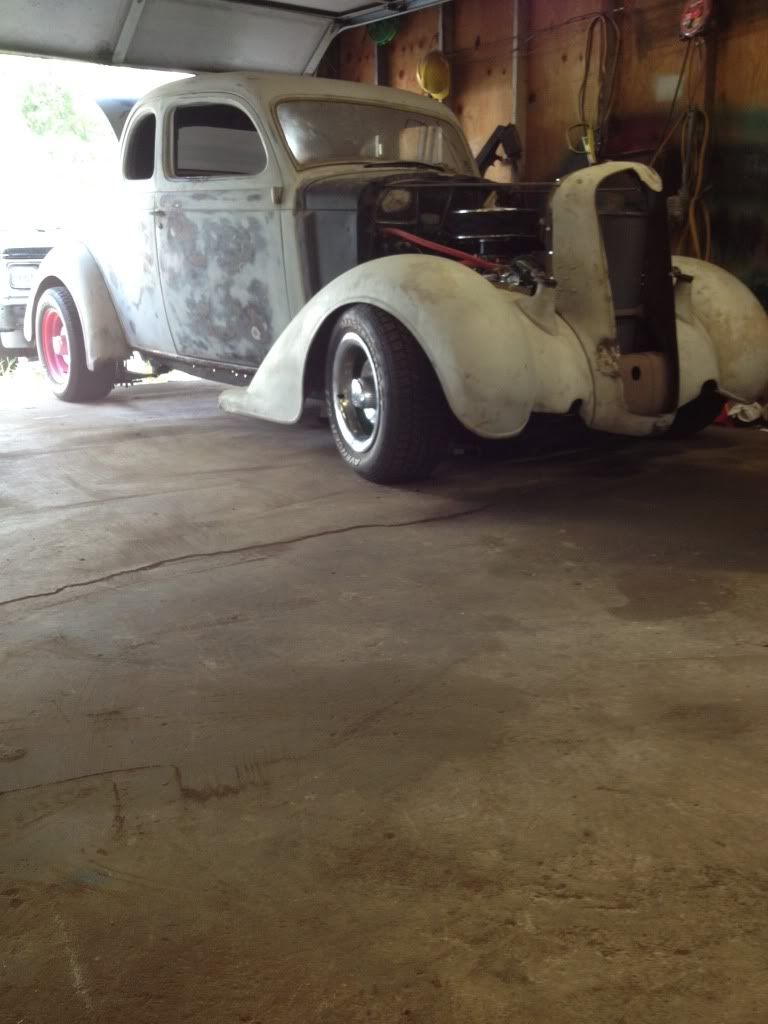

    I am new to this site, but I have a 36 plymouth that I am building. Here it is
    I still need a few hard to find pieces for it... I am missing the rear window garnish moulding and havent found one yet.. lol Thought I would poste a couple pictures of my build for ya guys.

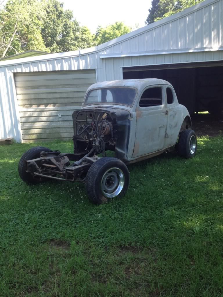

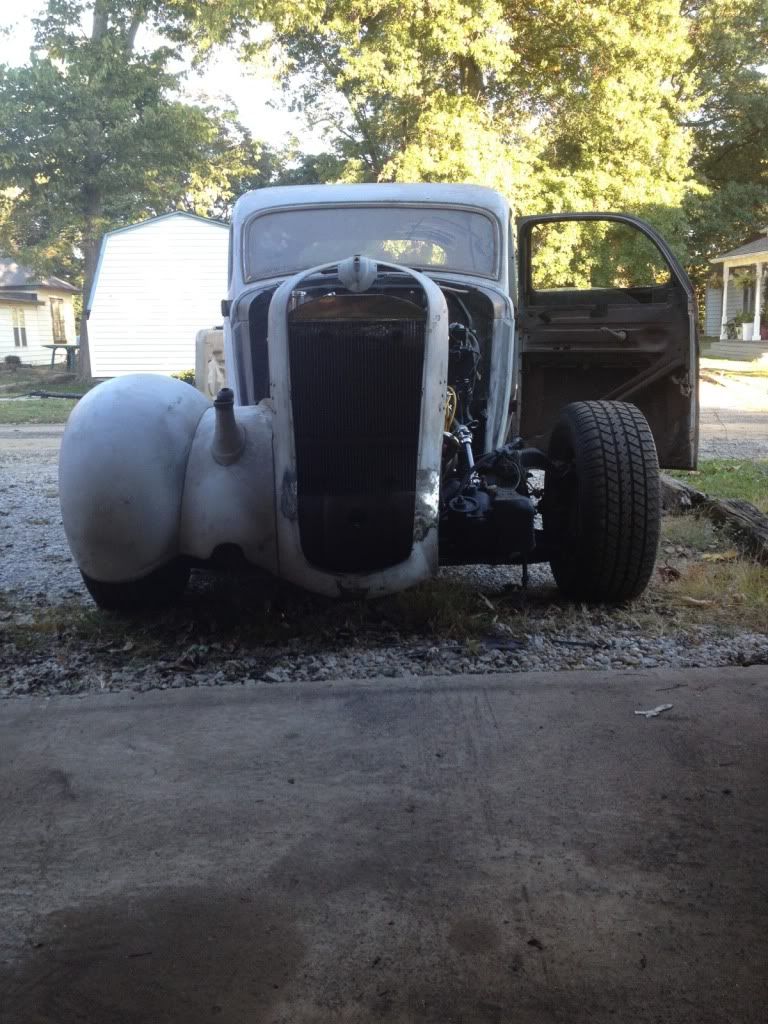

    I just purchased a 1936 Plymouth 5 window without a front clip.
    Do the 1935 Plymouth front fenders fit a 36? ImageUploadedByH.A.M.B.1439909057.189479.jpg

    Edit.. I think the 35 grill shell is more rounded. The grill itself has a square pattern instead of vertical grill like my 36. Search the Plymouth owners club. They would have more details on the measurements.
    I think the trim on sides is different too. It's like 5 circles with lines through it.
    I've got my 36 up for sale for 2900.00 in Phoenix AZ. My front clip is straight and complete. Well the grill needs a little love. Not parting it out unfortunately. It's a sedan, but I think the front clips were interchangeable on 36's but don't quote me on that. :)

    The 35 Fenders are different as they don't have the bead around the edges like the 36. Hoods and grills are also different as noted previously. As far as interchanging with 36 Dodges, the 36 Plymouth has a 113" wheel base, and the 36 Dodge has 116". The bodies are the same (other than trim and dash), so the length difference is in the nose, so sheetmetal won't interchange. The good news is that the runningboards do interchange. It's too bad you're so far away, as I have lots of parts for the 36's. Hope that helps, Bob

    When i bought mine it came with fiberglass fenders. Someone is doing them. If that doesn't bother you.

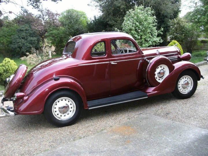

    Here's my old 36. CKD car built in Australia by T J Richards and son. 3 spare wheels on it. Here in the UK now. I was the second owner in the UK and got her roadworthy. Wanted to put a baby red ram in but to good to straight. Had a few owners since sold.

    No opening front screen or side vents was only drawback.

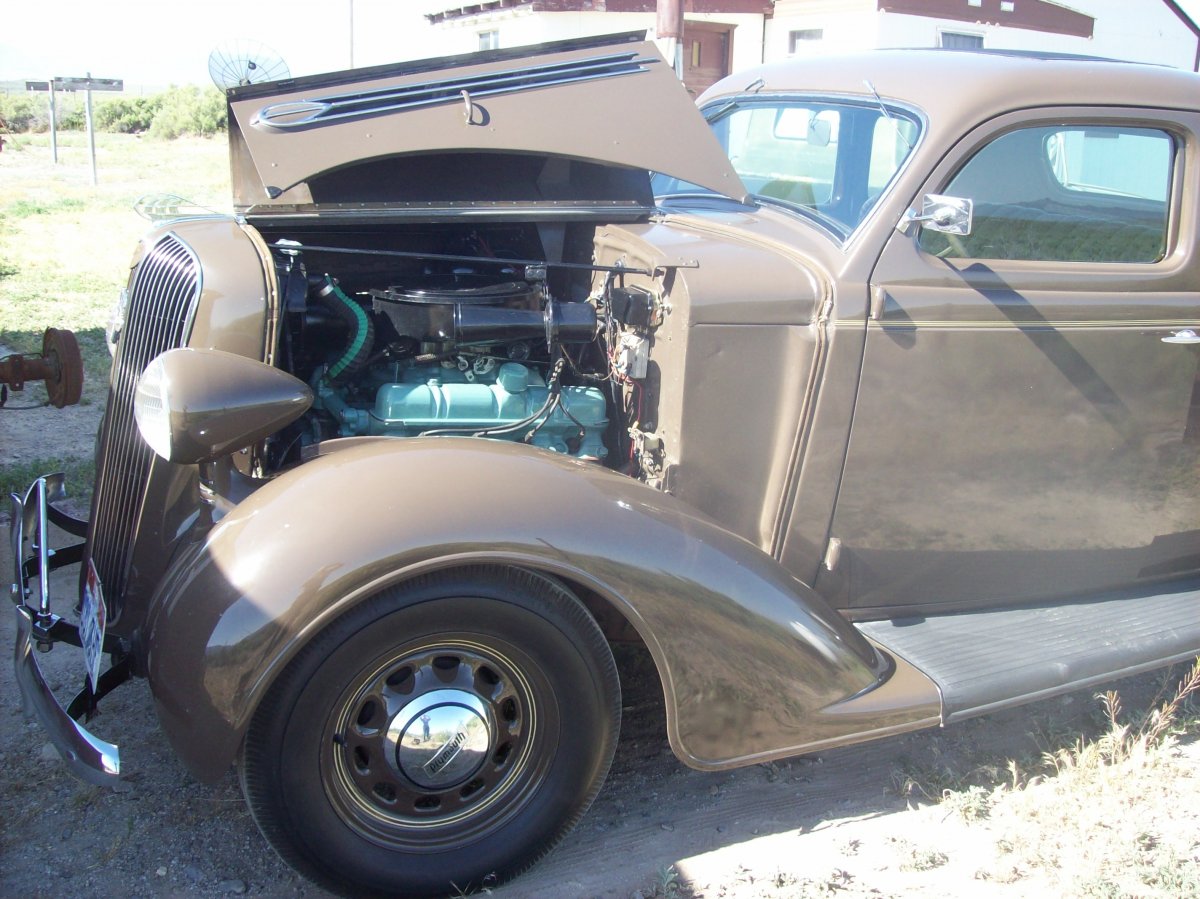

    Here are a few pics of my '36 which I purchased in
    1963. Since '65 it has been powered by a 401 'Nailhead' Buick.
