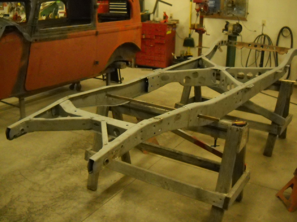

  10. So the frame had this huge ugly X member for the factory IFS....that had to go.
    I had a Hudson frame laying around, so I lopped off the front and grafted it on.
    Fits surprisingly well!

  12. I fish plated and fully boxed the frame where the 2 parts meet, then welded up dozens of extra holes.
    Still more welding and grinding to do.
    For the front suspension I'm using the Hudson axle on parallel leaves. This axle is the Elliot type and really cool looking.
    Front springs are model A type with a couple leaves removed.
    I was lucky to score an NOS kingpin set for this axle off Ebay.

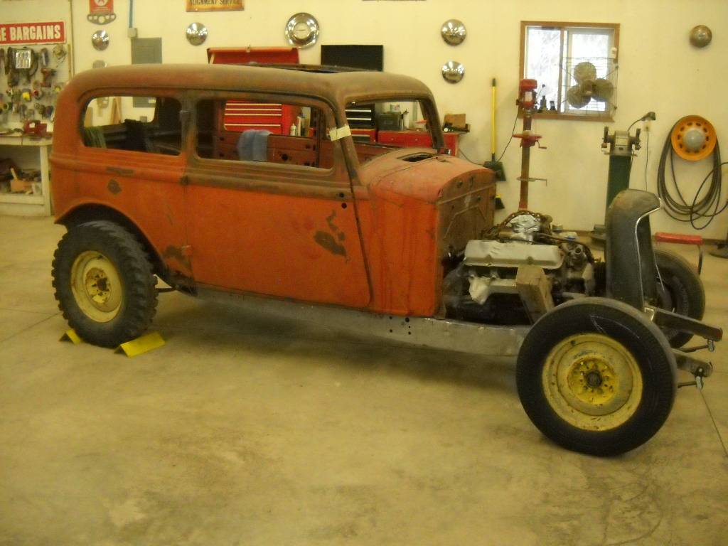

  18. The car looked pretty good on 4 wheels, but not quite there yet. Since the floors were rusty and weak I decided to channel it a bit.
    Only about 2", as I didn't want to upset the proportions. Still may chop the roof, but gonna wait til the car is together a bit more and see how it looks.
    After channeling......much better!

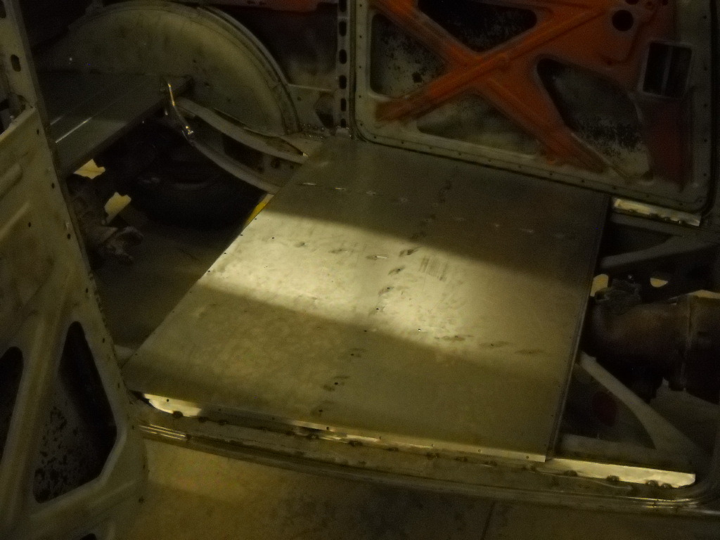

  20. So this is where I am now... I blasted the body, found a bunch more rust in the rockers/door jambs. Got that all rebuilt, now working on the floors.
  21. I finished up the floor from the shifter back, still need to do the front area with toe board and trans tunnel area.
    Did some junkyard shopping.....found a nice seat from a Chrysler mini van. Also grabbed some pedals from a '67 Chevy PU and have those pretty much sorted.
