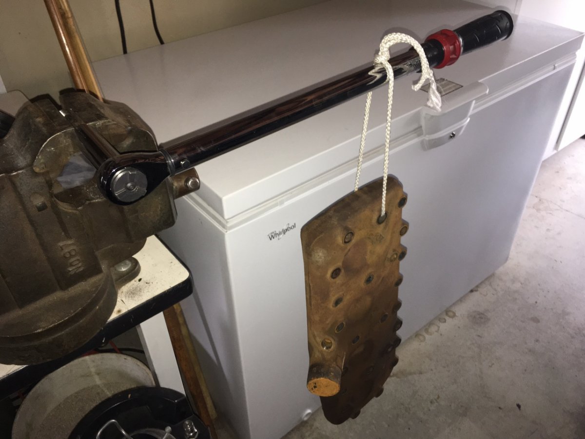

    Checked my torque wrench today. Hung one of the cast iron heads 12” from the center of the socket. Adjusted until I just heard a click. The wrench read 27 pounds. Took the head upstairs and weighed it on the bathroom scale...27.4 pounds. I’d say that’s close enough. I’ll hang both heads on it for a higher measurement next. IMG_0726.JPG

    That's a cool way to check the TQ wrench. Maybe the head had a casting flaw?

  23. Neat trick. It got me thinking, that I have some barbell weights that I can use to do the same thing, and on the next occasion when I have to use my torque wrench, I am going to do the same thing. I have a balance beam scale I can use to check if the weights are accurate.
