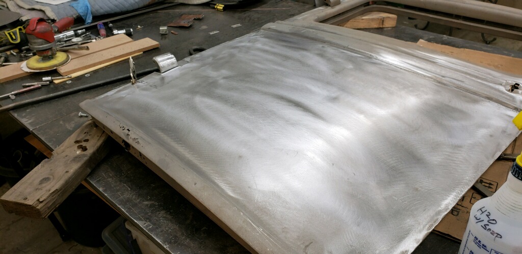

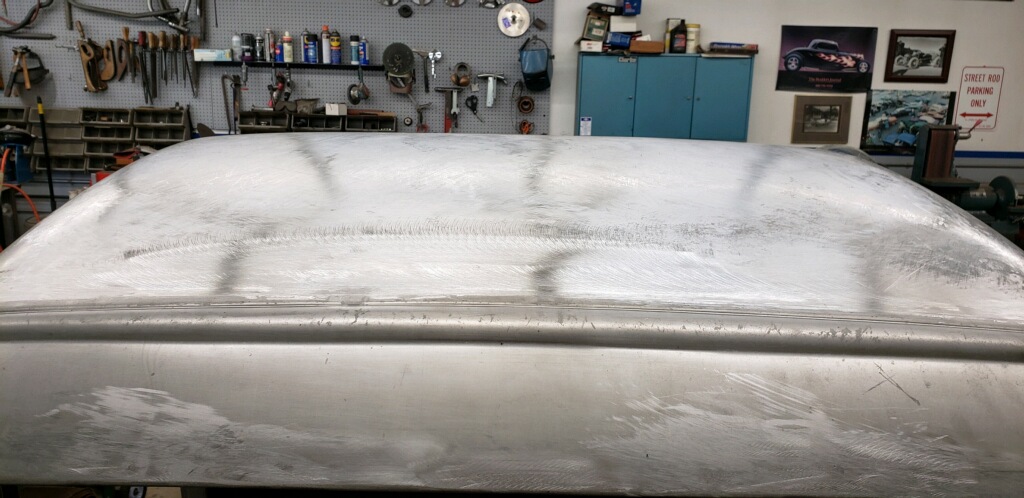

    Straightening out the roof was the first order of business on the cab. Sorry I didn't take any before pictures but it had all the typical dents. cab roof finish 2.jpg cab finished roof 1.jpg imagejpeg_0(72).jpg

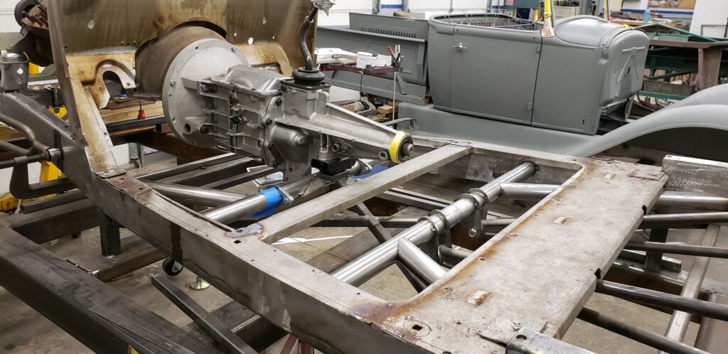

    With the Winters QC in place we welded in the motor mounts and set the flathead and T5 in place. my truck chassis 7.jpg my truck chassis with motor.jpg my truck chassis with motor 2.jpg

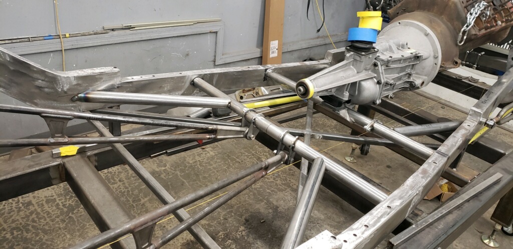

    With the engine and rear end located it was time to tie everything together.

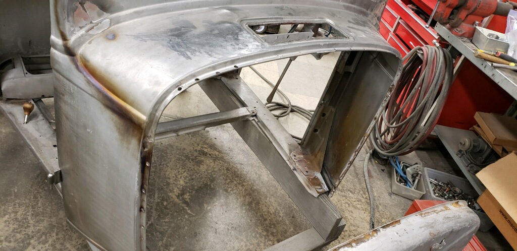

    Normally the front end would be next but because I want to run a suicide front end we decided to get the cab into position first, see what everything looked like, and then position the grill and axle. Channeling the cab was the first step and we decided to remove the firewall, section it, and mount it to the frame. It turned out that 2" could be removed from the area above the original forward cab mounts. The other 4 inches had to be sectioned out of the middle of the firewall.

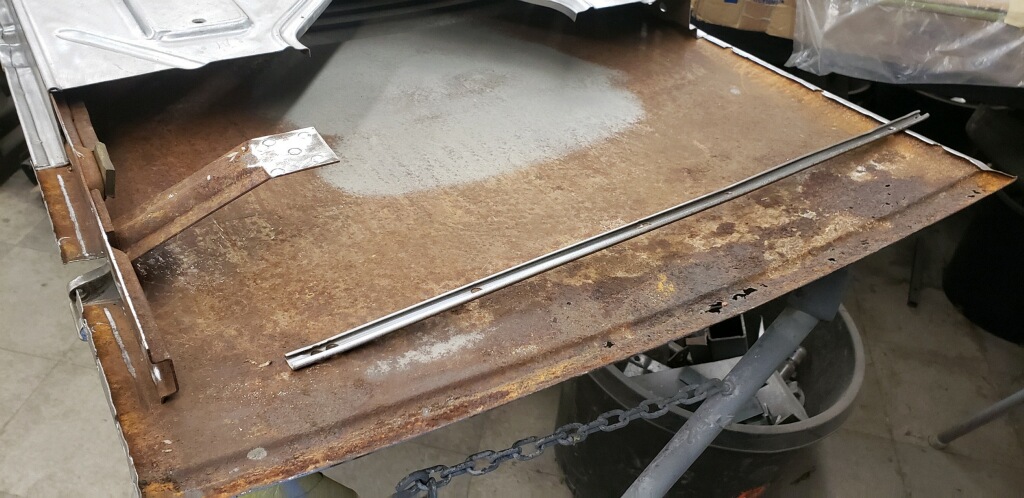

    With the firewall roughly in place the floor was cut out of the cab following the shape of the frame rails and mounted to the chassis.

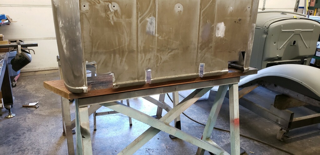

    Channeling the cab created its share of details to be addressed. Starting with rear panel. The panel was first notched to get the cab on the chassis, then the lower bead detail had to be moved up 2" to meet the original floor pan. imagejpeg_0(22).jpg cab channel detail rear corner.jpg cab rear panel template 2.jpg 20200603_114930_resized.jpg

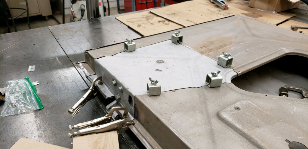

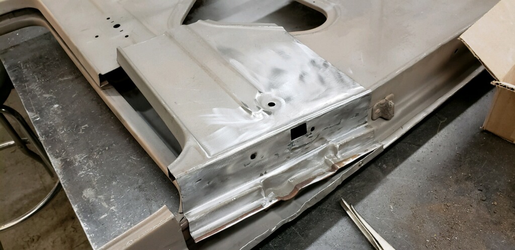

    More cab channel details. This time tying the floor and cab back together.

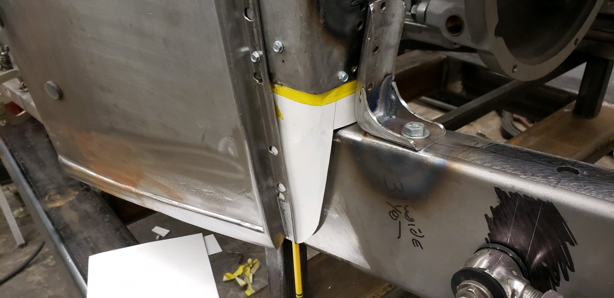

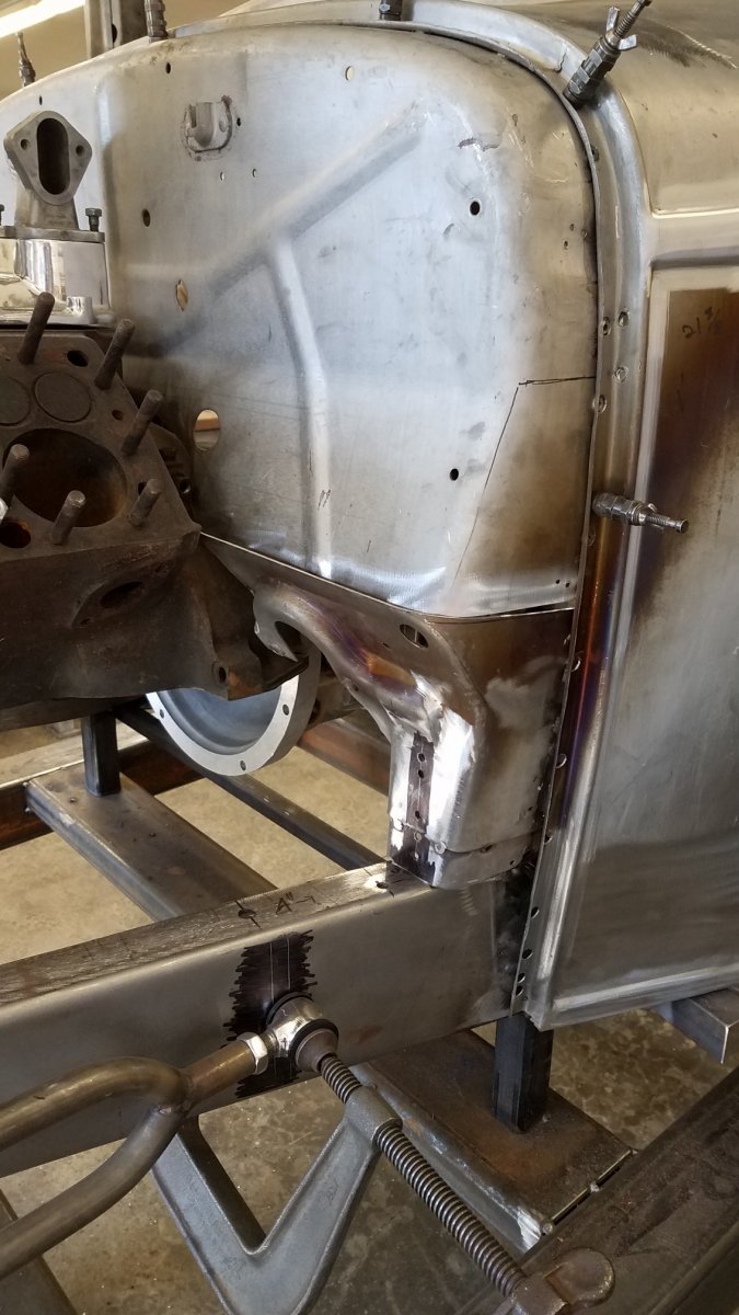

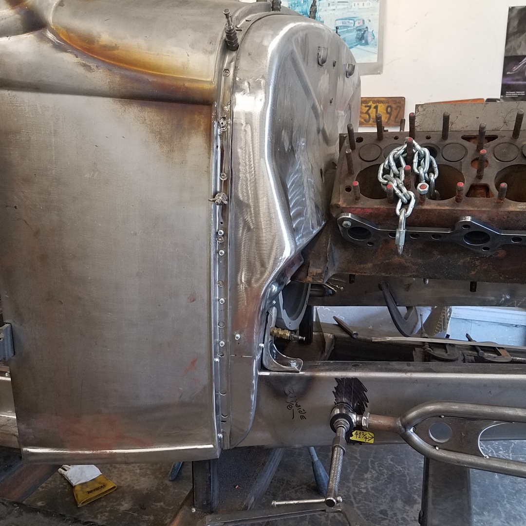

    Moving to the front again it was time to tackle the firewall transition.
    cab channel lower firewall transition 1.jpg firewall transition paper model 1.jpg 20200629_121053_resized.jpg 20200629_121157_resized.jpg cab channel firewall finish detail.jpg
    brEad, Jeff34, Fitnessguy and 9 others like this.

    Nice work that firewall came out great, keep the detailed pics coming

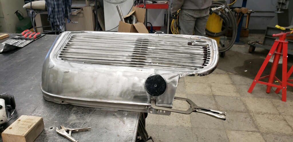

    Up to the front of the truck, we decided it was time to channel the grill 3" and section it another 3". The original grill was in very nice shape. It needed a little work on the bottom lip but otherwise had faired quite well over the years.
