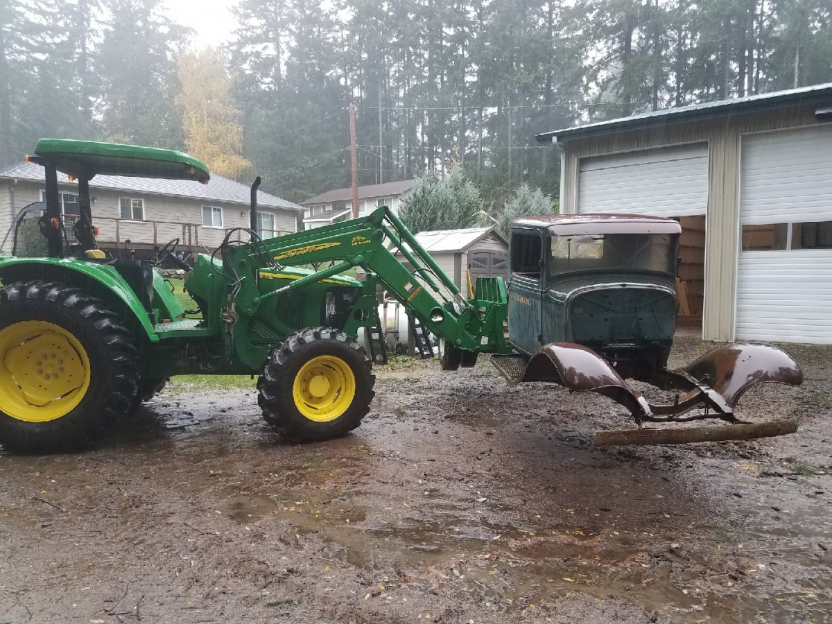

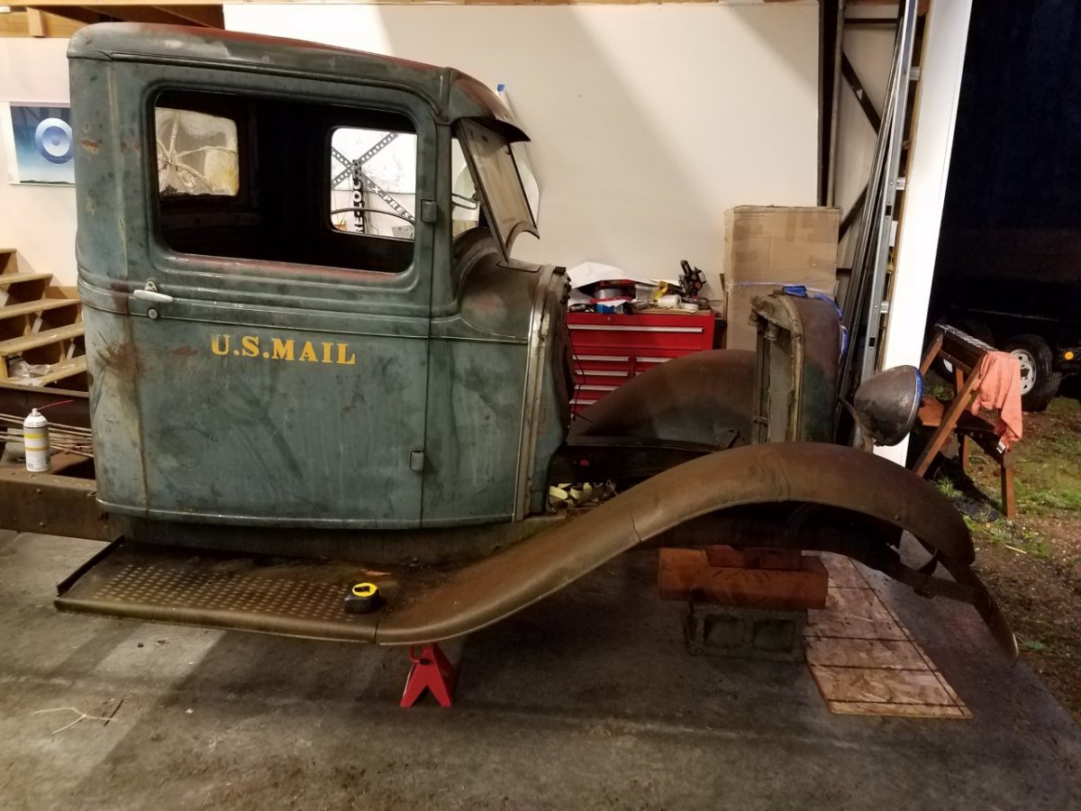

    My project has finally gotten to the point where it's beginning to look like something so I thought it would be a good time to start a build thread. I found a 1934 Ford BB heavy on CL which originally came out of Montana and at some time in its life it transported the U.S. Mail. My plan for the truck is to build a flathead powered traditional hot rod using a mix of old and new parts. Since I wanted to make a fair amount of changes to a stock chassis and the BB frame is too heavy, I decided to start from scratch.
    Here are a few pictures of the truck when I picked it up.

    Oops, forgot the step where the truck goes from the trailer to the shop. 20171121_122804_1511303736022001.jpg

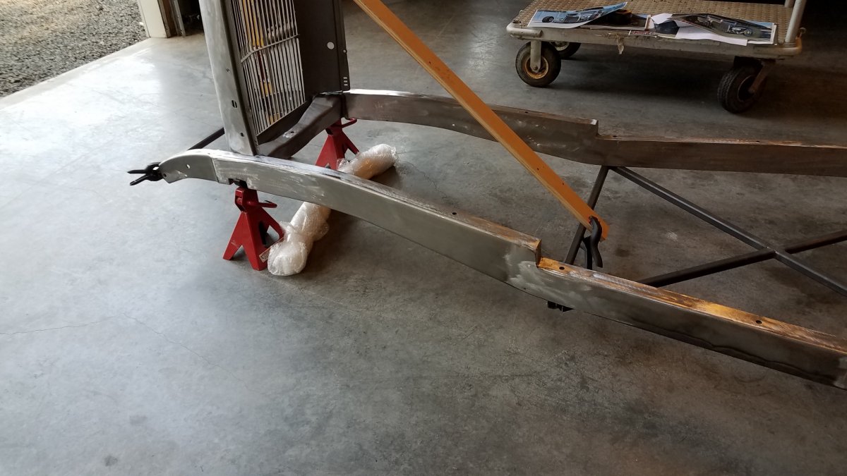

    Once I had everything for the chassis measured and located, I took my rails and drawings down to Schroeder Speed in Portland to fab the perimeter frame. They had a 33/34 frame fixture and did a great job boxing, pinching, kicking, and sectioning my frame. chassis drawing 2.jpg chassis drawing 1.jpg perimeter frame side.jpg perimetr frame rear detail.jpg perimeter frame front detail.jpg

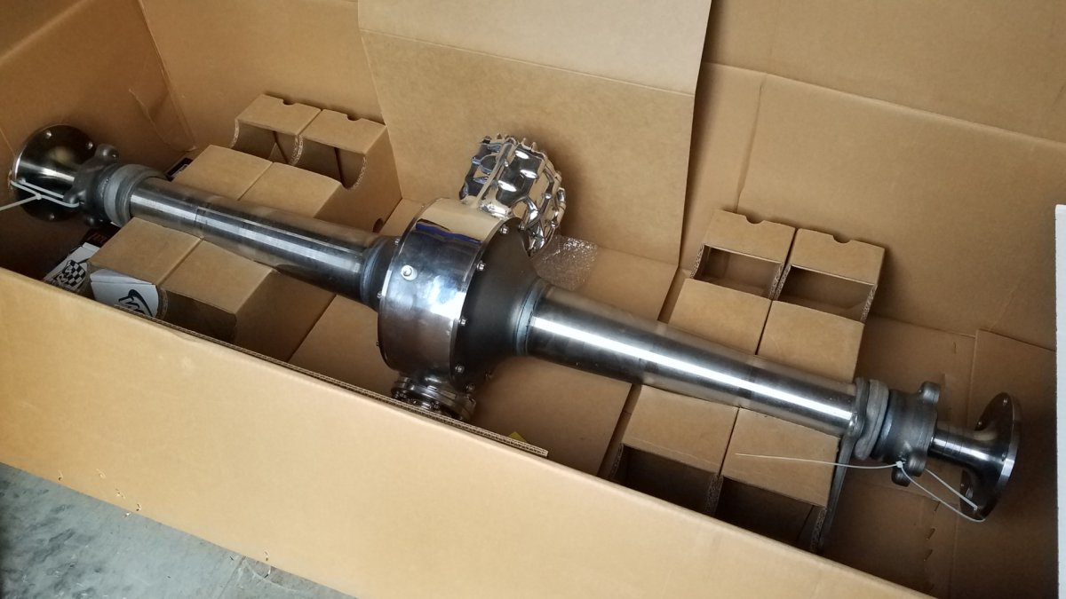

    While the perimeter frame was being built a few surprises showed up in the mail.
    winters quick change in the box.jpg 20200712_102637_resized.jpg IMG_1980.jpg magneto.jpg

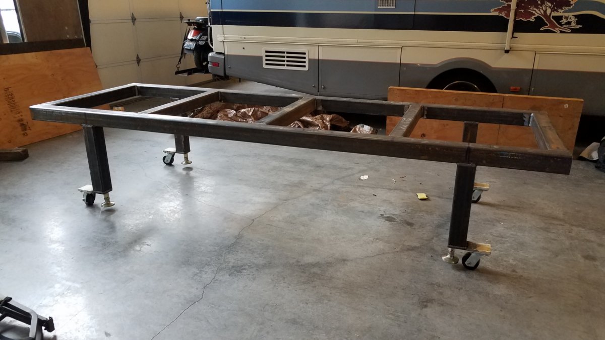

    With the perimeter frame ready to go I decided to build a chassis table. I used 4"x4"x1/4" tube and found a set of heavy duty adjustable casters on Ebay.

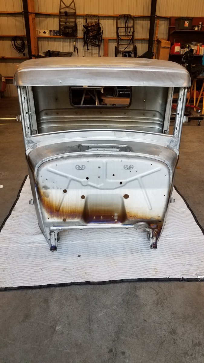

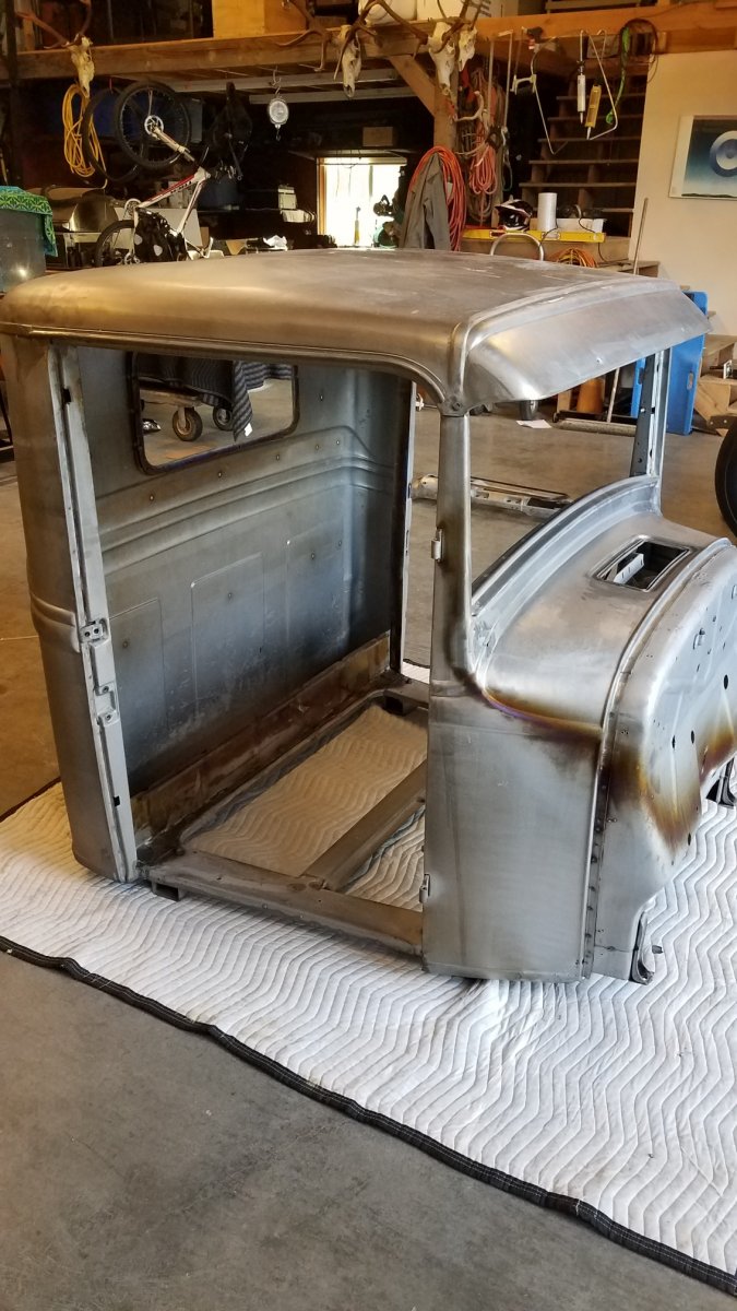

    Now for the controversial step. I made the decision to strip the cab. You can't see it in the pictures but the roof needed a bunch of straightening. The drivers door was wrinkled. And there were a bunch of spots around the bottom of the cab where the metal was thin. I dropped the cab off in Portland and had it chemically stripped. Here it is after I got the cab back.

  22. That looks solid. I liked the old paint with the U.S. Mail on the doors but it is yours. Your vision. I hope that you make it shiny and not some flat paint that looks like primer. My opinion but it is yours to do with what you like.

    I really liked the original patina and if I were doing some form of rat rod it would have been a perfect candidate but I wanted to get all the sheetmetal straightened out. I'll be incorporating the "U.S. Mail" logo in some form on my build. Just haven't decided where yet.
