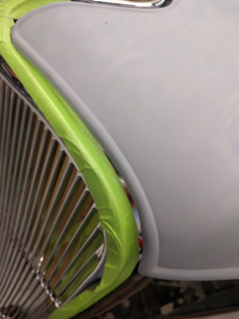

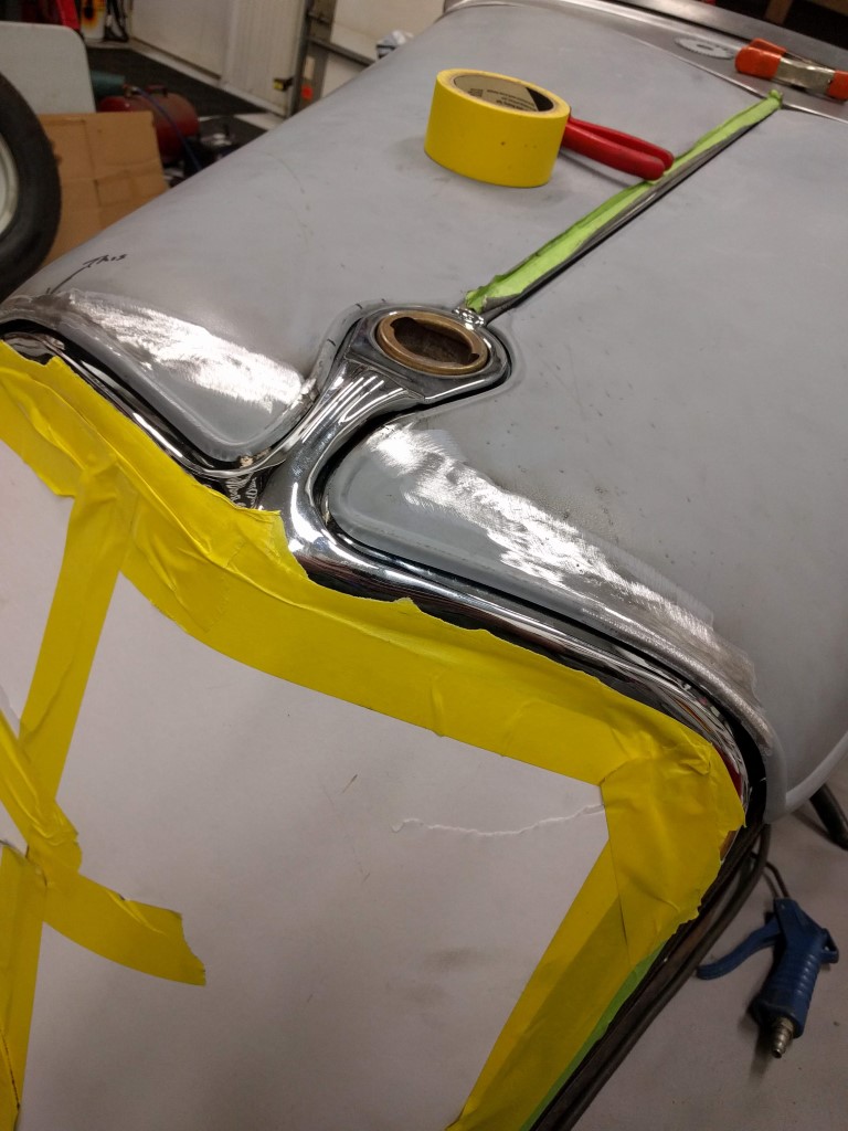

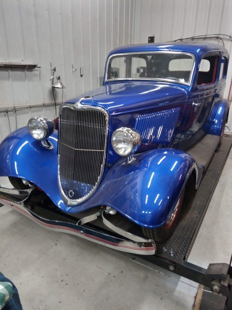

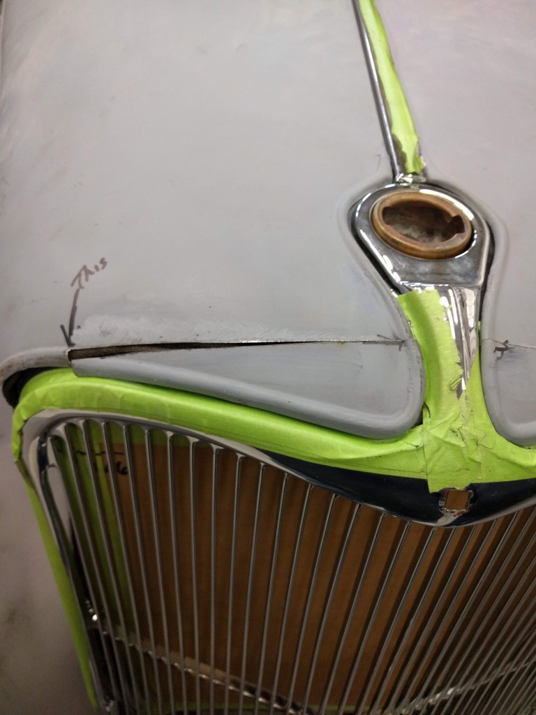

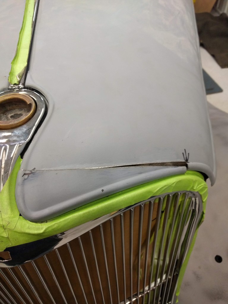

  14. Had to "tune" the nose of the hood to fit the Nottingham grille on my friends car. The chrome on the grille seemed really decent. The shiny bars are a little different; but look good. The mod to make the hood fit the grille wasn't too big a deal; but was a little surprised that it was needed. I noted someone else on the FordBarn inquiring about same problems with the fit too; he decided he didn't want to cut his hood; later I learned my kid bought the grille from him.
    left 1.jpg right 1.jpg left 2.jpg hood welded.jpg IMG_20210128_161846_3 (Medium).jpg

    Is that an original hood? If so I’m not impressed. How did it fit to the cowl?
  20. Original hood that fit the cowl as it should. The "V" shape of the top of the grill was less than hood; so when the very front of the hood was right the outside corners were well back from grille. The wedge cut with more at the inner side and none at the outer edge let the shell tip back and the outer corners and hood sides to come into place. Easy work; if you don't require exact originality, anyway, it's a hot rod not a restored car.
    Maybe this grille was an aberration considering other responses on this thread; but even if it wasn't, I would not hesitate to buy a Nottingham grille if needed in the future. The little metal work we did was nothing in comparison to the cost of buying a good original and getting it plated. The chrome on this grill was very good.

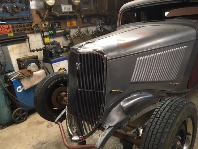

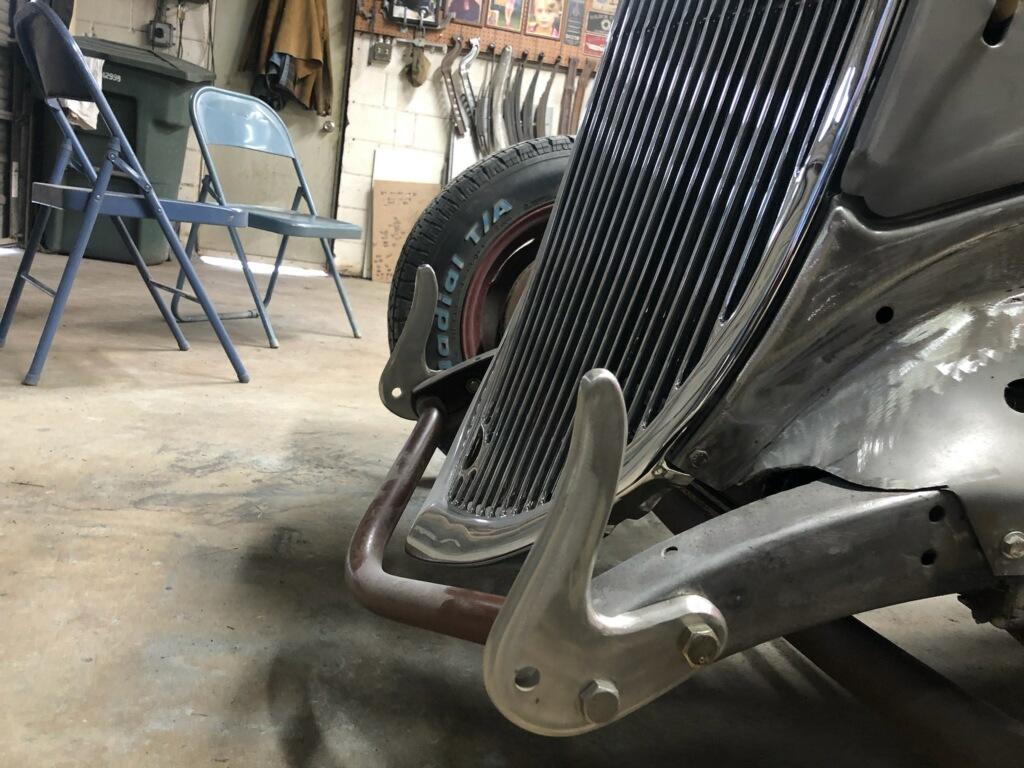

    thumbnail-24.jpeg thumbnail-33.jpeg Another picture of lower part of Nottingham Grille...The hood is Roodlieb and fits perfectly

  22. Looking good and I like the change to '34 hood latches; always seemed to me to be a better arrangement than the '33 latches.

    34 car so The hood handles was a no brainer, Rod at Rootlieb said Nottingham was a little different at top front ,so he made hood to fit the Nottingham grille ..I'm very pleased...

    I really like your setup! Did you fabricate the “horn hooks” and spreader bar yourself? Looks great.
