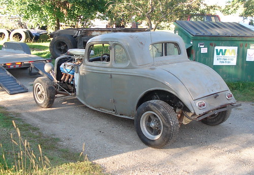

    I have started the "SOMEDAY" build. It is really good to be getting into this project. It is a journey for me since it is my first rod, but thankfully I have some good help to go along with it. I have gutted the entire car and have the doors off finally. Probably will get the body off the car this week and then remove the drivetrain. Also been spending time on restoring/rebuilding my dash and the rear panel below the trunk lid. Took about a week to get the dash all repaired and set up to accomodate a 1934 Plymouth Instrument Cluster. The rear panel is finally set and I will be cutting the holes for my 51 Buick Tail Lights tommorow, along with finishing up the brackets on the inside of the dash to hold the instrument cluster in there.
    With the 1957/1958 392 that is in the car, I figure that realistically puts me in a 60's type build (since I cannot believe many were yanked out of other cars right away) so that is the plan for right now. If anyone gets the Rodder's Journal, (I only have a couple issues) check out Issue 36, page 100. That is really the look that I am going for, less the same wheels and tires.

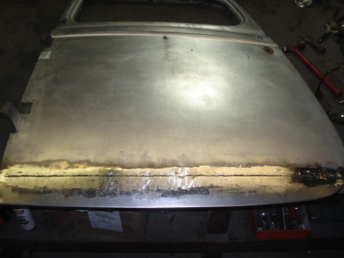

    Today I started to work on my passenger door. The door is not in too bad of shape for a 75+ year old Wisconsin door. Minor rust on the bottom outside and a bit more on the inside.
    I managed to get the rear skin off the door today and began fitting the inner panel/skin. Tomorrow I plan on removing the lower outer skin. My schedule won't allow a lot of time on the car this week, but I think I should be able to finish the door possibly this week or at the latest, early next week.

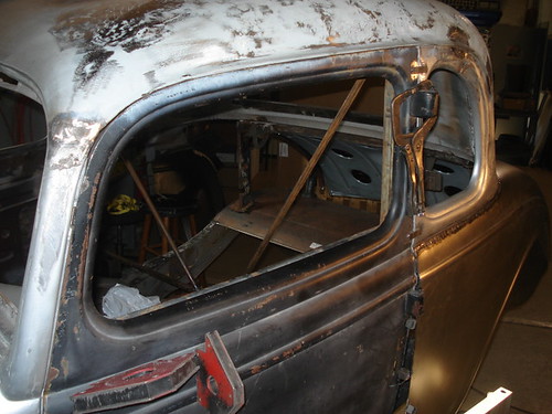

    I finally manged to pull the frame out from under the car so that I could begin working on it. It is a solid frame, but it has a bunch of junk welds on it from others who have molested it over the years. Someone had massive fenders (prior to the owner I bought it from) on it and the remains of the braces were left welded in the inner wheel wheels and on the frame in this area. So, that is why you see big chunks of the inner wheel wheels missing. I had to cut these areas out to get the body off the frame.
    Once the frame was removed, I got it on the trailer and hauled it over to a guy that does sand blasting. We bartered on some things years ago and it was time for him to even up his end of the deal. It blasted up really nice. Some pitting in some areas, but that is to be expected I guess. I have begun grinding off the chunk welds on it but have a ways to go to make all the repairs I want.

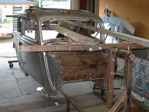

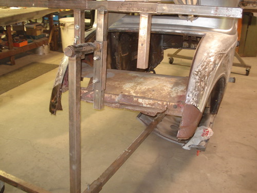

    Since front floors were out of the car and the rear floor still has to come out, I ended up hanging the car so that I could work on it (and get the frame out). These bodies blow in the wind when not tied together tight and this ended up being my solution. Portions of the original firewall were missing so I removed that one and found a solid replacement from a HAMBER in the Milwaukee area. It is just clamped onto the car at the moment. Currently have the doors hung and have begun to get those aligned. The drivers door is tacked in for the gap dimensions I want. There is a perpendicular piece of metal welded to the center of the tabs that fit between the door and body to hold the gaps I am looking for. Once I have the lower door skin on the passenger door, I'll set that door. Slowly will move around the car, repairing or replacing the inner wheel wheels, lower rear quarter patch panels, rockers and at some point in the maze (this winter), weld in the firewall and begin working on the floors.

    Left off before with my passenger side door. I removed as little of the lower door skin as possible. We took the skin and created a shallow crease so the original skin would overlap the skin nicely. I then took a body panel glue and glued the panels together. I then went back in behind the door skin and used wooded shims/blocks to establish the curvature of the door. I let this set for 24 hours. We then went back in and welded the door skin to original panel. This worked out really well and I would recommend it over just trying to weld your panels together with no curvature established. Still though, the metal shrank and I had a lot of pounding to do to get it back to near normal. Overall though, it turned out well. Still need to get the inner panel on the door, but that will happen down the road a bit.
