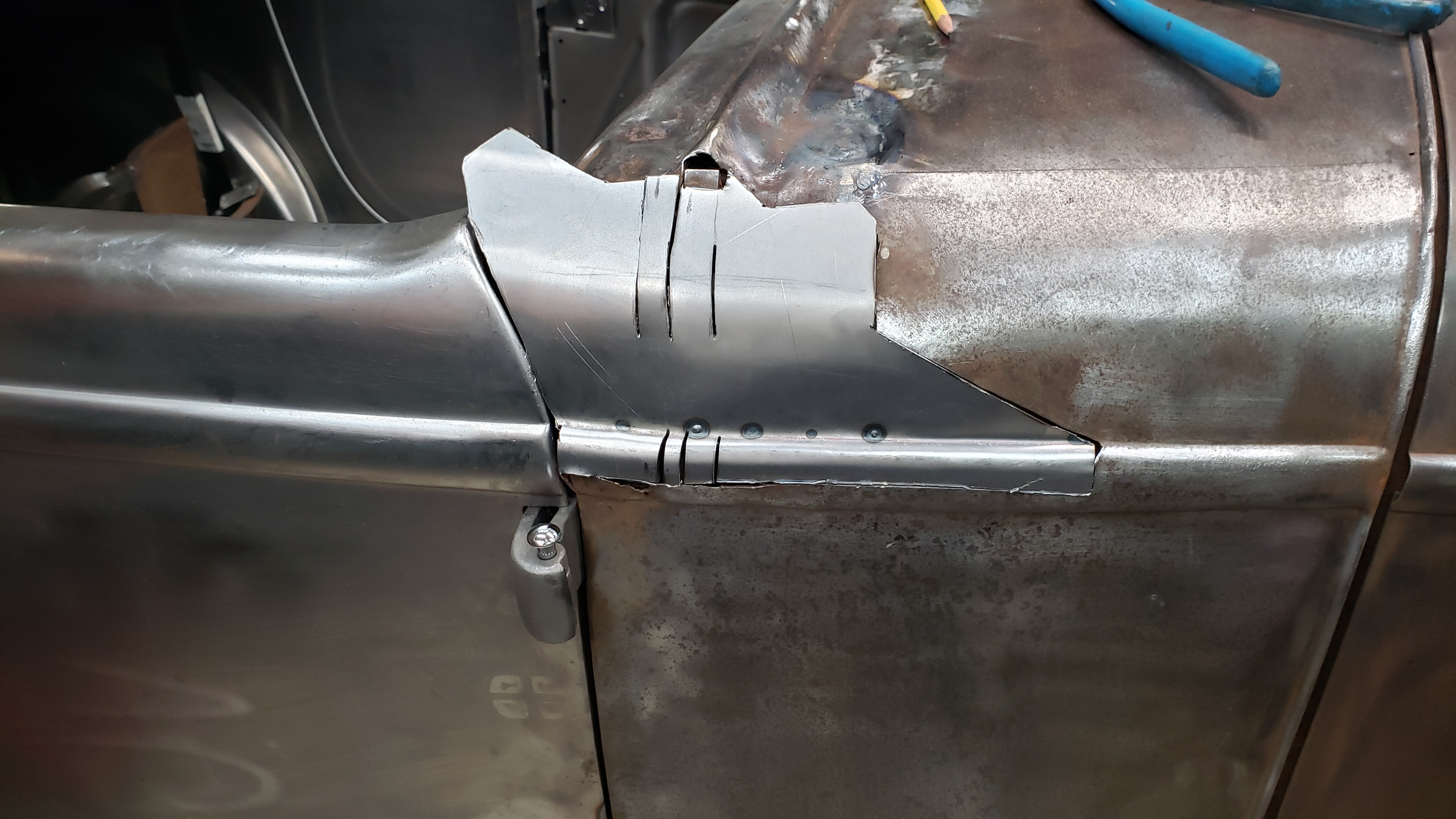

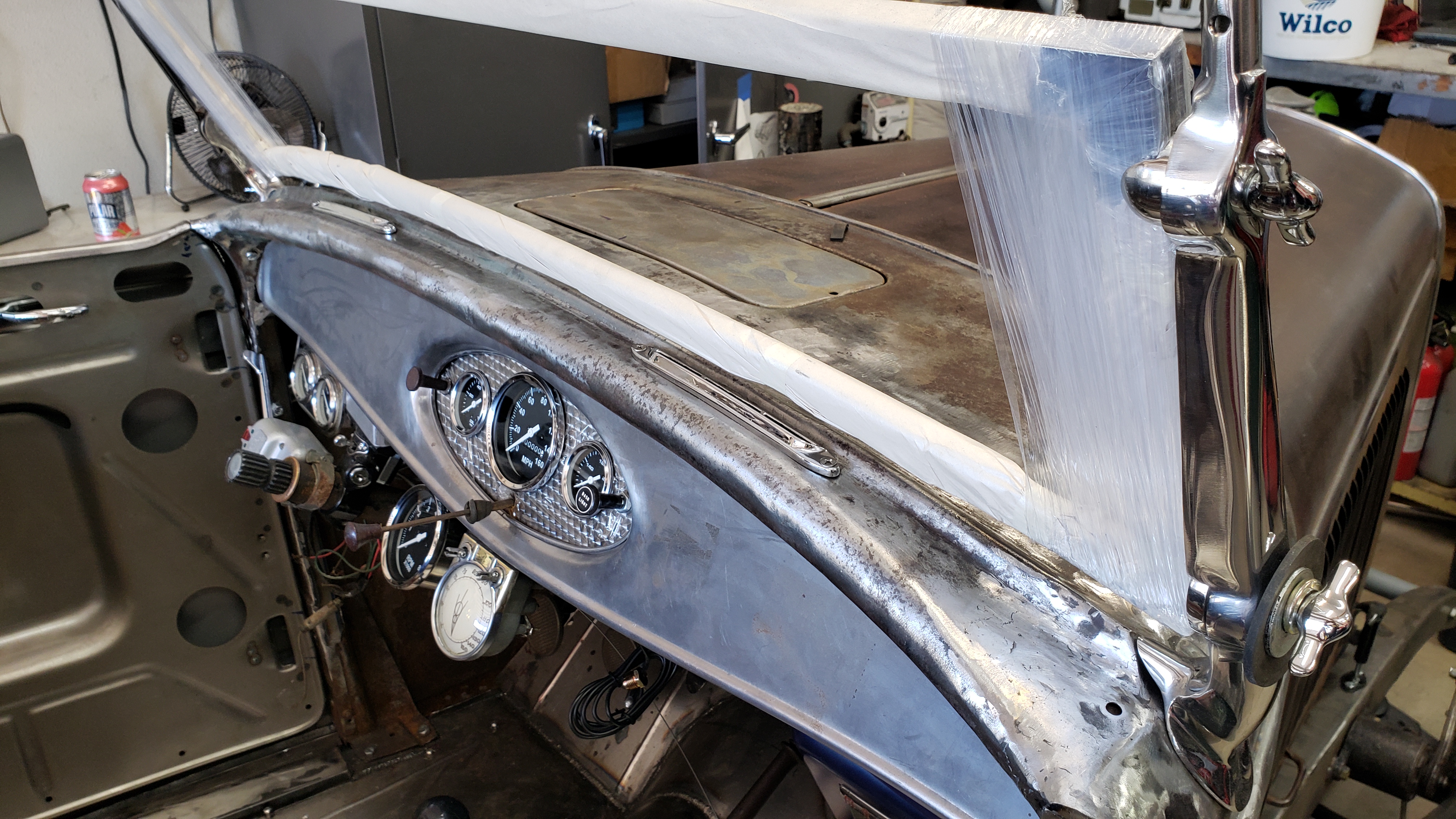

    I spent more time than you’d probably believe trying to get the cowl back into shape. It’s still not perfect but I think it’s close enough that a little bondo can deal with it.
    I don’t know if this will be useful for someone, but, with the bead roller wheels I have, I couldn’t get the 32 bead shape. Before buying something else, or making new bead roller wheels, I tried hammering a bead over a piece of round bar. It worked better than I expected. I had to relax it a little with the hammer after I took it off the bar, but I’m happy with the patches (I neeeded to patch my cowl because it was from a closed car and where the window pillars went up had to be fixed).
    I found a heater with a slight art-deco look. A Chevette heater core was small enough to fit in it. There’s a problem that the Chevette was designed to be mounted sideways but I put the hoses at the bottom and my hope is that the hot water will rise on the side it’s coming in on and fall on the other side. We shall see.
    I had a friend plastic print a piece that would fit in the top window for a hose to defrost. I installed MGA vent chrome and Vintage Air ducts. The same friend printed some wedges to get the ducts out of the cowl at the angle needed to clear the dash. They’re mounted and I think the system might work (hinging on the above mentioned core layout).
    I installed a stereo and speaker in an old Motorola box. I wanted to use a 37 Ford control head, but that took a little thinking. I’m going to leave the volume up on the amp, and then run the speaker output to an inline volume control (controlled by the 37 head) is what I eventually came up with. I’ll use the other knob to turn on the heater fan probably.
    Laying out the dash was fun, getting to use a little creativity after a month of hammering a cowl. I tried to retain some ‘32 look.
    I did fix the column drop, something I wasn’t sure I’d be able to do. I never found a “how-to” but I figured it out. Maybe I should have made a how-to but too late now, I didn’t take pictures as I fumbled along.
    Next up, I still need to get my rockers welded in, weld the B pillar supports and bolt in the side seat riser supports. I need to fix the headlights (I bought some reflector kit) and mount them. The hood also needs some help, the bottoms are both split at the middle and one side is a little bent upwards towards the rear/bottom.
