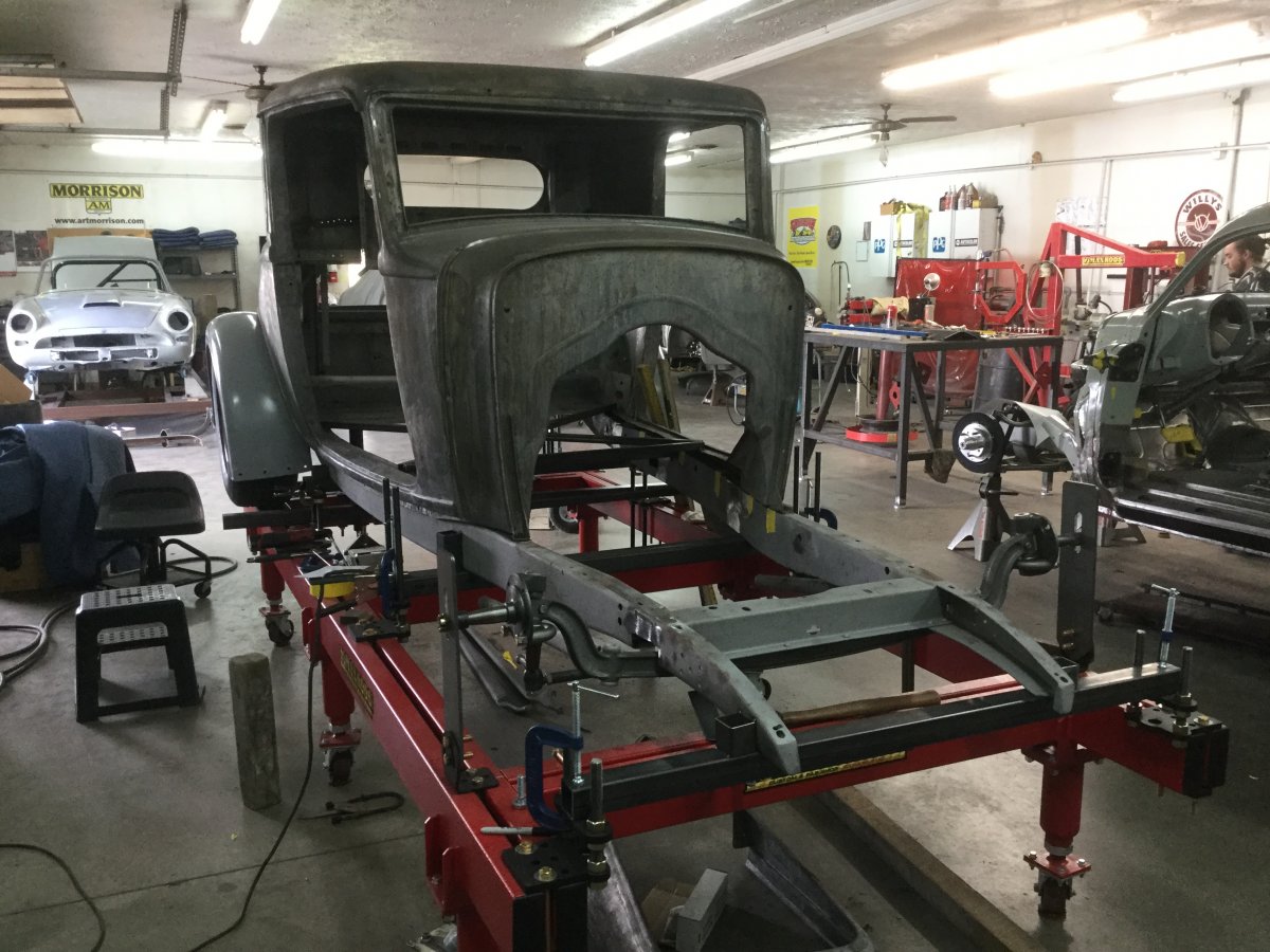

Projects 1932 Studebaker Rockne Build thread
Discussion in 'The Hokey Ass Message Board' started by KevinS, Jul 31, 2017.
  1. KevinS
    Joined: Mar 17, 2010
    Posts: 269
    KevinS
    from Ohio

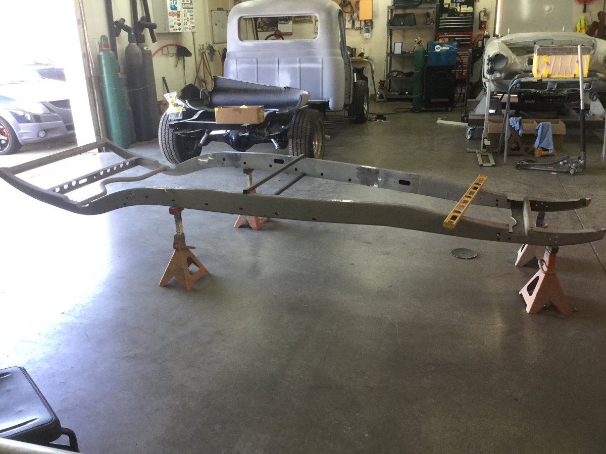

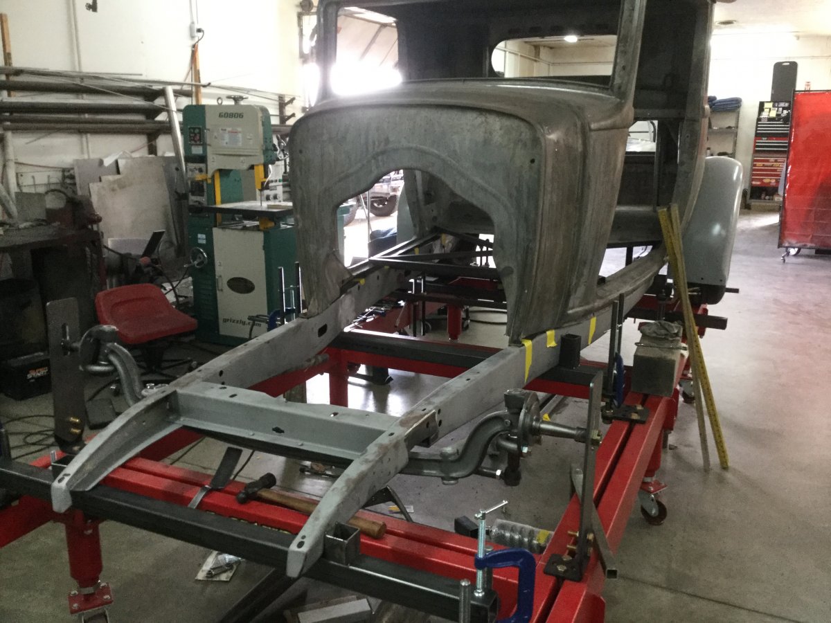

    The chassis is back from being blasted. The cross member is gone and it is now on the new chassis table/jig for mocking everything up along with the new front suspension and ride height. The first picture shows where the rear wheels will be when sitting. The front end will be low as the finished pictures reflected before.
    mgtstumpy and kidcampbell71 like this.

    KevinS
    from Ohio
    The body is back on and making sure that everything is level and starting to figure out ride height and the rake we want the car to sit. The front wishbones are sitting on the front end now. A lot of work to be done. Hoping to have the engine sitting in between the rails for mock up in the near future. The new cross member will resemble the old cross member but will be laser cut along with some other details that will be shown on the updated chassis. Part of the firewall has been cut out. However it will all be gone soon and look more traditional.

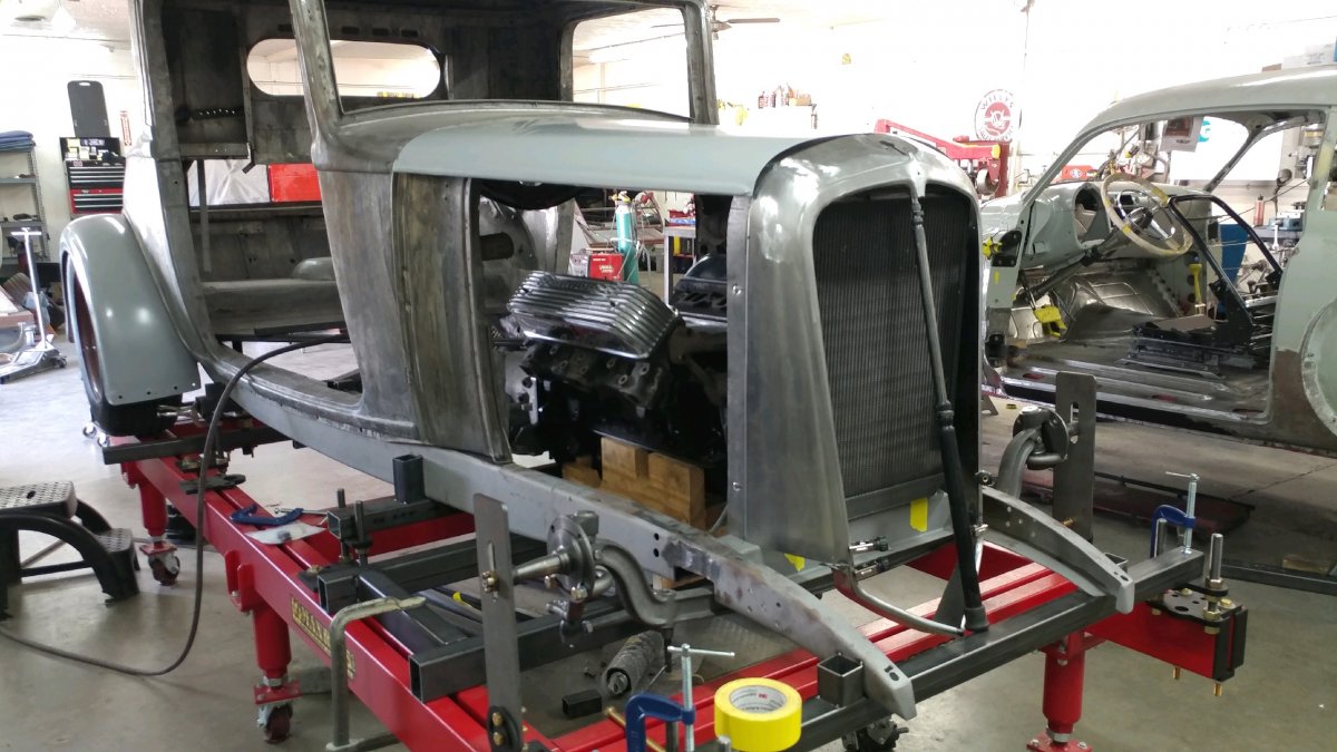

  5. KevinS
    Posts: 269
    KevinS
    from Ohio

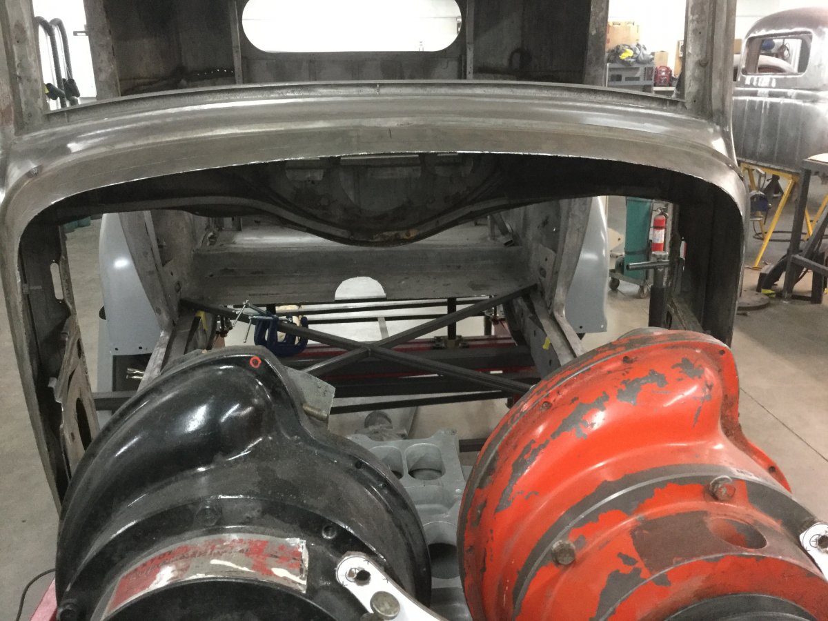

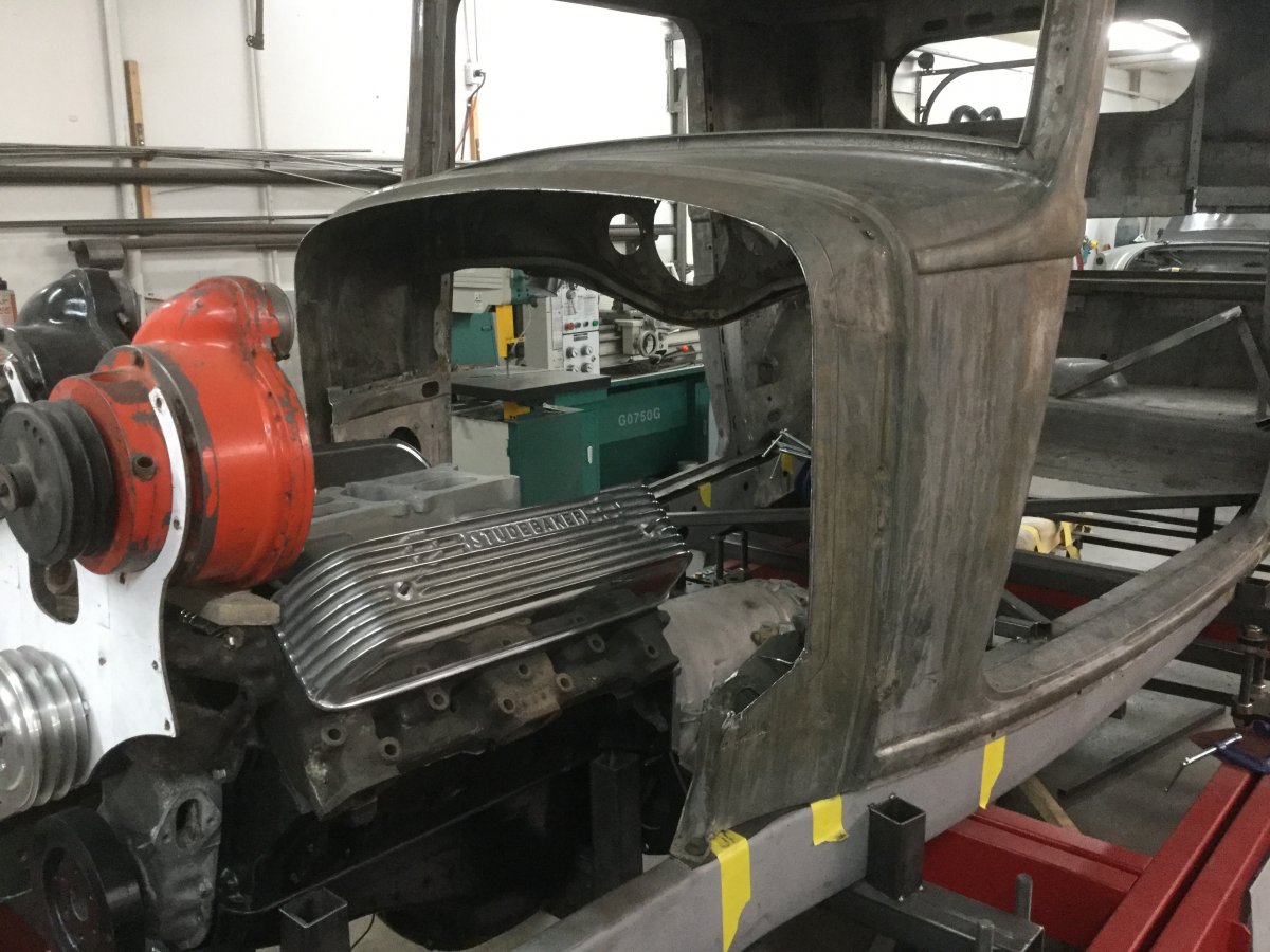

    Progress continues almost daily at the Lo Man Rods Shop. The firewall is now cut out and the engine is moved back further so there is clearance for the twin superchargers up front.
    6F56AF5A-80E9-431E-92C0-5A57248D72F5.jpeg BF373D4A-8CD5-496C-9E9A-B190A7B391BD.jpeg B0E30DFD-0795-4167-86D8-A2745DBC2F3C.jpeg 6F493187-D7DC-4127-8AC6-8DB82B373728.jpeg 12A02BB9-EC87-43C6-927D-3B547EF9F188.jpeg

    The front engine plate is beginning to be mocked up to hold the twin superchargers for the new Studebaker engine that will go in the Rockne. The intake and dual fours will go on soon.

  7. mgtstumpy
    Joined: Jul 20, 2006
    Posts: 7,890
    mgtstumpy
    Just a thought, have you considered removing that puller fan and putting it in front behind the grill and moving the engine forward, that way you would free up some interior space? Would there be sufficient clearance for pulleys, mechanical fan and radiator? Was that the original firewall, a slightly recessed version of that would compliment the car if it was?
  8. KevinS
    Posts: 269
    KevinS
    from Ohio
    There will be a fan behind the radiator and the condenser will be gone since I am losing the air conditioning (never used it). The firewall was it original. There is a ton of room under the front cowl and with the air conditioner removed we have even more space. The firewall will be replaced to look more traditional.

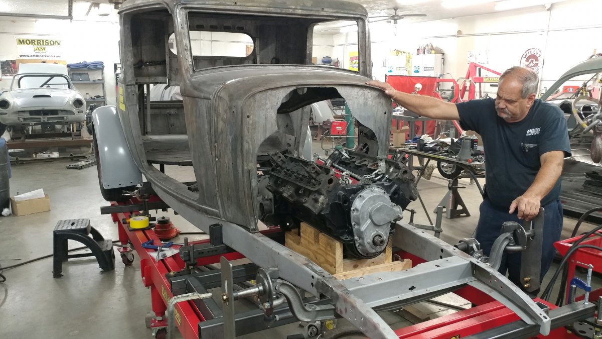

  10. KevinS
    Posts: 269
    KevinS
    from Ohio

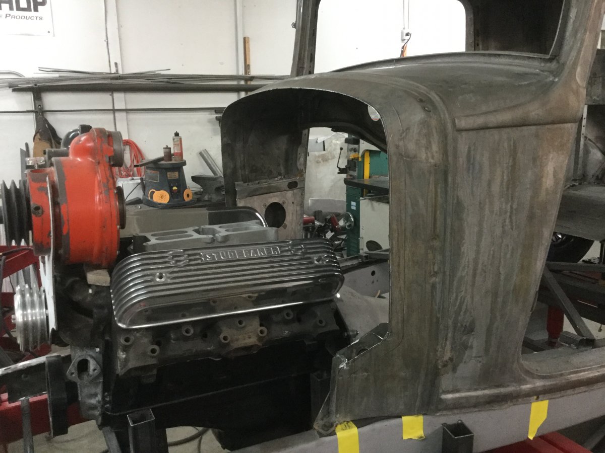

    The firewall has been trimmed and cut out so more of the engine will be seen. The inner front frame rails are being reworked as well and the motor is now level. Once the rails are boxed and smooth, the shop will be making the engine mounts, etc. There will be a lot of trick things done on the motor for the twin superchargers including the laser cut front engine plate along with other parts. Some of which will be kept secret or not completely shown so the car is the first one out with them. Stay tuned.
    9881C40F-28AA-4998-AABB-1E732C281497.jpeg 46106EFF-A0B8-4CE5-A4F0-0EFF093B0998.jpeg F2A38E40-EAC3-41C8-82DC-715C21F01E62.jpeg 33428AF8-82F3-4093-A2D5-908DE3FE1A91.jpeg
    waxhead and mgtstumpy like this.

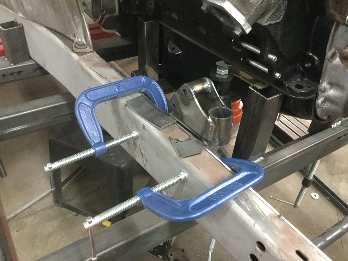

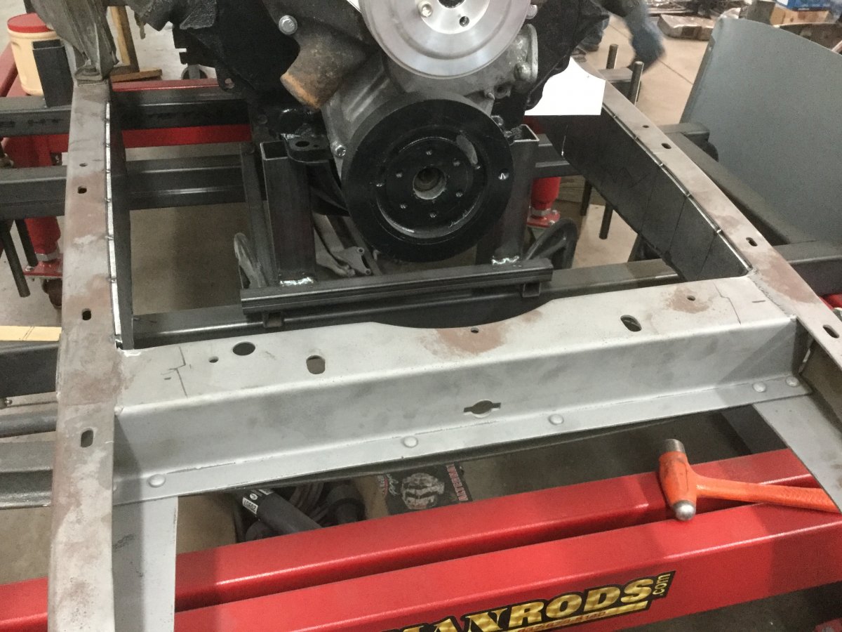

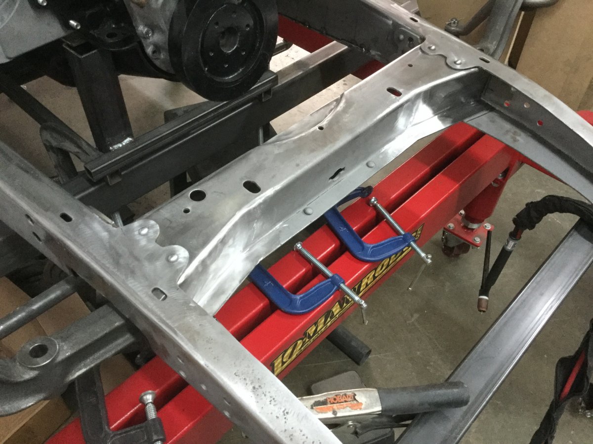

    The front cross member has been reworked, boxed in and new brackets welded on. The inner frame rails are starting to take shape and getting welded and smooth ready for the newly made motor mounts.

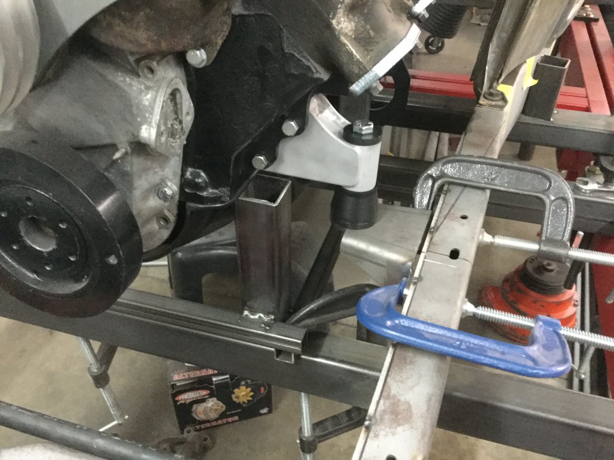

  12. KevinS
    Posts: 269
    KevinS
    from Ohio

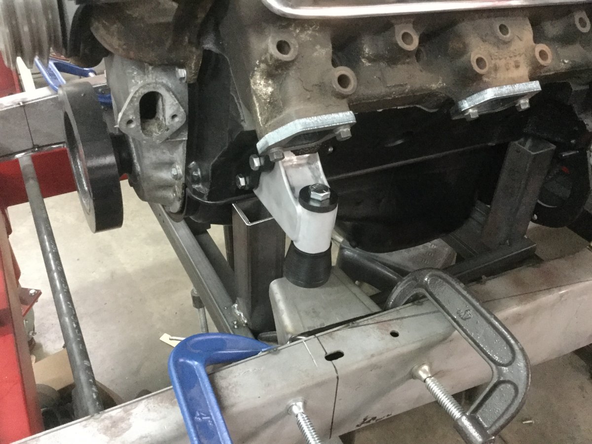

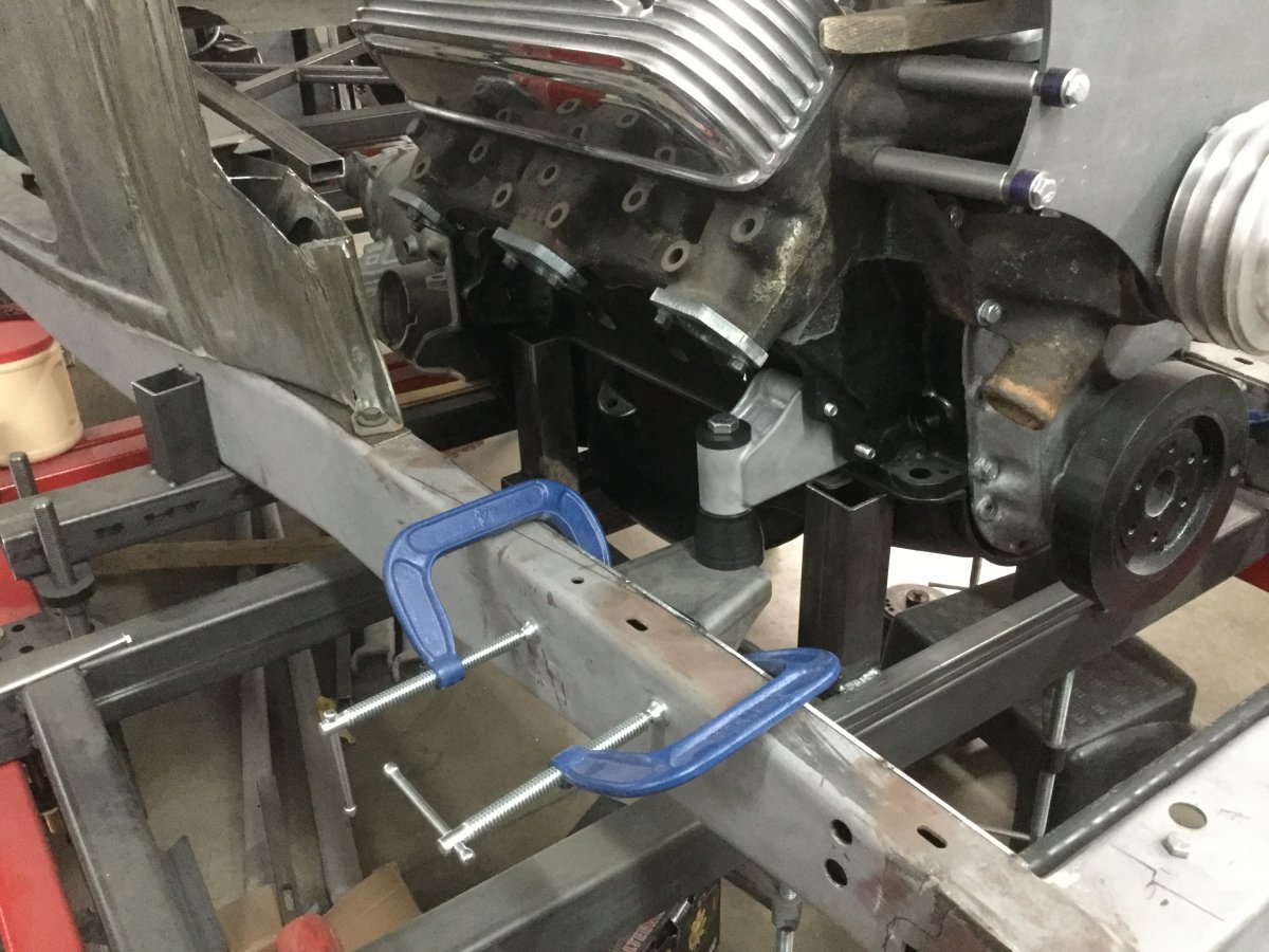

    The new motor mounts have been fabricated and are ready to be welded onto the inner frame rails. Most every part is being made for the car. No cookie cutter parts especially since they do not exist for this car.
    F2E8FC80-A9ED-431B-BB9A-DA1DF5FCC6CA.jpeg A6C29D7F-E402-4044-9E7B-A929D2154376.jpeg EEDE91F0-AD4D-4356-AC21-43D877AA0A92.jpeg 53E8A0C1-5628-4222-8031-82B9E6658A14.jpeg

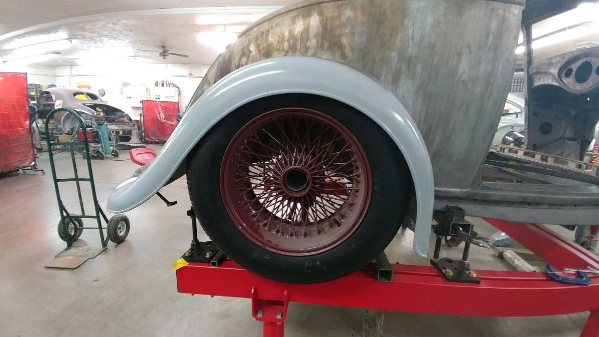

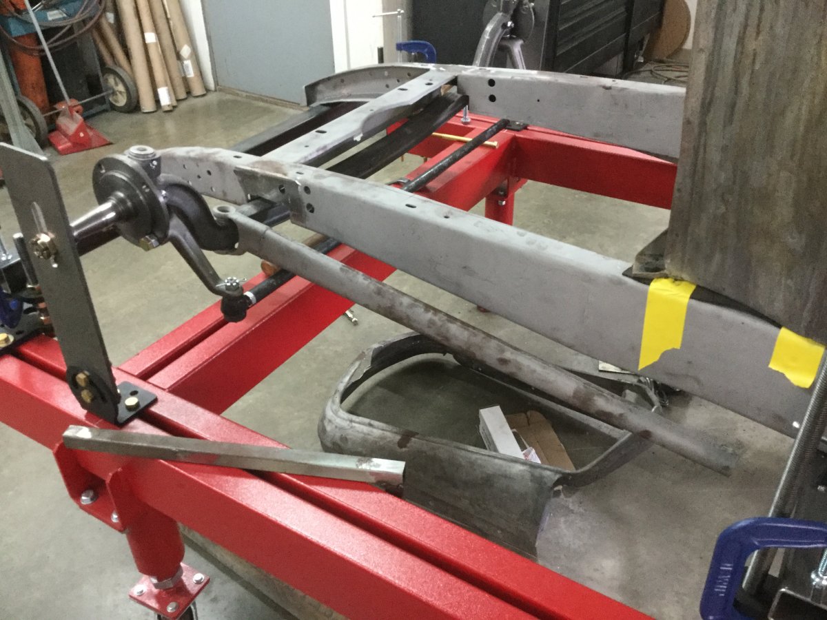

    The new rearend has been ordered and being built. We now have a larger tire on the rear wheels to fill the fender well even better than before and give it a better rake. You can see before that there was also a small gap between the tire and fender. I wanted it tightened up a little and the bigger tire to fill the wide fender.

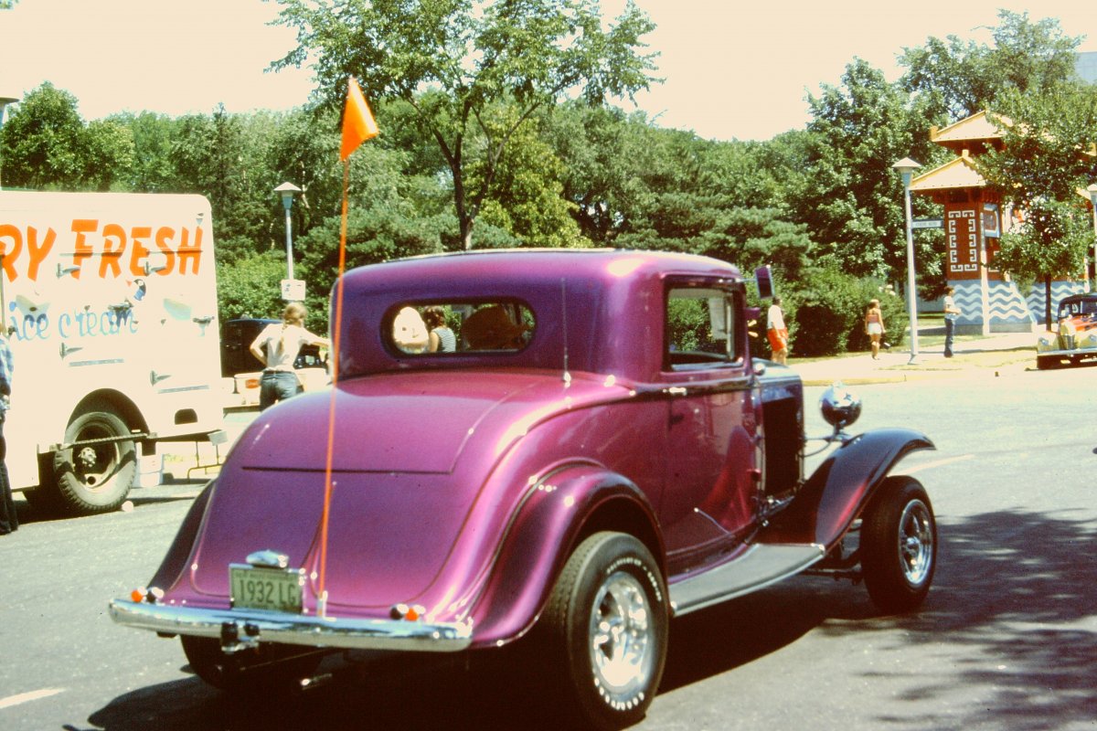

  28. KevinS
    Posts: 269
    KevinS
    from Ohio
    Thank you cabriolethiboy for posting this picture of the Rockne from the 1974 Nationals on that thread. I had not seen this picture before. For anyone else that has old pictures of the car, I would love to see them.
  29. KevinS
    Posts: 269
    KevinS
    from Ohio
    B92F6A6C-64A5-4747-A017-3613741A2337.jpeg Here is another historical photo of the car. As a kid, I used to sleep in the rear package tray and roll down the rear window (when you could get away with those things).

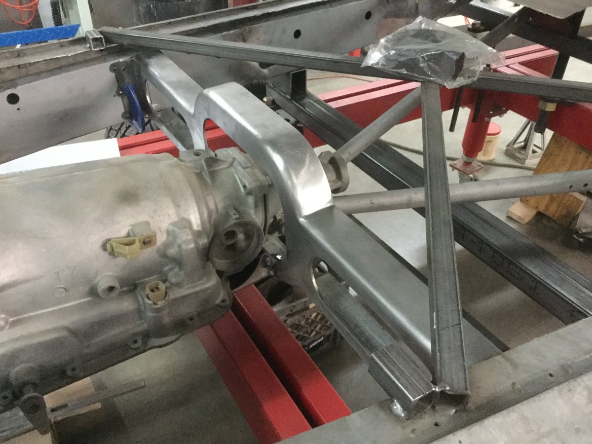

  30. KevinS
    Posts: 269
    KevinS
    from Ohio

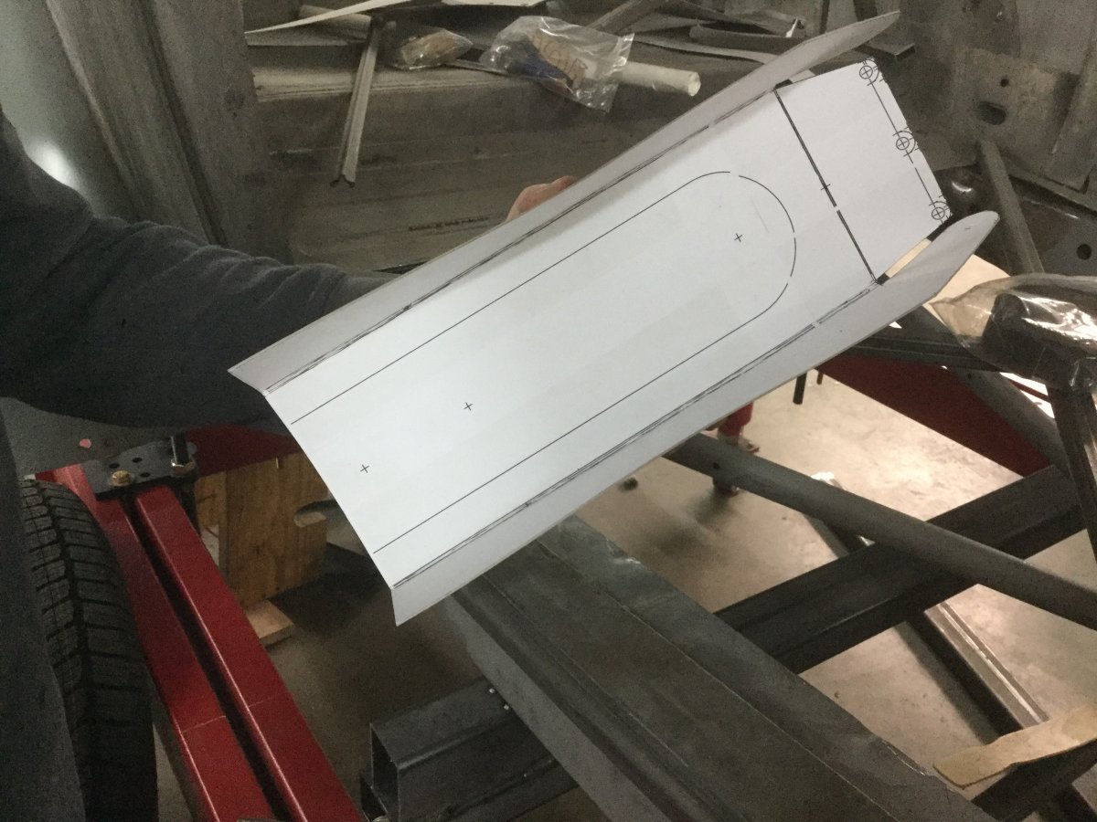

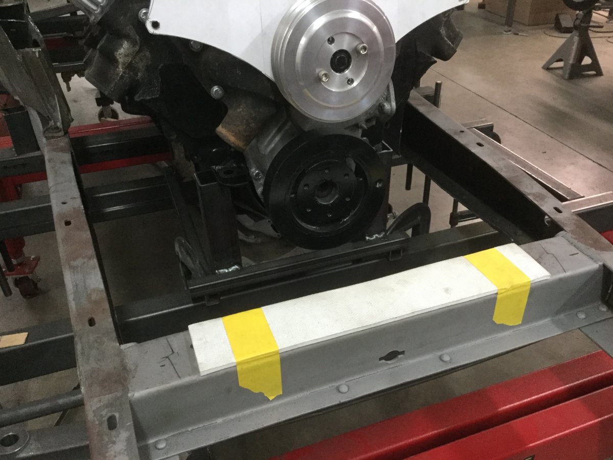

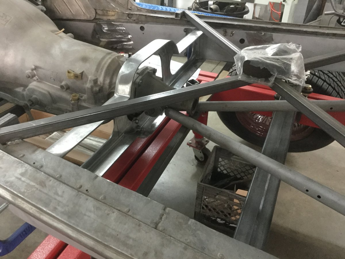

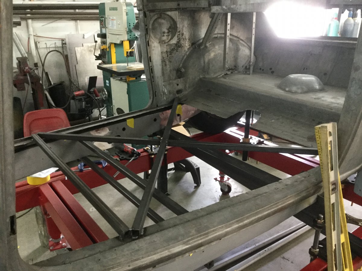

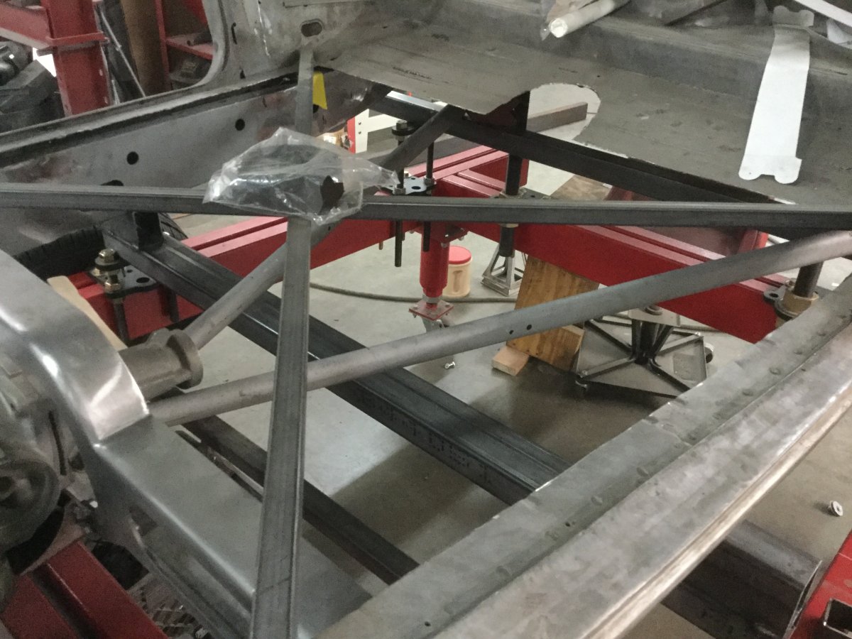

    The cross member for the transmission is now in the car and squared up. Next, designs for the center cross member have been laid out in card board, measured and placed in Bend Tech. The designs are currently being laser cut. The rear wish bones will also be laid out more to flow with the cross member.

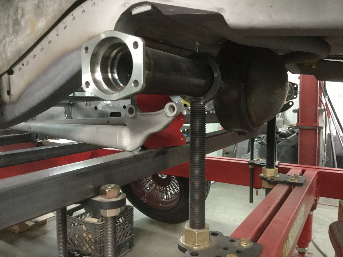

    The rear end is now mocked up in the car and measurements are being made for the rear wishbones, cross member and more. Rear plates and shock mounts are designed and being laser cut as well. Much more is going on at the same time as progress continues on the chassis.
    0528D4CD-A993-41EF-B429-453C19D04CB4.jpeg A9889FF7-C4E2-4D16-B2B7-8DD721E4343A.jpeg B5C0A886-71F5-4EC8-A76D-C00139A95AC5.jpeg E44CC6C1-9F04-4664-BC52-195F8D6FEDBC.jpeg 263B5E83-2532-426F-8839-2B8B70E30097.jpeg 5353B8C2-0938-49AC-A01E-0E232D4A740D.jpeg 7A046A83-C4F6-4AA3-97A3-EE82058E47A9.jpeg View attachment 3799901
