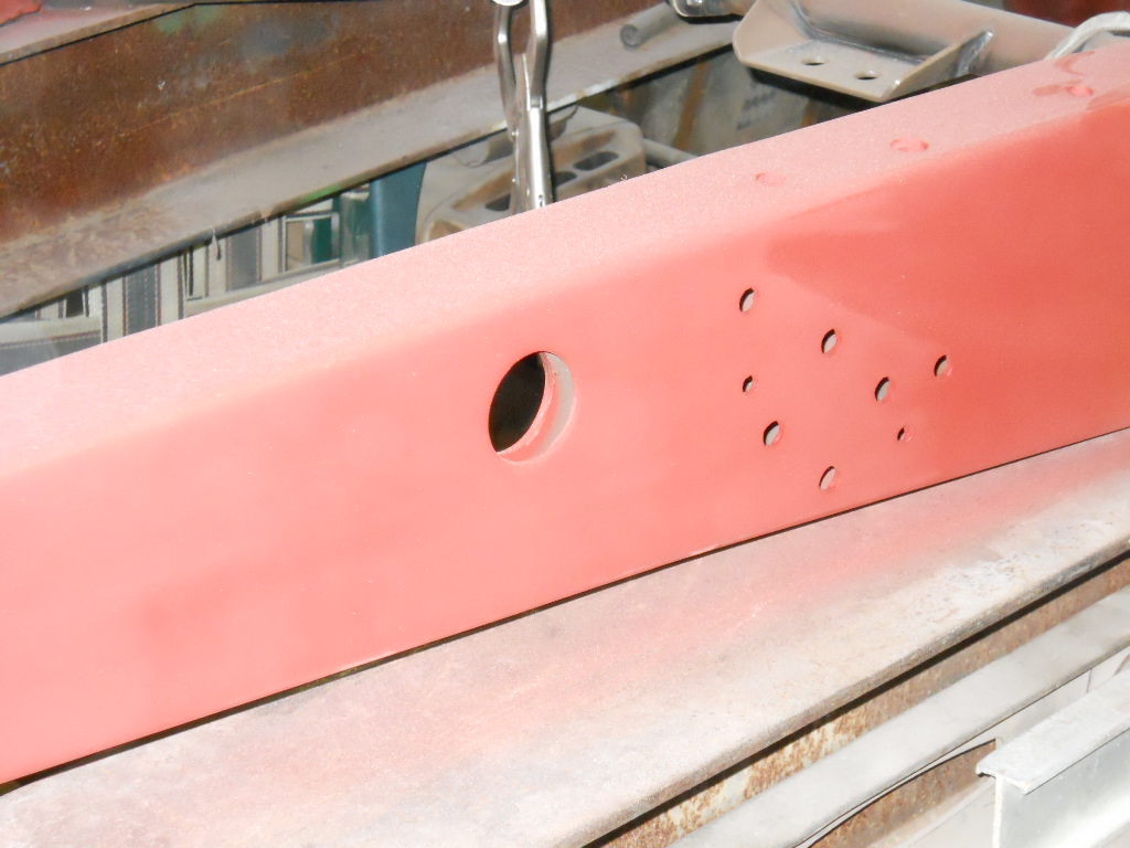

    I had a stock chassis at my shop for installing a center cross-member, boxing , etc, I made a template of the holes on the side of the frame. I used it to drill my ASC rails for my 32. I 'll see if I dig it up and make a copy for you. I remember thinking the day I was drilling the holes , for the last 40 years I'd been welding them all up !

    I have one of the chassis blueprint drawings hanging on my shop wall. What would be cool would be, if someone had access to a water jet, you could punch in the numbers off the blueprint and have exact templates made. With a CAD water jet and blueprint they would be perfect.
  18. My gosh, how was anything made perfect before CAD and water jets.
    You see the drawing up there? All of those dimension are in a straight line plotting the holes on the curves of the rails. In order for those numbers to work, the curves need to be perfect first. The dimensions aren't center to center for holes.
