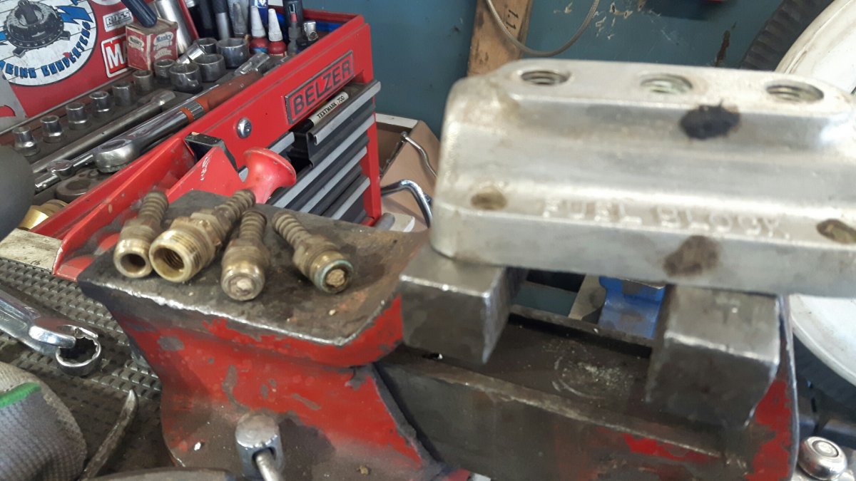

    Hello.
    Later model headgasket. I bore that hole to same end where I have plug that big hole.
    Generator bracket is maybe offenhauser stuff. I ordered it from speedwaymotors for this engine.
    I have also used those "59A" style LR or RH on head brackets. Still have one vintage bracket on stock "Los Angeles 66".

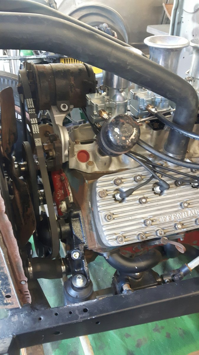

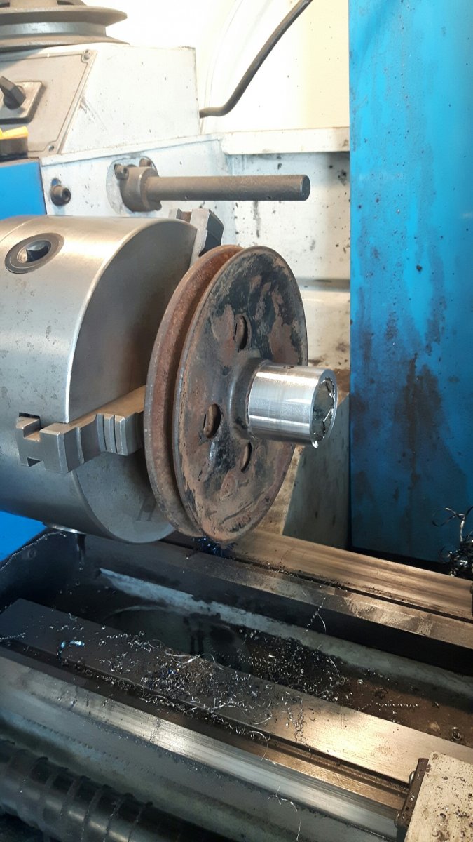

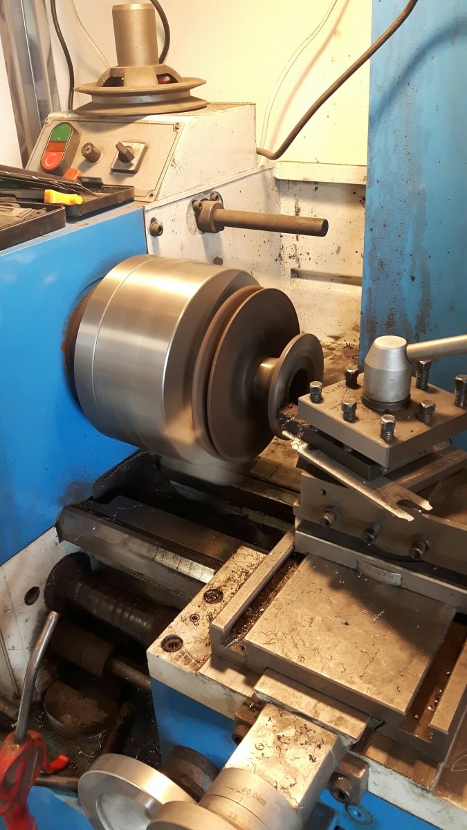

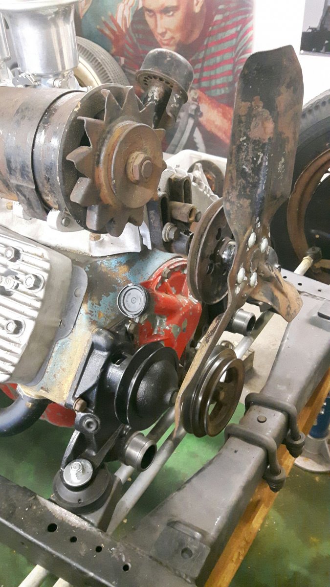

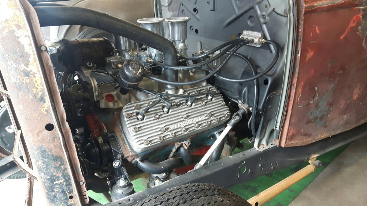

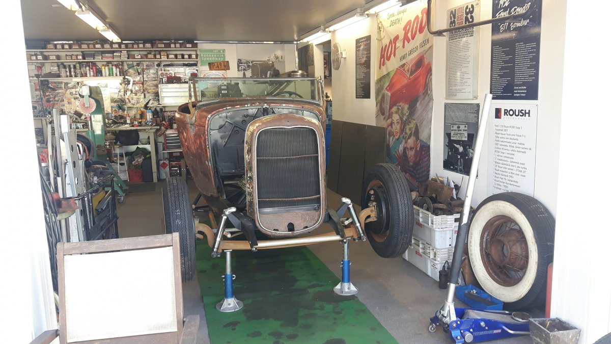

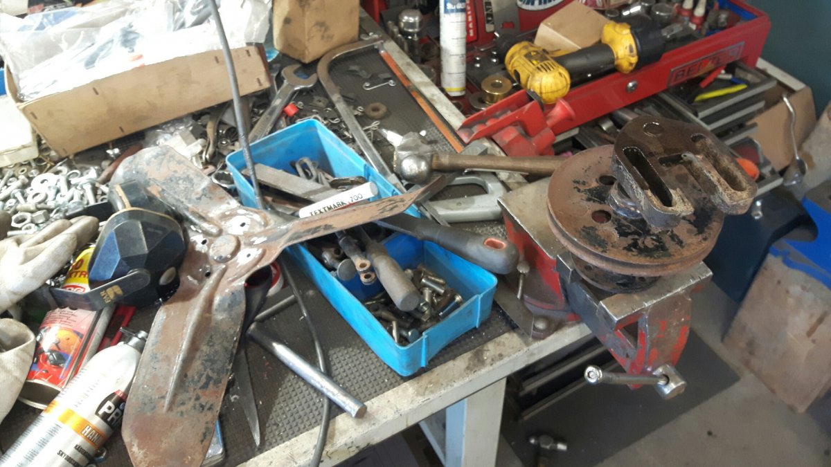

    Monday Rodding. Generator need to open. Its stack, but I will fix it.
    Generator pulley need to change to wide one.
    All day I have made fan modifications (measure,cut, short, lathe, weld, lathe, test install...).
    Original 53 merc fan is too long, I shorted it +20mm
    Waterpump belt will be classic V-belt (B). Fan belt will be narrow model as original merc have.
    Tomorrow need to install linkage kit, starter....
    Aulis

    The generator pulley looks out of alignment, optical illusion?
  5. AULIZ
    Joined: Oct 28, 2005
    Posts: 1,479
    AULIZ
    waterpumps + generator are same line.
    fan + 1st groove in crankpulley are same line.

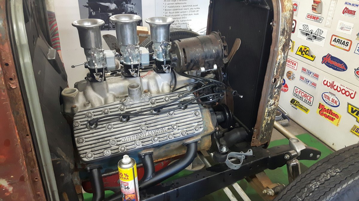

    distributor has got new wires, points, rotor, cap...
    sparkplug cables ready and starter installed.
    Aulis

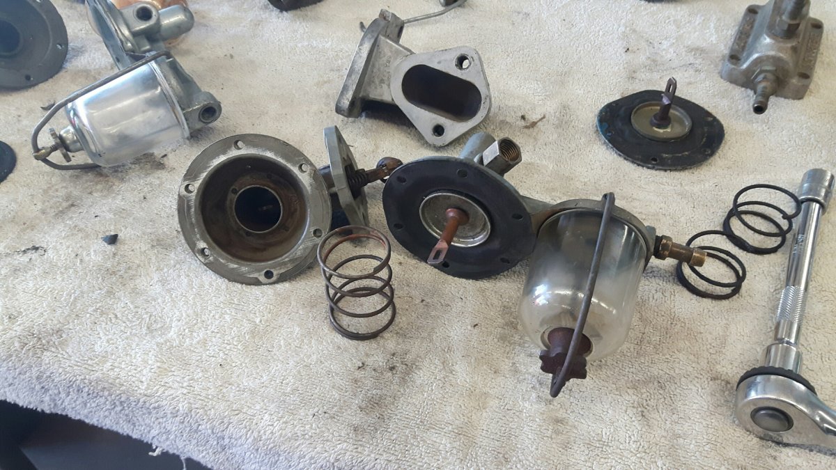

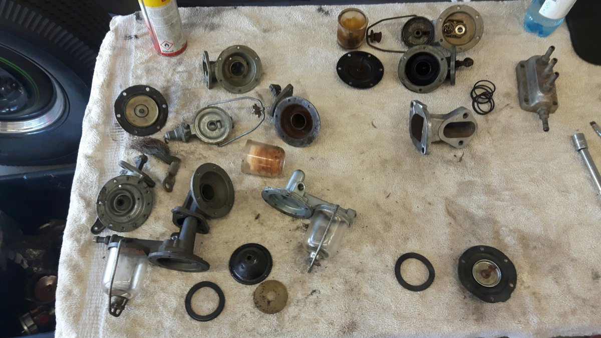

    Fuel pump rebuilt and installed. Fuel block "opened" and installed.
    Just ordered fuel inlets (carbs) from Stromberg UK.
    Linkage kit installed (very easy to adjust).
    Aulis

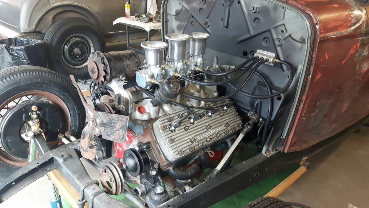

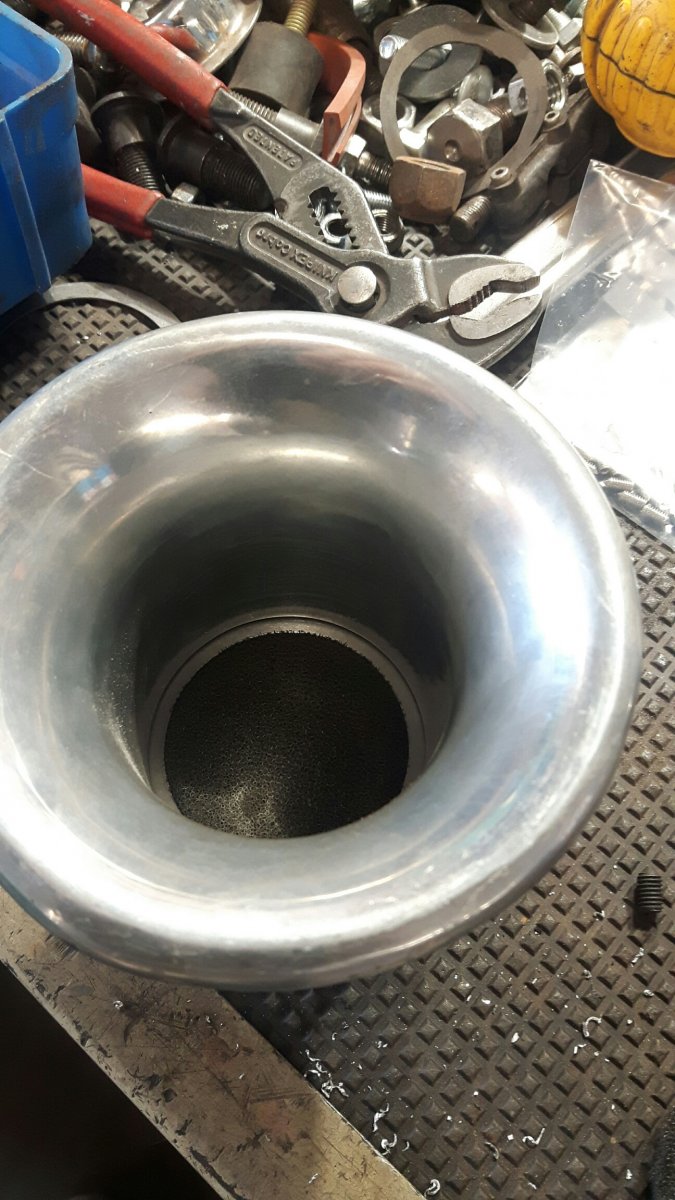

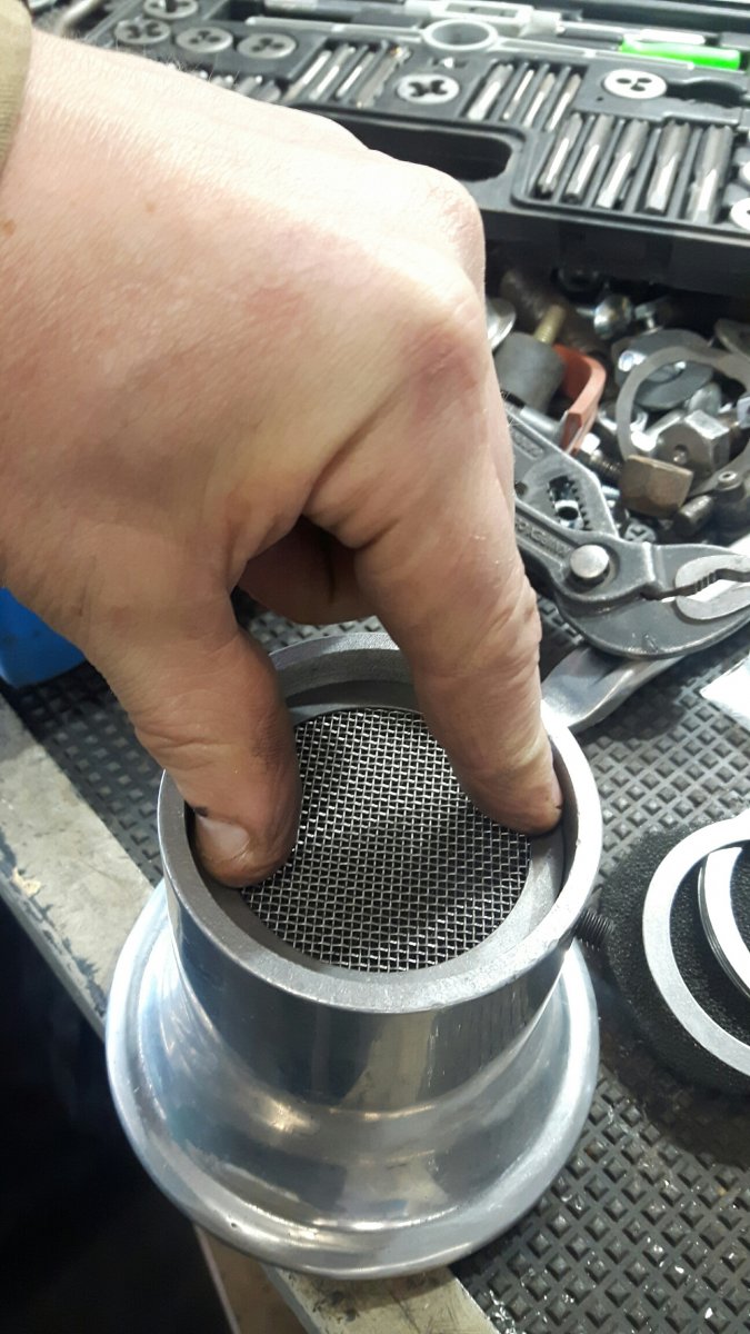

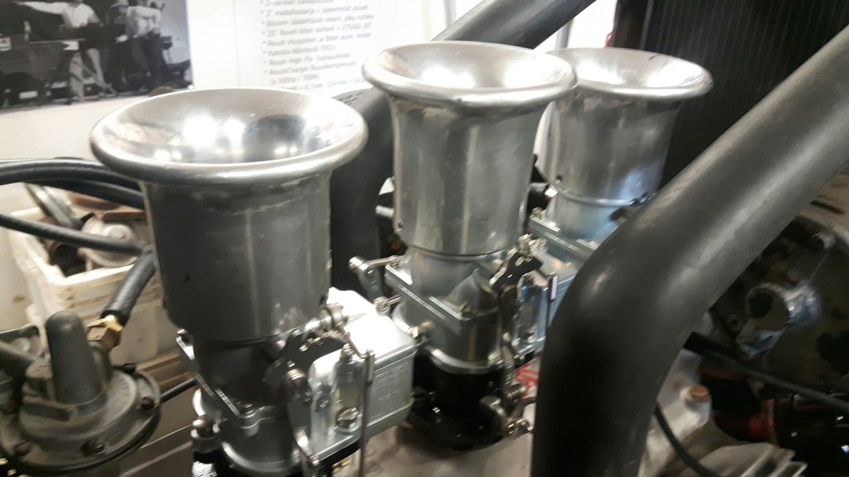

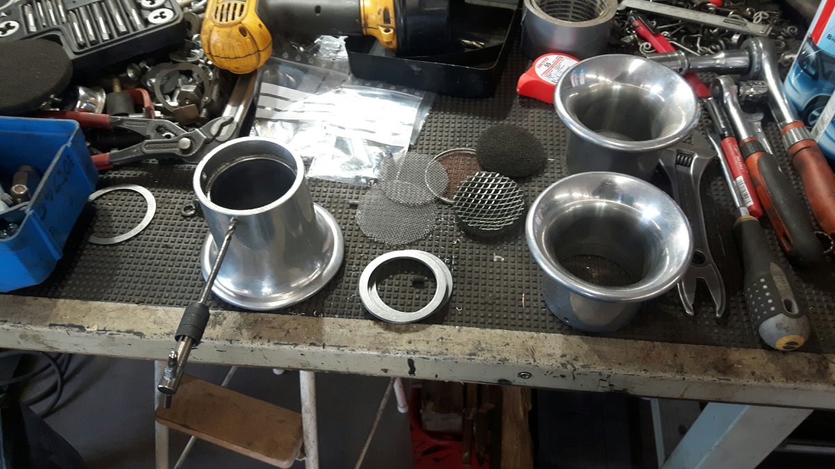

    jukka-414.jpg Thursday 14th of May: First in the morning I made velocity stacs ready and bolted on. I used bearing shims 2pc / velocity stack. SS net + foam. 3pc 4mm thread + locking screws.
    SPB and SPA v-belts arrived same time with shims from our bearing company (I work homeoffice, company is located in Helsinki). Yesterday I measure lenght, belts fit perfect.
    Aulis

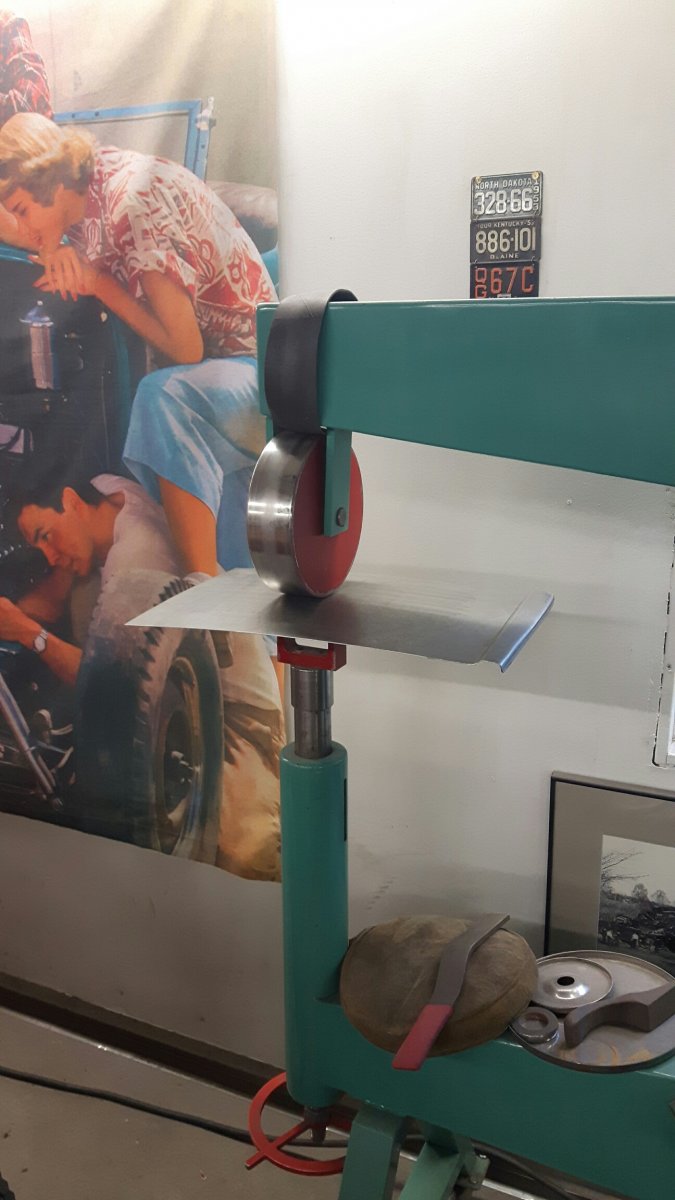

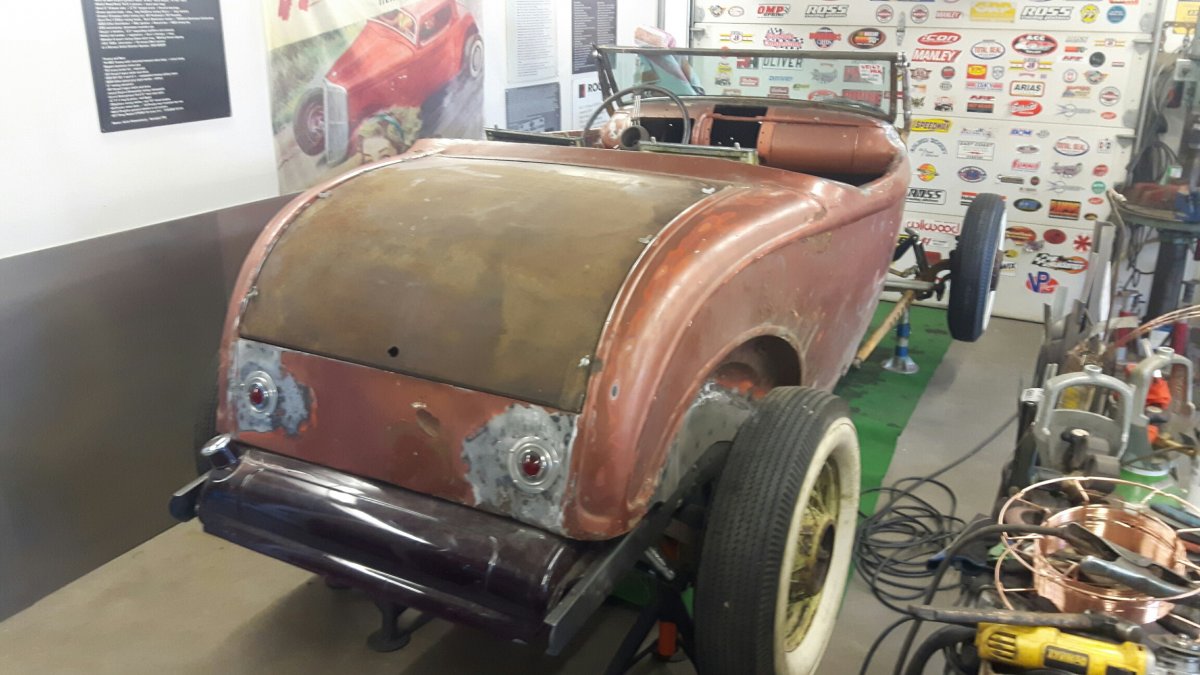

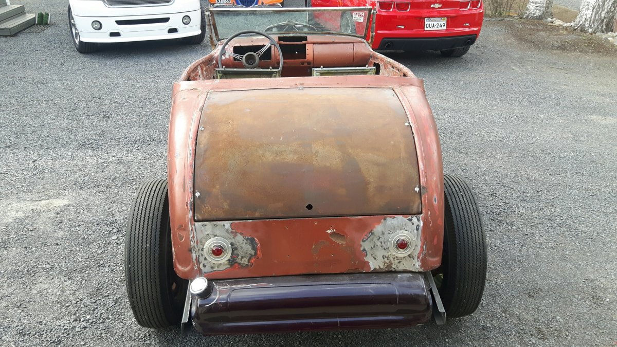

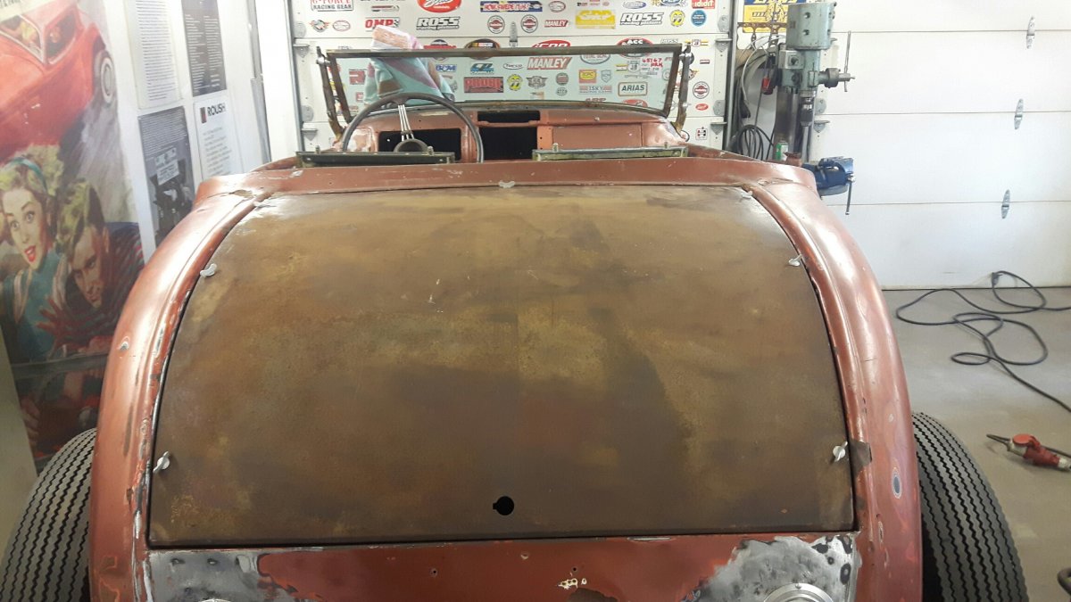

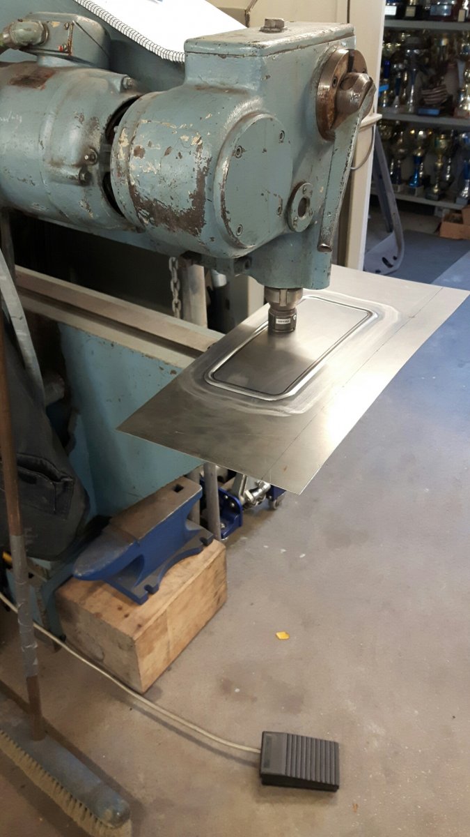

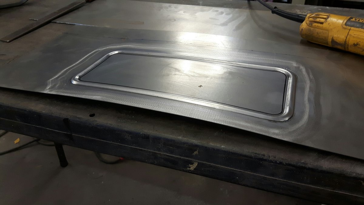

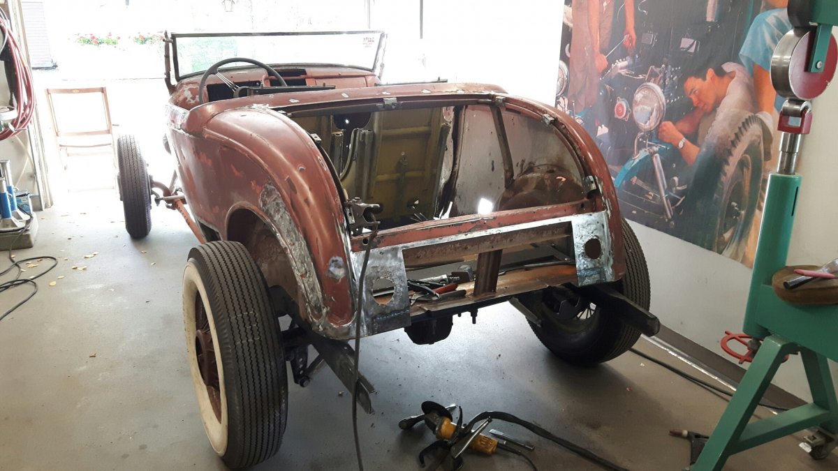

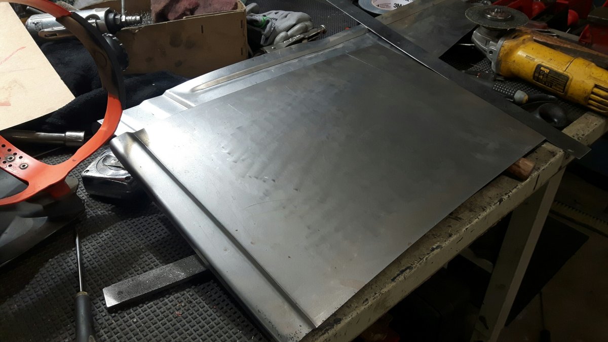

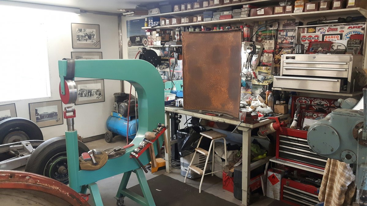

    Afternoon I welded, hammered, shrink, stretch and rolled with english wheel trunk lid skin. In this hot rod I will use only lid skin without any inner panel. I decided months ago that I´m not use any normal hinges and lock. I was decided that old Aircraft Dzuz fasteners are good for this car.
    I already made 3pc mountings and welded those on their places. 7pc total looks good to me.
    Aulis

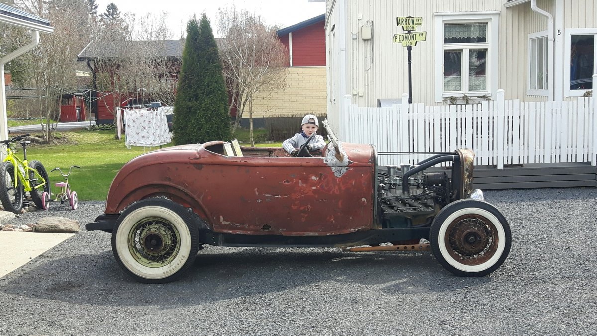

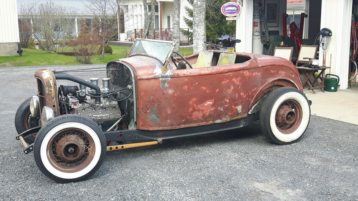

    This roadster is now "ready". I keep 3months break with this project. After summer I need to make aircraft style interior, exhaust, braketubes and hoses, fuel line, change all electric 12volt....
    Today, Sunday, bored holes for P-51 magnesium seatmountings, welded last 4pc trunk lid brackets and bolted on owners own original 1932 headlights.

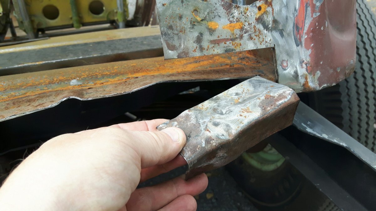

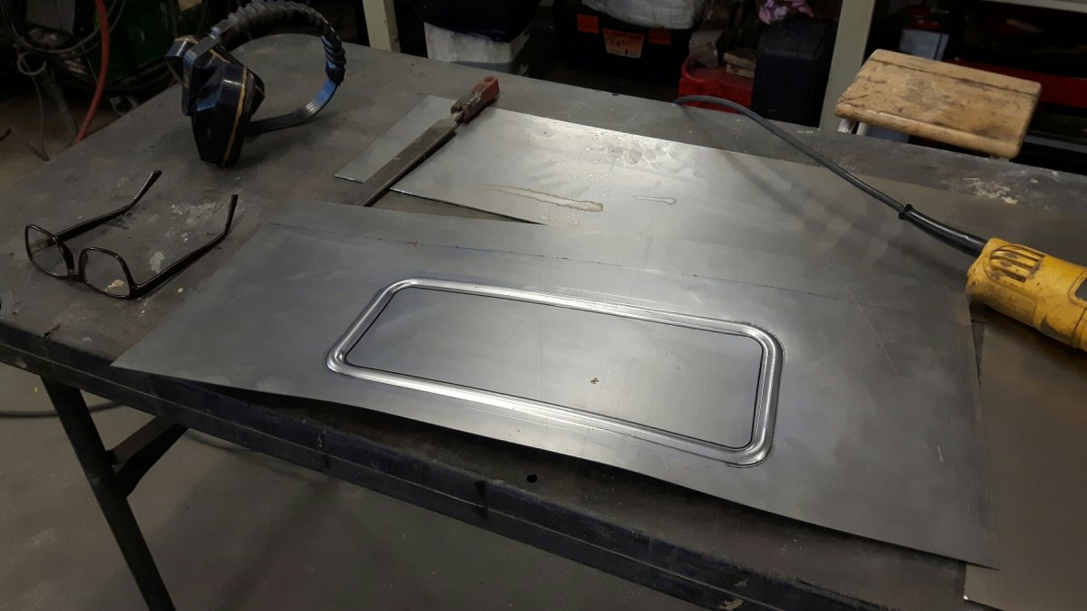

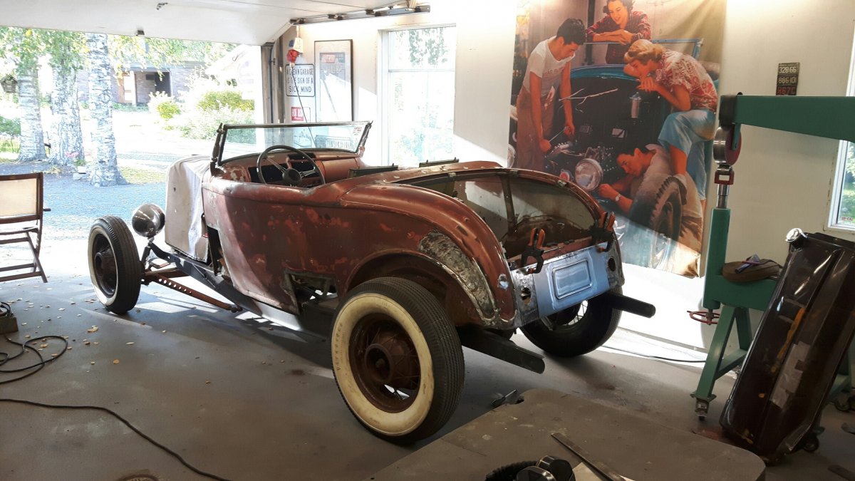

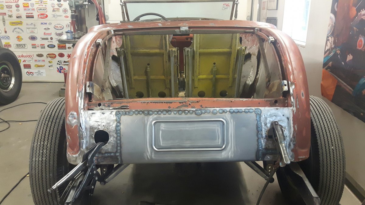

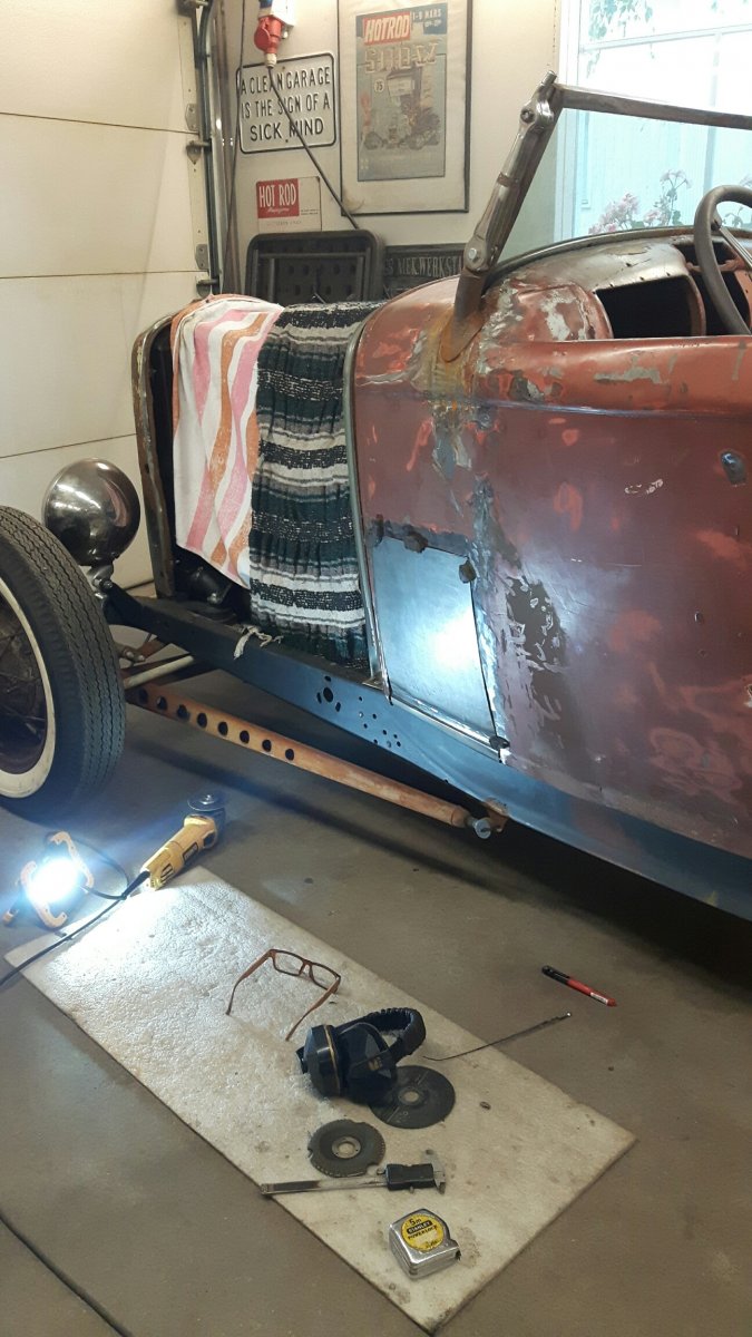

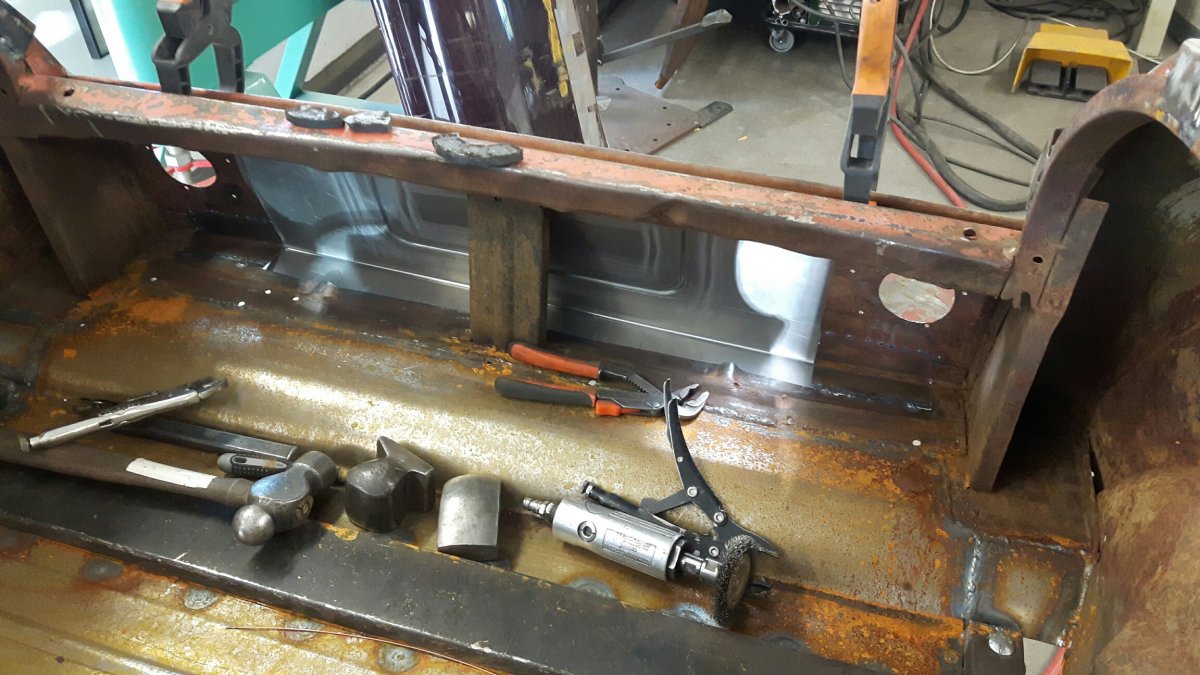

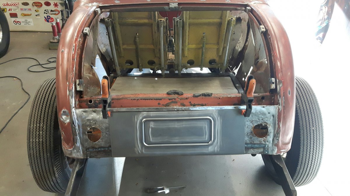

    10th of September I have been hammer rear panel lower corners and weld back on their places. Also hammered floor straight. Started to made new bigger part of that rear panel. I decided to change bigger part, because old one was so bad condition. Around taillights I have welded earlier before summer.
    I made "frame" for lic.plate. Tomorrow need to cut all ready and start to weld together.

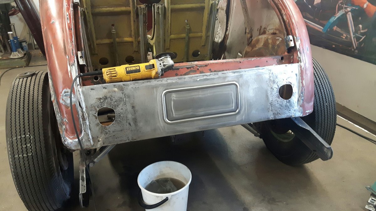

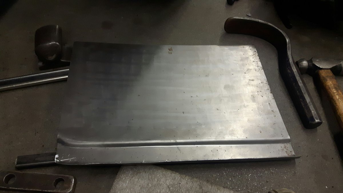

    Yestereday and Today I have spend time with my son. Today I worked only few hours with this panel.
    Today Sunday continue...
    aulis

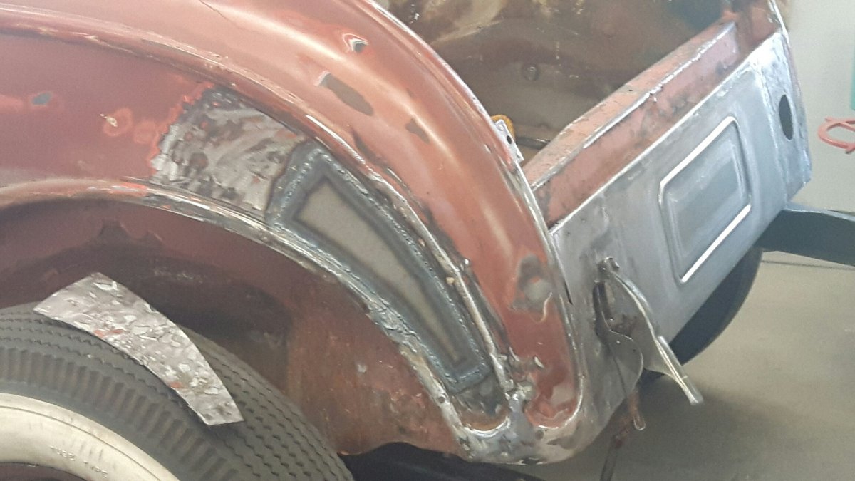

    Sunday morning TIG welded all around. After welding looks bad.... but I think it will be better after grinded and hammered.
    Aulis

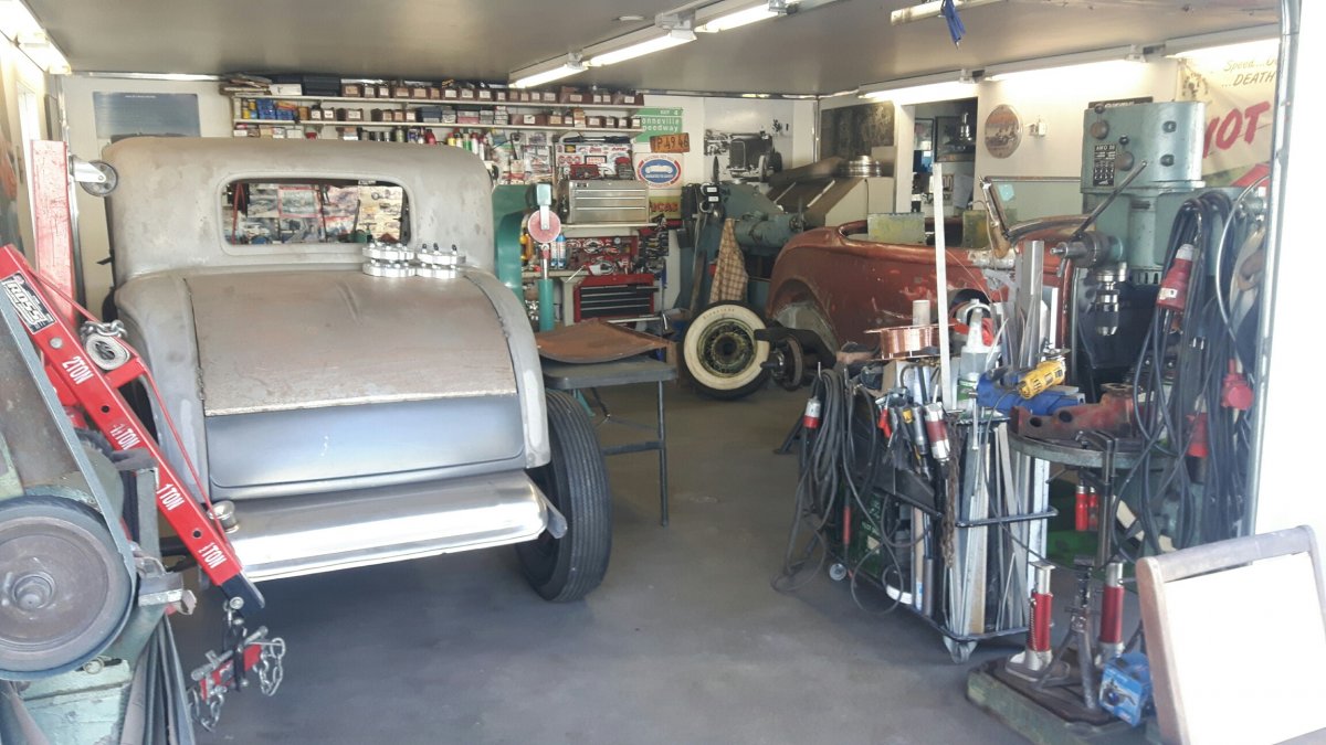

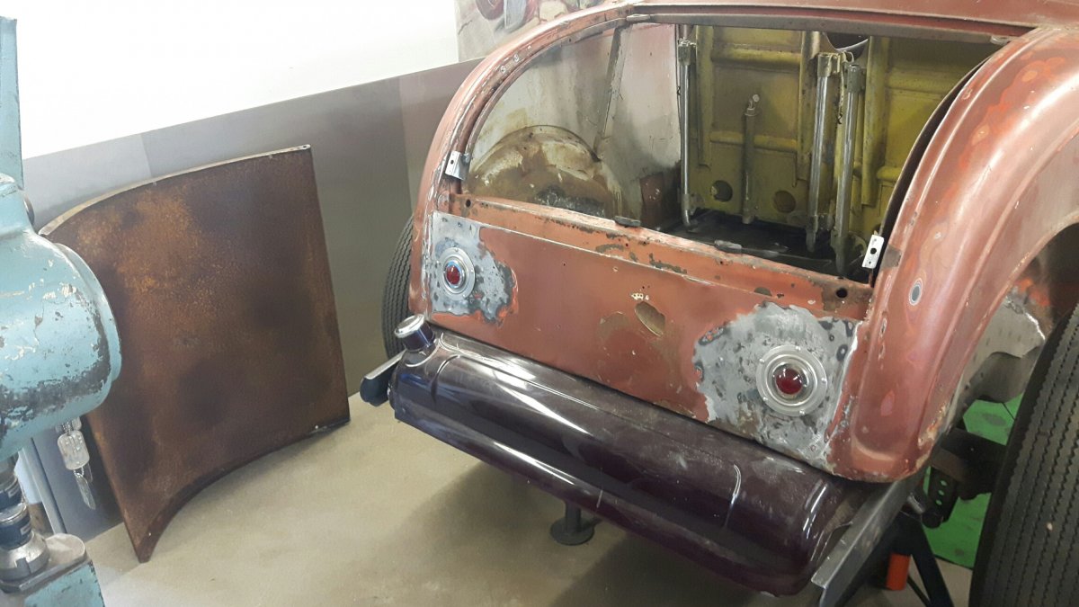

    Saturday - Sunday I spend my time in Kauhava LSK Business Park. Old military airfield which is now private owned and there is drag race raceway.

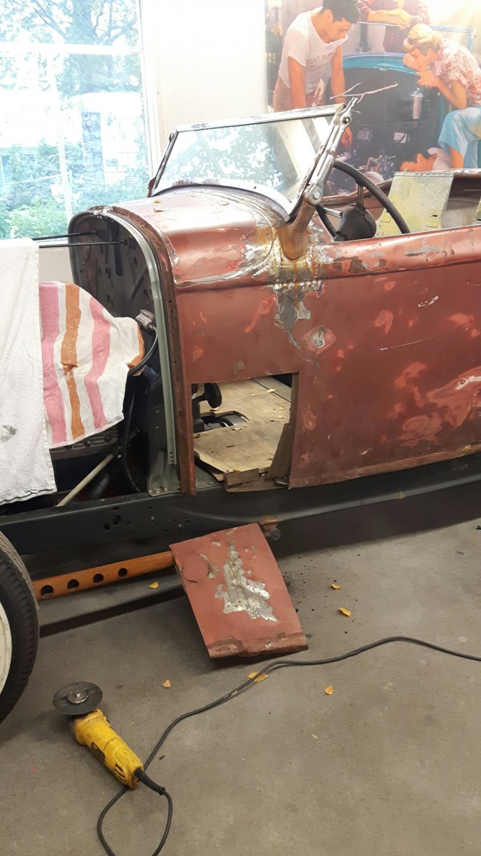

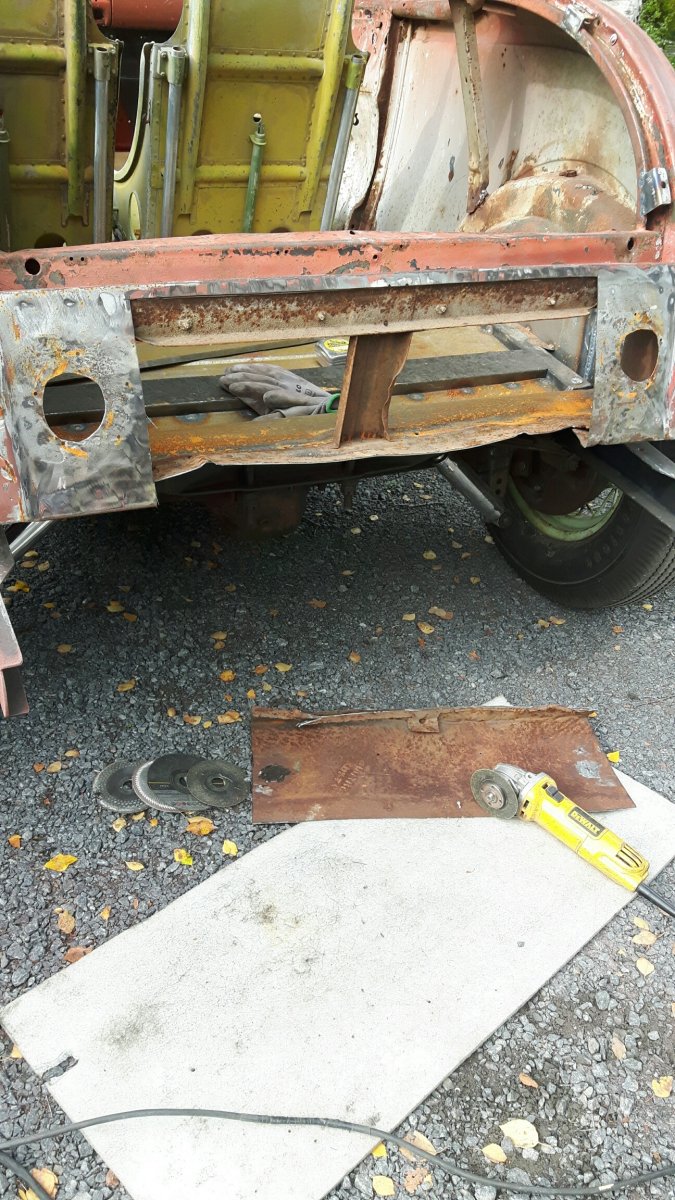

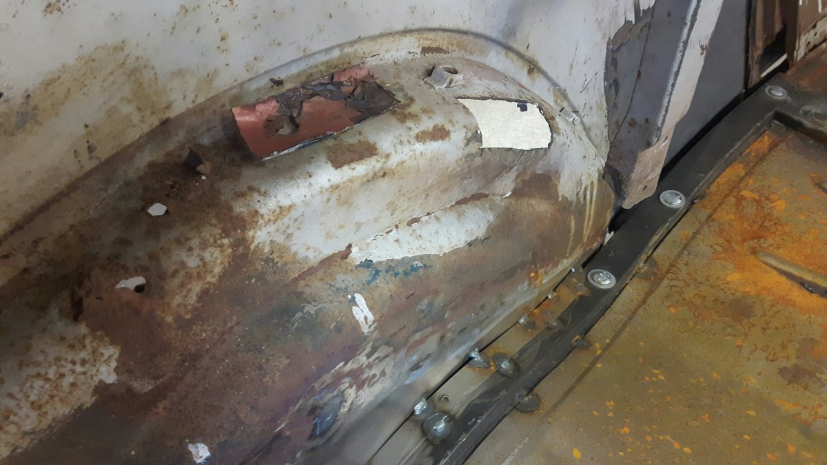

    Monday welded cowl all over. Yes, it shrink very strongly. I was only grind weldings down and must wait until I get firewall out and can hammer weldings straight.
    Tuesday made rear quarter patch panel and next panel after that. Too much putty, I must cut more.... Same time I weld rear inner fender holes. I made there one new piece, welded and grinded. Very much to do, but interesting job...so today continue 7.00 in the morning. When I have welded all, I to to sodablasting. All old paint need to remove
