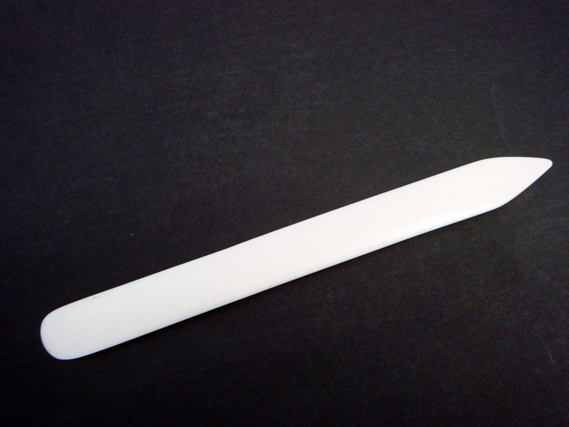

  6. In addition to the lubricants noted (I like the soap one myself because it doesn't attack the rubber and is fairly easy to clean up), I have had good success with a craft tool called a "folding bone" (available in better craft stores and of course online). It's original intent is to crease a paper fold crisply, but with both the pointy end and the rounded end it's pretty versatile for tucking weather strip in channels. It has a nice eased edge with a thin taper. Once you get started you get in a rhythm of align the seal edge with the channel and then tuck, align, tuck, repeat till done, being careful to not stretch too much.
