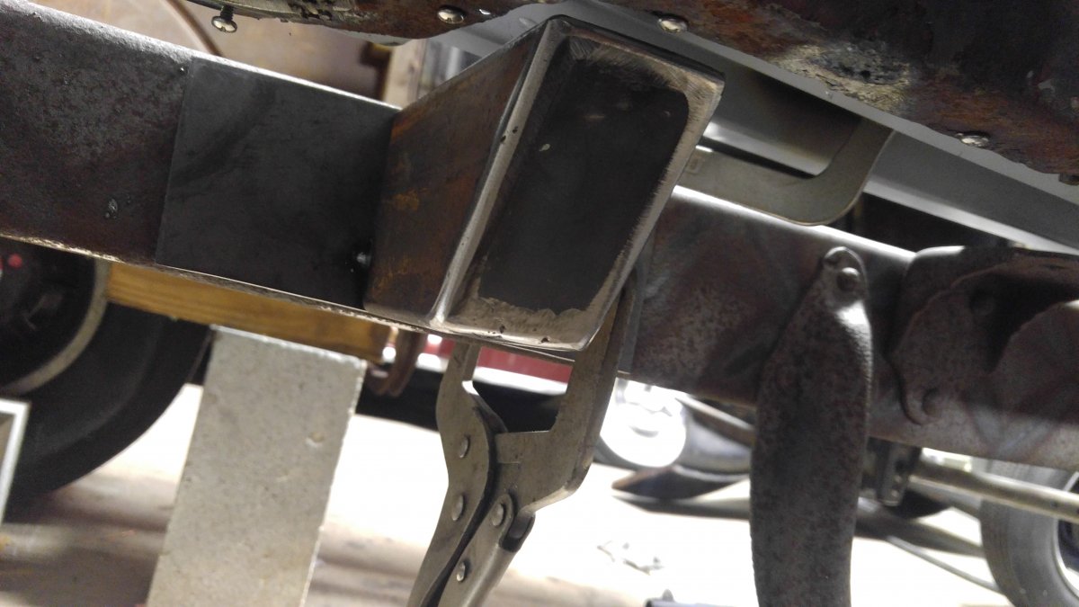

    Message_1482199032668.jpg Moving right along... Need to start thinking about a rollcage. My buddy Blacksmith Tom helped with a brainstorming session. We got the basic cage laid out and attachment points figured. Now we need landing spots. Main hoop goes here just forward of the wheel house and thru the subrail i made.

    Message_1482199093845.jpg Heres the mocked up outrigger for the main hoop. I will clean them up its basically just 2x3 tube. It will be thru bolted on the frame rail.

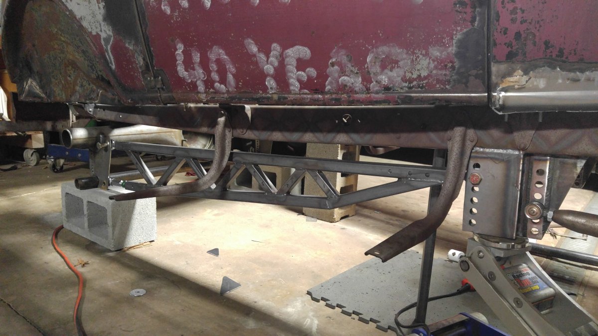

    20170123_192449.jpg finally got one ladder TIG welded. By the time im done i should be a decent welder these suckers are stout!

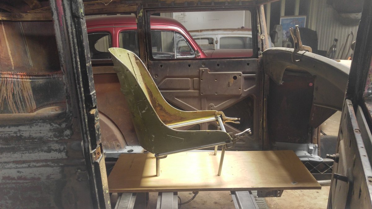

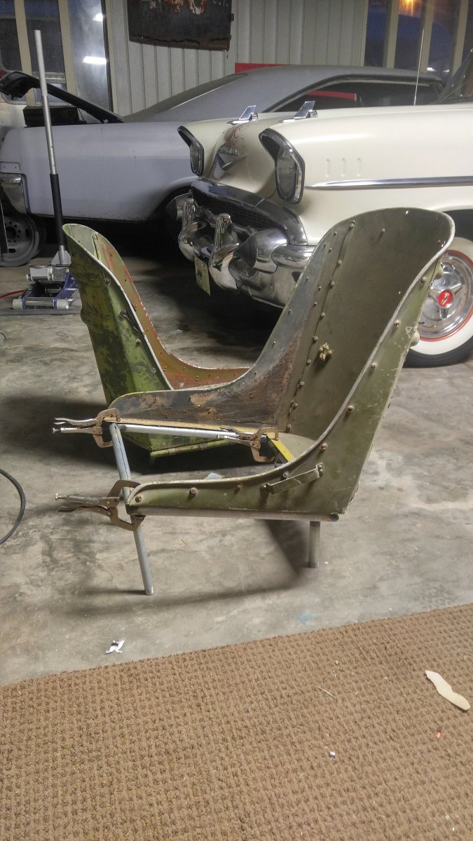

    I scored these old bomber seats years ago. They are just the backs....no bottoms or frame or legs. Quick trip to the hardware store and my buddy Jon turned me onto electrical conduit fab its cheap and light too!
  28. Cabbage
    Joined: Apr 17, 2006
    Posts: 729
    Cabbage
    1. S.F.C.C.
  29. Cabbage
    Posts: 729
    Cabbage
    1. S.F.C.C.
    Message_1516061332382.jpg Added some thin plate for bottoms and BAM! One gasser seat! I made the legs with threaded rod inserts so i can adjust the hieght and dial in the lean. They turned out nice
