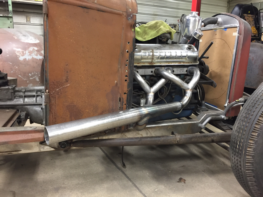

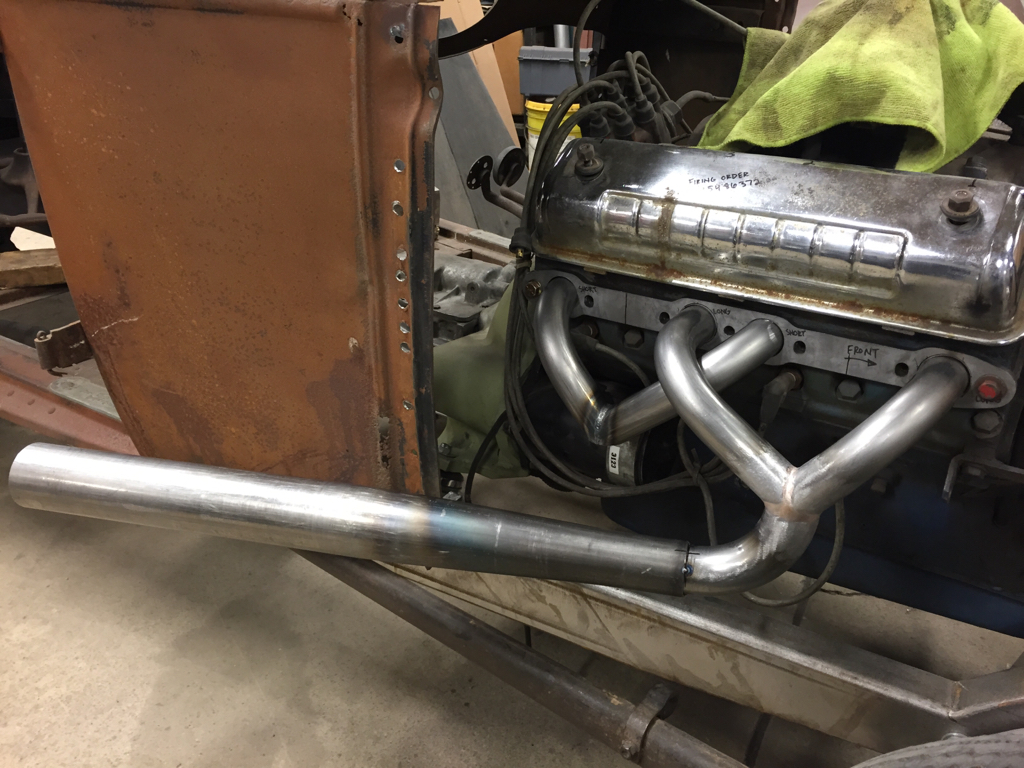

  4. Nathan,
    Was wondering why on psgr side of the engine your header pipes cross over on the 2nd and 3rd exhaust port. does it have to do with the firing order of the y-block? Or are you trying to attain a certain exhaust tone? Keep up the great looking work!
    Brad.[/QUOTE]

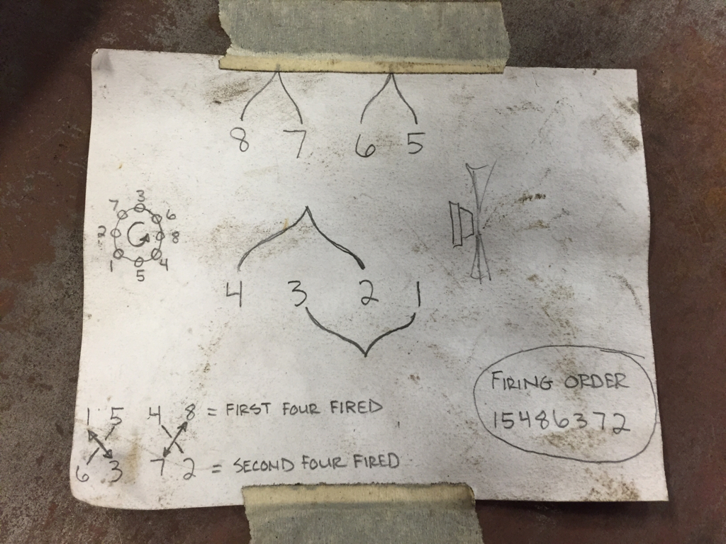

    It has to do with the firing order! Here's a drawing of how it works if are curious or need to know. You see how each head has two Y's? The object of tri Y headers is for the two exhaust valves that feed any one of those Y's to be as far apart on the firing order as possible. That increases the velocity of the exhaust gases leaving through the header, because there is only exhaust from one valve going through any Y at any time. Then they all come together in the third Y.
    4 into 1 type headers with collectors are really better suited for race cars that are running high RPM all the time.

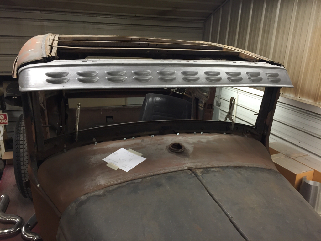

  14. Had the sun visor louvered!
    View attachment 3119342 [/QUOTE]
    They actually number the cylinders down each bank like that? I'm not familiar with Y block engines, but on most V configuration engines I'm familiar with the cylinders are odd numbered on one bank and even numbered on the other. So 1 & 2 would not be next to each other, each is on a different bank.

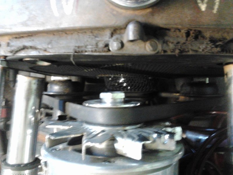

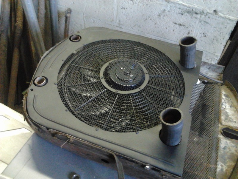

  18. I really like some details on your project, especially the radiator inlet, the filling reservoir and the fan shroud
    We've made one for my modified but to hide the electric fan (yes I know... it's not so cool :/)
    In place :
    I also have a A coupe project with a Y-block engine so I will follow yours with interest :)

    They actually number the cylinders down each bank like that? I'm not familiar with Y block engines, but on most V configuration engines I'm familiar with the cylinders are odd numbered on one bank and even numbered on the other. So 1 & 2 would not be next to each other, each is on a different bank.[/QUOTE]
    Yep, just like a flathead... And most other Ford V8's

    Here you go, Blues4u. I'm not sure why it's so blurry, but I think it's readable.

    Thanks, I learned something today, so whatever else happens the day is a success!

  24. Thank you! Nice that looks good. Hey an electric fan still gets the job done! Any pictures of the coupe project? Love to see them.

    I like the exhaust system except for one thing, the crossover pipe.
    I have been told over and over again by many old time hot rodders that a flathead and or a Y Block will sound better without a crossover.
    So, on my RPU, no crossover.
    The stainless looks good, I went with steel and will have the whole exhaust system ceramic coated. They do a nice job and the coating is inside as well.
    loudbang and NathanxStewart like this.
  27. From our experiences, crossover pipes always sound better with whatever engine and it makes more power in most cases as well. I guess it depends on what sound you want. My headers will be ceramic coated inside and out, but the stainless will be left bare.
    BigChief and loudbang like this.
  28. Blue One
    Joined: Feb 6, 2010
    Posts: 11,503
    Blue One
    from Alberta
    Well, that may be true for modern engines as for power production, but I have some friends who grew up with the Flatheads and hot rodded them.
    They will tell you otherwise as far as power or sound goes.
    NathanxStewart likes this.

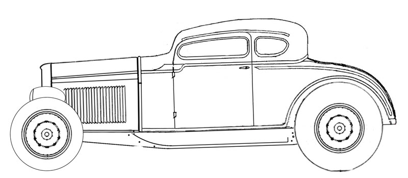

  29. Yes of course, but the frame at this time... I'm working to rebuild my old farm since one year and that takes all my time.
    The idea is here :
    And 2 piccs from the frame :
    The build thread is here :
    http://www.jalopyjournal.com/forum/threads/no-compromise-ford-a-coupe.924570/
    Thanks for interest :)
