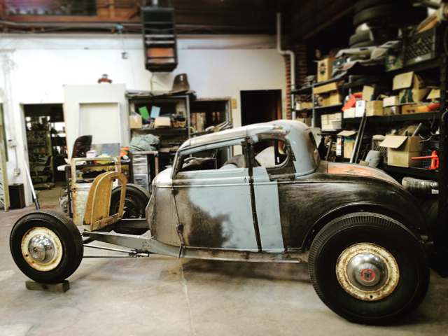

  5. Yeah man! This is pretty much what it looks like right now.. Except it's now in my tiny home garage. And I'll be changing a couple things coming up!
