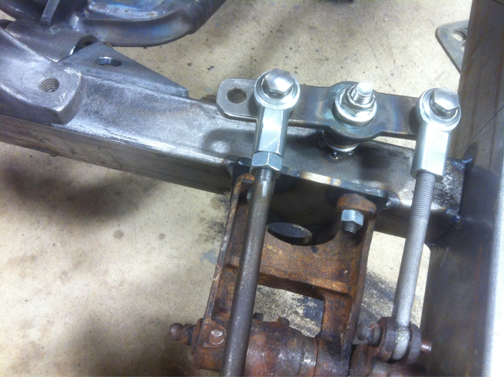

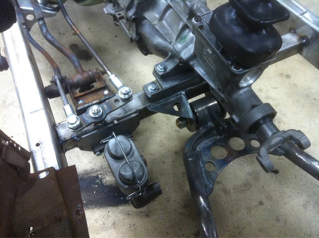

  5. Used a 47' pickup truck pedal assembly and got it all mounted up with the dual reservoir master cylinder. Had to make a bell crank cause the clutch pedal is a pusher and the clutch fork pulls.

    I like the bell crank idea , lesson learned lesson applied

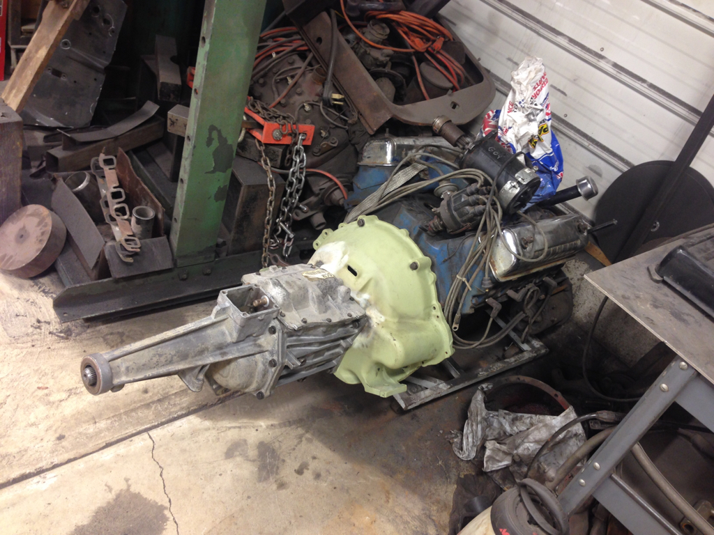

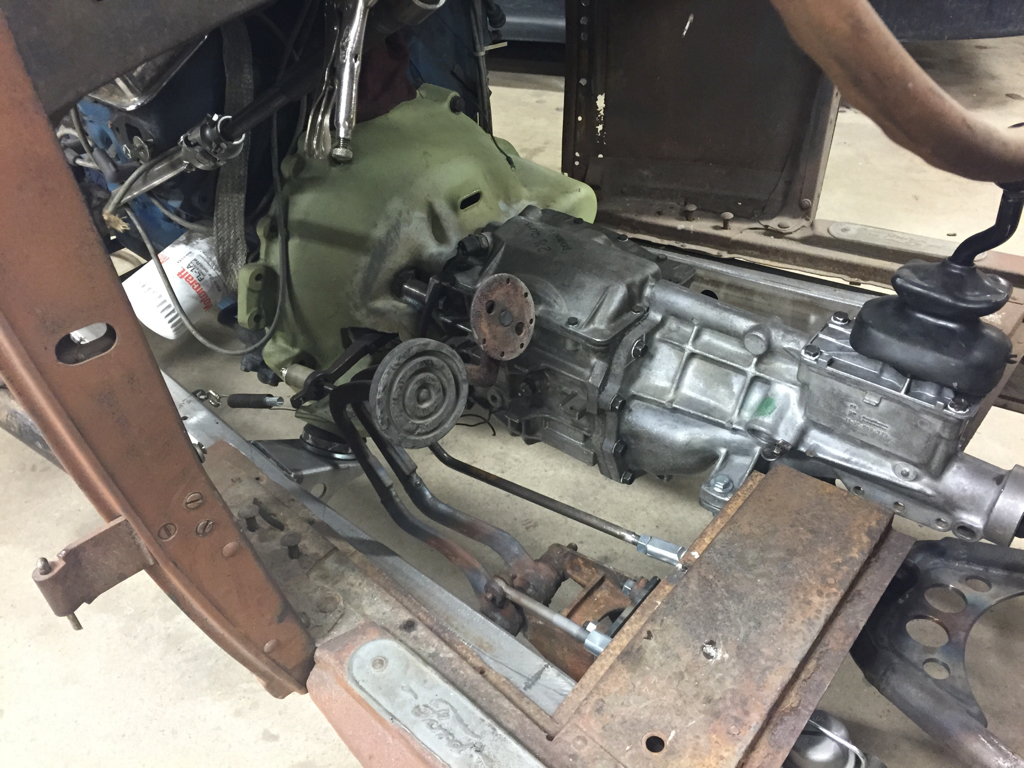

    Looks really good. Great progress. Have a question for ya. In a previous post, you showed the trans with shifter further forward than in your latest post. I think you said it was a t5. Which tail housing are you using? Plan on using a t5 with the shifter in a forward position, looking for info, tips. Thanks

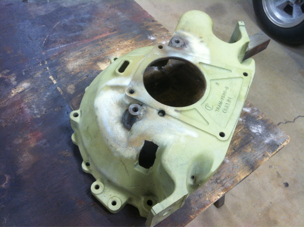

  12. Nathanxstewart, you've peaked some yblock/T5 interest here....
    At some point, could you give the P/N for the bell housing you used?
    Thanks
    NathanxStewart and mike bowling like this.

  16. Thank you! Yes it was farther forward because we thought the shifter would be too far back, we used a s10 tail housing to move it forward. It ended up being too far forward so we put the mustang tail housing back on to move it back in the right position. If you plan on using the s10 tail housing might want to use a longer shifter arm so you can reach it.

  21. Thank you, and I can actually give it to you right now!
    TAAM-7505-B
  22. I put the P/N to the bell housing in post #81.
    The clutch fork is original to the '62 3 speed bell housing.
    The clutch and pressure plate are '68 Torino (new)
    The throw out bearing is the only part other than the bell housing ,that had to be modified . We cut the ring off of the '62 throw out bearing that the clutch fork fit into, and carefully tig welded it to the new '68 Torino bearing flange, getting rid of the clips that were on the Torino bearing flange. The Torino throw out bearing fit the snout on the T5 perfectly. It was a piece of cake, and now it all works very smoothly.
    Thank you Mike, really appreciate the kind words. No I couldn't ever get sick of hearing someone appreciating our craftsmanship, thank you again. Yep that's a customers '34 coupe, really cool car.
    lothiandon1940 likes this.
  23. We talked to John Mummert before starting on that and he helped us figure out what clutch pack to use. I believe we did it the same way he does, except he has his own throw out bearings made ( not for sale separately ), and we combined the '62 and '68 bearings to make it work.

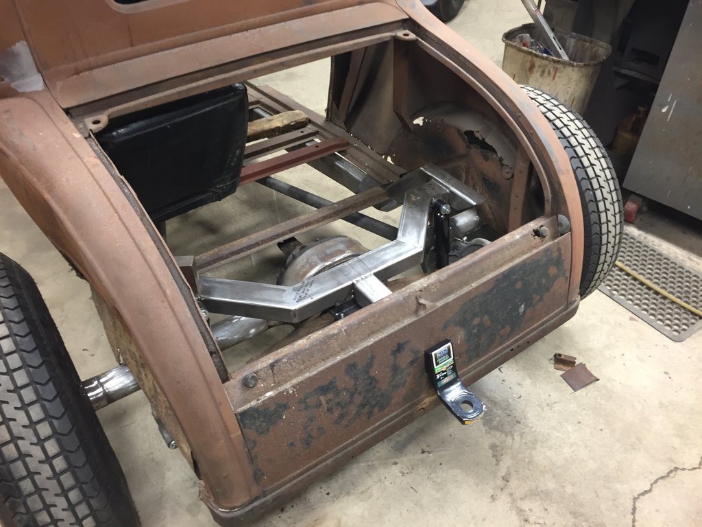

  28. I plan on building a single hauler motorcycle trailer to tow behind my coupe so we built a trailer hitch. We used a special broached tubing made for hitches to get a perfect fit.
    DylanHill1931, D-Russ and AHotRod like this.
