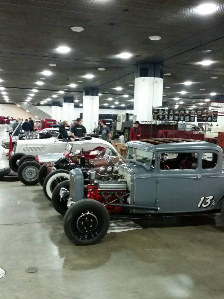

  5. Hey everyone!! Been awhile since I've been on here. Like my dad said we had a blast at the Autorama and I met a lot of amazing people! Here are some badass pictures that were taken over the weekend.

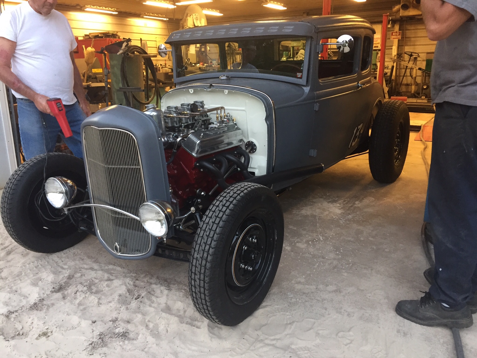

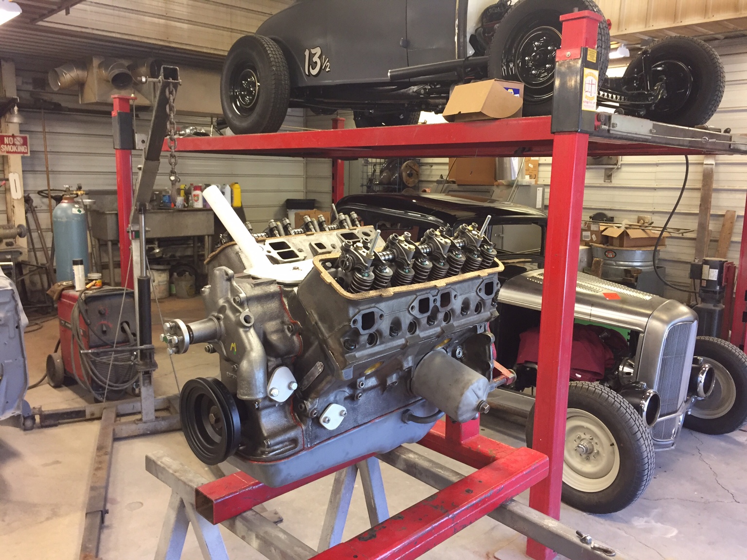

  21. It's been awhile since I've posted about the car on here. Since my last post I had a new Y-block built for the coupe, a very healthy one.
    Dad and I went to a friends shop and found a 292 he had sitting around, a good one that was freshly rebuilt. Don't know exactly what was all done to it but I do know it was bored 0.40. So we bought the engine.
    Brought it home and I immediately tore into it. It definitely looked like a good block.
    Took it over to Radar Industries in Sunbury, Ohio (which is about 5 miles from my old mans fabrication shop) to have them look it over, make sure it's a good block, and to do the machine work/assembly.
    Radar told us the engine was good and to order parts.
    Here are the specs on this rowdy little Y-Block:
    314ci, 11: 1 compression, had the crank offset ground to the 312 stroke, bored .060 over 292, puts out roughly 330 ft lbs of torque and around 325 hp (educated guess) haha
    Cam specs:
    Clay smith cam, 240 duration @ .050 and .485 valve lift
    Got a set of '57 ECZ-G posted heads. Tim McMaster did all the good stuff to them, as well as pressurizing and rebuilding the rocker stands cause everyone knows how Y-Blocks had a problem getting oil up top.
    Fenton tri power intake with Holley 2110's and progressive linkage which was my 18th birthday present from my old man. This intake isn't going anywhere, as well as the car!
    Engine is back and it's time to pretty her up!!
    I don't know what this color red is called, my friend that owns a body shop let me dig into his pile of some old Centari paint he had laying around and I found this red and I said that's perfect. What made it even more perfect is that it was free!!
    Engine is in, hooked up, and we're ready to MAKE SOME NOISE!!

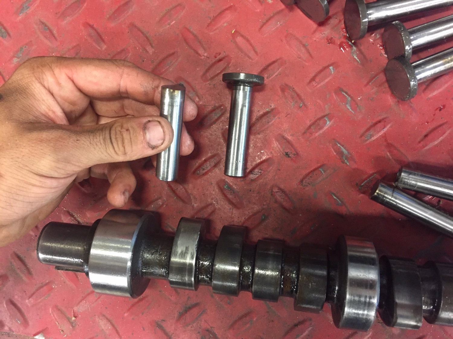

  25. Finally got the coupe on the road and took it to the local cruise in, everything seemed good and car seemed to be running strong!

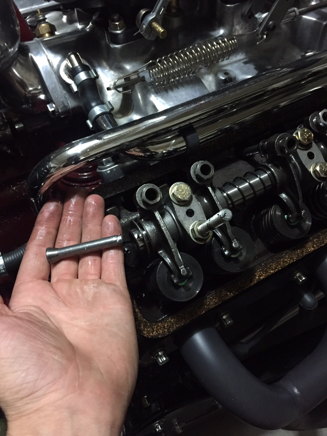

    About a week or two has gone by and I had been driving the coupe and working the bugs out of it. Had the car idling and just happen to feel the drivers side exhaust blowing cold? So I started to investigate. Checked the plugs, all looked good except #5. Plug was fouled out, checked for spark and was good there. Pulled the valve cover and found this
    Broken push rod, not good.
    Did more investigating, exhaust push rod bent and fell in the valley.
    Turns out I made a rookie mistake. The front intake bolt was too long and protruded through allowing the intake push rod to be rubbing against the bolt and ended up breaking in two. Which I'm guessing made the valve lash adjustment get out of whack and that's why the exhaust push rod bent?
    Thought I was going to get away with replacing the push rods. I thought wrong.

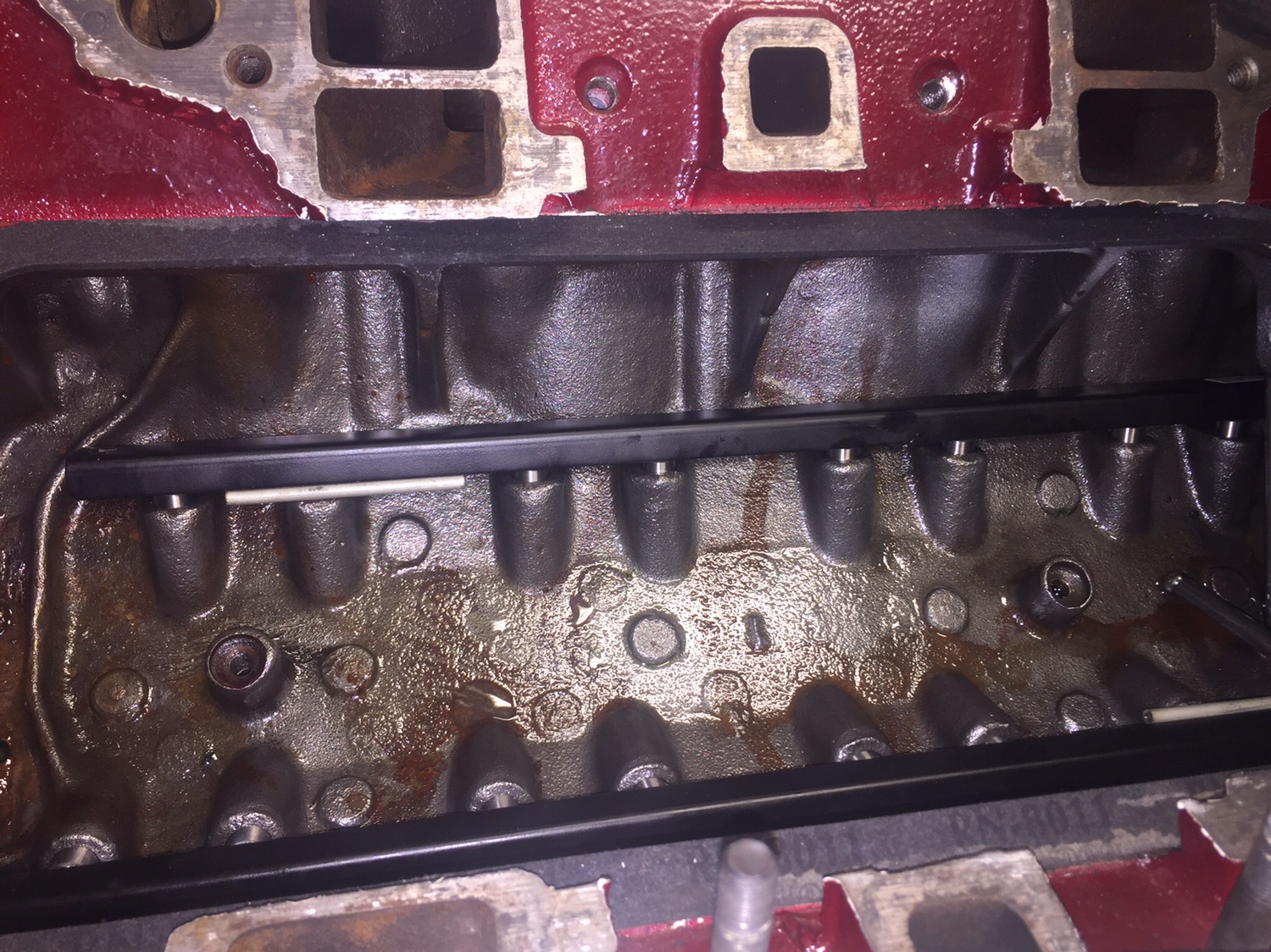

    Put new push rods in, drove the car for about 10 miles... cam goes flat.

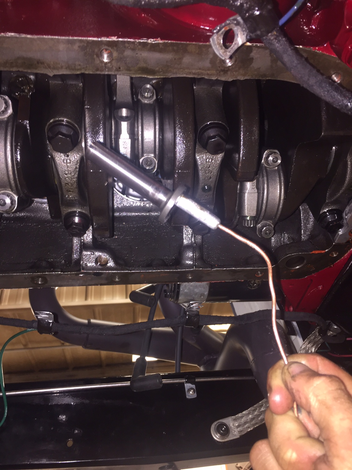

    Long story short, tore it all apart and that one intake bolt did more damage than I thought. When the push rods fell, that allowed the cam to smack the lifters and break them. Then putting the new push rods in made the rough broken lifters ride on the cam and grind the lobes flat.
    Took the main caps off no scoring or any damage to the bearings, or the cylinder walls... thank god.
    Put new lifters in, cam, and push rods.
    If you know Y-Blocks then you know that the lifters go in from the bottom. Well with the engine still in the car it makes it a little difficult to put the lifters in cause gravity fights you as well as the crank being in the way. So what I came up with was putting two strong tool magnet holders in the valley, then took my magnet stick, put assembly lube on a lifter and fished it through the crank and stuck up through the block and to the magnet. Then slipped the cam right in. Was not easy, and it took me about an hour to put a set of lifters in but it worked!!
    What a pain in the ass! But that's hot ridding right??
    Finally got the car buttoned up, started it, broke in the cam and everything seemed good. Oil pressure good, engine is running strong!!
    STOKED!
