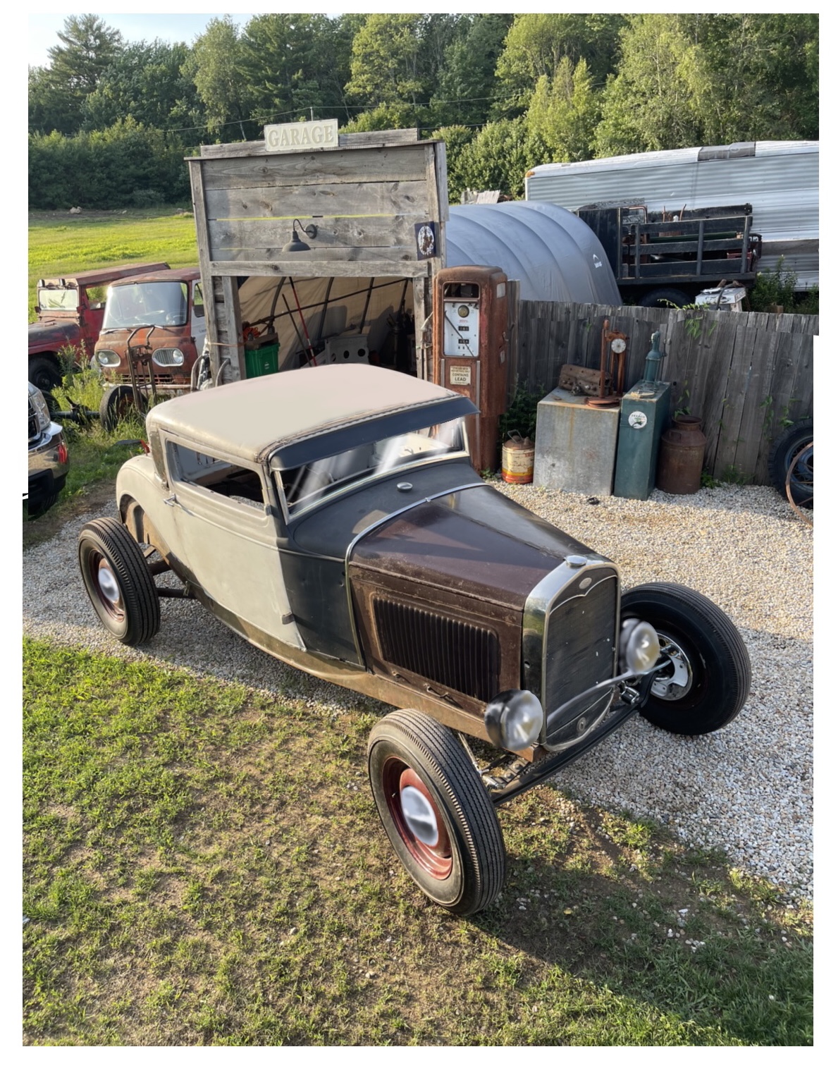

  1. I was able to get both doors opening and latching finally so now that everything is tacked in place from the B pillars forward I’ve now moved onto the rear of the car turning my attention to the trunk/gutter and tulip panel IMG_7219.JPG here’s the lower section of the tulip panel patch that my father bent up at his work and I curved to match the old one. I clecoed the gutter to it to start fitting it the the quarters. IMG_7220.JPG IMG_7221.JPG

  2. IMG_7486.JPG IMG_7487.JPG IMG_7479.JPG 64720590485__56A94191-49F4-4E87-A1EE-F6D4741B3D4A.JPG 64720928726__ECC157BB-9EB5-4C10-AF16-688EEFA95A91.JPG 64720929606__ECB0F3CF-0FDD-48AB-BCB3-86F4D4CB3485.JPG finally remembered to take a picture of the window opening which is roughly 12 1/2” tall on the Vicky doors. The model a truck I have here measures at 14 7/8” tall but I can’t remember if the truck/sedan doors are taller or just longer. Also decided to finally go at the tulip panel and got it all fit and tacked in place after a lot of massaging the lower patch panel I then measured out the back window chop. I did it at 1 1/2” and that just didn’t look proportional so I settled for roughly 3/4” so I’ll add some back but oh well. Inner trunk skin will be here soon and I’ll finally be able to fit it to my outer skin and begin to tack weld the gutters in place once proper fitment is achieved IMG_7348.JPG

  3. IMG_7492.JPG IMG_7499.JPG IMG_7501.JPG IMG_7496.JPG pushed it outside after I finished up for today and realized all the patches are in place and this is how she will look! Super excited that it’s finally taking shape, been a long time coming!

  4. Proportions are really nice!

    It's a Man Quilt...:D...looking mighty awesome Dylan...can't wait till it's all 1 color even if its primer...any side profiles with the latest mods all roughed in?
    You have both side upright rear beads on as well?...that means a door trim is on the way soon...
    Bobbed frame out front...I missed that even though I probably liked the post where you mentioned or did it...:)...are you squaring it off, capping or are horns going on?

  9. X2. It's a little nicer than a stock A coupe, but hasn't lost it's easily recognizable boxy Model A shape.:)
    And more importantly, by keeping the A hood & grille shell, it doesn't look like it's trying to be a Deuce.:rolleyes:

  14. Same here man, gonna probably do a quick maroon paint job with a rattle can for right now and then come back later and give the whole car a nice one.
    Yep both B pillars are fabbed however I still need to attach to the subframe.
    Yeah never been a huge fan of frame horns without fenders. Had to cut them off. I will curve the stubs and follow the flow of the grille shell!

  28. I’ve been trying my damndest to convince myself not to chop it…I feel I may have to with as tall as it looks after I got the window filled in and primed all one color…it will only go 2 more inches and I’m not chopping it right now. I will be moving in with metal repair and getting it running for the race next year if I have time before I’ll chop it. IMG_0585.JPG IMG_0592.JPG 2B253BB5-2769-425A-858C-4240BAC0741A.jpg
