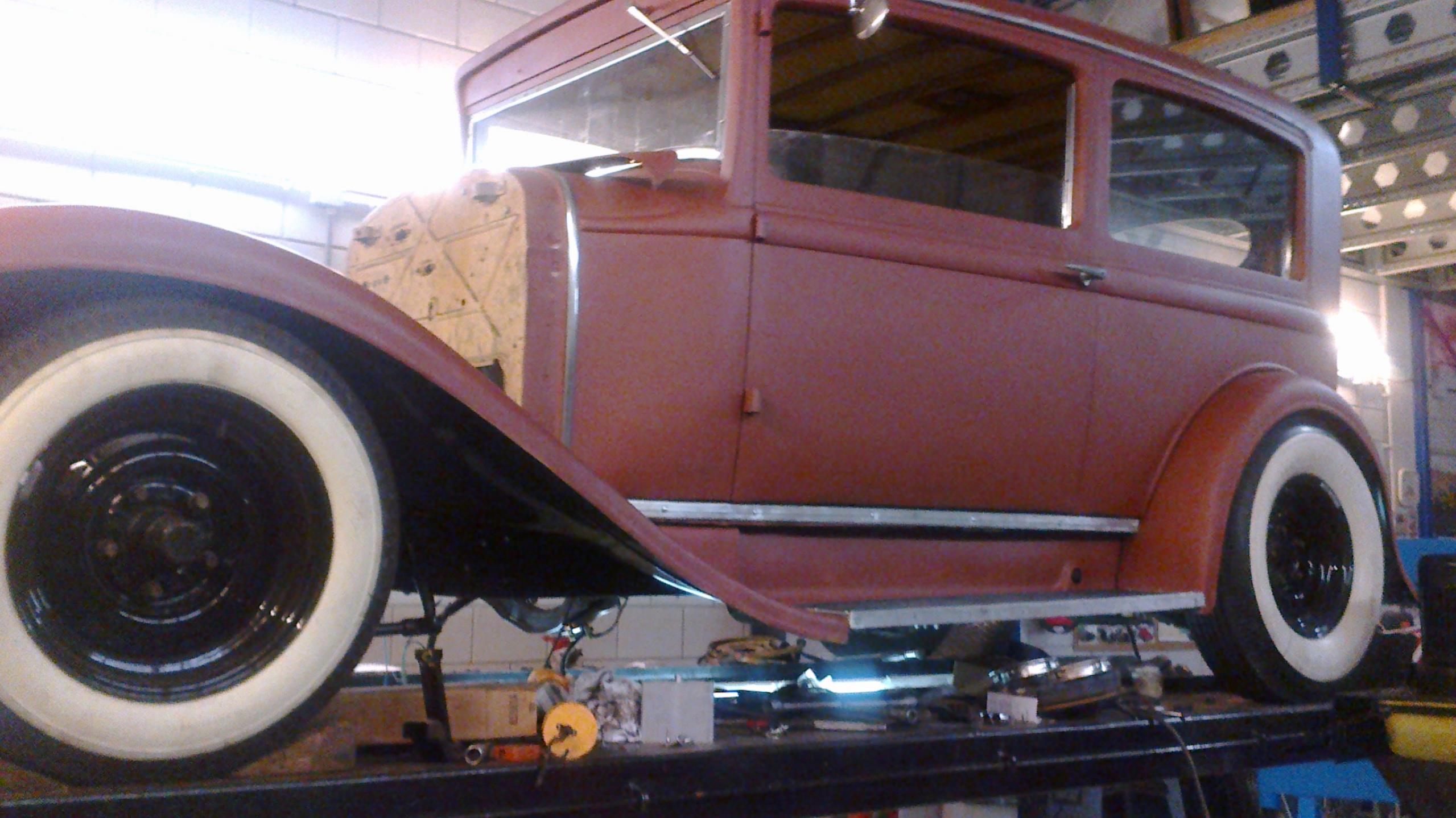

    Nice project, I am waiting on the other side of the world what you are gone do with the front end of the body, I am thinking of putting a '31 Ford visor on it. The rear oval window, well I am thinking of removing it totally and put something really different in it, do not know what..
    keep in touch
    Leen

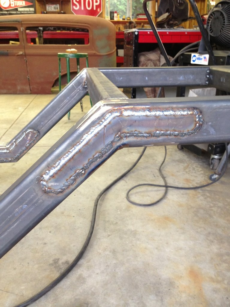

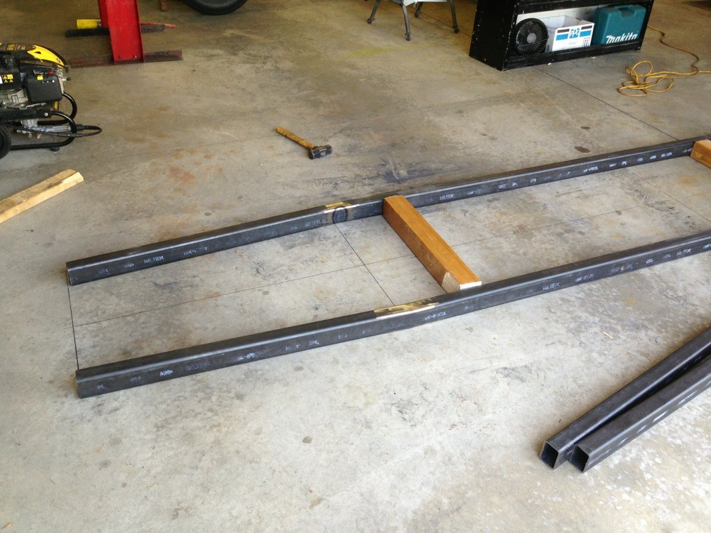

    Got metal for my frame yesterday, started making the rails
    Cutting for the Z. Ended up going with a 12" kick
    The cross pieces aren't welded in, just set there to get a better idea of the finished product

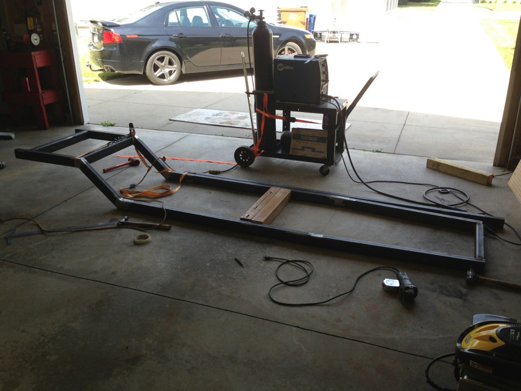

  18. charlesincharge09
    Joined: Nov 1, 2012
    Posts: 280
    charlesincharge09
    from Wisconsin

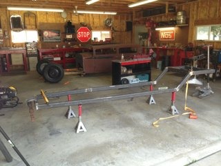

    Got some more done on the frame.
    Welded the cross pieces in
    Got the front perch
    Modified speedyway mount
    So this scared the shit out of me. Turns out one of my jack stand is bent and lower than the rest

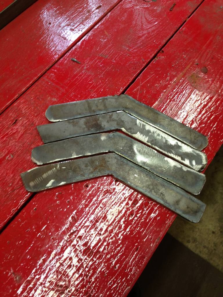

    Thanks guys! It was a challenge but was worth the learning experience. I got $170 into metal and still have 10ft left, so I planned it out pretty well, putting the rod ends on the split bones tonight, and cut out some fishtails with the plasma cutter at work, hopefully I will weld those on tonight too

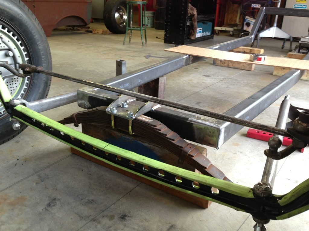

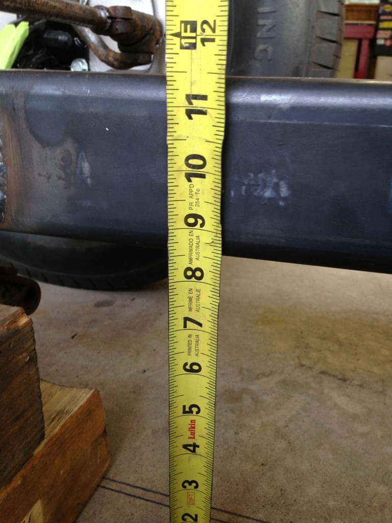

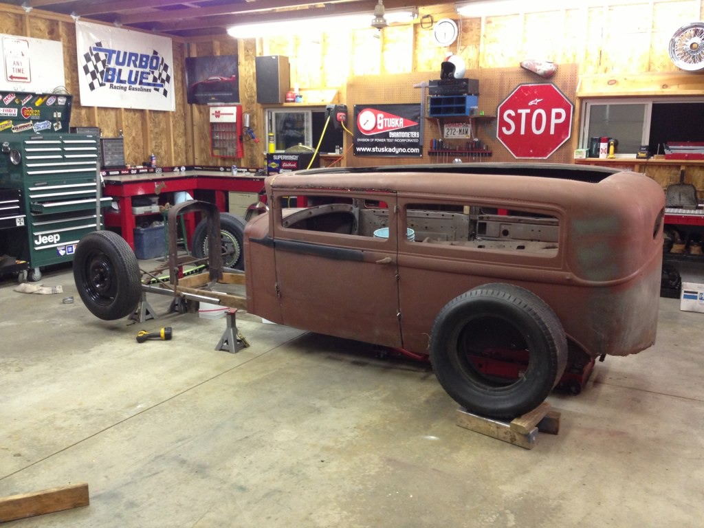

    Ok so I need some advice on ride height and what spring and spring mount to go with. I know there are tons of different ways to do mounts and tons of kinds of springs out there, I will probably need to go with with a reverse eye of some sort. What is a good ride height? I was thinking 7-8? And how much will it drop with motor and trans, an inch??
    Here is the frame spaced up for mock up, should I go higher?
    Here is a stock model A spring, it's junk though, the main leaf is cracked
    Another shot of where a stock spring sits
    Here is a picture of roughly the stock A spring center to the center of the wishbone which is 4"
    Anyways, advice would be appreciated
    Also I got my fishtails cutout and mounted
    They are pretty crude but will be blended with a flapper disc
    Got three of them welded in until my welder decided to over heat, so here I sit on my HAMB app on my phone ( since I don't have Internet) waiting for it to cool down

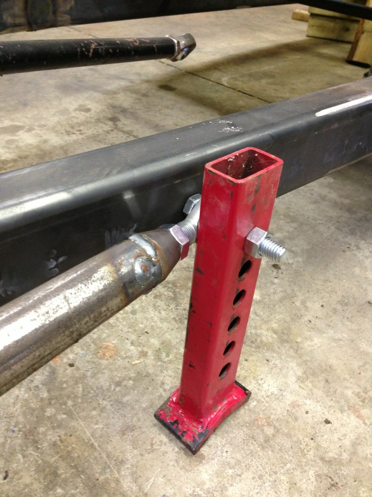

    So I found a new use for my jack stands, and it allowed me to figure out the a good place to drill for caster angle ImageUploadedByH.A.M.B.1377200804.154942.jpg
