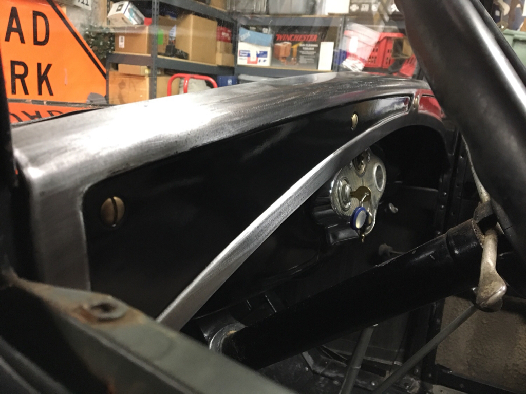

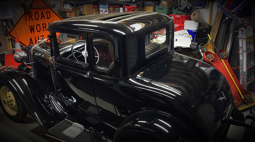

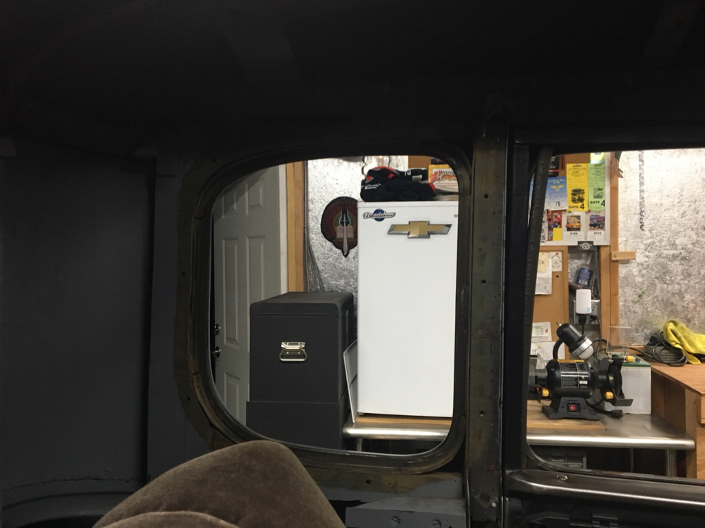

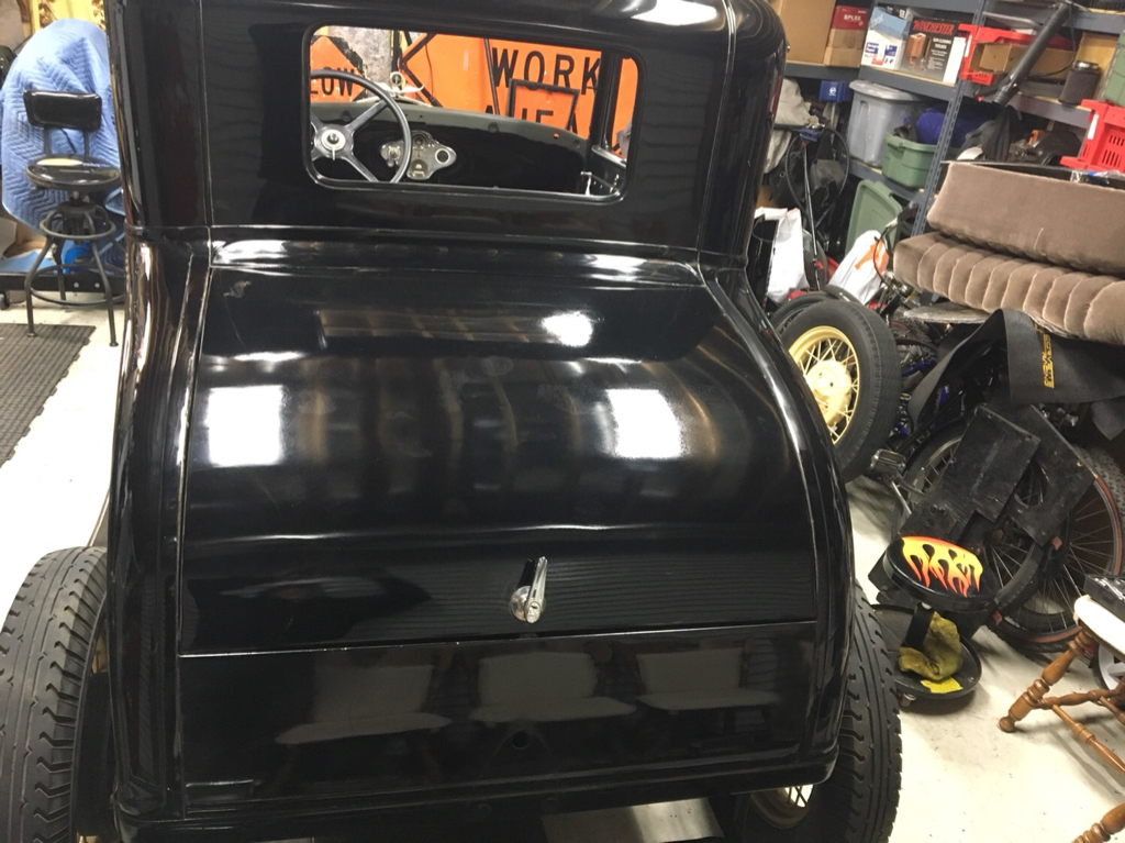

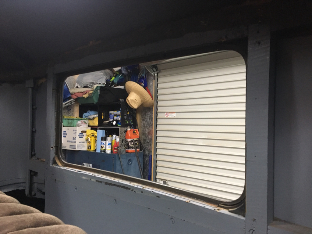

    So after the National Roadster show in Pomona, I had to start tearing into my stock A...I pulled all the door parts out, rebuilt the doors locks, ordered parts, tore out all the interior...removed the crappy sheet metal on the roof...[​IMG][​IMG][​IMG][​IMG][​IMG]

    [​IMG] so...I want to do a three inch chop...but looking at the window mount location, not sure what to do...

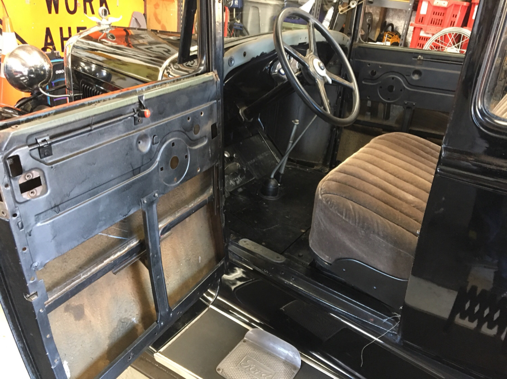

    [​IMG][​IMG][​IMG]got the door locks all fixed up with new springs, and handles that function an d lock...more window parts coming...

    I want to do a 3” chop...but how do you preserve (or can you) the mount for the front windshield?

    set your w/s frame all the way up under your visor with both being level. mark both edges...
    where the top edges touch the visor is the absolute maximum you could raise the w/s frame...maybe 2".
    subtract the difference between the stock w/s frame hight and your max from 3"...
    that sum is to be cut from the stock w/s frame ... 3" chop - 2" lift = 1" to chop the w/s frame...
    some of us like to trim the'30-'31 visor so we can tilt it back a little...HIH...

    [​IMG][​IMG][​IMG]more dis assembly...going well...this car seems to be in great shape...getting ready to choppy chop before I remove the body frame the chassis...so fun...this is good therapy for me...
