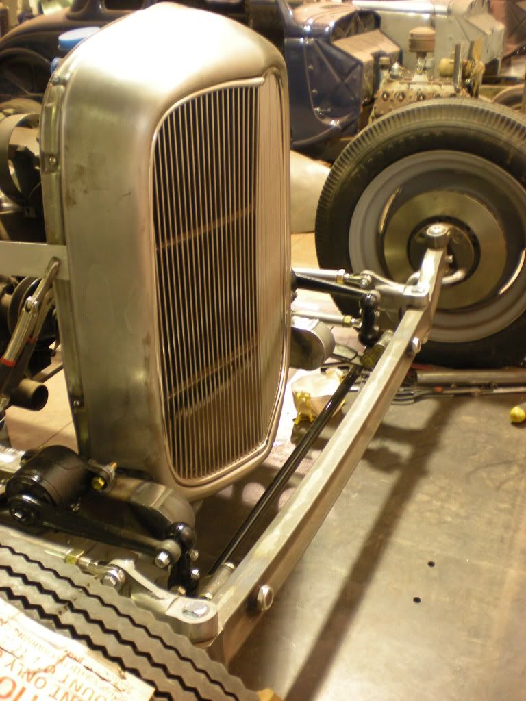

    My part is pretty much done on this one. I finish welded all the stuff on the frame, and so it's ready for the owners to take back and finish up. Im sure they will update pictures here, or I will make sure to get some pictures from them and update you guys.
    Thanks to everyone for your comments and support on this project. It really was a blast to be involved in.

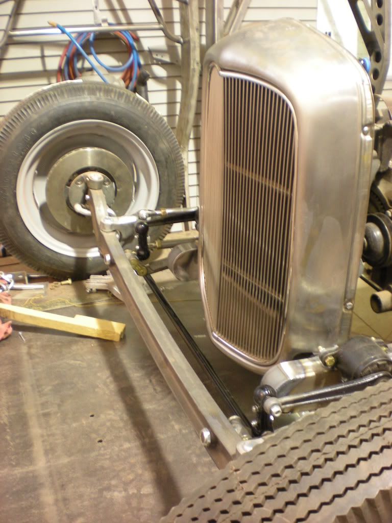

  7. Did you modify the radiator shell. If you did how many inches was it modified from the original lenght.

    Said it before, I'll say it again, I love this build...so clean and tidy. Like the hairpins too. Any concern they may be too stiff (torsionally) to allow much articulation in the front axle? Assuming the i-beam twists just a smidge, it's probably fine?

    <!--[if gte mso 9]><xml> <w:WordDocument> <w:View>Normal</w:View> <w:Zoom>0</w:Zoom> <w:DoNotOptimizeForBrowser/> </w:WordDocument> </xml><![endif]--> I love this car, love the original concept, the details, the workmanship.
    There was some discussion of suspension and radius rods. Having some suspension knowledge and experience, I have to add my $.02 here.
    Henry’s original wishbone layout, front and rear, put the wishbone pivot ball on the centerline of the car. As the car encountered bumps, or the body rolled when turning corners, the suspension pivoted around the ball joints at the ends of the wishbones. The same layout was used front and rear, I’ll use rear suspension for my example, the same applies to the front.
    When we split the wishbone, we move the forward radius rod pivots off the centerline, towards the frame rails. Think about what now happens when you turn a corner: the rear axle stays parallel to the ground, so the rear radius rod mounts stay at the same height. But as the frame rolls, the forward ends of the radius rods change height- if you’re turning left, the left one rises and the right one drops. The farther away from the car’s centerline the front mounts are, the more pronounced this effect is. So the radius rods are forced to bend every time the body rolls. Add to this the torque of a healthy motor trying to rotate the rear end under acceleration, and something’s eventually gonna break. The front suspension is more forgiving because a beam axle will twist along its length, in effect acting as an antiroll bar. A tube axle will not twist, thus requiring a different radius rod setup, such as a four bar that pivots at all ends. Rear axle housings don’t twist either, thus requiring a linkage arrangement that allows travel without binding or bending things.
    You don’t need to be an engineer to understand this. The axles stay parallel to the ground, the frame does not. Yes, it has worked for decades, more or less. Lots of cars have broken too. A design that requires parts to bind, bend or twist every time the suspension moves is less than ideal, regardless of how elegantly the parts are made. Not trashing Chris here (his work is beautiful), just stating a simple fact.
    Check out ElPolacko’s Industrial Chassis website for some brilliant solutions to this problem.
