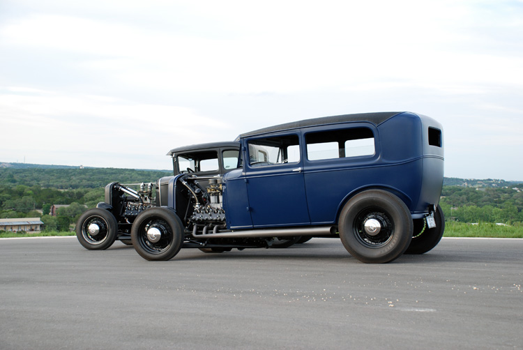

    This is the Prettiest set of sidepipes I've ever seen on a 30's Car...!

    god damn that shits pretty. i'd like to run pipes like that but my 31 is channeled so.. i wouldnt be able to open my doors, unless i ran them on the ground almost
