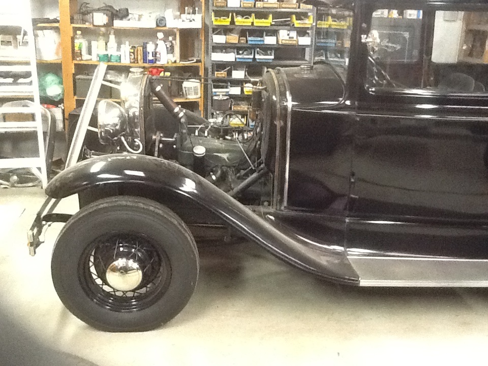

    Pics below of my new summer toy, it's been a brutal winter so looking forward to getting into it. I want to lower the front but nothing drastic, thinking of just using a reverse eye but I see mixed reactions on here and most seem unhappy with just an inch or so. The picture at the bottom is a fellow HAMBer RPU and is what I am hoping the end product will look like.
    She has a stock 4 banger and the long term plan is to replace with a flathead but I will be running her as is this summer and would like some suggestions on some improvements I can make with out breaking the bank or sacrificing reliability/drivability.
    Any and all suggestions tips are humbly appreciated.

    Reversed spring eye up front, 16" '35 wire wheels with 6.00 and 7.10 tires, a floater kit for the mechanical brakes, and an in-driveshaft overdrive. It'll look great, do highway speeds, stop much nicer, and require no cutting of anything original.
    That's what I'd do. Great looking truck, perfect cantidate for a mild hop-up.

    Looks great. I'd do pretty much what Squablow laid out, but if you wanted a little lower in the front, you can do what I did on my phaeton. It involves 32-34 spindles, perches, and a 2 1/2" strech-dropped axle. You can keep your mechanical brakes, and you get lower than just a reverse-eyed spring will get you.
    As for the engine, you'd be suprized how much fun a hopped-up four-banger can be for little to no hassle. With a simple carb, cam, and head swap you can double the original 40 horsepower and actually improve reliability. With a little more tweeking, you can put out power to rival some healthy flathead V8's out there.

    The -BIG- problem you are going to run into with a drop axle is your brakes. Here are the options you have if you want a drop-axle and want to keep your mechanicals:
    1) 2 1/2" Stretch-Dropped Axle, 1932-34 Ford Spindles, 1932-34 Spring Perches, Model A Kingpins and everything else. This is what I did, and I can tell you that every thing just bolts together with no modifications or non-sense. However, the perches and spindles are getting hard to find.
    2) Same as above but with an original 1934-34 axle. This will net you about 2" of drop before your reverse-eye spring, and you have the satisfaction of having all original Ford parts that will pretty much fall together. But, like the perches and spindles, the axles aren't getting any easier to find.
    3) Same as Option 1, but with a Stretch Dropped axle of your choice, and some sort of a spacer between the brake actuators and perches. I think guys on here have gone up to a 4" drop axle, maybe with a little reshaping of the steering arms.
    4) Model A everything, except Stretch-Dropped Axle of your choice. You will need to heat up and bend, or otherwise reshape your steering arms for correct geometry and clearance. And you will have to make some sort of spacer between the Spring Perch and the Brake Actuator. Gonna be lots of trial and error with this option.
    The one big thing to note is that any drop axle MUST be of the stretch-dropped type to maintain the original perch-to-spindle measurement for you brake actuators to work. No new aftermarket axles that I know of are this way, since most street rodders aren't building things with mechanical brakes.
    All that said, the 2 1/2" that I lowered my front end is noticeable and the brakes work just fine. They will lock up all four if I want them to, and as long as I keep them adjusted, they don't fade bad either, these cars are really light. You can't just slam the pedal like in a modern car, you actually have to drive these things.
    ...oh and you can substitute 35-36 Spindles for the 32-34 ones but they have no integral steering arm like the earlier ones. This is either a blessing or a curse, since you will have to make one, but you can make whatever shape you need.
