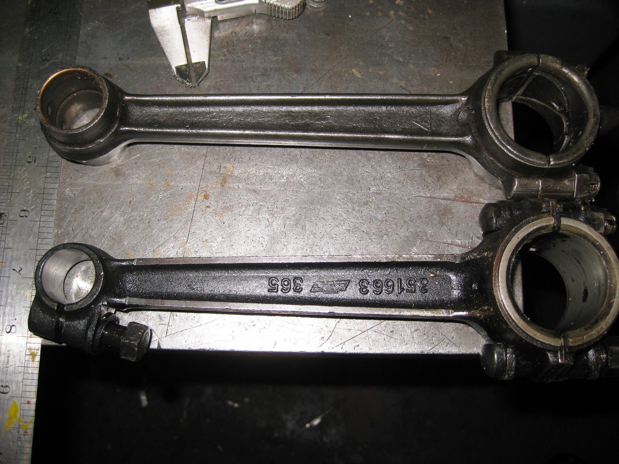

    Finally had some time to do some work on one of my four banger motors. Have come across a few "interesting" things during the strip down.
    First up up is the Ford Model "A" rod on the Chevy crank.
    Here are the two big ends side by side:
    Here's the Ford rod on a four banger crankpin.
    The Ford rod has the same nominal bearing diameter at 1.5" but is around 1/4" narrower than the Chevy rod at the big end. Has anyone run an engine like this? did you leave the huge endfloat or did you metal out the cheeks of the big end in some way -an extra 1/8" of white metal each side seems a lot.
    I am considering converting the whole bottom end to full pressure lube. The stock "oil seal" arrangement for the rear main in the next picture looks like it would be fairly ineffective when the bearing is getting oil under pressure. It doesn't look to be easy to fit any kind of modern seal here -the bearing cap and crankcase half at the rear don't really have much metal there for putting in a lip seal or rope seal. I am considering machining out the third groove and fitting an "O" ring in there. this "O" ring should stay static in the groove and would ride on the polished crank tail. Does this sound feasible, or has anyone fitted a positive seal of some other sort to one of these motors?

    Stueeee, I'm confused. Are the two rods above a Chevy on the left and a Ford on the right? According to information earlier the Chevy should be shorter than the Flathead. Could the on on the left be a Durant? Or are you building something bigger than the 171?

    Not sure about the exact details re fitting the model A or B crank in a four banger, But the "A" crank left the factory with a slinger on the rear main. Snyders do a lip seal conversion which I'm looking at using on the 4 banger -it's a flexible seal, so it should be possible to stretch it over the 4 banger rear flange in the same way as for the model "A" Obviously to use it on the four banger it will be necessary to machine up a housing from a chunk of Ali billet.
    When I took the photo to emphasize the different big end widths, I hadn't noticed that I'd also managed to create an optical illusion making the Chevy rod look longer than the Ford item. The big end split lines are both aligned on the edge of this machine table.

    I can see the pinch bolt on the Chevy rod now too.
    Also think of getting the new A rods milled for inserts.

    First--the Ford A and B rods are 1/8" longer, and a LOT better metal that the Chev.

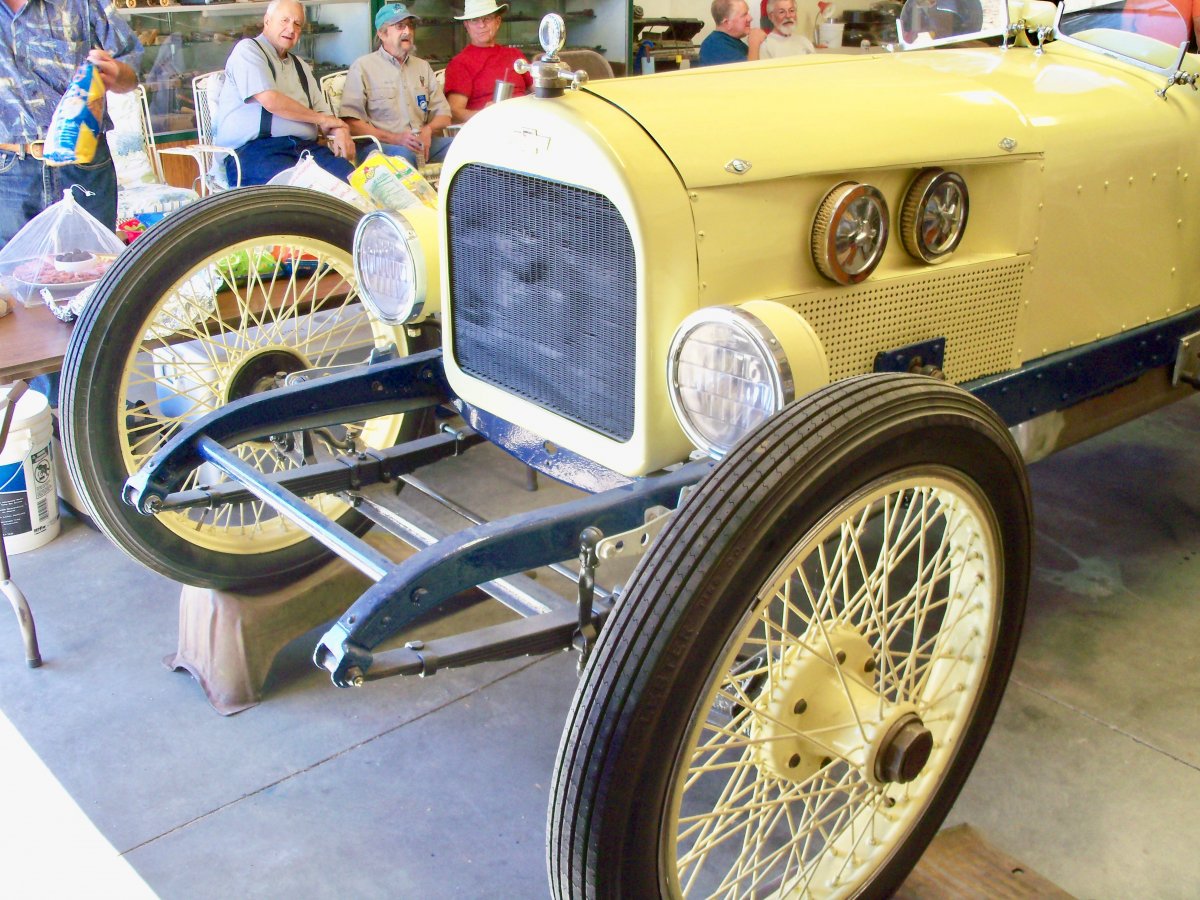

    Our Inlines club had our annual swap meet at the above mentioned friend's shop today. For me it is Chevy four banger Heaven though Mel builds Ts too. I got an Olds 3 port head with a set of custom rockers and pushrods. I also got a great complete steering column and box with the most beautiful steering wheel I've seen outside of a museum. I'll try to post pictures tomorrow. There are some of his '25 Chevy powered racer.
    Outback and Jimmy B like this.

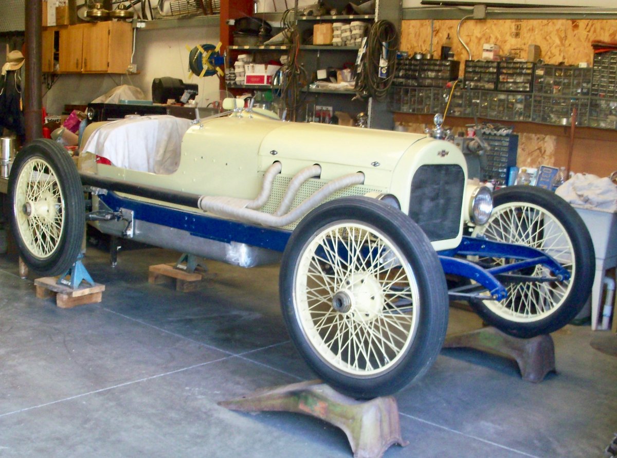

    Here are some pictures. The rockers appear to be 2 to 1 ratio. My friend Mel made them. He said they were tearing up the Fords (Ts & As) so bad that they were outlawed in whatever rules they were using. 100_0204.jpg 100_0201.jpg 100_0213.jpg Oh My new steering column too.

    Here are some pictures of the Chevy racer Mel is building. Almost done I can not wait to see and hear the one. It was a dirt track racer. It has a '25 block, 3 port Olds head, two see drafts, balanced crank, and a T-5 trans. He bored out some old spark plug bases and threaded them for modern plugs. I'm not sure what else in done to his engine. His T speedster runs a '28 Chevy head.
