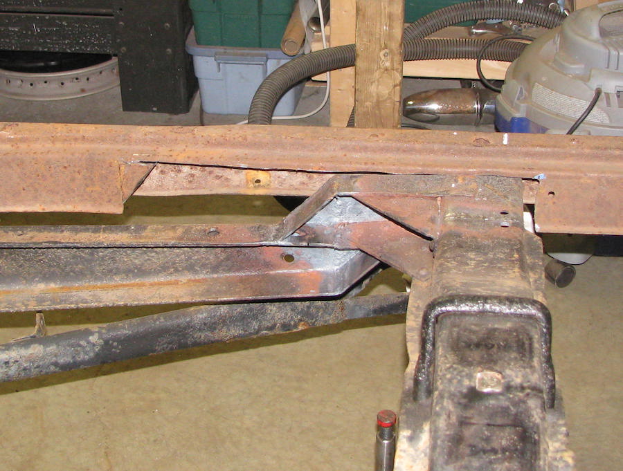

    I was going to weld up my subframe (it's broken) and cut the step out before I put the body on the frame, but I got anxious. The body is sitting at an angle because of the step, and the top of the radiator got pulled back a little further than it should have, but here's the general fit. All these pictures were taken with the mounting hole in the subframe centered on the frame's rear crossmember.

    And here's the step area. I think what I'm going to do is put a horizontal cut on the side of the subframe at the height of the step, from the back of the frame to an inch or two in front of the crossmember. Then slide that whole section forward enough so the crossmember isn't hitting the step, then cut the diagonal to clear the step and weld it all back together. That seems like the easiest way to move/mod the crossmember. I don't see any reason it has to be where it is, I'm not using a Model T frame so nothing attaches to it anyway.

  12. Looking at what you need to do to get the sub frame to fit over the kick up and rear cross member, ( I cant see it fitting like that) I was picturing pinching the rear frame rails and narrowing the cross member to all fit inside the sub frame. I may be missing what you intend with the sub frame cutting, so please correct me.:D:D JW

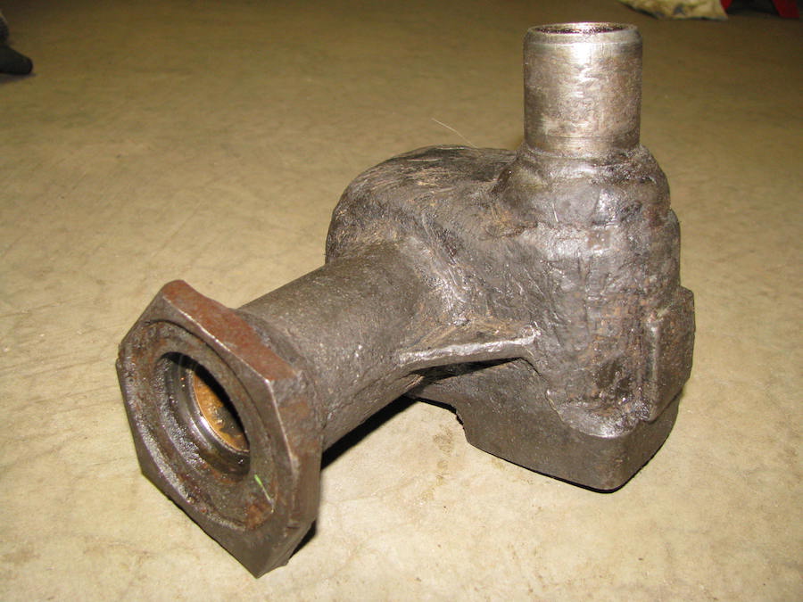

    They are Mercury pumps, and in trying to find a picture that shows what Mercury pumps look like, I discovered that's how they did it in '50-'51. So one more mystery solved. Pictures stolen from a Ford Barn thread...
    The thread these pics are from:
    https://www.fordbarn.com/forum/showthread.php?t=137768&showall=1
    The plan for the body/subframe is pretty simple, I probably didn't explain it well. It'll be easier to just do it and show pics later...

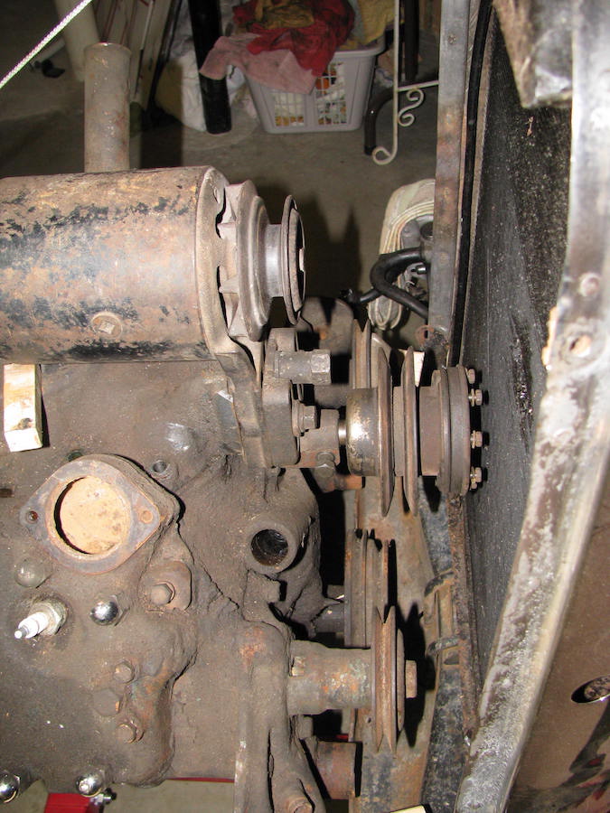

    Welcome to today's installment of Fun With Fans!
    I tried to mock up a fan the other day and ended up confusing myself to no end, I'm not even sure I'll be able to describe what I'm confused about but here goes.
    The background. When I bought the engine, it had no fan mounted on it. What I started with was an 8BA with Mercury pumps, and what I think is a typical 8BA crank pulley and generator.
    The seller did throw an earlier generator and fan in with the deal though. Judging by the diameter (18") I think it is from a truck.
    Here is the generator that was on the engine when I got it.
    And below is the mess of parts I mounted on the engine to get an idea of what I'm working with. The radiator is off of a '31 Model A so it is too tall. Wild guess 4" too tall. I doubt I can go with a generator mounted fan because I'll likely be using a chopped '32 grill and radiator. Also, you can't really tell from the photo, but NOTHING lines up with anything else. That's not really an issue yet, I have a mix of eras so the pulleys are a mix of wide and narrow, etc.
    On to my confusion.
    As I understand it: The fan and generator I have on there are both from a pre-'59 engine. So... shouldn't that mean it's the shorter (vs an 8BA) set up? As everything sits right now, the fan I have would be about 1/2" into the radiator if it were installed. That's not a show stopper, worst case move the radiator forward. Not ideal but doable.

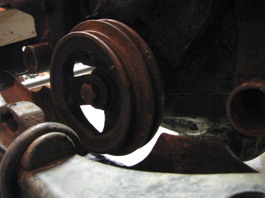

    Here is the rub: The crank pulley is an 8BA part. It is supposed to be longer than a 59A dual pulley, right? BUT... the pulley for the fan I have on there is further forward than the 8BA crank pulley. That leads me to beleive there is a shorter fan of this style, but I can't find it.
    I thought maybe a truck fan was a different length than the car fan, but everything I've seen shows the same part, car vs truck. The difference I've seen is in the diameter, not the length.
    The point of this was supposed to be so I could figure out which waterpumps to get. For some reason I was still considering going with the 8BA set up, but in light of this I'm going to order earlier waterpumps and build the front as a 59A. I just don't know what to look for in a fan though. Earlier dizzy, shorter cam, earlier cam gears, earlier crank pulley, different timing cover, check. Got it. But what about the dang fan? I thought I HAD an earlier fan but it's pulley is further forward than the 8BA pulley even. I don't get it.
    I had to put the intake on for all of this. That made me realize the rear of it is further under the firewall than I thought, but not enough to change any plans. I'm going with an earlier (dual carb) intake to lose the draft tube, which means a combo fuel pump/breather stand. I'll mod the upper part of the firewall to make it fit if I have too, there's nothing behind there now that the gas tank is gone. In this shot the body is tilted forward to get access for cutting/welding the subframe, so the clearance looks worse that it will be.
    So to sum it all up, the mock up of the fan just confused me, I can't help but think I'm not dealing with what I thought I was. I'm going to build up the front and intake like a 59A, and basically just deal with the fan issue as I go.

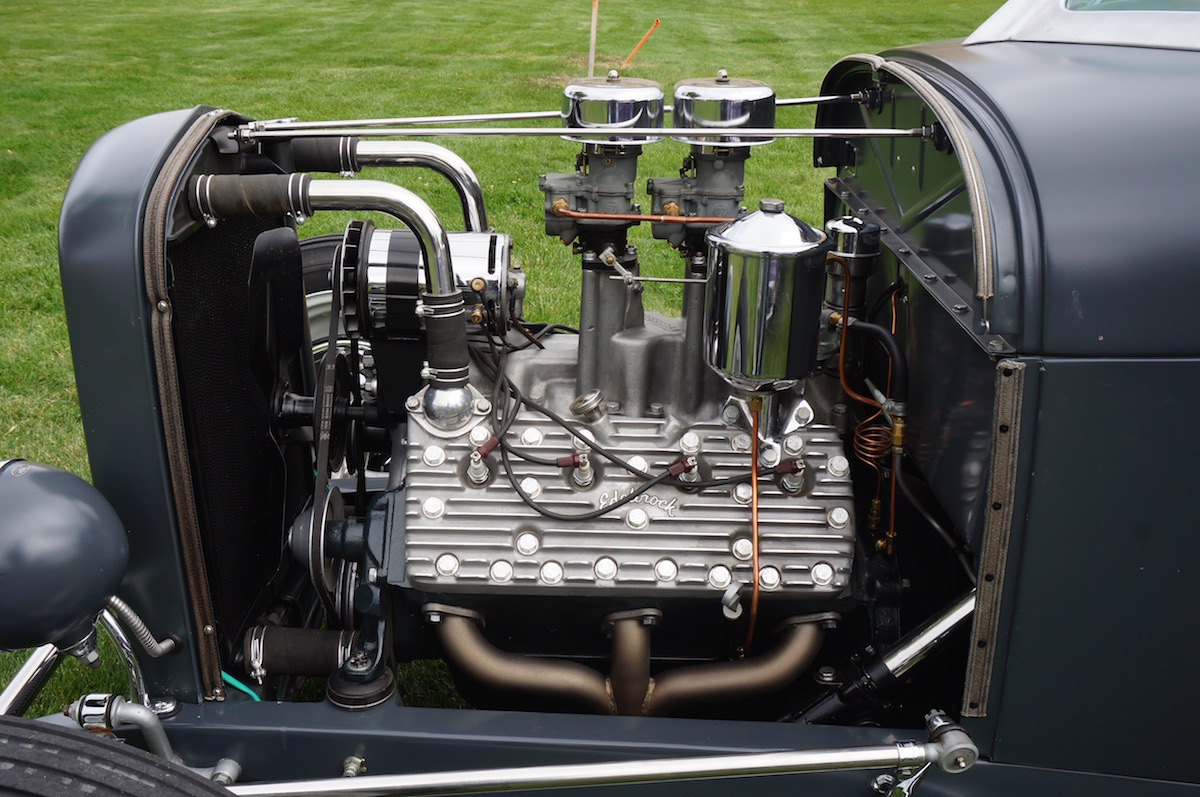

  15. May be time for a thread to ask what you need to make what you have work. The flat head V-8 boys will tell you what you need to look for. JW
  16. 5280A2
    Joined: Sep 8, 2014
    Posts: 82
    5280A2
    Your photos show the early (59A) fan setup with the wide belt pulleys. The reason it doesn't line up is that the late flatheads use narrow belts and pulleys for both the pumps and fan. Your photo looks like there may not be fan clearance at the radiator with the early setup. The two photos below show the early and late fans in place. The width of the pulleys is probably the best initial indicator of which parts are which.
    26 T Ford RPU likes this.

    Yeah you're probably right. I want to get a little more familiar with what I already have first though. I did order early waterpumps this afternoon (along with a timing cover for a two bolt distributor) so I've committed to an early front end set up. I haven't found an early pulley yet, which will confirm where the pulley for the fan is supposed to end up.
    Yeah judging by the pulleys I thought the fan set up I have is an early one. And I get that the pulleys are different widths so don't match up. What I don't get is, If the front end of a 59A is supposed to be shorter than an 8BA, how can the pulley for the fan on the 59A set up be further forward than the outermost one on the 8BA crank pulley? The fan for the 8BA must be longer than the fan on a 59A. This would suggest a mix of 8BA and 59A parts would lead to the shortest possible combination, but I've never seen anyone mention that and I'm pretty sure if it were true, someone would have done it already.
    The pictures you showed... if I'm seeing this right the top one has early heads and fan with a late generator, all of which are bumped out to clear a late intake/draft tube and I would assume distributor.
    The bottom one has late heads/fan/generator/distributor with an early intake. So neither one is taking advantage of the shorter 59A set up.
    Basically the take away is it doesn't really matter what I do, there's a way to make it work and someone else has done it before. ;-)

    Looks like you have the right fan pulley. You just need the correct 59a crank pulley

    DesmoDog you have a better eye than me; the top photo is indeed a late setup with wide belts Pickup or Merc?). Lodaddyo shows the 59A crank pulley and why the fan pulley is further forward. Here's more of a side view of the early version that I should have posted yesterday. Distributor is definitely up front on this one.

    Thats the same setup as i posted i believe. If you really want more room you need to go to a generator mounted fan and use a single belt. Thats what i did with my 8ba in my Av8.

    Thanks for the comments. I think I have the fan figured out - not so much how I'm going to make it work, but what I have and what the different options would bring. I bought a 59A distributor and a '32 grill shell (repop) today, they should help me figure out what direction to go. I highly doubt I'll have room for a generator mounted fan as I plan to chop the grill shell. I also got a breather/fuel pump stand to see just how tight things will be in the firewall area. I do NOT want to move the engine back farther to make the fan work, but we'll see...
    I think my confusion came from expecting the wrong thing. I was under the impression a 59A was significantly shorter than an 8BA. From what I can tell now, that's only true if you don't include the fan. Granted I've never seen an 8BA fan but again judging from the pulley locations I'm guessing it sticks out about the same as the one I have.
    I've got a few ideas on how to make things fit, from the simple to the somewhat elaborate. I'll even entertain pushing the grill/radiator forward an inch or so. Not my first choice but I'm not ruling it out yet. I'm going to press on with my plan for now and when more parts show up I'll play with the fan more.

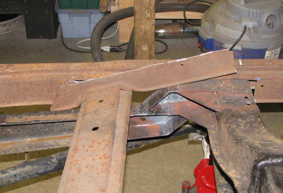

    This morning I had the chance to make some noise downstairs and cut the subframe. I laid out what I thought had to go and then drilled a hole in the corner that won't have anything welded back in place. Sharp corners = not good... The tape is there instead of drawing a long line.
    Cutting didn't go as smoothly as I imagined it would (surprise surprise) but this should be workable. The front is angled because I didn't have room for the cutoff tool straight up and down.
    The rear body mount on the frame is uncut. Tardel's book says to cut the tabs off to get the body to fit, but I don't see why? Maybe it's a Model A thing, the Model T subframe is wide enough to fit over the uncut tabs. In fact, the mounting holes in the Model T subframe are actually wider than the holes in the Model A frame. Close enough to make work though.
    Here's kinda sorta how it will all fit together. Obviously I need to trim the metal to fit in place, but once it's cut the crossmember will sit level, about two inches further forward than it was before. I'm not sure I'll get to that today though. Desmo (the dog in my avatar) is nearing end of life and requiring a lot of supervision. Well, maybe not "requiring", but he certainly deserves it. My wife reminded me today that we picked him up from the rescue place fifteen years ago this weekend, and he was around two years old when we got him... That's a damn good run for a retriever. But I digress.

    Last winter I picked up a couple F1 boxes, one of which already had the flange hacked up on it. I figured that'd be the obvious start for trying to make one of these work with the VW mount.
    Here's the box, stripped down. Not as clean as it could be but that's life. I started out cleaning it, then got to cutting and grinding and one thing led to another.
    The thread I got the idea from mentioned the bore for the shaft wasn't centered in the casting, I found the same thing. He had a little spot that wasn't even touched when he was done. I machined mine down to a 1.77" diameter and it just barely cleaned up the whole diameter on the final pass. (This is an in process shot)
    It fits! And all it took was a little cutting on the bandsaw, a bit of grinding, and a bunch of cutting on the lathe. And two trips to the hardware store to deal with a little lathe issue.
    Sure, it fits... the mount anyway. I could swear that somewhere I posted I wasn't sure it'd fit the car? Yeah. Not even close. No way this is sitting on top of the frame with the engine in this position. It might fit in the stock position, but then the pitman arm would hit the hairpin.
    The box will fit UNDER the frame though... and still be higher than the bottom of the oil pan. This means the pitman arm would have to go up instead of down, which means the box would work backwards and the steering would be reversed. Which makes me wonder how our buddies that drive on the wrong side of the road do it? I know a lot of cars shared internals with the F1 box. What are the chances that there exists a right hand drive version of this box that has the worm screw wrapped the other direction? Mine has some pitting so I'm going to be buying a new one anyway. The angle of the steering column could be an issue but I think the length would be ok.
    Another option would be to ditch the hairpins and go with a modified wishbone I suppose. Cowl steering is looking better all the time...

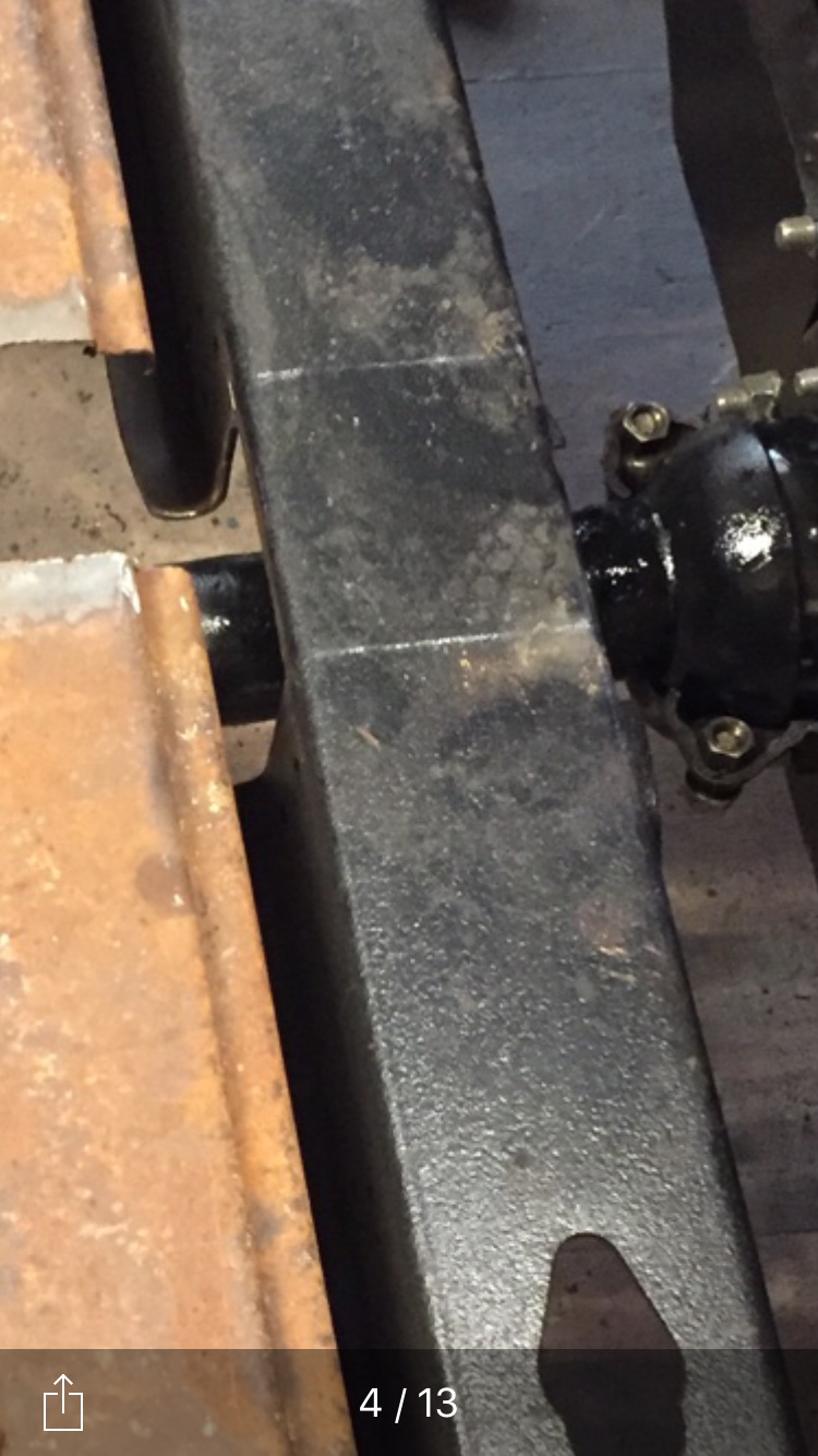

    In other news I welded the subframe back together so the body sits on the frame like it should and the cross brace is back in position. I moved it forward 2". If I had it to do over again I'd only move it forward 1". Moving it forward 2" puts it into an area where the subframe pinches in, so there's work trimming the front edge and twisting a tab to make it fit. If I brought it forward an inch I'd avoid that but the trade off would be trimming the back edge of the crossbrace a little. It worked, it just might have worked better another way.
    I also fit the hairpins. Putting those together made me realize I screwed up when I located the frame mounts, but that's no big deal. I only drilled two holes per side just in case I had to move them later.
