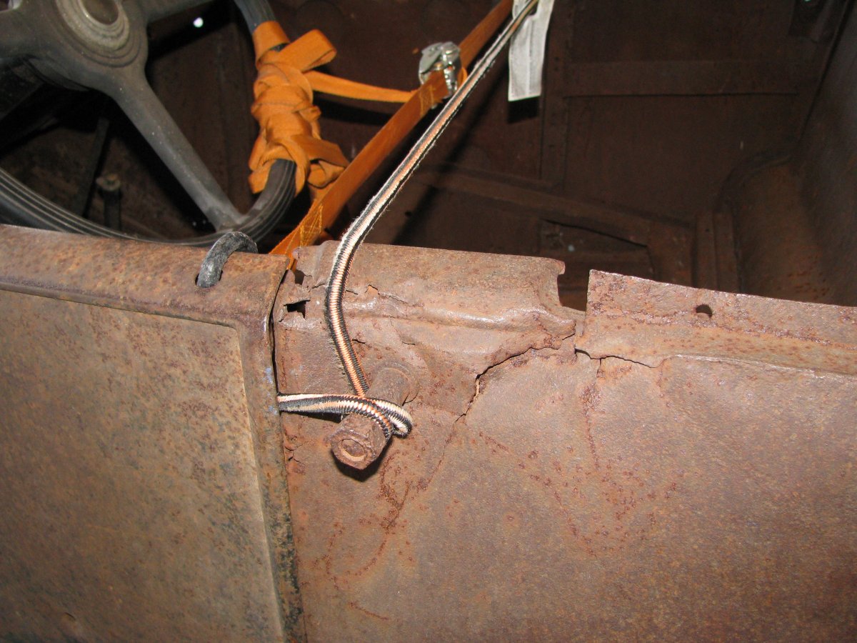

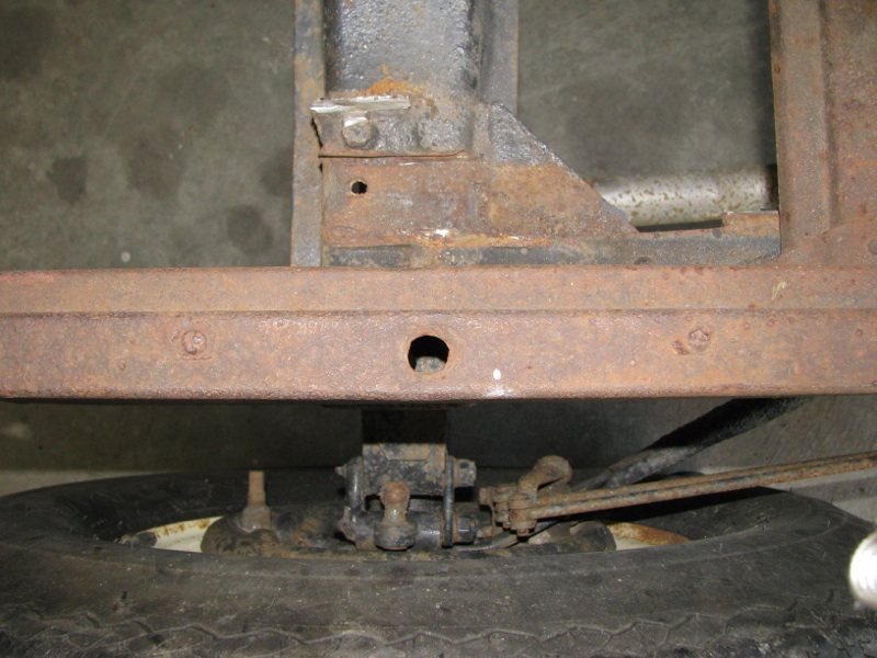

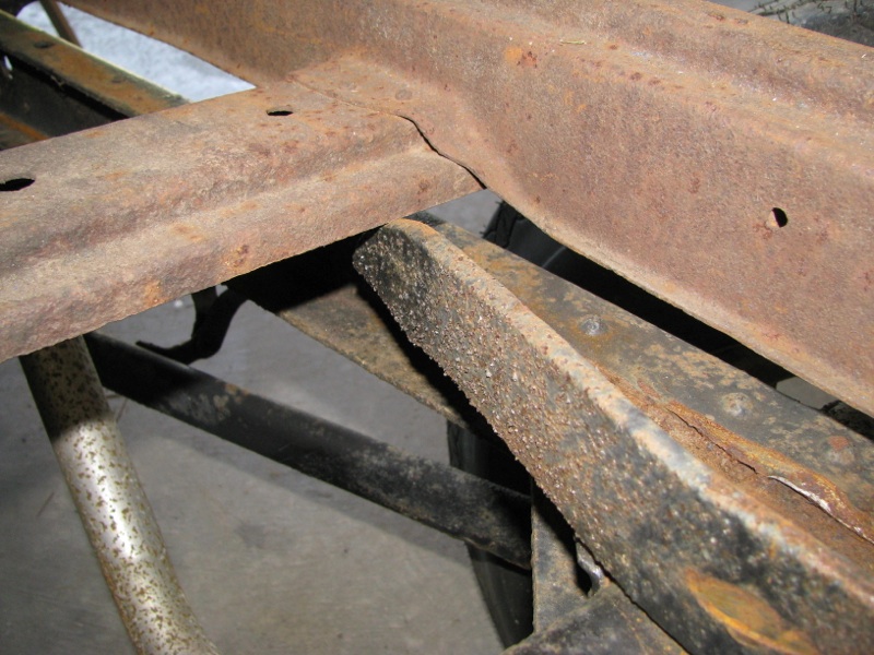

  3. I'm realizing that being a newbie to this stuff, much of what I might post in a build thread is going to seem incredibly basic to people who have been there and done that before. The thing is, some of the threads that I've looked at left me with questions on the basics. I figure if I post it here it will be something of a reality check and if I've got a detail wrong, someone will point it out. And it might help some other clueless newbs.
    I've seen some info that made it sound like a '27 T body will drop right on to a Model A frame. Other posts indicated it wasn't quite that easy. I started out by trying to get the body into position so I could get a feel for potential frame mods and a layout for the interior.
    When I started wrestling with it I found a couple areas on my car that prevented the body from sitting where I thought it should go. First, the clutch pedal hits the firewall before the body is centered in front, it needs to move over maybe another inch. I saw one thread here where the pedals were bent to fit. I'm going to remove the clutch pedal for now and save modding anything until I get around to working out the brakes (I've got later juice brakes to install)
    Also, on my car the rear bumper brackets were welded on and keeping the subframe from sitting down on top of the frame.
    I'm guessing welded bumper brackets aren't normal (I've never taken apart a Model A) but whatever, I cut them off and set the body about where I thought it should go.
    I don't have a turtle deck yet so when I was deciding where the body should sit I couldn't just align the wheel well with the rear axle, instead I searched for dimensions and found a few sources. None of them agreed as to where the firewall should be in relation to the rear axle but they all seemed to agree that the rear of the body is 17" back from the axle centerline. My subframe is a bit beat up but I put it at 17" and found that the hole in the rear crossmember almost lines up with the hole in the subframe. It's off by maybe half an inch. I'm not sure if the fix is to pull the body back another half an inch or mod the holes to work. (I really wish I had a turtle deck to see how the wheel wells will line up.) You can just see the slot in the crossmember through the hole in the subframe. No other holes come close to lining up from what I can tell, and the front mounts will need a tab put on the frame to be useful.
    Once the body was sitting in place at the back, the info in Tardell's book about zee'ing the frame made more sense. It seems that if the frame is z'd 4" in front of the rear crossmember, there will be room to put the gusset on without much if any trimming of the subframe's cross member. And I haven't measured things yet but it also looks like once the frame is z'd, only the inner face of the subframe will need to be cut for clearance. With a little trimming of the rear crossmember it should fit up into the subframe.
    In other news, based on the door sills and a detail on the cowl I think this body is actually a 1927, not a '26. I don't think it really matters for what I'm doing but you never know.

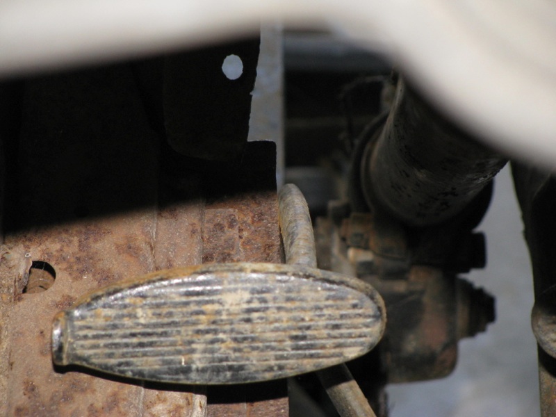

  6. Thanks for the info guys. I'm hoping to get a turtledeck before I have to commit to a location for the body, for now I'm trying to get close so I can get a feel for what I'm dealing with.
    I tried pulling the clutch pedal after that last post. The pin is stuck so it's soaking in penetrating oil for a while. In the meantime I was looking at the parking brake lever - it's not mounted because it's too tall. Then I realized it was hitting the old gas tank so I pulled the tank. I'm not sure what the official Ford method is for doing that but I'm guessing it doesn't involve a bunch of cutting tools and a big hammer? I may still have to shorten the lever depending on what I do for a dash, but at least the tank is gone. Now I have ot figur eout what to do with the cowl. Put in a cowl vent? Smooth it out? No rush on that, there is a lot I have to do before that matters.

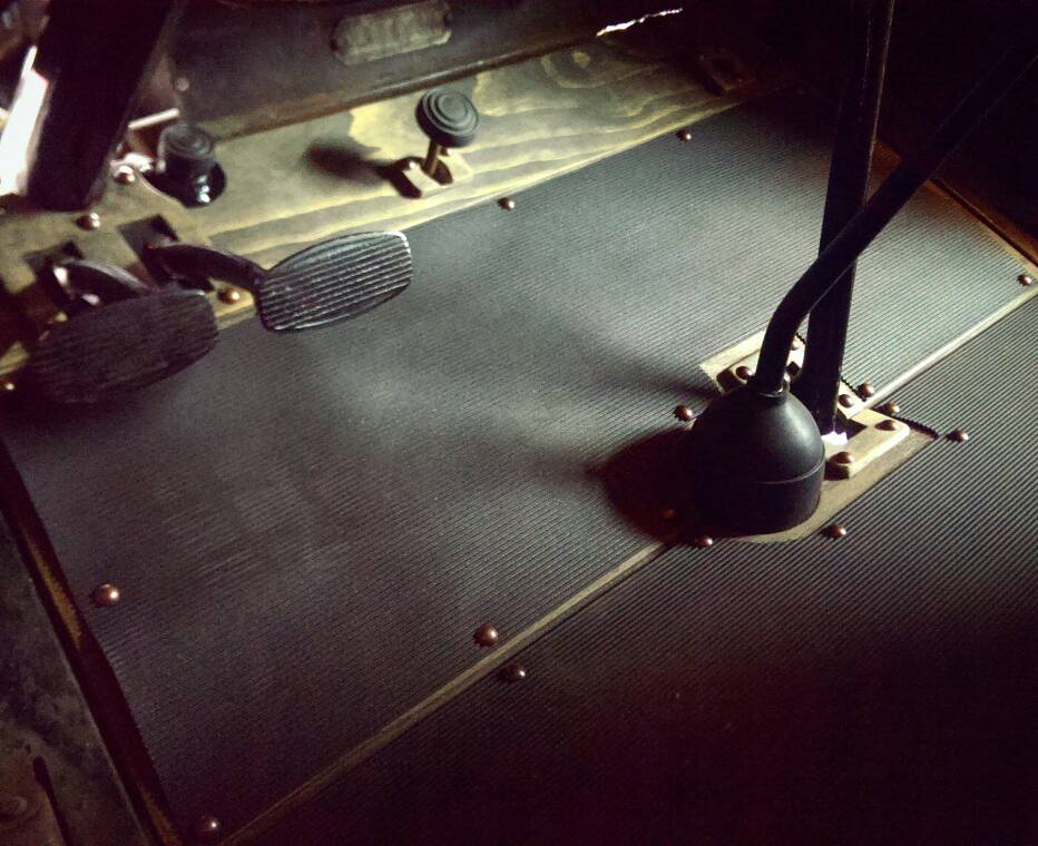

    My latest is a 26 coupe on an A chassis. The principles are the same with exception of pinching the frame to match the turtle deck.
    The clutch is an easy fix with two pie cuts, a bend, and weld. You will require tabs to mount the body.
    I would get a turtle deck before you commit to body position. With mine and using a banger i wanted the rear tire centered to the well. This required shortening the frame 3 inches so I could get the body as close enough to the engine for the pedals to work. If you shorten it do it behind the crossmember. I made this mistake and caused a bunch more work for myself because the trans wouldn't clear. Personally I prefer the look of the T wheelbase on a T. 103.5 looks off to me..
    This also required some creative bending of the throttle to match the angle of the floor and trim the brake and clutch due to them being closer together.

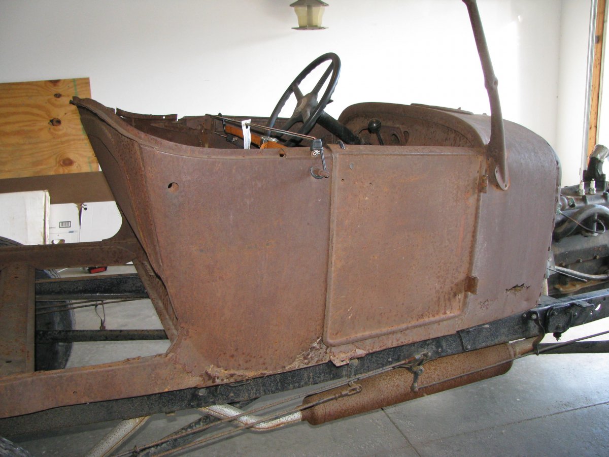

  11. Umm… yeaaaahhh… about that… No. :rolleyes:
    The pin between the clutch pedal/adjusting arm was not responding to penetrating oil and progressively less gentle kisses with progressively heavier hammers, so last night I simply cut the adjuster and got on with life. The threads were pretty shot on it anyway so nothing lost.
    Getting the clutch pedal off let me set the body about where I think it will end up. It's right at 17" from the end of the body to the rear axle, which puts it about half an inch off of evintho's number. It's in the ballpark, good enough to see how things will fit but I'll wait for a turtledeck to start welding on tabs and drilling new holes.
    I have been thinking about the wheelbase. It looks like the body could still slide forward maybe 2" before the engine and firewall started to interfere? The farther forward the body is, the more room there is for the pedals. To keep things simple I was going to stick with the stock wheelbase, but the frame's already getting cut to Z it, and I've been secretly lusting after/watching a few threads on more modern transmissions. One of those would require cutting the torque tube and wishbone so changing the wheelbase wouldn't be a big deal? It seems tempting but it also seems like a slippery slope.
    The steering column is in the wrong spot too. I hadn't planned on using the stock dash but the wheel might be a bit too close to the side of the body? Are people compensating for this somehow or just going with it? Cowl steering appeals to me for a few reasons but getting back to the keep it simple mantra I decided against it.
    The purists are going to be pissed, somebody cut the dash!
    I'm trying to think of anything else I want to do before I pull the body off and tear it down to the bare frame. Tear down needs to start soon.

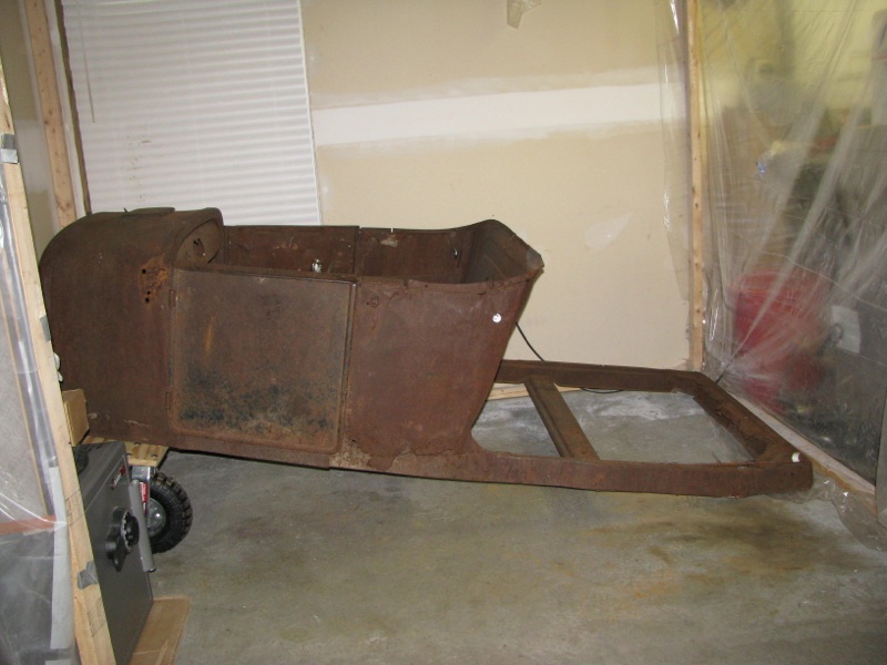

  24. The title I got with this has been "open" since November of 1991. The seller back then signed it, but it was never transferred to any of the subsequent owners over the past 25 years. I wasn't sure how that was going to go over with the state but I went in today and it turned out to be a non-issue. I also brought along a motorcycle title that was basically the same story except from '99. I had been stressing over that for one for years, too many horror stories I guess. Anyway, now for the first time in a long time, all my projects will have clean, 100% legit numbers matching titles. Sweet! Barring a rejection from the people in Lansing anyway. Damn, knock on wood… probably shouldn't celebrate until the new titles are in hand I suppose.
    I have decided to keep the stock Model A wheelbase, for a few reasons. Not the least of which are A) it saves me having to modify the torque tube and everything else, and B) It keeps my options open for alternate bodies. I'm not going to lie, I'm kinda stressing about not having a turtle deck for it, and even more so the condition of the left side.
    I decided not to spend the time/money trying to make it run before tearing it down. What's the point? I'm running out of nice weather so time to being the project indoors! I have the next couple days off work so I started tearing this down. The parts all need to move out of the garage, down and across a hill, then back up the hill to the door of our walkout basement. Not a big deal but I'll be doing it alone.
    Step one, removing the body. Not too hard as it was just sitting there anyway. Sidenote: Engine hoists are pretty handy to have around!
    Step two was putting some wheels under it. Then I just rolled it to where it needed to be. I won't mention how things were going so well on the down and across part that I decided to get a run on the uphill part. Worked great until I got a bit too close to a deck post and caught the end of an eye bolt I had installed in the body. Oops. Suffice it to say I ended up on my ass but no harm done. I just hope the neighbors weren't watching.
    Step three was getting it through the door. The door is about 30" wide. The body is about 44" wide, but only 26" tall. So I put a board on the ground, a blanket on the board, unbolted the wheels, and flipped it onto it's side. Then wrestled it through the door and onto a moving dolly. Once it was inside I put the wheels back on a moved it into it's new home, the space that used to pass as my paint booth.
    I'll build a body dolly for it later. Tomorrow I'll attack the chassis. That's Desmo checking out the progress.
    If all goes well the rest of the car will be out of the garage in the next couple of days too.
