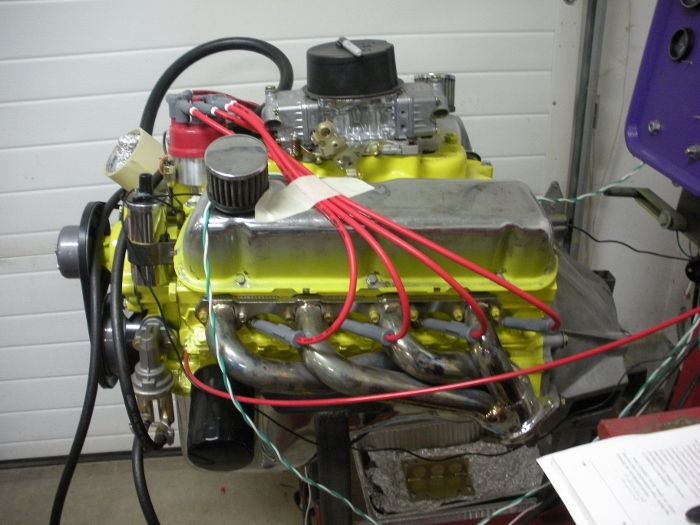

    After cam break in i drained the oil and let it sit a few days in a freshly washed bucket. Then scraped the bottom with this clean jelly jar and stuck a magnet to it.... Looks like a lot of junk, there is about ten teaspoons of it in the bucket and I have yet to look at the filter guts.
    In a two stroke all this stuff gets blown out the pipe so you never see how much there is.
    Is this too much stuff??
    Here was the goofy break in setup. Yes those are garden hoses (filtered), yes it got up to temp, and yes that is a taco bell tray dashboard.
  6. Are you saying you got TEN teaspoons of metal shavings out of your oil?
    Holy crap man....there's something fishy about that. I'd be surprised that an engine was running at all if that much stuff came out of it. Surely that's a little bit of metal mixed in with other misc crap and gunk.

    Not exactly, between 5 and 10 tea spoons full of stuff. Only a small amount is magnetic (1 spoon) and it would be less if not saturated with oil... I will strain it and wash the oil out and see what it is. Cam looks ok and I have ok compression.
    It doesnt seem right to me but it all checks out so ???
  8. That sounds more reasonable. If you've got a good running engine and good compression, you should be fine then.

    Got a big cup full and let it settle. Then sucked up the oil on top, washed the rest out with dish soap and water. Looks like most of the stuff came from break in lube and only a little bit of magnetic powder. It was all really fine stuff so I'm relieved.

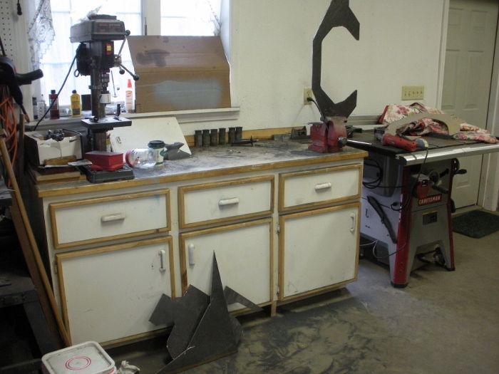

    probly wont post another update till after my engineering finals are done next week but here is the start of my motor mounts and cradle... way over built but I dont want plain-jane motor mounts
    Good use of all the tiny cutoff wheels

    Dont drill through the drill press kids.
    Used break in oil is a good cheap cutting fluid... and has a good aroma to it.
    put a few tacks on the steering box to make a pattern for the cradle.

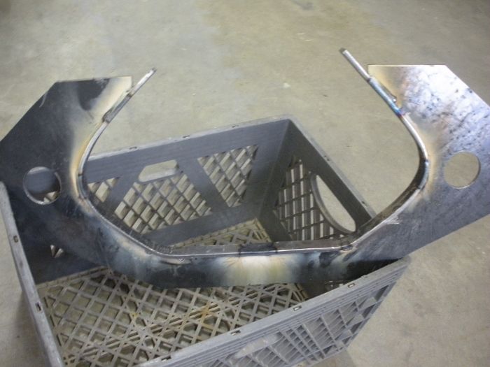

    Thanks You guys very much. Smokey, this truck hasn't run in a number of years and although it looked like a streetable machine it was far from road worthy. The wood framing in the cab was falling apart on the ride home and the frame had a few spots where you could poke a finger through(reason for cutting it up). I think after its on the road I will work on getting the banger running on the stand.
    I ran out of heat but this will be an I beam when finished.

    Let it cool down and post a pic.

    Still too hot to touch and not clean, but under that flux my welds are steadily getting better... I'm happy with my progress but they still arent pretty.
  22. You're really showing some skill and suburb attention to detail....especially considering your age.

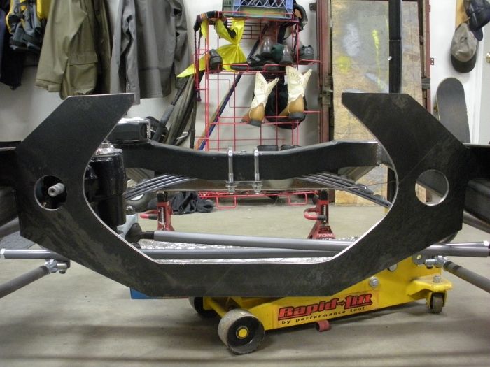

    The wide angle lens on my camera makes everything look crooked but I assure you everything is square.

    Pretty sure I'm doing all of this the hard way, but it's cheap and the only way I know how.
    Puck mounts being punched out...
    Checking position
