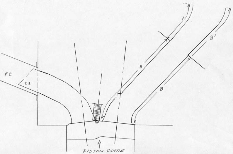

    that looks quite a bit better
    here is an article you might want to read:
    http://www.theoldone.com/articles/The_Soft_Head_1999/
    It covers a lot of combustion chamber theory, runner design, the web site also has a lot of good information on improving blower efficiency
    this drawing is a good example of keeping the runner floor and roof equal length to prevent "shearing" of the air column.
    for a street motor it might not be of major concern but it may be something you want to look into as is can prevent fuel puddling and detonation. every little bit helps.

    There will be no fuel puddling because the fuel is injected directly into the ports, alcohol and gasoline. The detonation is handled by multiple knock sensors and the presence of the alcohol. GeminiEFI
