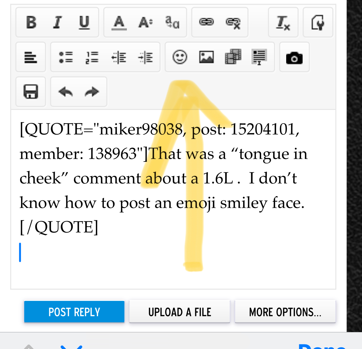

    That was a “tongue in cheek” comment about a 1.6L . I don’t know how to post an emoji smiley face.

    Thank you Anthony

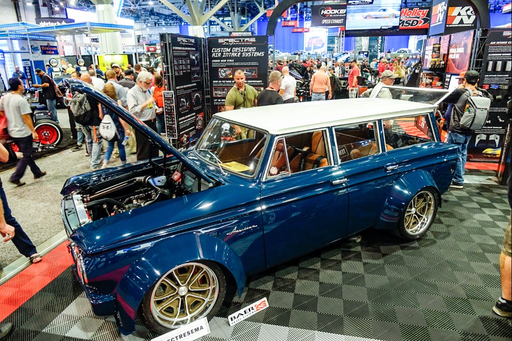

    Here is a decent looking one. :D

    I’d build both of them! They both look rock solid!
