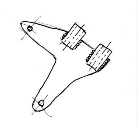

  2. How about fabricating new arms from tubing and 1/2" plate similar to these ? You could use the top spindle holes and your tie rod would pass over the top of your springs and wishbones.

    I thought about that, in fact I was looking at the Sprint steering arms from Speedway.
    But, again, I just don't like the looks.
