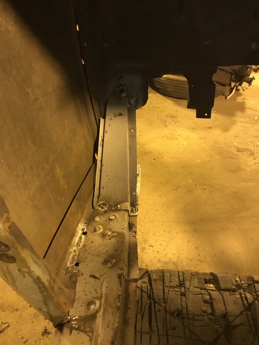

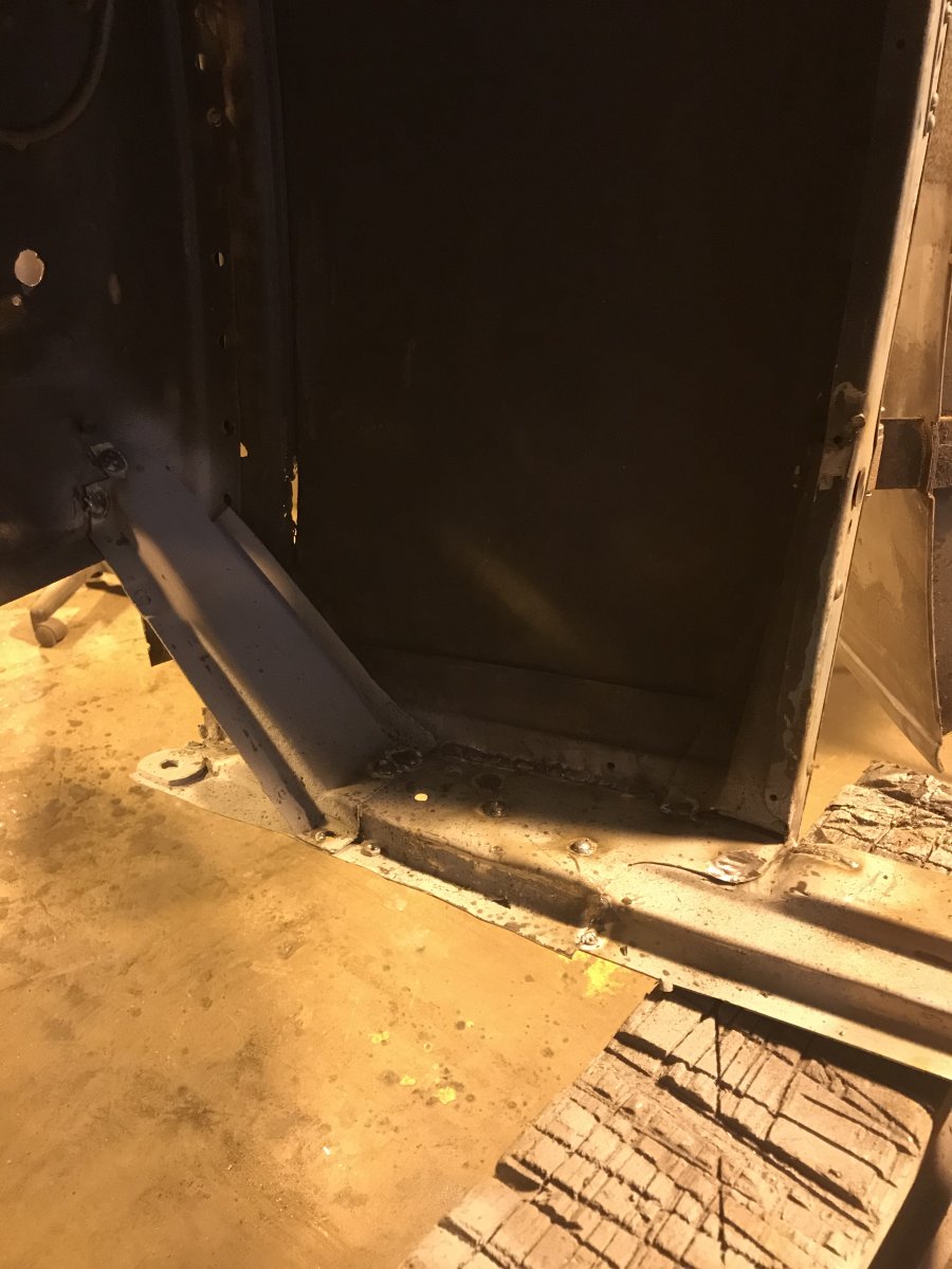

    I think I need to get some repop subframes for my model a. I would be curious to know what kind of issues you ran into trying to incorporate new subframes in your body. Thanks in advance!

    I didn’t run into any issues at all really, but I didn’t have anything original to start with. I’m sure there would be issues if you’re working with original stuff and aftermarket. The inner fenders will go in last, I definitely wouldn’t leave those out. Good luck with your project!

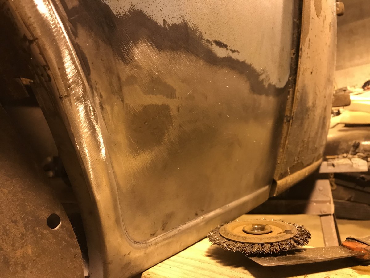

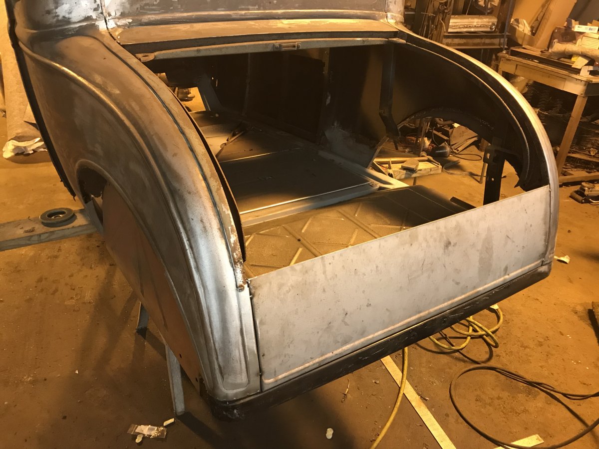

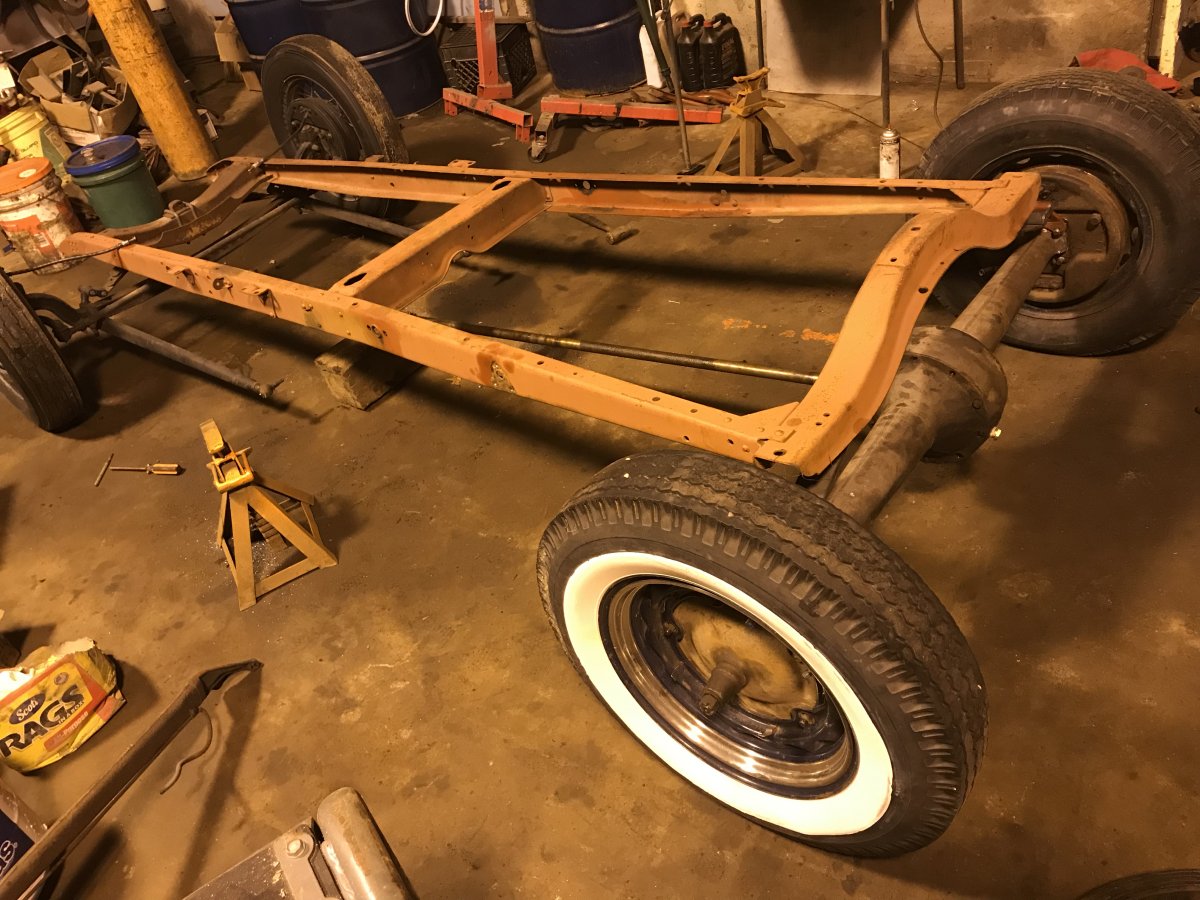

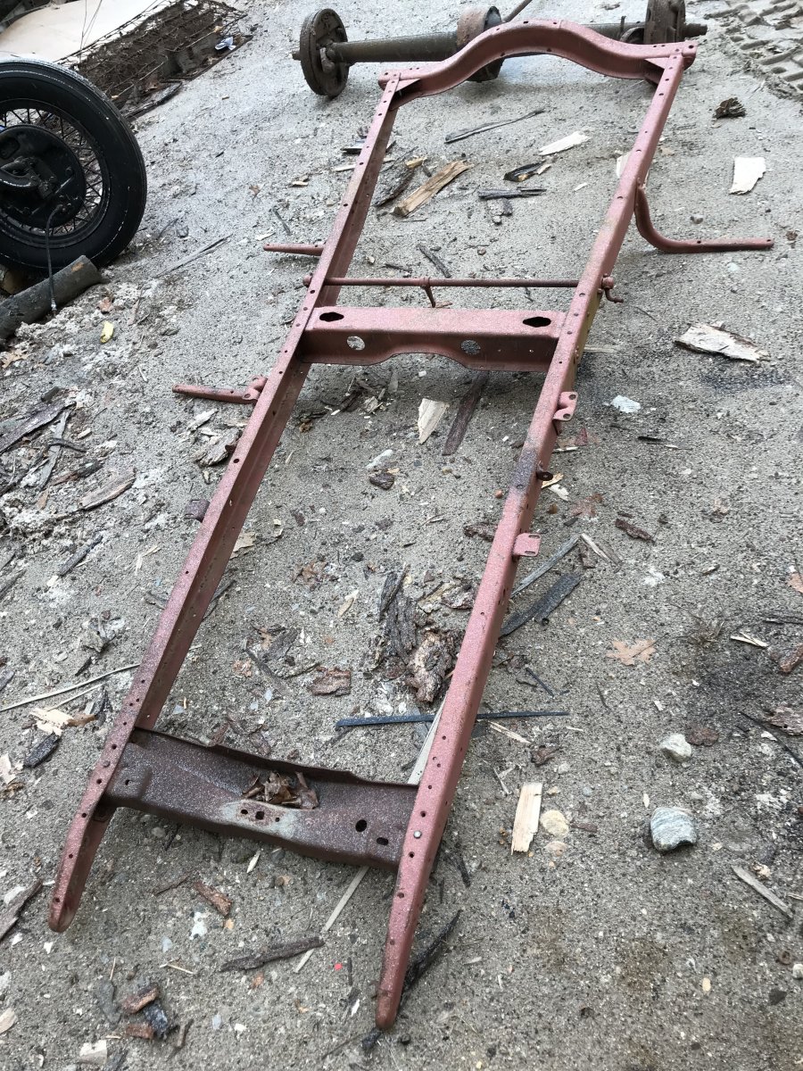

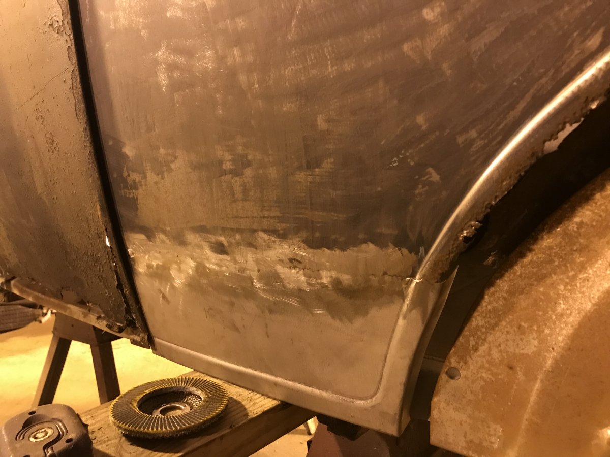

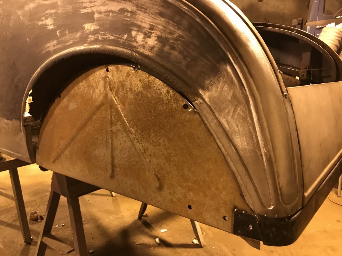

    Well I haven’t made to much progress with the holidays and getting stuff finished up for customers but I’m back at it now. Working on making a patch panel for the drivers side door. I picked up a nice original frame too.

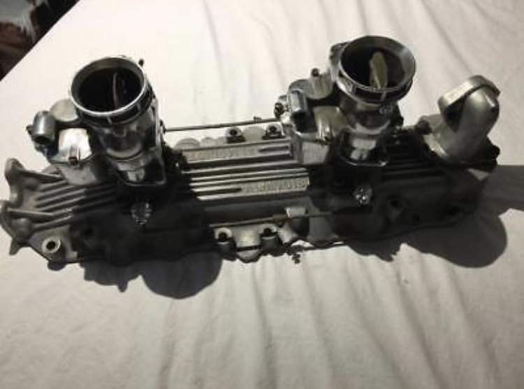

    Also, I’ve been looking for old almquist stuff for my 59a motor. Picked up this intake setup. Now I’m searching for a set of heads if anyone out there is holding.

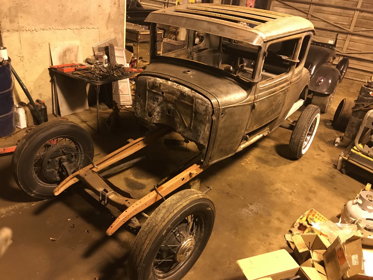

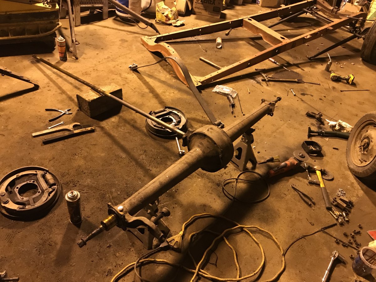

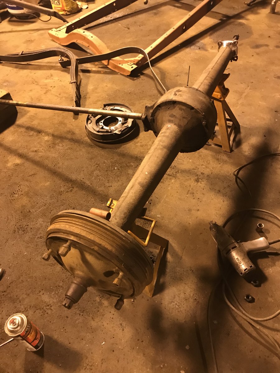

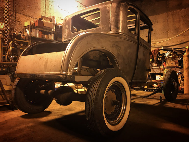

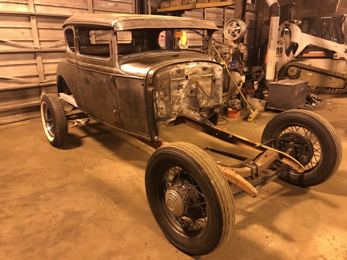

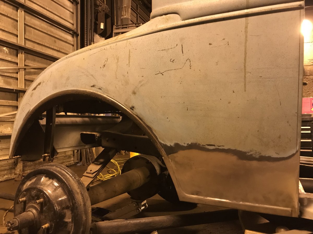

    More progress. So I started messing around with the rear axle. I got the old spring perches cut off and the new ones on. Also changed out the drums for the wide five ones. Then I got the front and rear bolted up to the frame and set the body on for the first time.

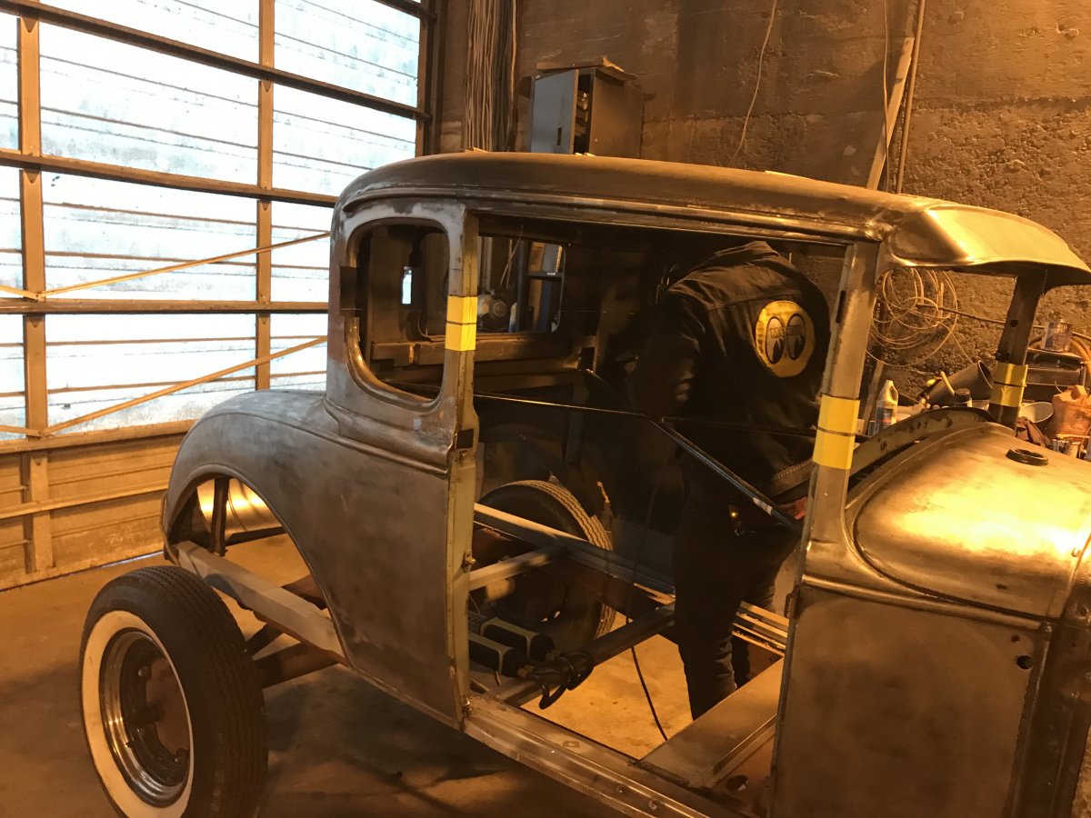

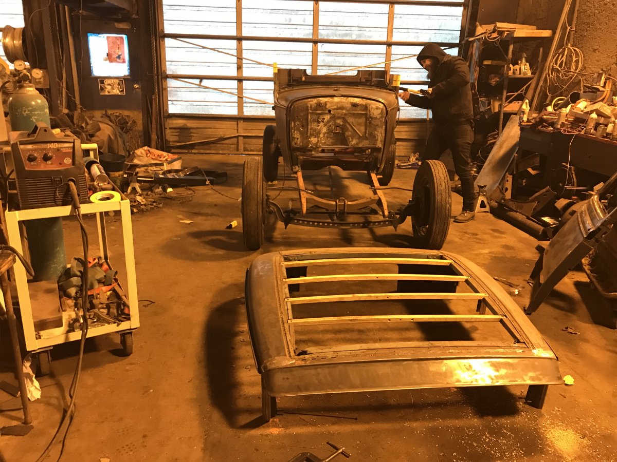

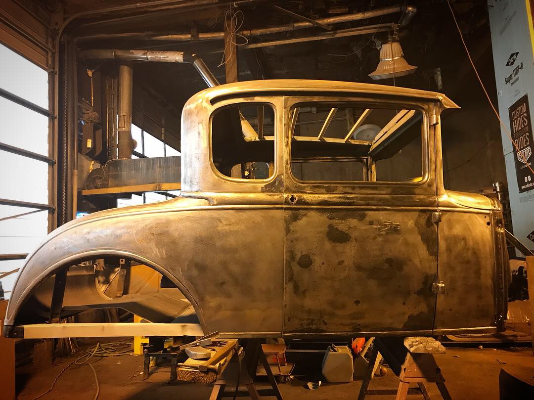

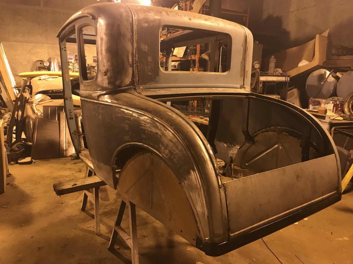

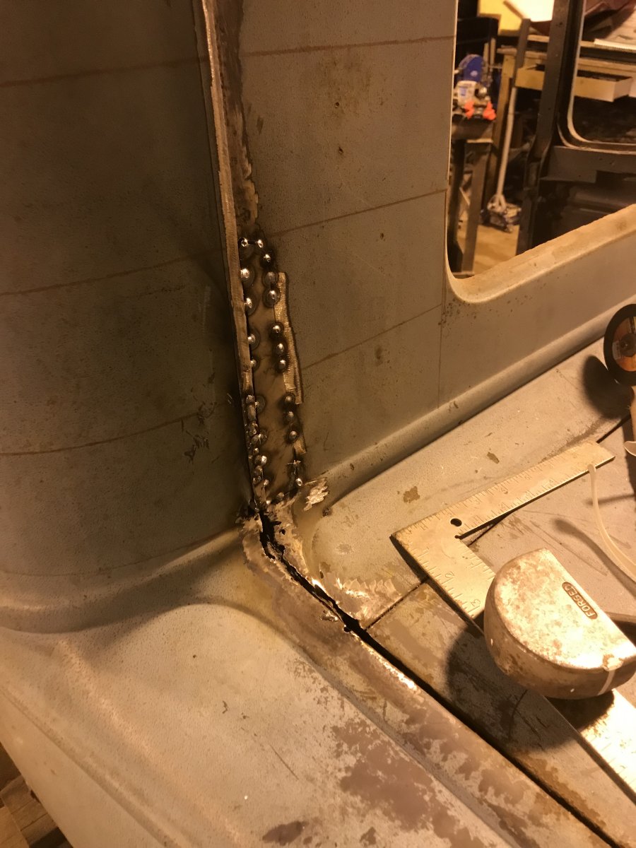

    Well everyone that has come into the shop since I’ve started building this car has asked me if I’m going to chop it. I spent Friday night taking the wood out, bracing, and laying out the 4” chop. Last night we cut it off and set it back on.
