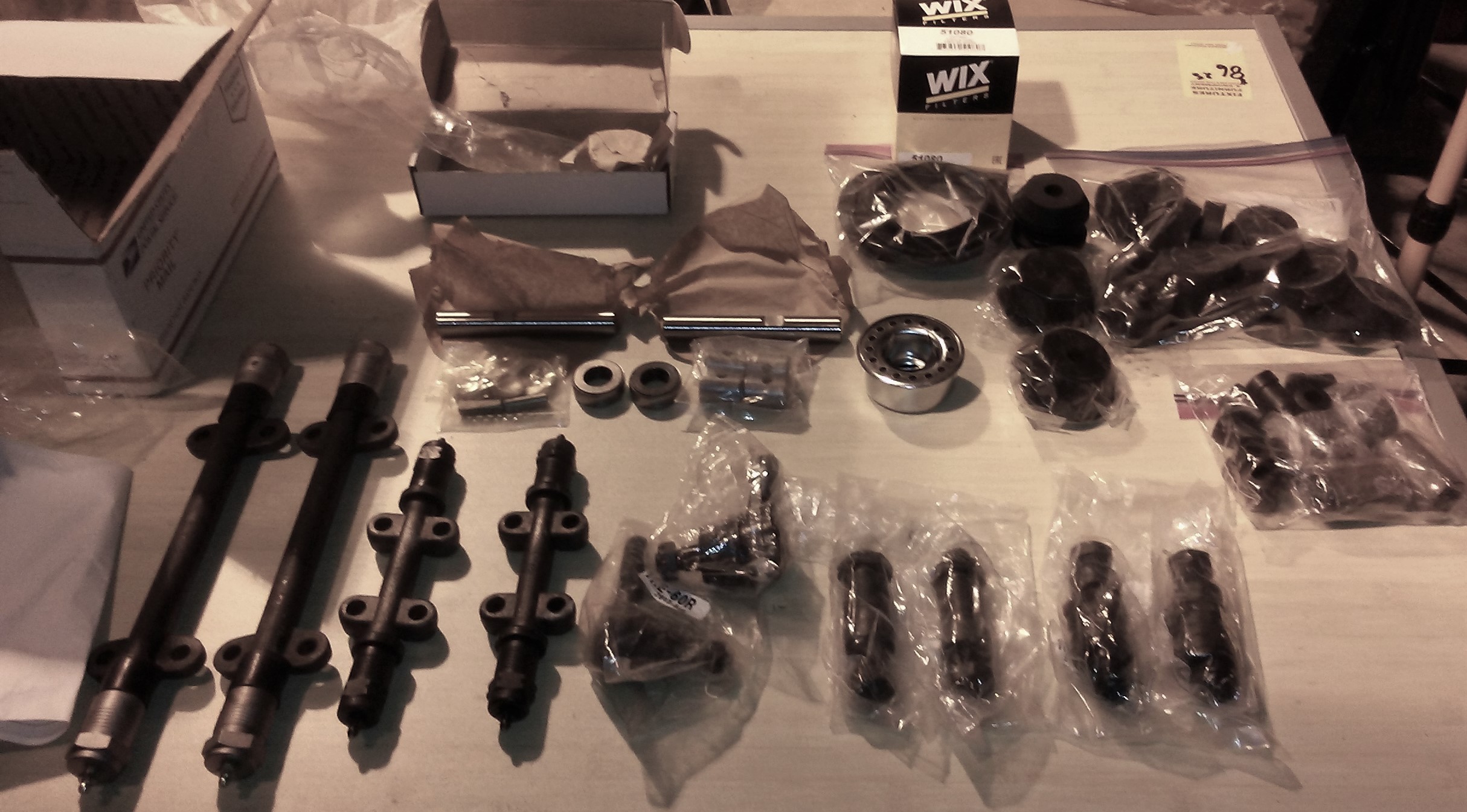

Installed this front end rebuild kit. I probably would have been good with the existing upper and lower control arm pivot bars, but the upper and lower control arm pins were badly worn. The kingpins were well within tolerances too, but I cleaned and checked bushings and installed the new pins anyway just because I had them. The only missing from this 'kit' was two tie rod ends ~ the kit provider only included the outers and I didn't catch that. I had to order those separately. The rubber bushings/silencer kit came as well so we are prepared assemble!
