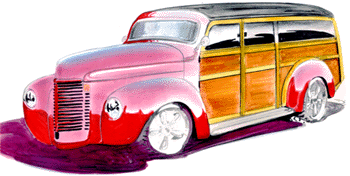

    I first do a ton of drawings of your car..what I do is draw the side view of the car without the wood part.. get the right rake..and make a ton of copies...then pencil in the wood design until you get the look you want..
    then get yourself alot of large cardboard..and project your image full size on the using this as your plan...prop it up on the car and make sure it looks right..a full size version sometimes still does look right...so work the full size view to you liking...proportions are everything ...

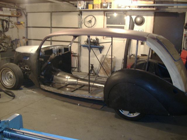

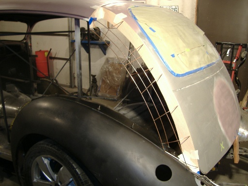

    I'm west of you in Roseau and in the middle of scratch building a woodie. My car of choice is a 37 Lincoln Zephyr - formerly a 4 door. I'm going with a steel roof, made from 2 sedan front roof halves welded back to back. The rear hatch is from a PT cruiser and will be skinned with Maple veneer. I intend to finish most everything on the car by this summer, then spend all of next winter on the wood.
    In the pictures, you can see my first attempt to mock up the rear corner pillar, which will be cut from a Maple 8x12. I used welding wire to frame up the shape, then covered it with cardboard and tape. I will then fiberglass it and use it for a pattern. I still haven't figured out how I'll make a mirror image copy for the other side.
