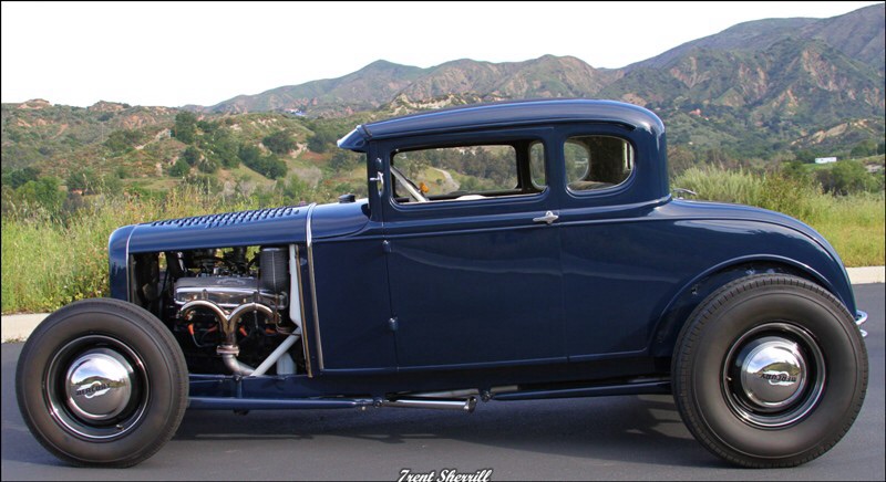

  9. A Boner
    Joined: Dec 25, 2004
    Posts: 7,445
    A Boner
    This blue Model A has a Rolling Bones style front end. That is how you get the front of an A framed hot rod nice and low. Notice how the split wishbone doesn't have the long bracket hanging down to mount the rear of the wishbone.
