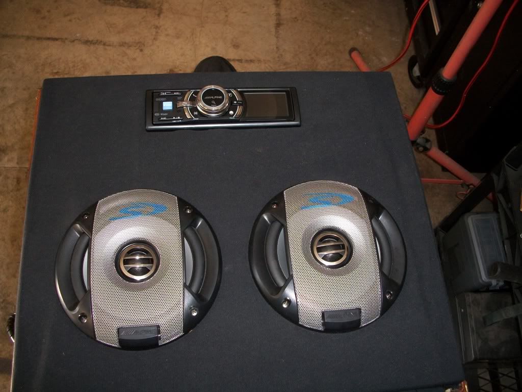

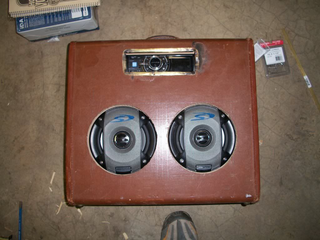

  3. I did this in my 49 plymouth I used to own

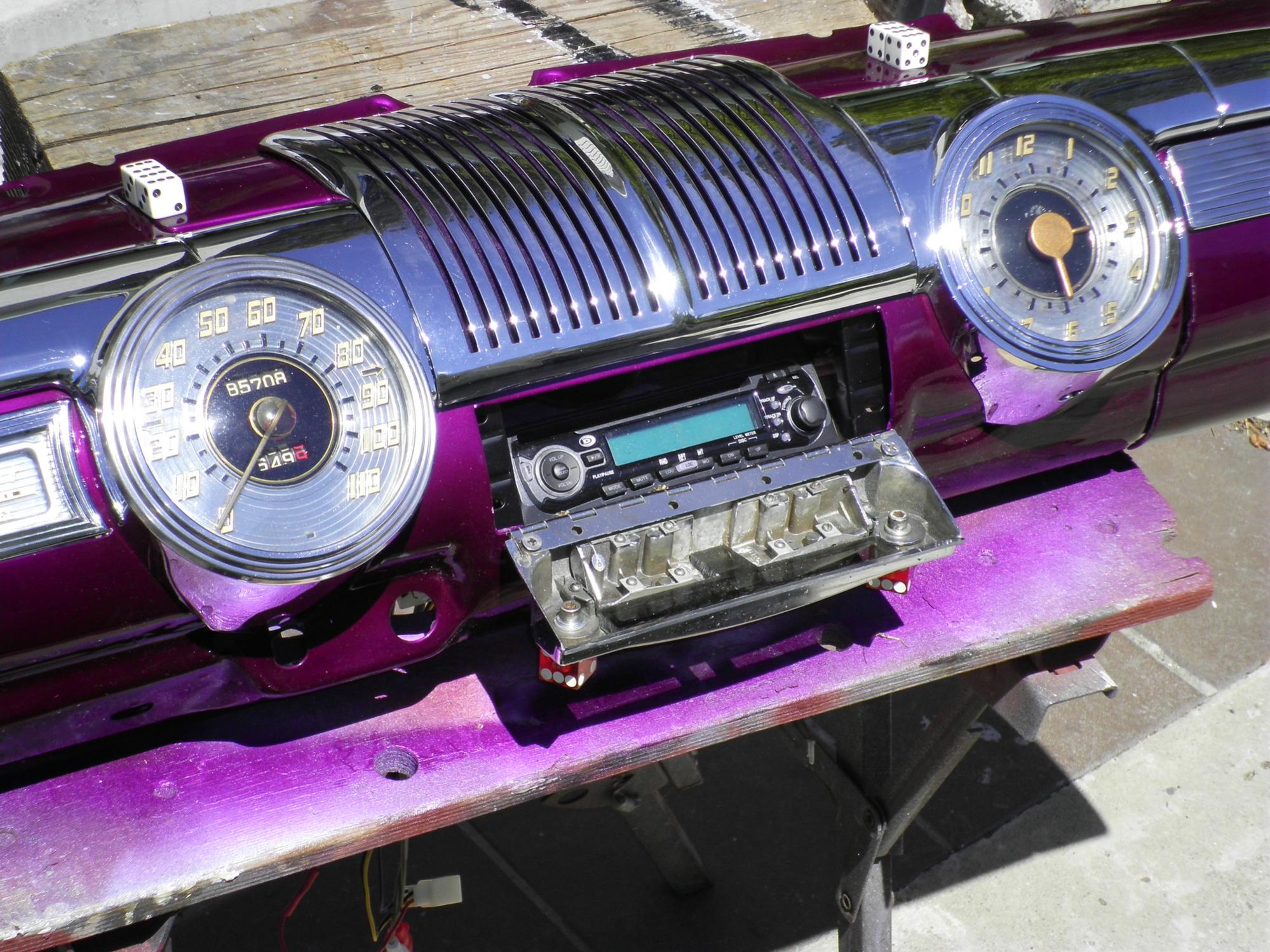

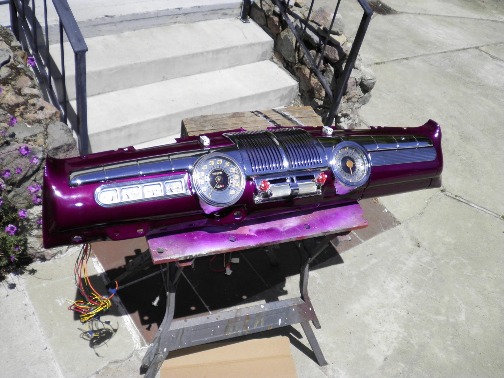

    I separated the face from the radio box, mounted the face recessed into the dash, and mounted the radio box sideways behind some panels under the dash, the cd now pops out through a slot in the passenger foot well.

    I hinged the old radio front and mounted the cd player behind it.

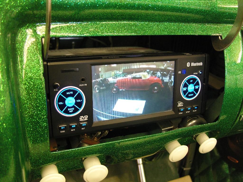

    Ilike my music so put mine behind the hinged speaker grille in my 40 dash, plays
    CD,DVD,MP3,SD,USB,TV,Bluetooth, Remote Controlled, You can't see it.
    Video of it working
  30. bonez
