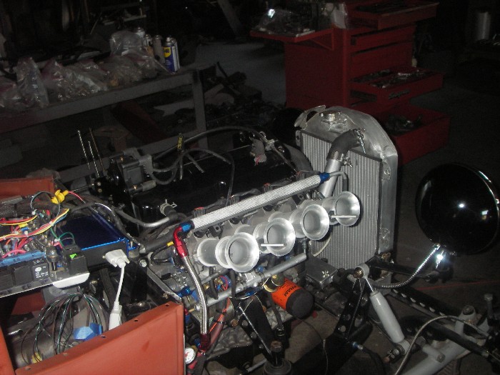

    I run a Ford Zetec in my 28 modified. It had 20,000 mile on it when I bought it for $750 and I have added about 12,000 to that in the last couple of years. BW T5 tranny, Hilborn electronic FI. Runs pretty good. I have attached a couple of pics.
    I agree with Rich Fox about not looking "old timey" though but I was looking more for the midget motor look.

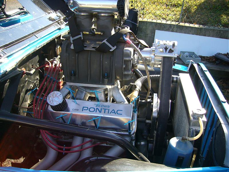

    Or you could go old school Pontiac Tempest 4 cyl. 200CI, 166Hp in 61-63 with a factory 4 bbl carb. Or you could step it up & go wild with it. Here is a pic of a Mickey Thompson Blown Tempest 4 cyl & A carb'd one from Nunzie. Or if you want really wild, how about one in a mudbogger Jeep!!!
