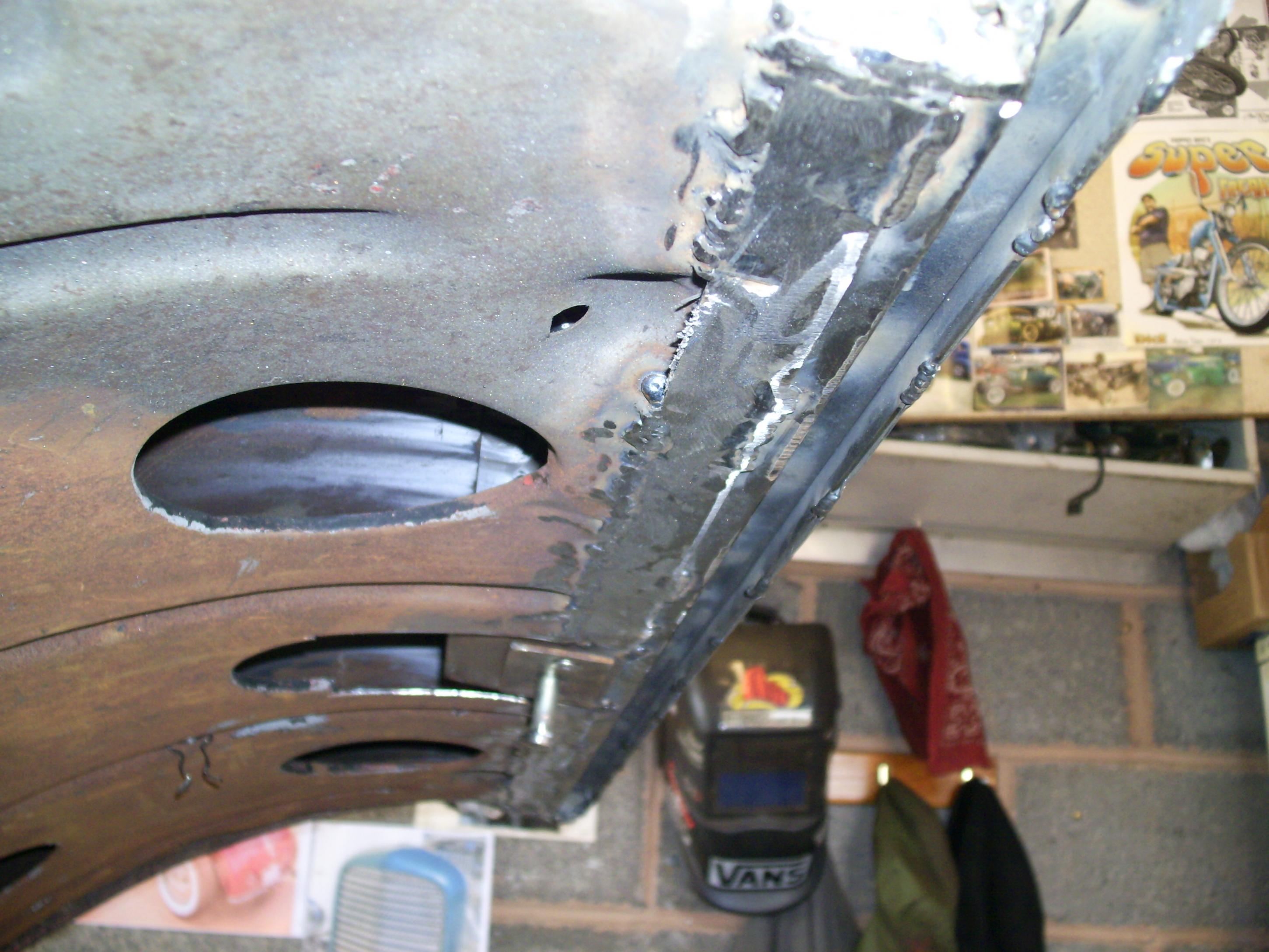

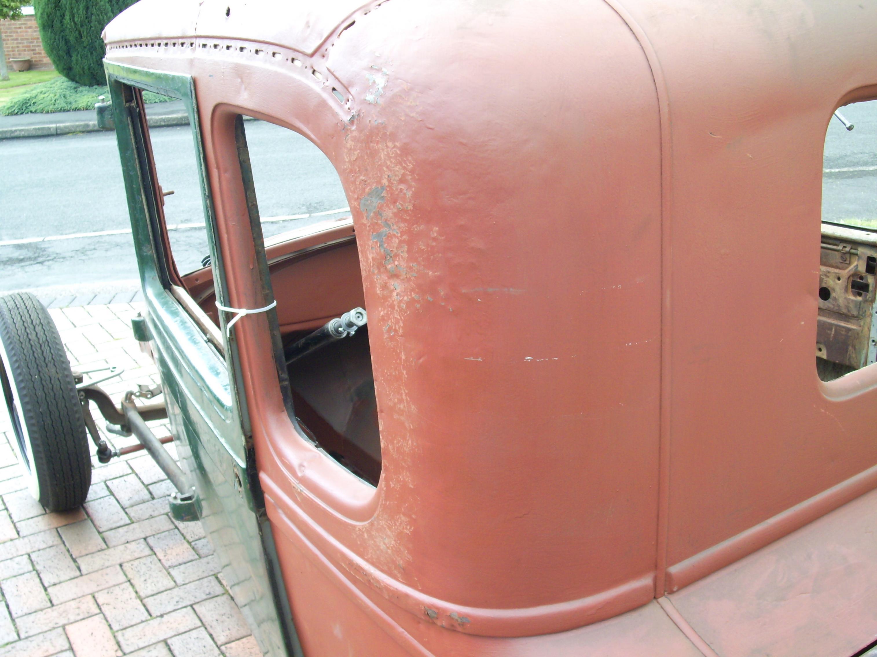

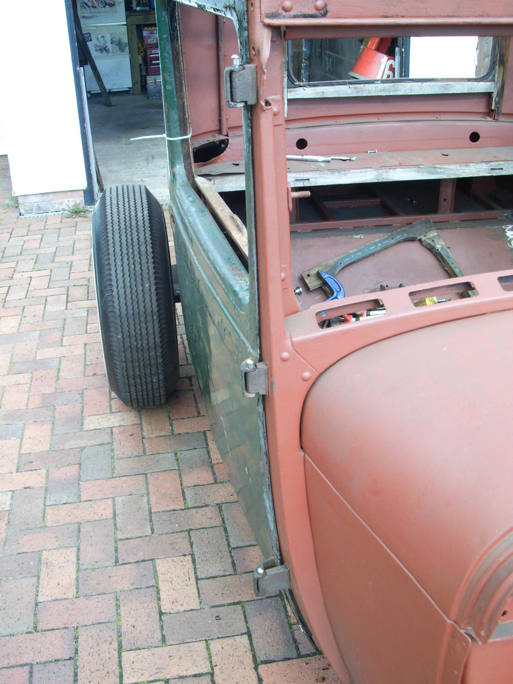

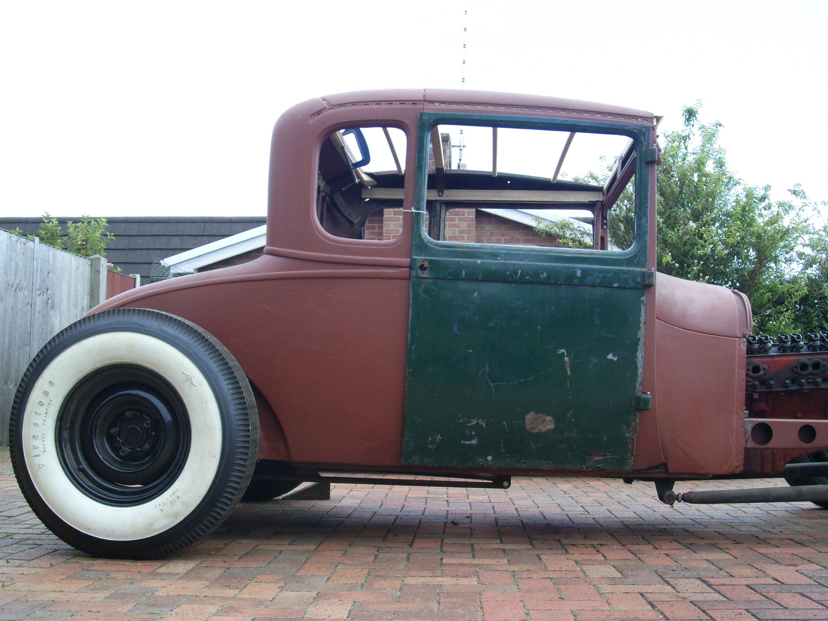

    I thought it was about time I up-dated you on the progress of my ''A'' Coupe.I don't work as fast as some, so a little goes a long way or so they say:)Since I posted last I've redone the underside/siderails on the body, I had issues with clearence, there wasn't enough!The body and frame rubbed on each other, they may have liked this, but I didn't!:DNow I have acres of clearance, well a bit more anyway!

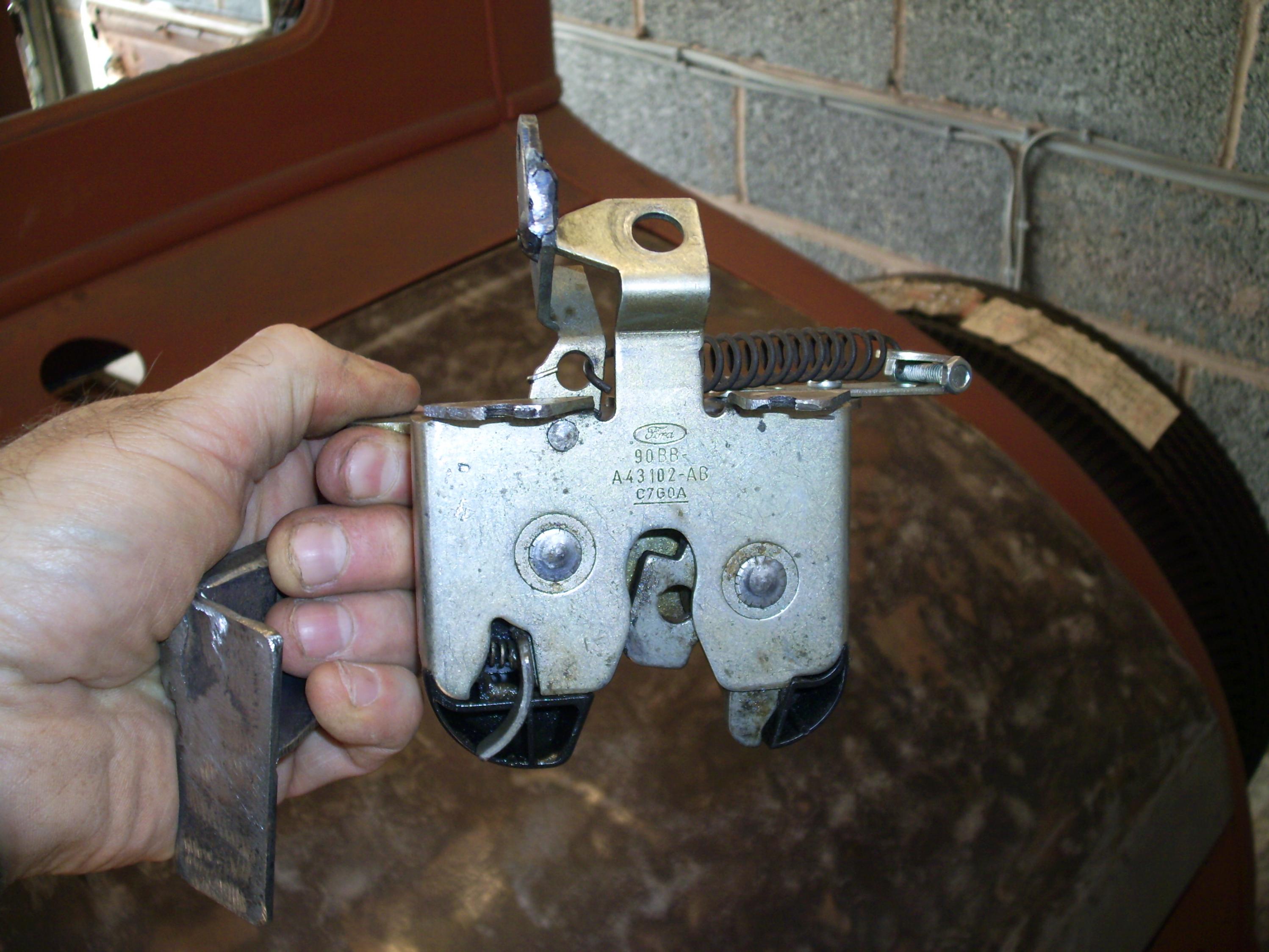

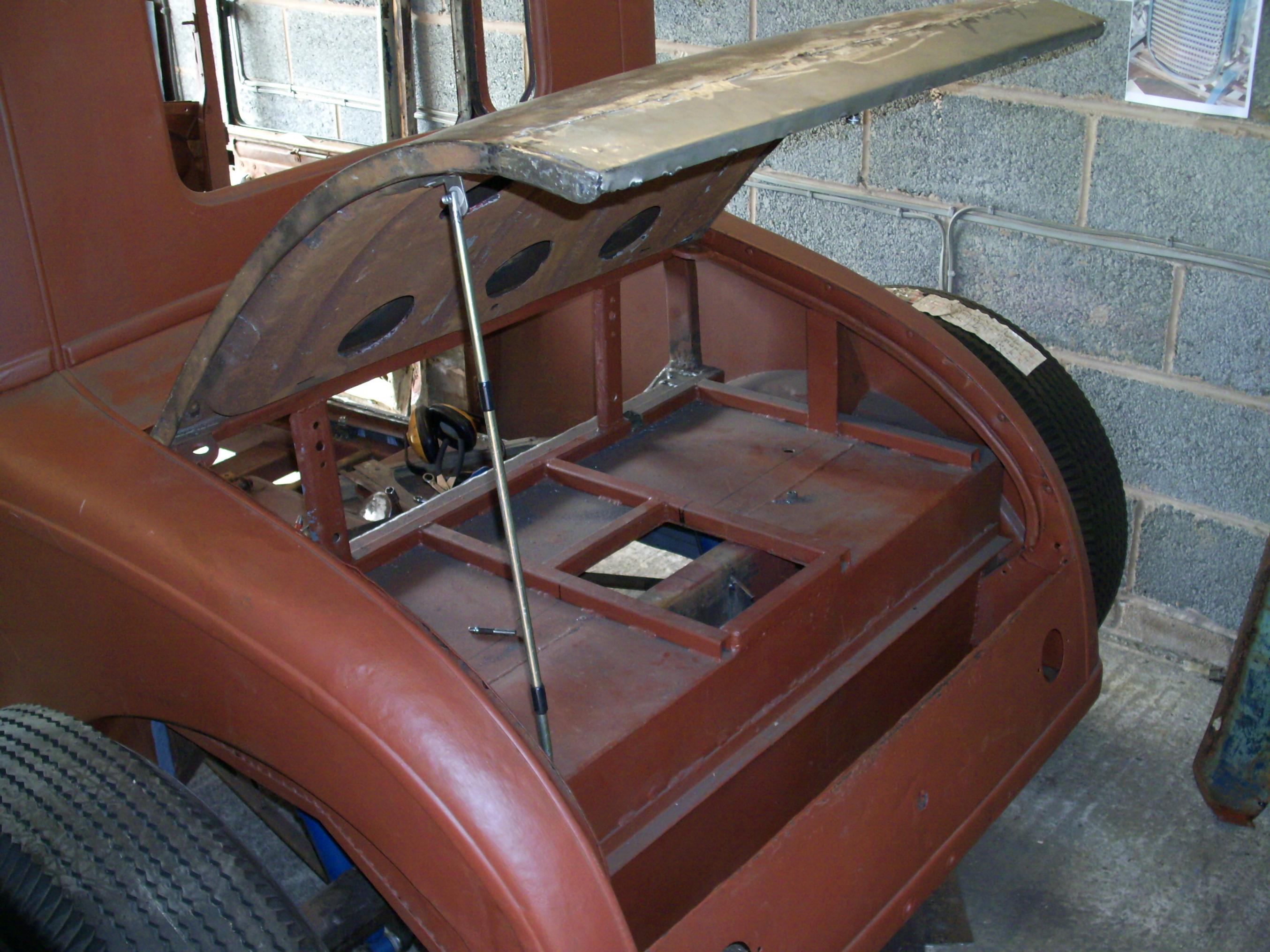

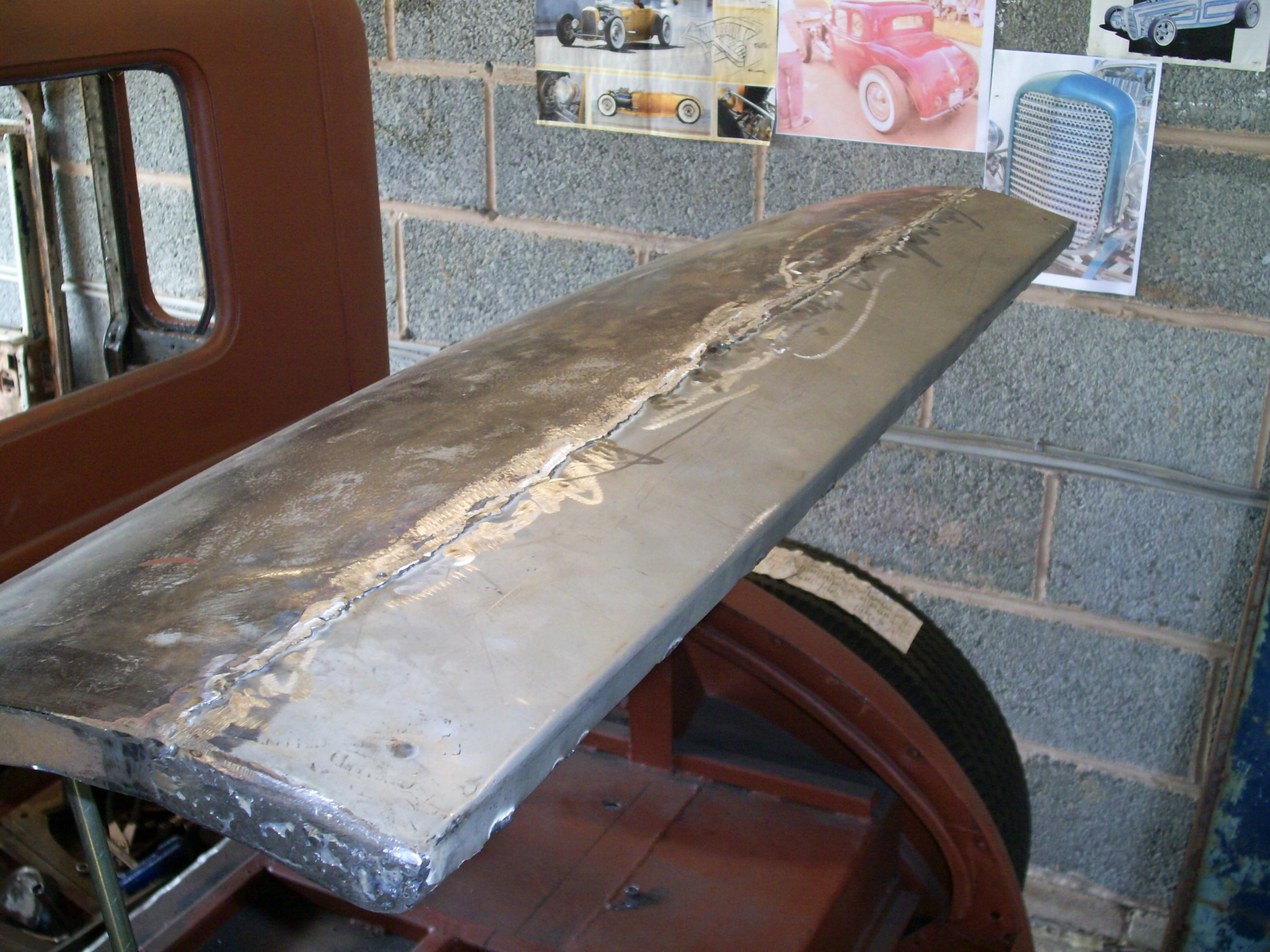

    I've messed wih the door gaps, not perfect, but not too bad!I fitted correct hinge parts on the body and THANKS to dudley32 for sending me some so I could make a full set!:)I will get him that Jag or Big Healey hes' after oneday!!!;)Also fixed the over priced and more fuckin' rotten than I thought decklid!Too tight to buy a new skin I just made some thing up to do the job, looks O.K. it'll look a lot better with some filler on it. I'm using a modified Ford Sierra tailgate latch, had to make it work by pull cable. I used a fire extinguisher pull cable I got from work, should have that buttoned up this week, when its' finshed kicking my Ass!:D

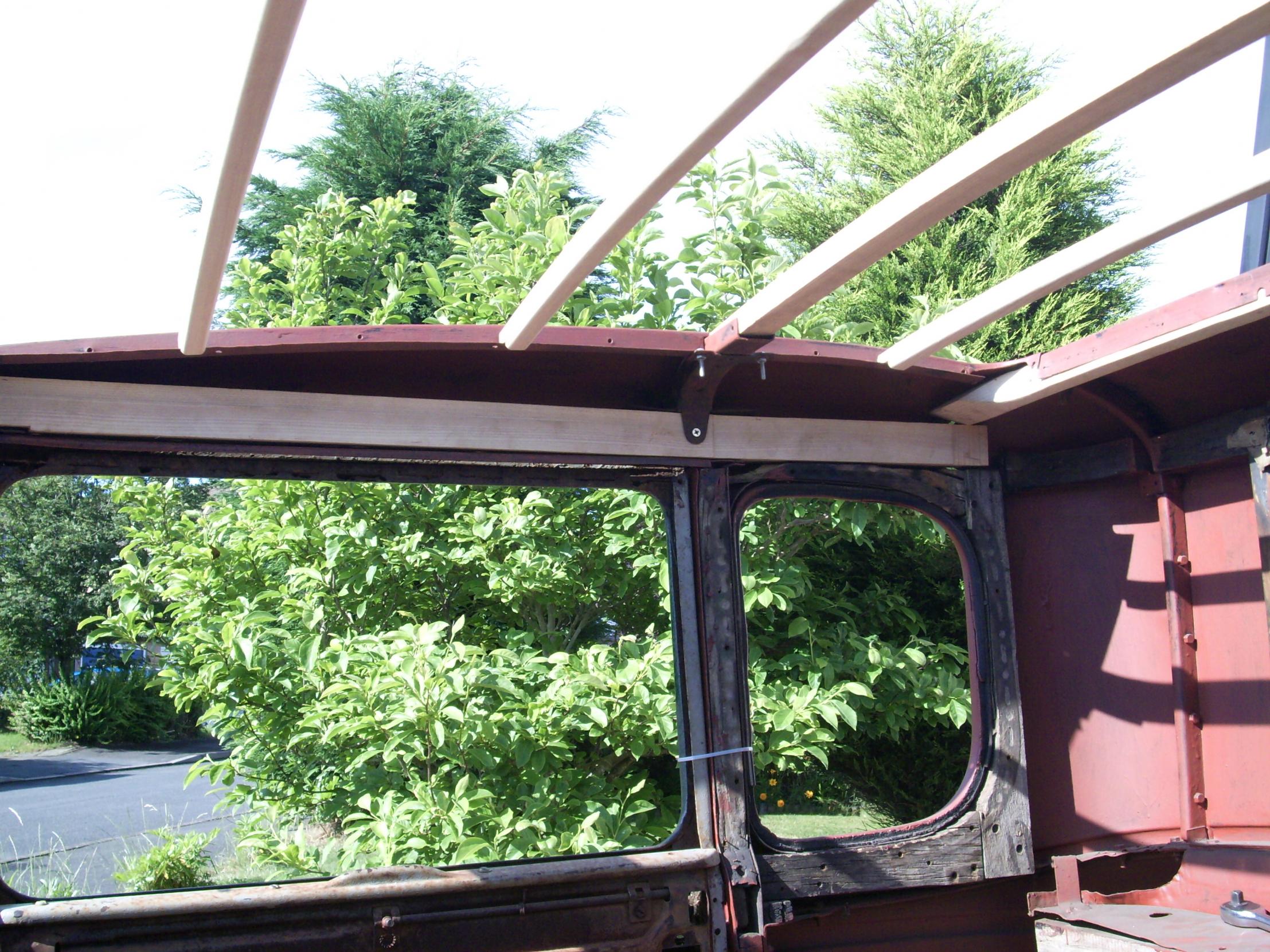

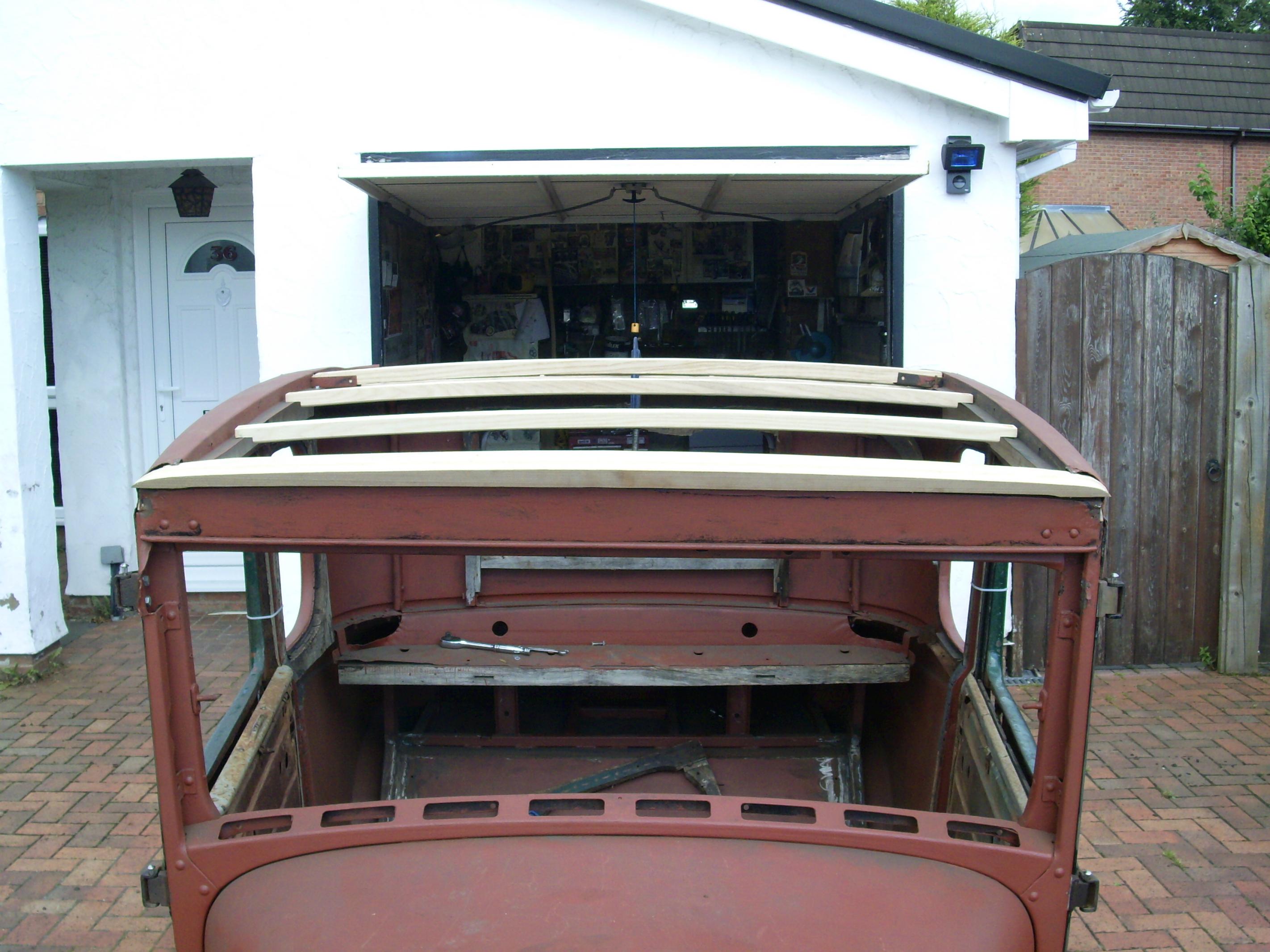

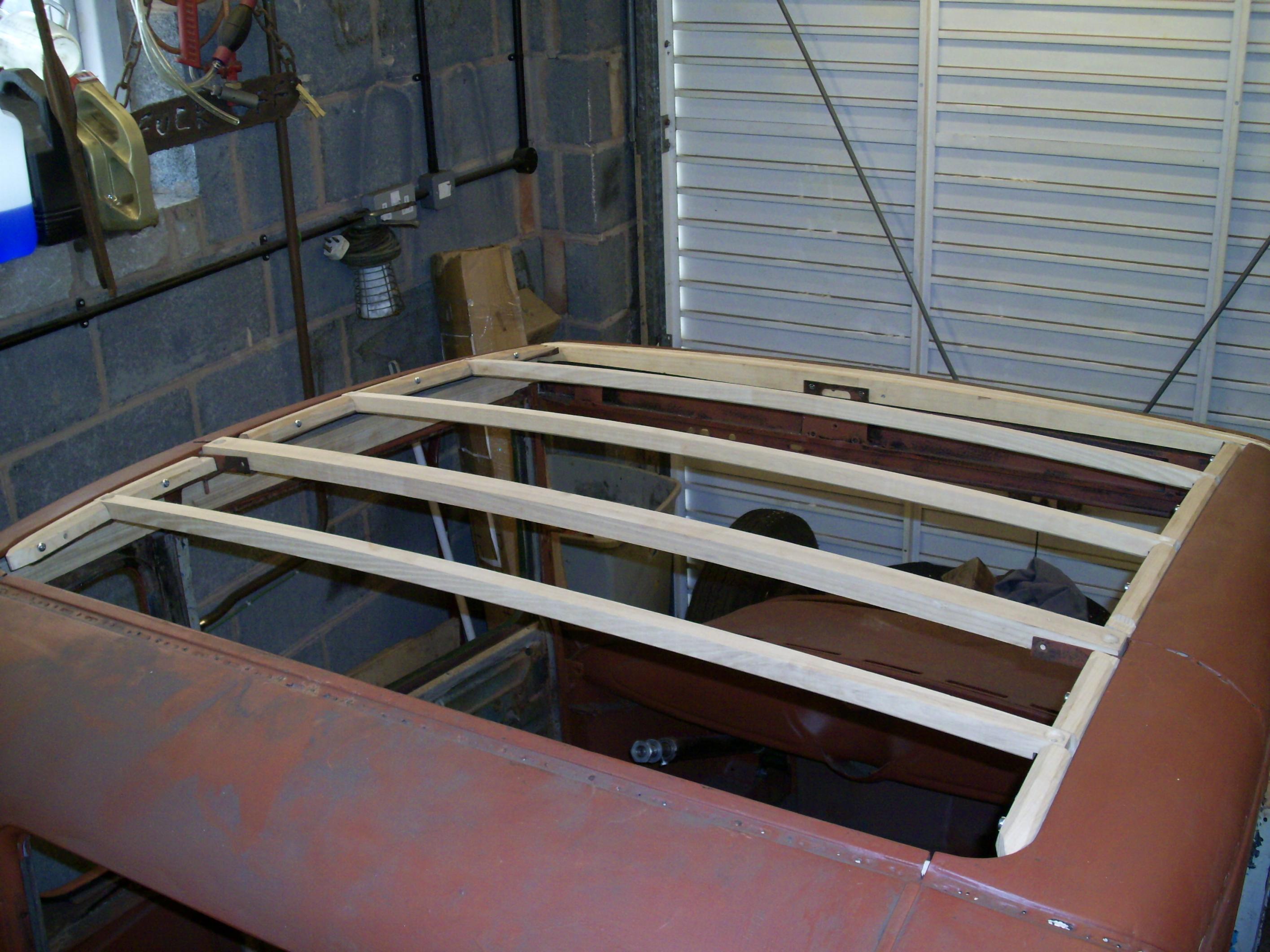

    I've tried working with this new type of metal this weekend, I believe its called wood! Never heard of it before and it don't weld well!!!:D Don't seem to be able to strike an arc on it!

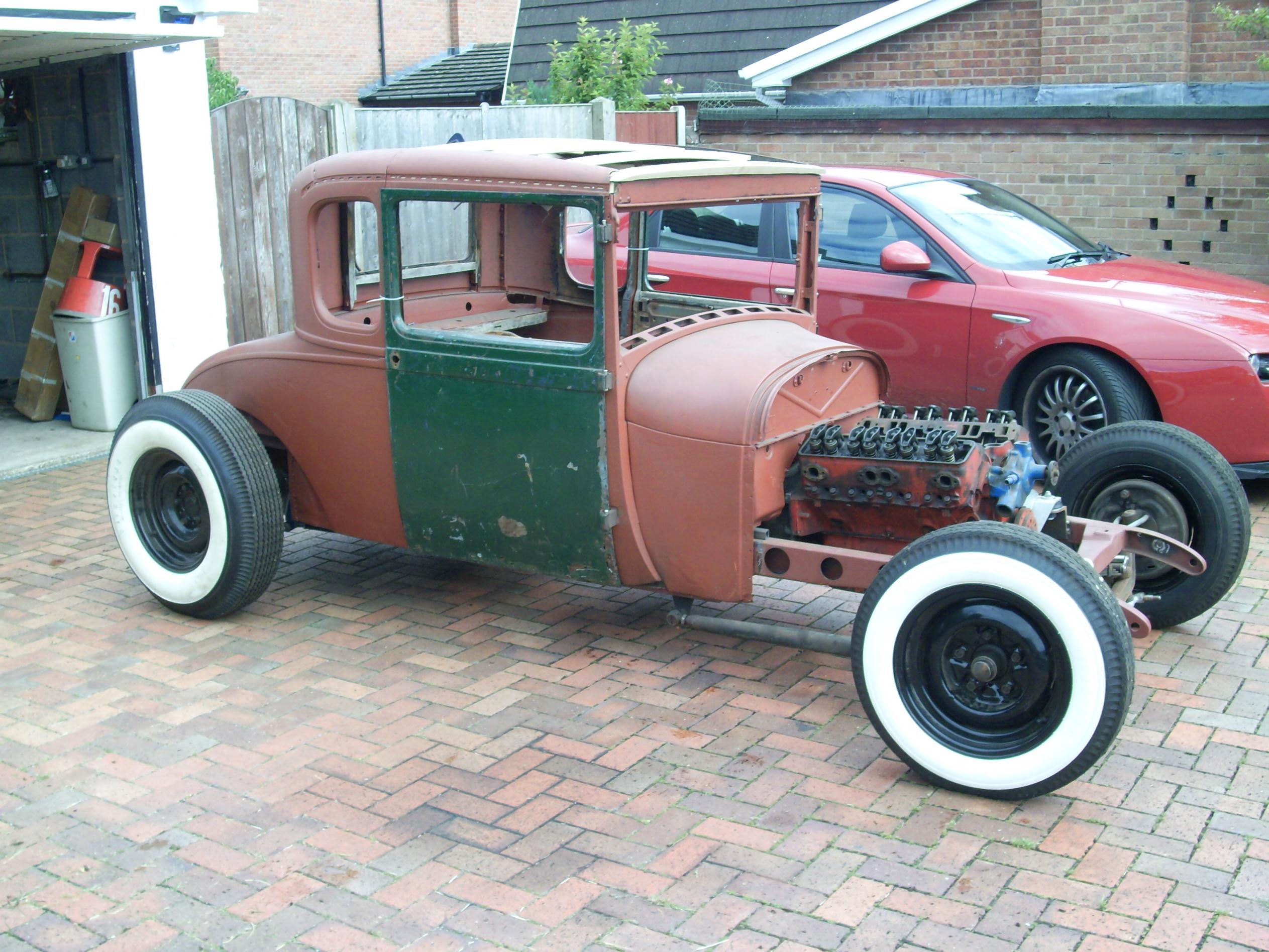

    Nice new roof wood kit from Zipford, fits a treat, just don't tell my wife as I'm NO good with flat pack furniture!;)The CHOP is looming its' lovely head and I've deciced to enlist from professional help Zipford again!Thats about it for now, its' all down to the timeing of the chop as to when I take the body off the frame and start to finish weld that and rebuild the brakes e.t.c. Oh and I've decided(with some butt kicking by others:D) I'd lost sight some what of my original goal to build a simple, black Hot Rod. So no more ideas of fancy paint jobs, more of a late '50's style which is what I was going for when I planned this Damn build in the first place:)So THANKS for listening, hope it wasn't TOOO boring!!

    I know what your saying a bout the chop, but I have to do it to this one while I can still get in the bloody thing!I'm not getting any younger!!!!!:D
    The original plan called for no chop, but I like the look of 'em chopped more than not chopped!:)

    Mark, 4'' I reckon!:)
