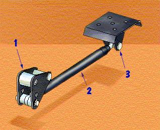

  17. Ummmm....yeah, I guess ?? Any device stiffening the front leaf pack will reduce his axle rolling back on itself. Having said that....I just noticed my comment regarding the inner structure is the damned frame sitting on the snubber. That goes into the realm of my Suburban mods'. Totally off topic vehicle....but I notched and plated the frame on that...so yeah.
    Cal-Tracs and their derivitives are good for axle wrap. Hell, even cutting a leaf just a little past half will help as a cheap traction device. Either way the leaf pack needs to be solidly bolted together, rather then sliding around haphazardly. He may as well have a mono leaf....pretty much what it's doing anyway.

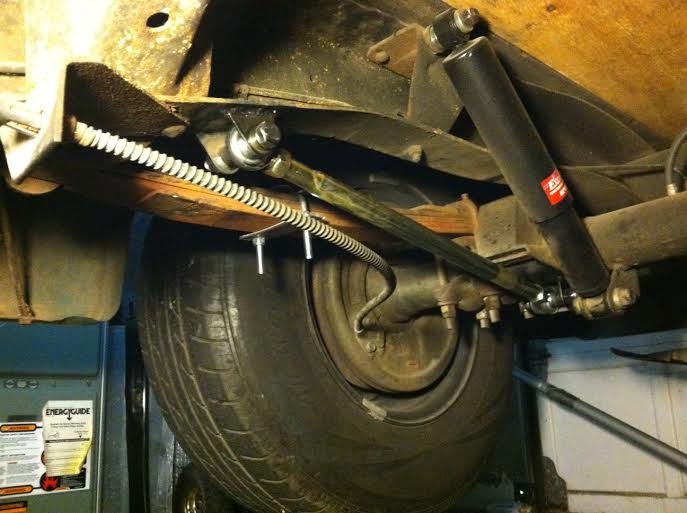

    Good news. After deliberation and input from you all, I decided to make some "traction sticks". I got all the pieces from Summit Racing, 5/8" rod ends, threaded swag tubing, and coil-over shock mounts. Here is a picture of the new setup:
    And more importantly, the results. I took it out today to test it. It feels totally different it terms of torque transfer. When I torque brake it, the rear end feels like it is lifting up when torque is applied, where as before, the axle would rotate and stay soft. Now its just smooth single tire annihilation, no wheel hop. Ha!

    If both ends of that traction arm are fixed (they appear to be), and the front mount is not the same length as the as the front mount of the spring mount you will bind the traction arm mounts, and they will fail.
    This is why drag cars with leaf springs and ladder bars put the axle spring mounts on sliders.
    Cal Tracs pivot at the front mount so they do not bind.
    You don't have much axle travel (but you should) and may want to rethink your design.

  27. So it looks like you've bound the overload helper to the other leaves with clamps.
    The bar you added has a different arc of movement than the springed axle does. Basically a triangle has been formed now and you're expecting one of the legs to change its length as the suspension moves. The legs are frame spring mount to axle centerline, frame bar mount to axle, and frame spring mount to frame bar mount. Incidentally, with a caltracs bar the last leg of the same triangle is on a pivot to allow movement and locks against the spring.
    When you want to keep something from moving a common way is to diagonally brace it forming a triangle. You've formed this triangle in something you want and need to move freely.

  28. I was going to mention the same thing here. That C-10 should have a truck arm ( trailing arm) suspension. They don't hop. That parallel leaf setup doesn't look like the correct setup for that truck.
    That aside, when your suspension bottoms out that is what is causing any hop you are experiencing, it is now using the tires to absorb what your springs should be absorbing. A quick fix would be a pair of air shocks and add a little air pressure when you want to go to the burnout contest.
