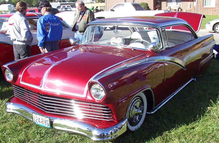

  7. I can't help with measurements, but I did find a few pictures of '55-'56 Fords with tube grilles in them--courtesy of Rik Hoving's Custom Car Archive. Hope this helps you out..........E hay056-vi.jpg 56FordHTCarnut-vi.jpg

    Sorry for the slow come back. Both pictures are excellent. Having the ends bent, was my idea. I ordered two of the tubes one foot longer to see if its possible to bend them. I'm using 5/8 tube with .035 wall thickness. The steel company i got them from said should bend easy. Ive also got a 5/8 tube bender. Stainless tubes come next week so we will give it a try. Also Like the second picture, if the bending doesn't work well then the cut off ends will also work. thanks very much.
