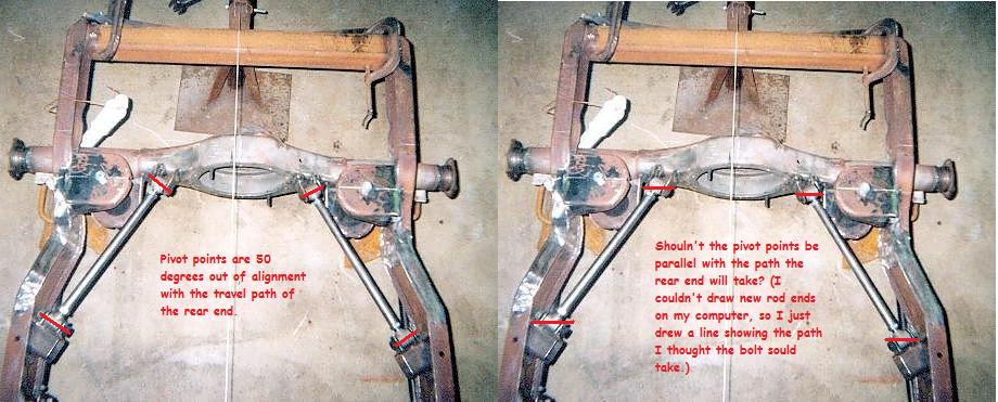

    I have a new-guy question:
    The rear end will be moving up and down perpendicular to the frame. The pivot points at both ends of the upper mounts are at a 50 degree angle to that movement. Shouldn't they also be perpendicular to the frame in order to follow the movement of the axle?
    The bars could still be angled at 50 degrees, but it seems to me that the pivot points should be perpendicular (90 degrees).
    I've seen many rear ends done like this and not many done as I've described, so I have to at least consider the possibility that I'm wrong (again). But it seems to me that the rear end would bind if the bushings were solid. The only reason it works so well is because the rubber compresses and is overcome by a long lever (the upper links).
    Can someone explain this to me?
  28. dontlifttoshift
    Joined: Sep 17, 2005
    Posts: 652
    dontlifttoshift
    Nothing to explain.... You are correct. The factory bushings are very large in diameter for that reason.

    When I mocked up the rear set-up you see in the photo I placed my floor jack under the rearend housing and lifted and lowered the rear axle. It doesn't bind at all as shown. Every triangulated four bar I have ever seen has rod ends mounted like the ones on the photo.
    The bushings in the rod ends aren't rubber they are hard poly bushings.
    I can't recall ever seeing a triangulated 4 bar set-up the way you are describing it. Got any photos?
