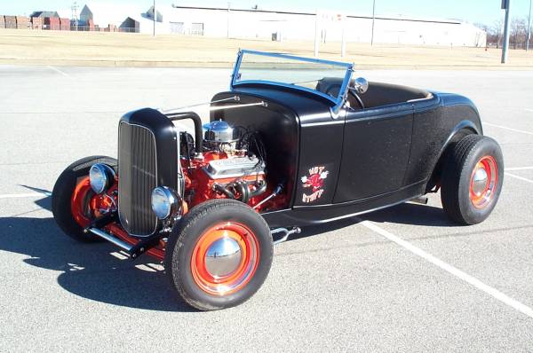

  8. I have John Deere Blitz Black on my roadster. Not very chip resistant. If I was doing it again I would use one of the "Hot Rod" black paints that are available.

    John Deere blitz black. looked great when first sprayed but once it got into the sun it became alittle streaky. but for 40 bucks u cant beat it.

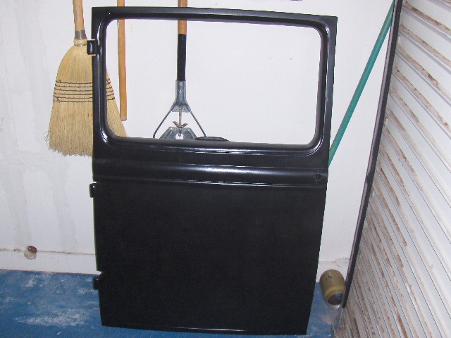

  17. I shot the door to my old model A truck cab with Rustoleum Satin Black paint which is basically the same thing. The door was real rough so after I soaked it in my electrolysis tank to remove the rust, I patched it up and just shot it with what I had in the garage, just to see what it would look like. Turned out great! Well, great for what it is...:D
    For a no frills, low buck ride it works perfect and looks surprisingly good. Tractor paint is just an enamel and if you buy the hardener at Tractor supply or ACE or whatever, it dries in about an hour and is tough as nails. The gloss paints wet sand and buff out well and will last if you keep it waxed. The flats and satins don't hold up as well but you can keep them looking nice with Pledge or Old English furniture polish. I just poured a little less than a cap full of hardener directly in the gun and stirred it up real good.
    Here's the link to the hardener: http://www.tractorsupply.com/webapp...&langId=-1&storeId=10551&ddkey=http:ClickInfo
    You can use it with just about any enamel paint they sell at the hardware store. Again, I used the Rustoleum. The pic's show some spots because my camera was out in the rain but the door has a smooth sheen to it in person.

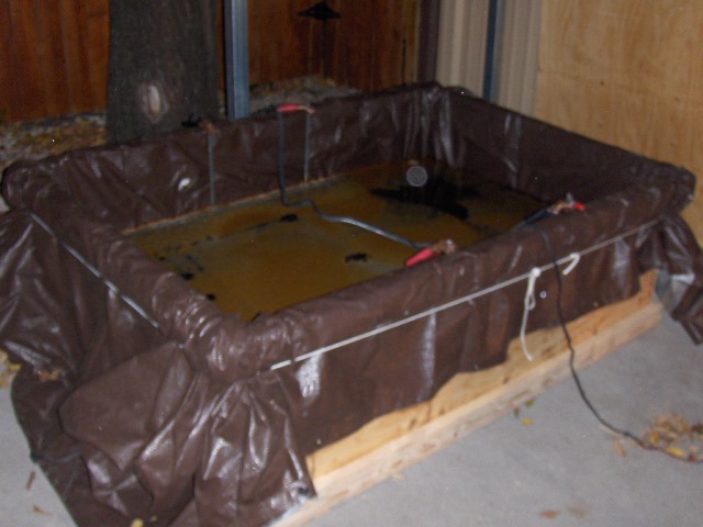

    I would like to know more about your electrolosis tank...how large is it?

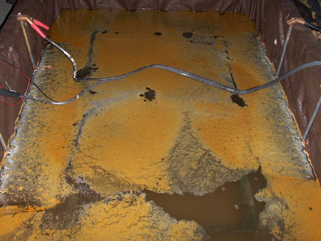

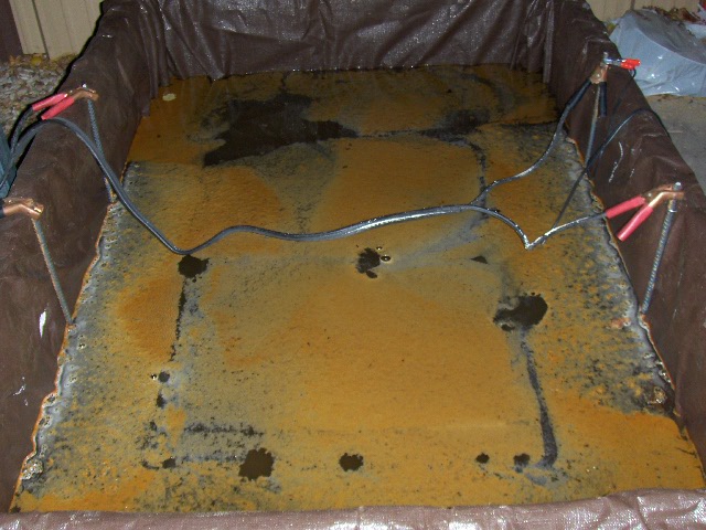

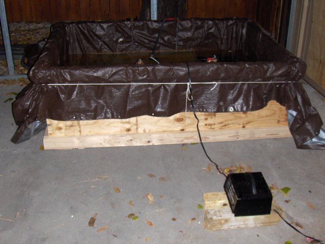

  25. I used a 4x8 sheet of plywood cut down to 4x6 which leaves a 4x2 section for the end wall. Another sheet cut down to 4x6 and then cut in half gives you the other walls. So basically it's 4x6x2. I wrapped a band of 2x4's around the top and bottom for strength and screwed it all together with deck screw's. Some rebar, Arm & Hammer washing soda and a charger on 10 amps for a couple of days does the trick. I'm doing the whole cab (cut down) this way. This is the door in the photo's above when it was in the tank.
    Don't want to high jack the thread but I thought this would be OK considering it's related to what we're talking about...PM me if you have any questions.
    -Ron

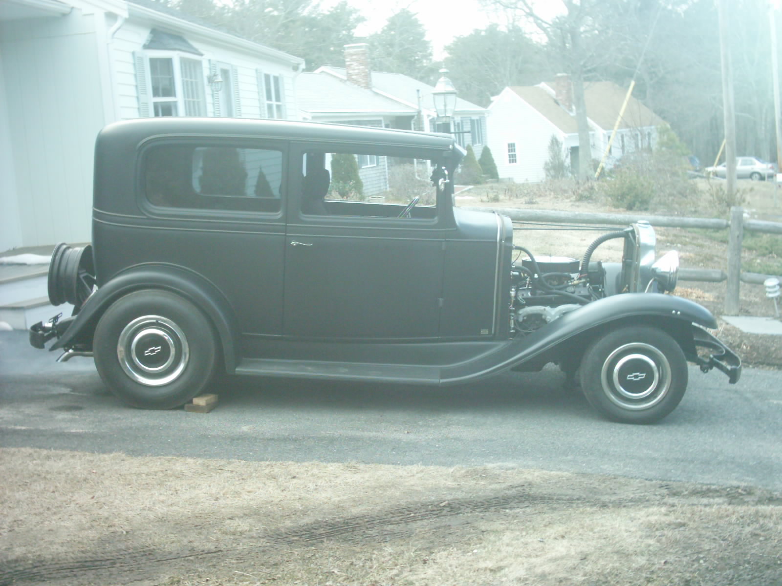

  30. My 31 chevy with John Deere Blitz Black rattle can.
